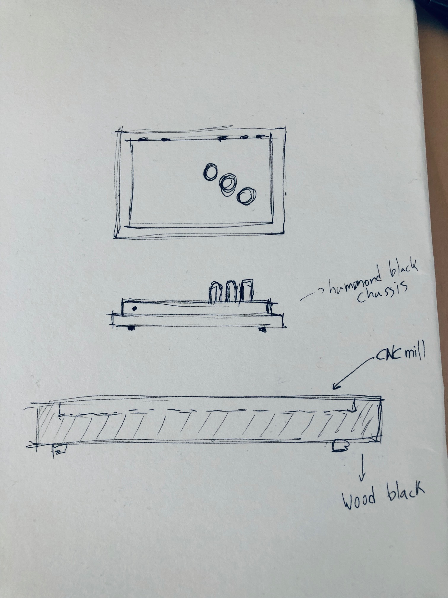

Im in design and engineering so Id like to design a cool look for it! (Currently thinking of a design for another line preamp)
Looks is always a good psychoacoustic plus heeheh (I sometimes love snake oils)
sounds good. if you come up with a cool design for the case, let me know. maybe i'll buy one off of you to replace mine - which fits nice but the holes are a mess....
No time for a 3d model but I though I can sketch something. My free time is crazy.
I like the concept of solid black wood with a CNC milled centre part in order to accommodate a black hammond chassis.
