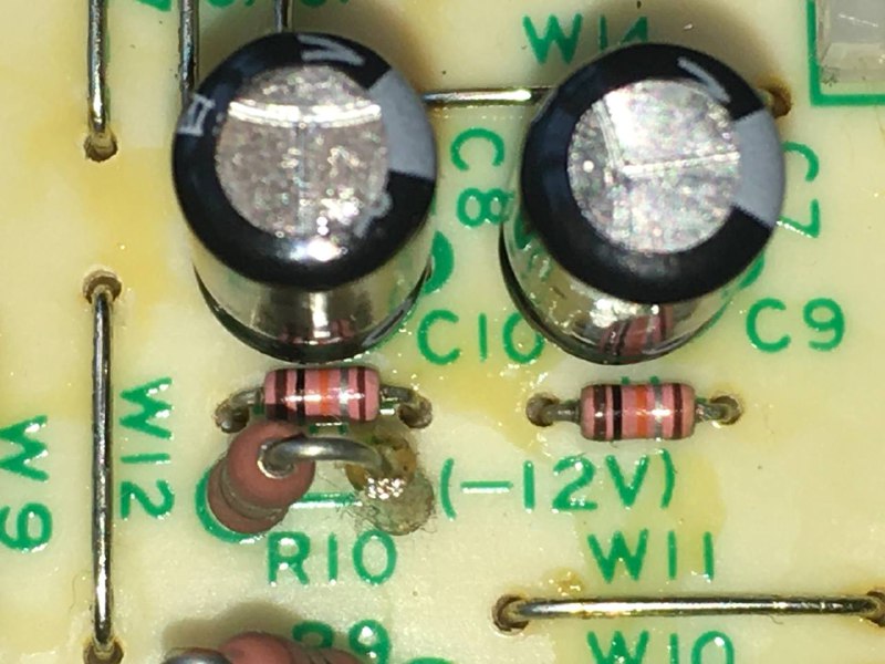

Taking it open I found this fried lead behind the op amp (see attachments mixer 1 and 2).
In the schematics, it's the lead right after U3's leg 6 (attachment monbusspcb).

After making a jumper repairing it, sound started coming trough the input channels, albeit quiet and when taken to overdrive, the clicking returned but at least with some sound (see video).
Tascam M-2516 problem - YouTube
I proceeded to cannibalize two op amp chips from the talkback replacing U2 and U3 IC's as well as replacing caps C7, C8, C104, C106, C204 and C206 with no change in the problem.

One detail that throws me off is that in the schematics C9 and C10 (decoupling caps?) look like small resistors (attachment, right below the electrolytics).
I've read there are resistor looking axial caps. What am I safe to replace them with? I'm not sure if I can find similar ones.
