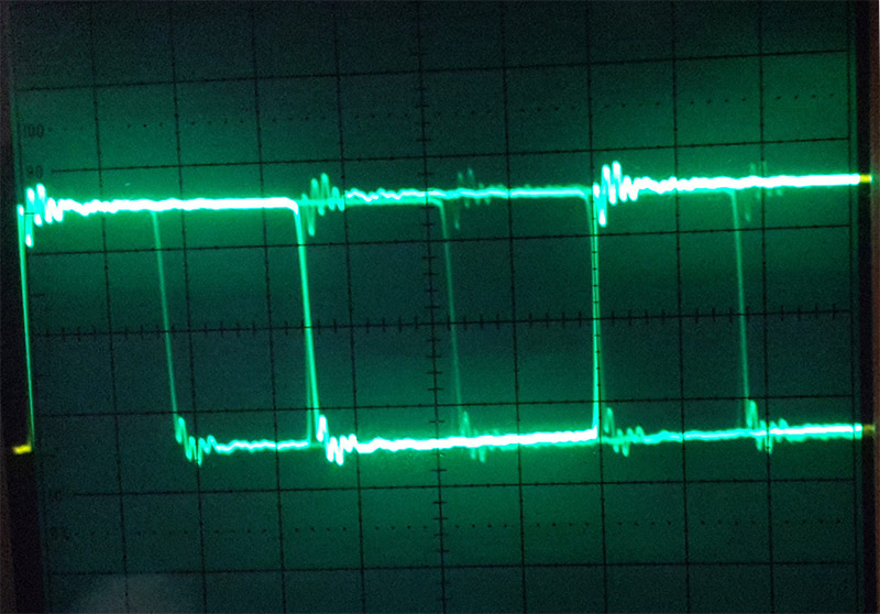

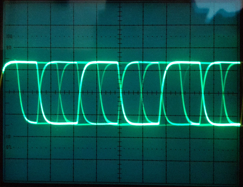

on a TASCAM CD-401 MkII here is what the S/PDIF looks like. It does sync flawlessly but I wonder if the signal's shark fin look can be, or even needs, to be improved. If for you guys rise/fall edges are just good enough I will not mess with the passive parts after the 74HC04.
Thanks!

Have you had a look at the different waves and mods shown at CD_transport_DIY
The TosLink one has no flat top and bottom, it's not that ugly Mine looks a bit less square that his screen captures because our scopes were not on same time/div.
As I have resistors, caps and transformer maybe I can try it... but the L just at the output of the 74HC04 makes me wonder, filtering noise? If yes, will the transformer will remove some?

by reflections you mean what kind of visible things? My other sources have faster rise/fall but show some ringing on the top/bottom. (all measure are with 75R load or the real load).
On this very CD player it's an inductance that slow it down, if I bypass it (it's just after the 74HC07) I get a more classic shape, with some light ringing. In fact each of the scope I've used... shows different ringing levels! Maybe even the scopes have hard times with square signal?

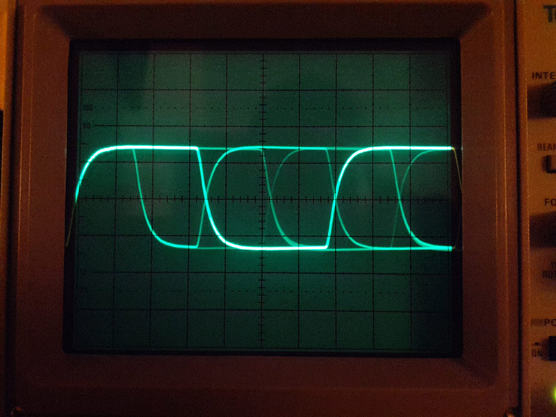

Here is my TEAC for comparison. Maybe you are right about leaving things as they are, they all sound and work well, I just wanted to know if there was any improvement possible where it seems to matters, jitter. And that galvanic isolation thing... the more I learn the more I see how much I don't know :'( But now I'm scared m TEAC's S/PDIF is not that great! =)

Yeah reflections are visible as either a non-continuous rise/fall - steps in other words, and perhaps steps on the tops/bottom of the waveform. But it depends on the time delay associated with the reflection - with a very short delay it could look just like ringing.
Your scope would need a low inductance earth connection for you to be sure of the shape of a fast waveform, a few cm of earth wire with fast edges can introduce ringing.
As the output is 'shaped' by an inductor, you could try reducing the value (try half) of that component and see if you get any audible improvement.

Ok I'll keep this one for the next time I open it then, don't have the service manual nor the L value and I'm lazy enough to keep your first advice of leaving it as is for now =)
Still will do that transformer output to see how it looks.

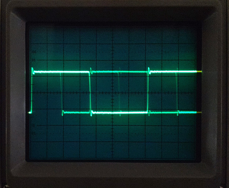

Tested that with the same source post #9, my TEAC player, but done with coax cables only (75R coax from source to a 75R on coax plug and 50R coax to scope). Not the same! Better measurement? (#9 was at the DAC's input and with a... decent chinese probe and its crocodile clip).
Measurements are also fine arts...
Tascam's passive, post logic IC, S/PDIF circuitry out, tiny pcb with cap/transformer/R divider in. No probe but full coax like done previous post to check it out.
That is square! And also isolated. Good enough!
