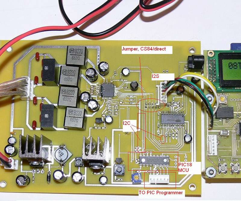

Running the programme on the PC would set the registers via -- whatever Interface!?. How does the PC connects to the board?
You need to study PIC, www.microchip.com
The source code is not for PC, for the micro 8bit CPU.
MCU is a fundamental to DIY full digital amplifier, to control TASxxxx I2C registers in amplifier itself.
Hmm, your picture says "to PIC programmer" on the connector. I was hoping a simple serial connection to a PC was sufficient to program the PIC? What kind of PIC programmer is necessary, or is it just a PC interface after all?
iampivot said:Hmm, your picture says "to PIC programmer" on the connector. I was hoping a simple serial connection to a PC was sufficient to program the PIC? What kind of PIC programmer is necessary, or is it just a PC interface after all?
http://www.microchip.com/stellent/idcplg?IdcService=SS_GET_PAGE&nodeId=1406&dDocName=en010046
I can not answer each question of PIC programming, how it works, how to install PIC C language, I/O registers, ADC, I2C, etc....
Those are off topic and same as writing whole book.
I used JackRabbit / AVR / PIC33 / PIC18 MCU, or Xilinx FPGA, TI C6713 DSP, nVidia GPU, for my DIY projects without any help. So anyone can DIY with some effort.

Hi, I added tools link what I'm using.

Now TAS5706 amplifier is playing great music from small board 🙂
I think TAS5706 can be final solution for Stereo Full digital Amplifier for DIY.
please see my website for detail, and hi res photos.
If anyone want to be group by manager, I can provide ExpressPCB CAD data. ( I don't want to be.. )
