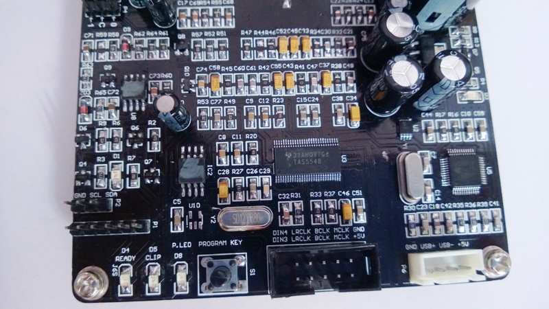

looking good. Can the 7 biquads per channel be used for digital crossover and/or eq. If not four spdif inputs, would be nice.
Also Power supply volume control sounds interesting. Will that part be supported in your design?
ok! customer can adjust the volume and EQ and limiter themselves by computer software, simaliar as TI EVM supported control console software.

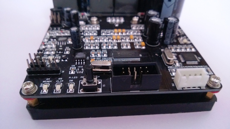

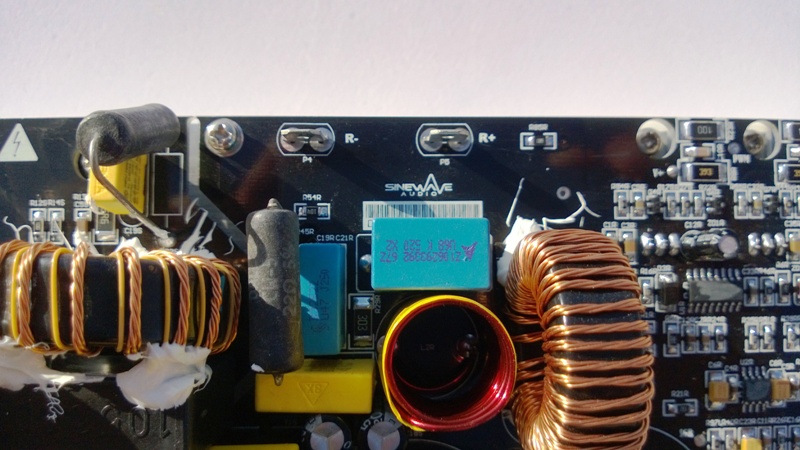

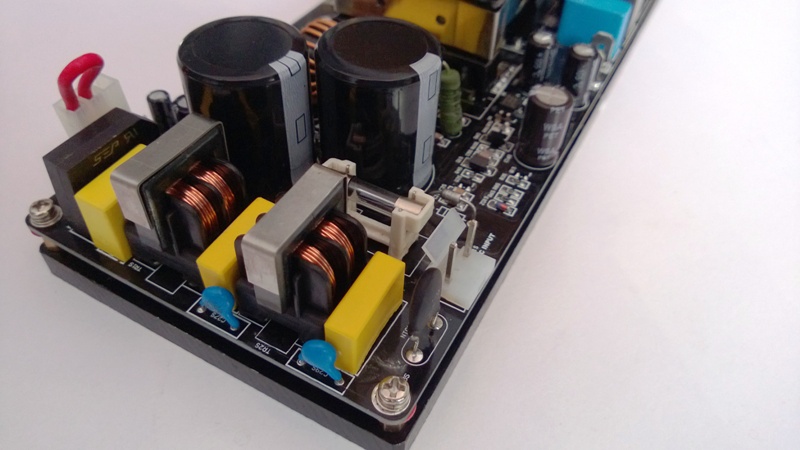

Genius200 (G300V21 board with TAS5613) Review
Recently I felt compelled to take another look at my Genius200 amp from Sinewave Audio, since I learned that Peachtree Audio's new Decco65 amplifier also uses the TAS5631 Class-D IC that is used in the Genius200 (though they have their own board with separate linear power supply and their component layout is different, appearing to be based on the TI reference evaluation board for the TAS5631). The Decco65 was reviewed well by Stereophile, so I thought, why not give the Genius200 another shot?
In the course of this narrative, I lost a channel on my regular Class-AB amplifier (which is a 200WPC unit into 4 ohms, 135W into 8 ohms), so with the Sinewave amp being the only other moderate to high power amplifier I have in house at present, I decided to hook it up directly to my Mark Levinson preamp and high-end DAC for some more serious listening than I had been doing before (where I had connected my CD player's output directly to the unit and using the front-mounted volume control). With the preamp in the chain, I set my Genius200 volume knob to full.
I have been critical of the Genius300 amplifier in the past for having a somewhat high noise floor - audible at the listening position through speakers of typical sensitivity. The Genius200 by comparison has slightly lower noise through ordinary speakers (I used a pair of Klipsch RB-25 mass-market bookshelf speakers for this test), but my speakers for listening are fairly beefy mini-monitors with low-ish sensitivity (~82 dB 1W/1m), due to the fact that their crossovers use full baffle step compensation. They are a DIY construction with a Tang Band W4-1720 underhung midbass driver and SEAS 22TAF/G tweeter, with a crossover designed in Jeff Bagby's PCD program and verified through measurements. Through these speakers, the noise level of the Genius200 was low enough that it receded into the noise floor of the room - barely perceptible. As I have said before, anything that Sinewave Audio can do to further reduce this noise floor would be beneficial to the product. While the feedback systems used by most class-D ICs are able to achieve high levels of power supply noise rejection, I don't think this feedback should be entirely relied upon to reduce PSU noise - it already has its hands full with lowering the distortion of the amplifier with an audio signal, without also having to clean up the power supply to the output devices.
My Genius200 came from the factory with a volume potentiometer that was noticeably mismatched between the left and right channels, with the right channel being louder, though at the maximum setting the mismatch became negligible. This made it difficult to use my Genius200 with sources like smartphones, laptops, or PCs, because I would need to run their digital volume controls at low levels, not helping the noise floor issue. Where I work, however, we had evaluated an older Sinewave Genius300 amplifier, but after testing it had begun to emit a strange smell from its PSU, so we had called it dead and put it on our shelf. I was able to take the ALPS 50KAX2 potentiometer and PC board assembly from the older Genius300 and swap it for the one in my Genius200, which corrected my issue. It would be good for Sinewave to test the fully assembled Genius amplifiers to make sure this volume mismatch doesn't exist, though I think they do test the amp modules thoroughly. I should further note that even though the Genius300 sample unit at my work started emitting the distinctive 'burning transistor smell', my own Genius200 unit has been trouble-free.
Moving on to the sound of the Genius200 unit, I can report that I think I like the sound of the unit better now than I did when I first purchased it. It is a very different animal from my mosfet-based class-AB amplifier, with a tonal balance that is more neutral to cool, while my class-AB amp (Hafler 9270) was neutral to warm by comparison. The Genius200 is based upon the Texas Instruments TAS5613 PurePath HD amplifier IC, which is a quad-half-bridge design where two half-bridges are strapped together to form a full bridge for each channel, operating at 65W into 8 ohms at 1% THD, or 125W into 4 ohms at 1% THD. The 150WPC rating of the IC is based on a 10% THD figure, which I would consider unacceptable from any type of amp, so I prefer to consider the TAS5613 (and by extension the Genius200) as a 125WPC amplifier. This still gives the unit a combined output of 250W. I have read that the TAS5613 is considered to be a better-sounding IC than the TAS5630 on which the larger Sinewave Genius300 amp is based, and I can confirm this. If you need big power on the cheap, consider the Genius300 (with TAS5630), but if the most nuanced presentation is your priority, then choose the Genius200 (with TAS5613).
I found the Genius200 to provide an excellent level of detail, pulling lots of information out of any recording I gave it, though I settled on three recordings for my critical listening: Jennifer Warnes' The Hunter, Sera Una Noche's La Segunda, and Richard Page's Shelter Me. While I will say the Genius200 is not the most transparent amplifier I have heard, it certainly might be the most transparent IC-based class-D amplifier I have heard (among amps based on ICs from Tripath and ST Micro). I have heard ICEpower amps sound marginally better (with fuller, weightier images and warmer tonal balance), but I have not heard any Hypex-based amps. Imaging from the Genius200 was very good, with accurate and repeatable placement of instruments and singers, particularly near the center of the image, though I felt the image was not as sharply defined at the extremes of left and right. Soundstaging was fairly deep (and with the Sera Una Noche album, very wide and spacious as well, with good decay of reverb), but images were placed behind the speakers rather than in front of them, and they were not as palpable as I have heard from my Class-AB amp.
As I said above, sonic detail was very present, and I got a strong impression of clarity and speed. The famous class-D bass presentation was in full effect, with the small woofers in my mini-monitors staying well controlled even though they throbbed mightily to deliver impactful bass. I think one benefit to ordering the Genius200 is that the same power supply is used for the G300V21 amp module with the 300WPC TAS5630 or the 150WPC TAS5613, so the power supply is under lighter demand from the TAS5613 chip and it can deliver plenty of current into the load. My speakers are 4-ohm speakers, so I could be sure they were under the control of the full available 125W of power from this amplifier. Even though bass was furiously controlled, it still had weight and richness that helped keep things satisfying, especially on the Richard Page album (which straddles R&B, blues, and jazz - think of him as a male Tracy Chapman) where the bass guitar and kick drum seemed to energize the entire room from the tiny 4.5" midwoofers of my mini-monitors - a surprising feat that I've only heard from this amplifier.
Throughout my listening, I didn't notice any artifacts (such as HF hash or midrange glare) that would detract or distract from my listening enjoyment, even though I have heard these from other IC-based class-D amplifiers. The Genius200 kept up well with elevated volumes and energetic program material. Only when I played extremely harmonically complex material from the Finnish orchestral band Nightwish's latest Imaginaerum album did the amp seem to begin having trouble with midrange coherence, seeming to start presenting a wall of sonic energy, but occasionally sonic details did arise over the melange of heavily distorted metal guitars, and the bass remained tight and fast. It's possible that what I was hearing was just the very matter-of-fact, un-sweetened sound of this amp when applied to my favorite metal recordings. I should reiterate - there are no sweeteners in this amp, just a very straightforward, detailed, and controlled presentation. Amps like these are an indication that class-D (and particularly affordable IC-based class-D) amps are finally beginning to rise to the levels of performance demanded by commodity high-end. These IC-based amps are becoming very good.
To conclude, I think I may have been overly and unfairly critical of the Sinewave Genius amps in the past, but the time I have been spending with the Genius200 lately has begun to change my opinion for the better. I think there are still things that Sinewave can do (and hopefully has done with the new G300V30 module design) to improve the performance of this amp, mainly through lowering the noise floor and being more careful about unit-to-unit consistency, but if you lack the funds for a more expensive amp then there's definitely no reason to shy away from the Genius200 amp. It is an excellent value.

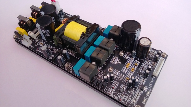

G300VV31 V2.0 UPDATE
Long time testing , G300v31 boards are manufacturing now.latest version is v2.0 now
two chip version TAS5613A and TAS5630B
TAS5630B version specifictions:
1. full 400W rms power out one module.
2. Half bridge LLC power supply .
3.Shield output inductor and very few influence to radio.
4. 2channel output:
2x200W/4ohm@0.5%THD+N
2X300W/4ohm@10%THD+N
5. 1channel output:
1X400W/2ohm@1%THD+N
6. Balance signal input.
7. Every channel work status indictor
8.Clip signal indicator
9.110v or 230V ac supply
10. AC supply fuse on board
11.8mm thickness aluminum plate heatsink, 2X3mm assembling hole support.
TAS5613A version specifictions:same board as TAS5630B
1. full 400W rms power out one module (@3ohm loder).
4. 2channel output:
2x120W/4ohm@0.5%THD+N
2X150W/4ohm@10%THD+N
5. 1channel output:
1X250W/2ohm@1%THD+N
