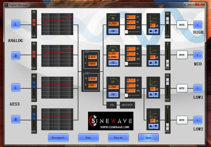

What is the specification of this one?
upload specifications pics just now, pls check .
The colour figure shows a 3-way design, 4 outputs. Is this one of the options? What is the spec in this configuration?
Dmp1250 use out1 (HIGH) and out3(LOW1), xover frequency can set easily at HP Filter ad LP filter cell.
post one demo pics of dmp1250 here.

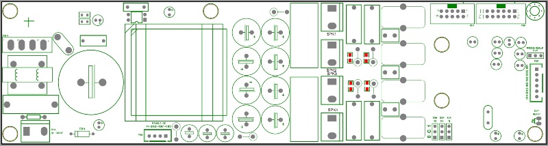

we developed new g300 series hi-fi board, integrated tas5630 4ch mode and wide range smps and dsp unit. testing now.
This is very interesting! Is this a "board only" version of your Genius33D amp? Will it also be able to do 2.1 setup? And will it have optical input directly to DSP? Price?
Thank you for your message here, this board named 'G300DD',dsp process and tas5630 class D amp and FLB SMPS, ,some functions like G33d board, accepted digital IIS signal and analog signal, it can be set as 4ch/2.1ch/2BTL/1PBTL , it is our unique amp with single chip 4ch amp module.if connect optical, you have to convert it as IIS format.

G300DD digital port have I2S format digital audio input and output functions, one digital input and one digital output ,it is easier to make it as your idea mode. one board for sub the other for 2BTL, analog or digital signal input support ,audio signal input one board( 2BTL ), then digital signal output to other board .

G300DD board size same as G300v21, assembling hole position same too.
G300DD first version debugging pics attached here.
if no other problems, we will finish one batch before 20th June.
about price, 120usd/pcs for diyaudio member, 2pcs one order at least.not include freight.
