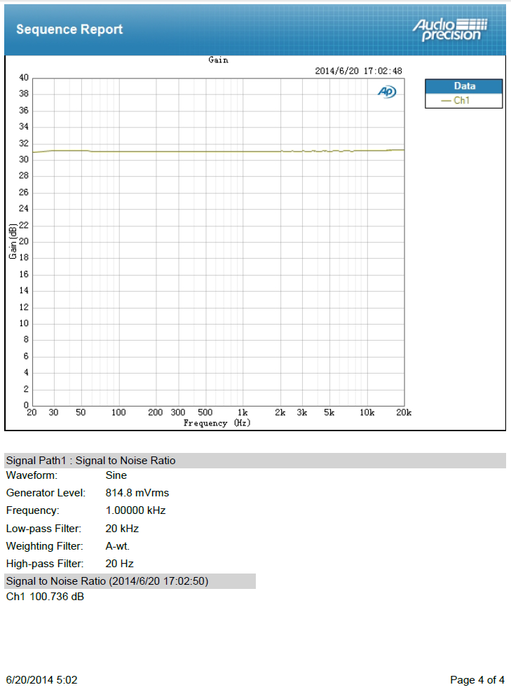

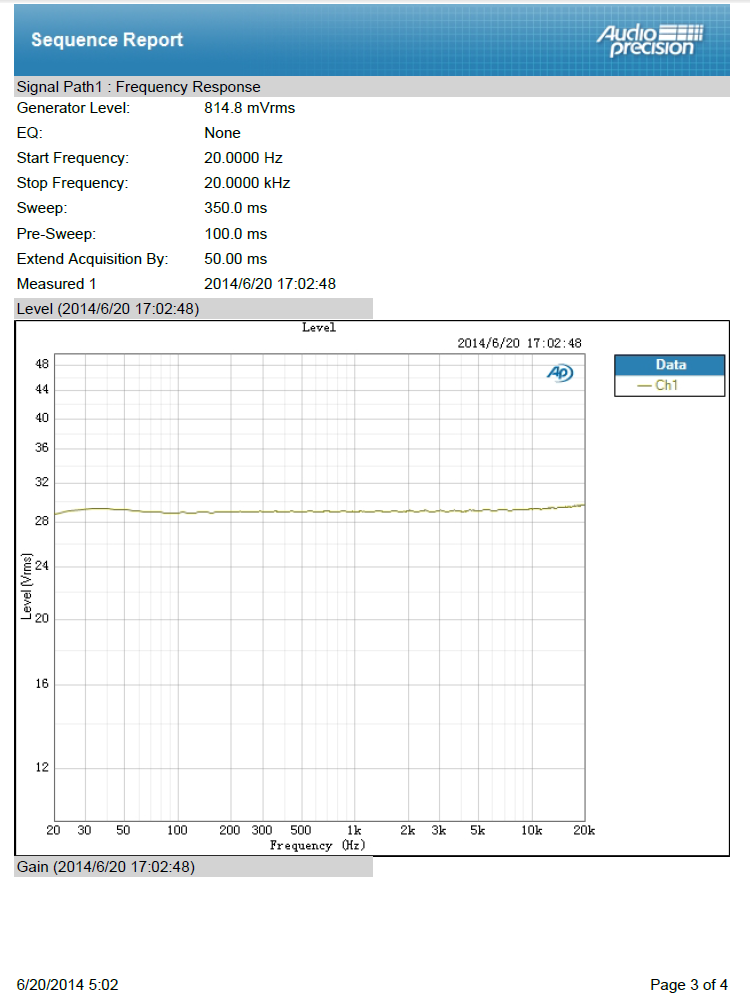

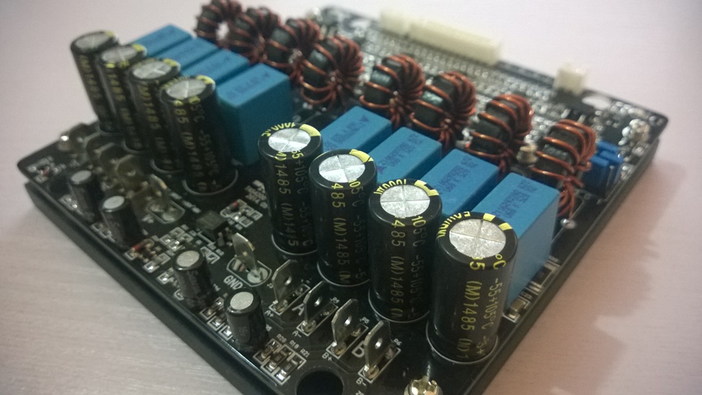

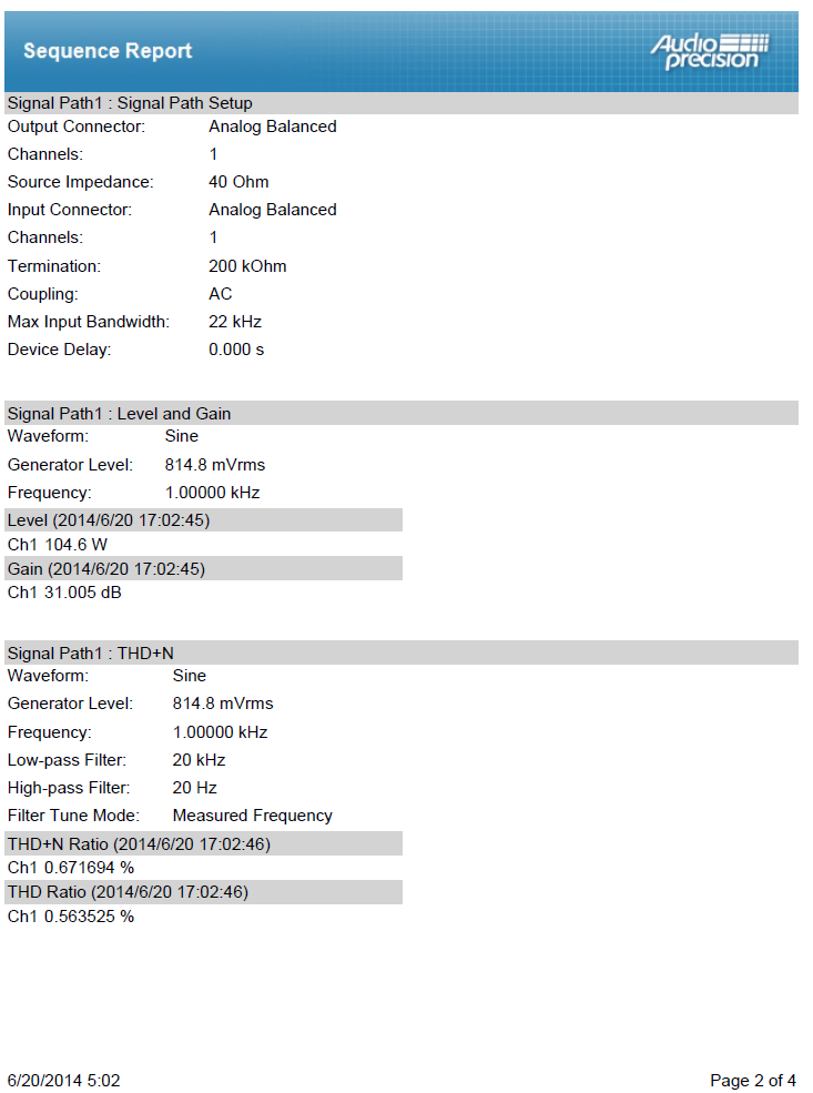

TAS4200 4 CHANNEL MODULE HAVE VERY GOOD S/N
Hello!Everyone,
Thanks for your concern!
This four channel module have new 4 balance input version now, attach some photos and AP test result here.
this module have very good Signal to Noise Ratio, above 100dB, sound should very clear now.
Some addtional circuit to make tas chip more stable than orginal version.
Hello!Everyone,
