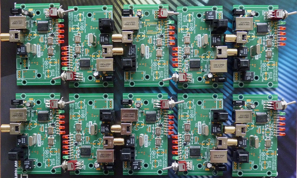

Converters are ready. 🙂
Special version for ncsound user in preparation.

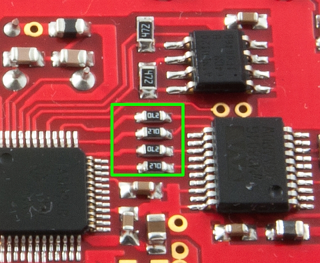

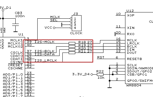

Part of schematic and PCB with marked I2S bus.
You can remove resistor R18,R19,R20,R21 a then connect own DAC chip with I2S bus.
Or you can leave them and connect DAC to TAS1020B then DAC and WM8804 will be work parallel.
