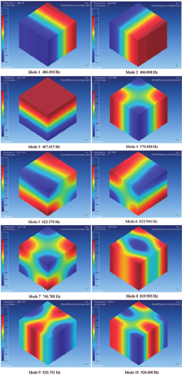

I think you got it but there is not only one spot where nulls/boost occurs, there is many located throughout the whole volume of room.
If the room is a perfect shoebox and walls are infinetly rigide then it's simple to model. In practice it's not that easy and can deviate from model as rooms have rarely a perfect shape and walls/building techniques can be effective membrane absorbers ( it's commonly used by acousticians to offer a degree of low freq absorbtion as well as sound isolation: dual leaf technique with plasterboard/limp membrane/plasterboard 'sandwich' and decoupling from other walls, floor and ceilling... a mouthfull isn't it 😉 ).
In fact rather than spot those are area where modes occurs.

It's not a vid but gaves an idea of distribution in space of modes: there is 4 family of them, longitudinal, tangential, in height and oblique in a room. It makes for a bunch of them to take care... 16 iirc.
Another with animation ( great site to grasp the basics in a visual manner imho):
https://blog.soton.ac.uk/soundwaves/standing-waves/5-room-modes/
