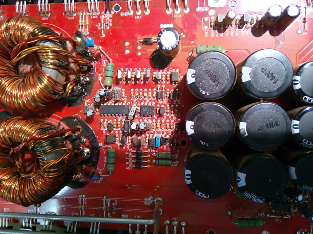

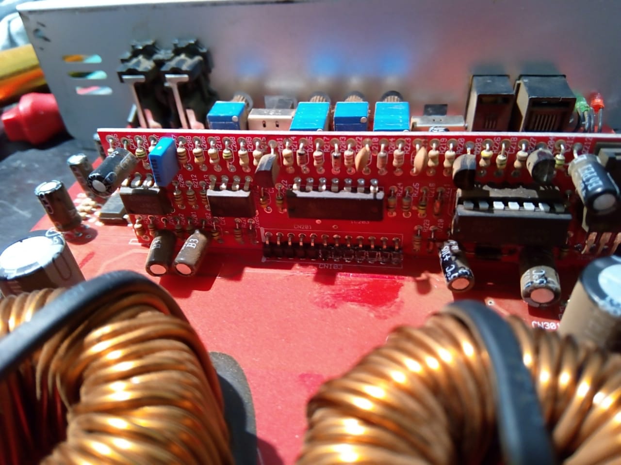

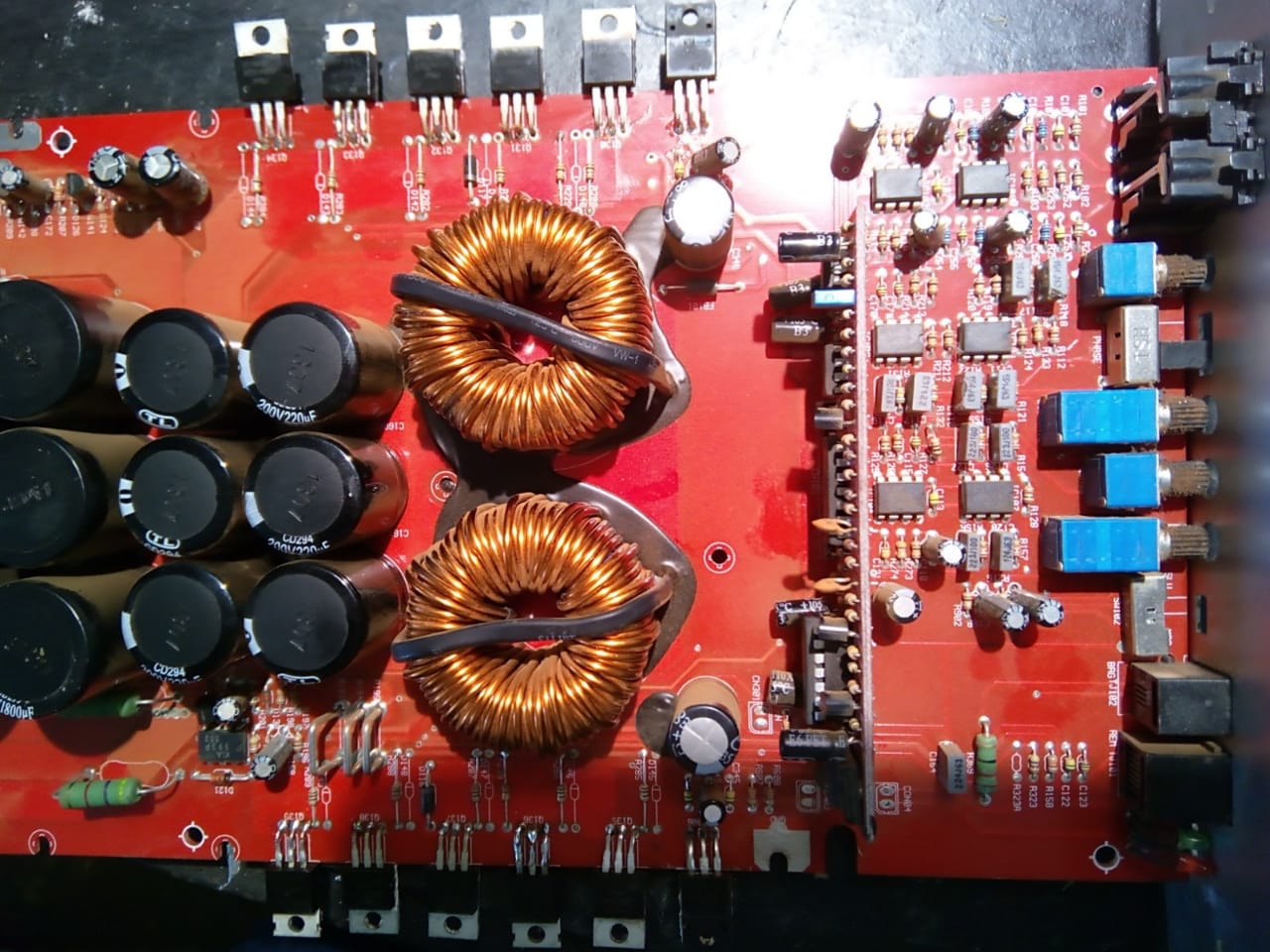

Some pics of the board

Sorry my bad had black probe on positive rail, black probe on negative I get 0.6v on SD that doesn't change when it mutes. Amp powers up red protect led then goes to green. when the input voltage goes over 13.2 the power supply remains on and producing rail volatges, the green light remains on it just loses output and rail to rail oscillation above 13.2v
Reduce the input Voltage back to 13.2 or below, rail to rail oscillation starts again and amp produces audio
