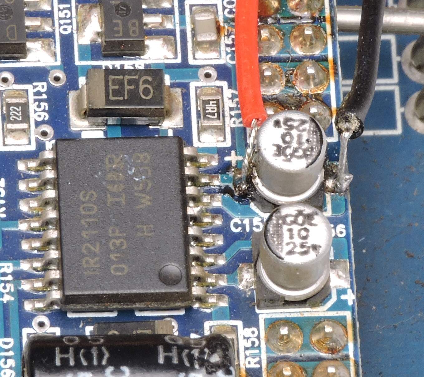

Without the FETs, the high-side has no supply voltage. I use a 9v battery to supply the high-side. The following shows it connected across the cap (different amp) that's connected to the VB and VS terminals. You'll have to find the best points to connect it on your amp.
