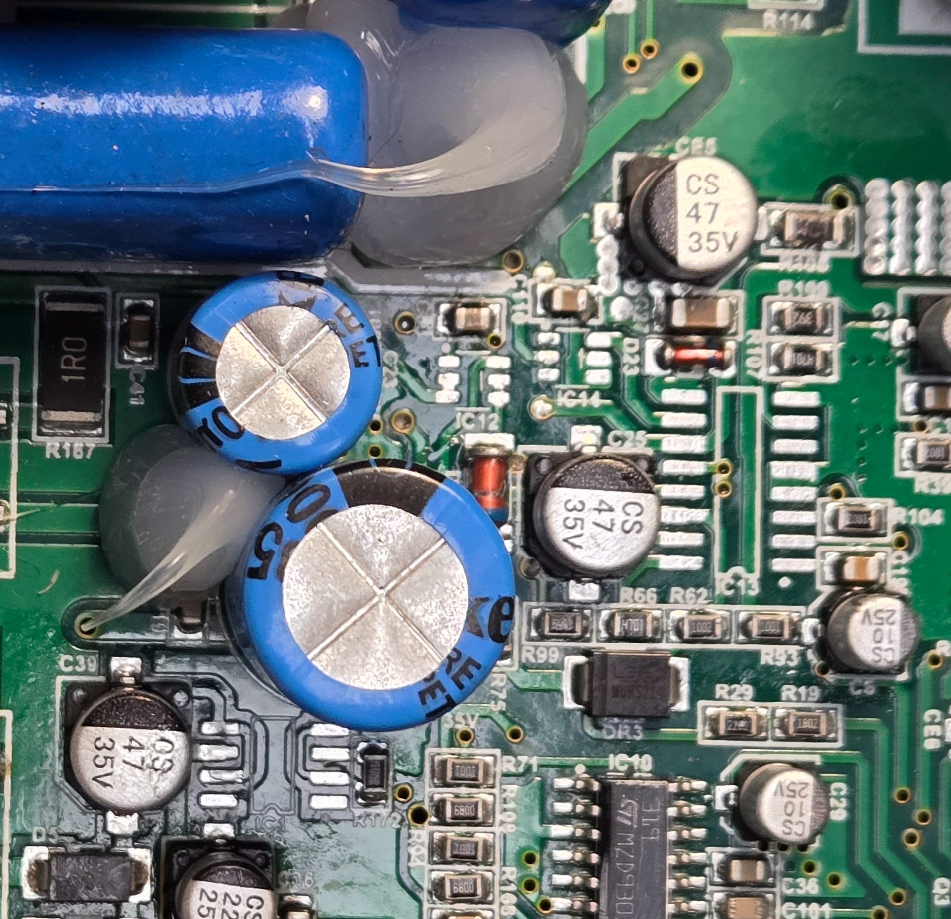

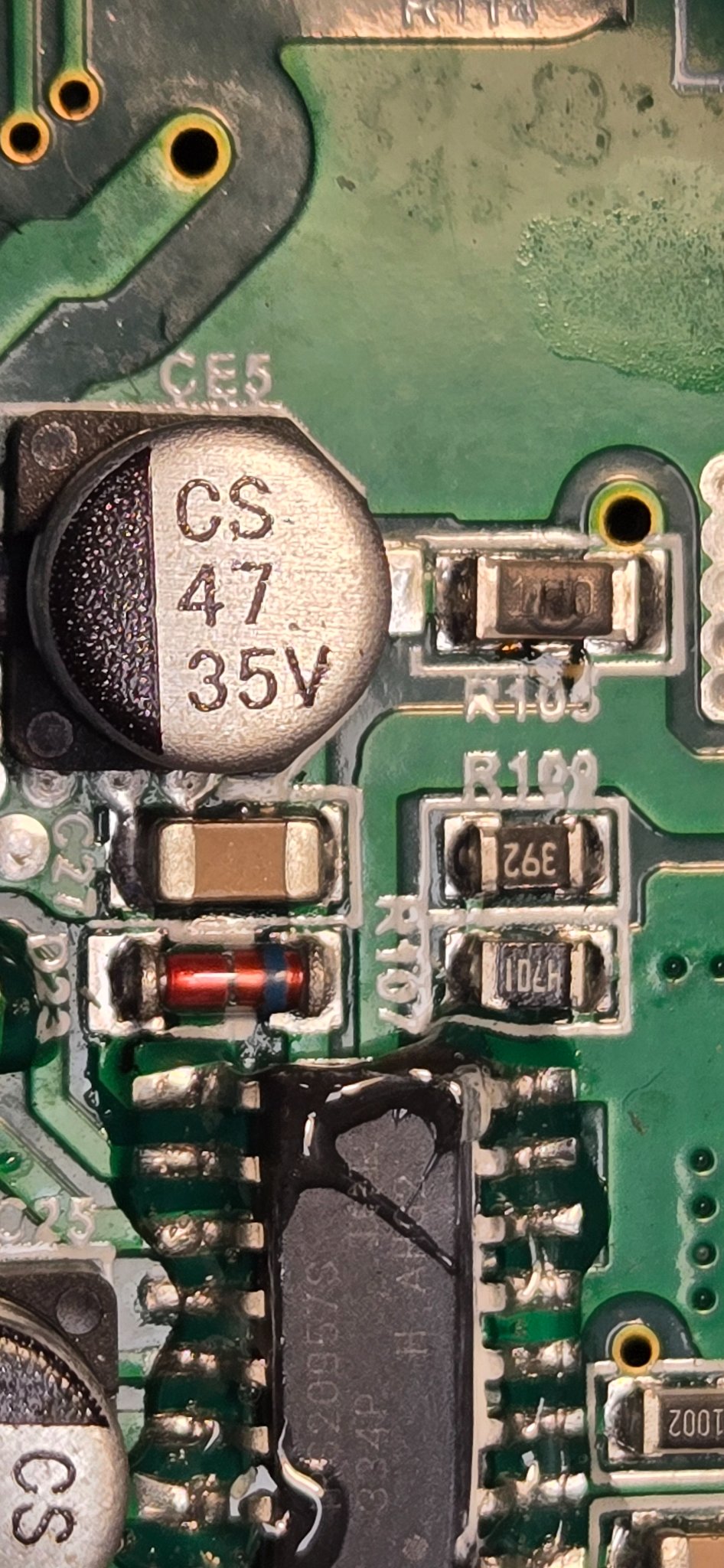

Anyone happen to know what diode was in place at location D6? It was completely melted out of the amp when I got it. The MJD32C burned the pad up pretty good.
Thanks in advance!

Posssibly:
https://www.diodes.com/datasheet/download/US1M.pdf
You could email Taramps to get a definitive answer.

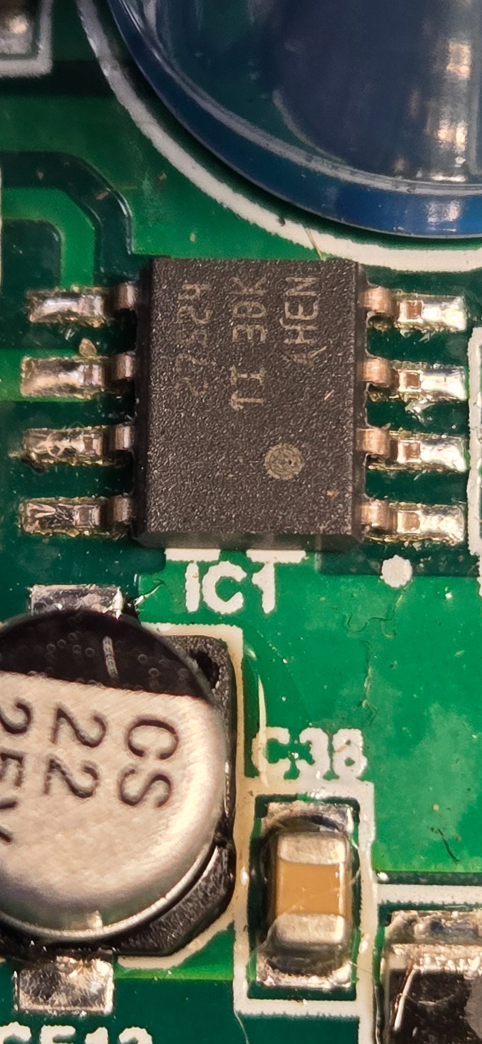

Did IC1 fail as well?

Ok, I'll try messaging them.
The original problem, a wire strand grounded an output transistor tab to the case.
I'm not certain about IC1. I still have a short between gate and source of all the output pads on one side of the amp. I removed IC12, 13, and 14 and now IC 1. The short is still there. Also R105 is smoked. I think it is supposed to be 1 ohm.

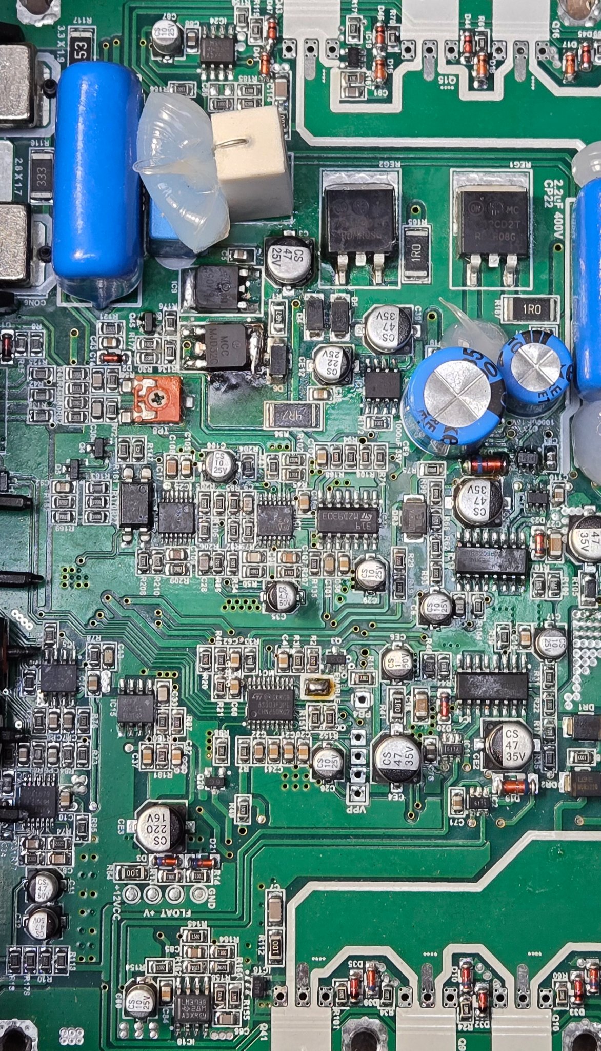

Good afternoon,
Ok. Current condition of this amp. Repopulated everything damaged that I've found so far. Including replacing all the damaged diodes, resistors and zeners in the bad channel. Everything matches the other side.
IC1 seems OK. Output side has nice 7v square waves. Where do those go? Couldn't find them elsewhere....
The power supply transistors. I do get switching. They seem to be ok, just removed to not have the rail voltage. All output transistors are removed.

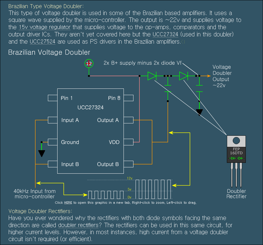

With remote applied, the fans turn on momentarily. Both IR20957S have 10.3v on pin 1, nothing on Pin 2, Pin 3 has switching, Pin 10 has 0.00v and Pin 14 has 4.50v.
Is there a way to get them to send drive to the output gate pads? Should I just put in the power supply transistors?

Good day sir. It's definitely boosting the square wave between 2 to 7 and 4 to 5. There are currently no outputs or ps transistors in circuit.

Those are the supply terminals and need voltage for the IC to function. They all have different reference points, the reason for the placement of the black probe.
4-2 should be above 70% of the 4-1 voltage. It could be low because the high-side is in UVLO (under voltage lockout). Are both ICs at approximately the same voltage 13-15?
