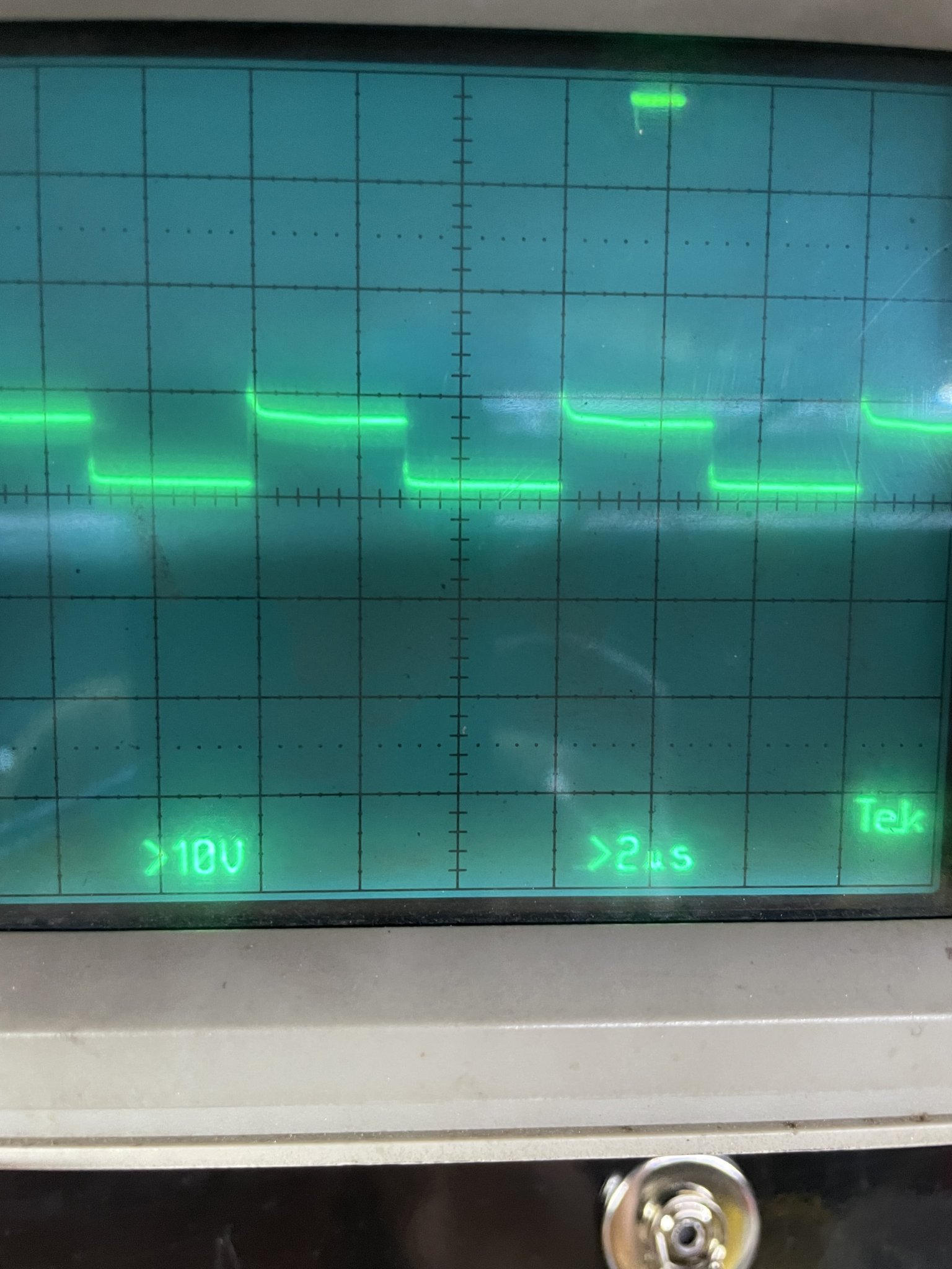

The output from the ucc27524 is also 40khz at appx 9vdc peak to peak, 5.3vrms

The output of the IC should swing the full supply voltage minus about 1/10 of a volt.
Is the IC heating up?
Do you have the same square wave amplitude on each side of the cap in series with the output of the IC?

The IC output does swing appx supply voltage . Attached is the IC output with 11.9-12vdc supply voltage.
