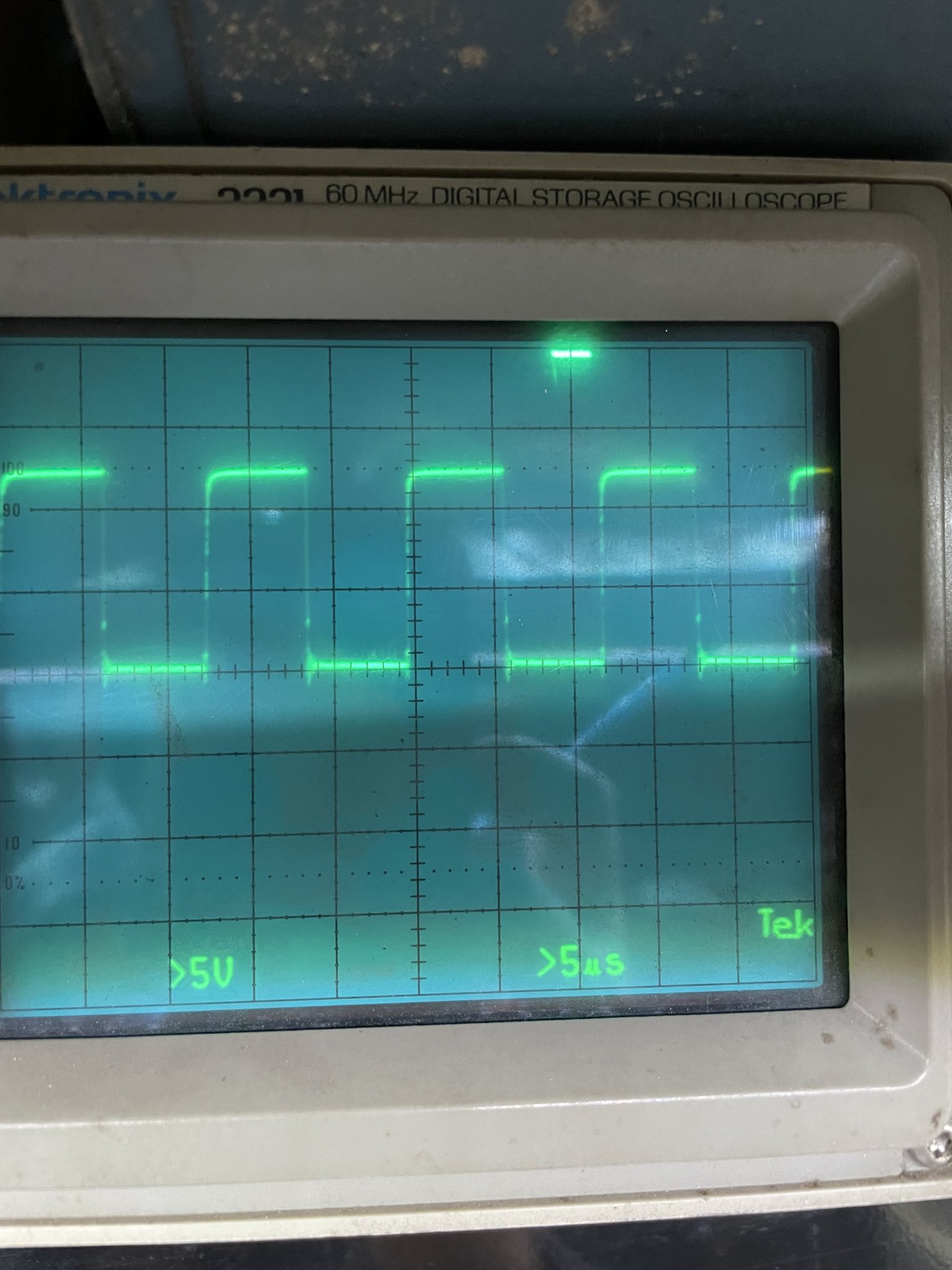

Hello, can someone help me identify why my power supply drive looks like this?
It looks the same all the way back to the MC1 but just with a lower voltage pre-drive buffer.
Rail voltage is too high, 204vdc. Amp comes on with blue light only but no drive on the outputs.
The drive buffer ucc27524 is verified good.
The duty cycle is rolled back as far as it can be. The 204v isn't far off.

I accidentally discovered I can get a nice 20khz ps drive wave if I drop the supply voltage to appx 9.6v. It will hold the drive wave until I increase the input voltage to appx 11.3v. This doesn’t change the behavior of the output section.

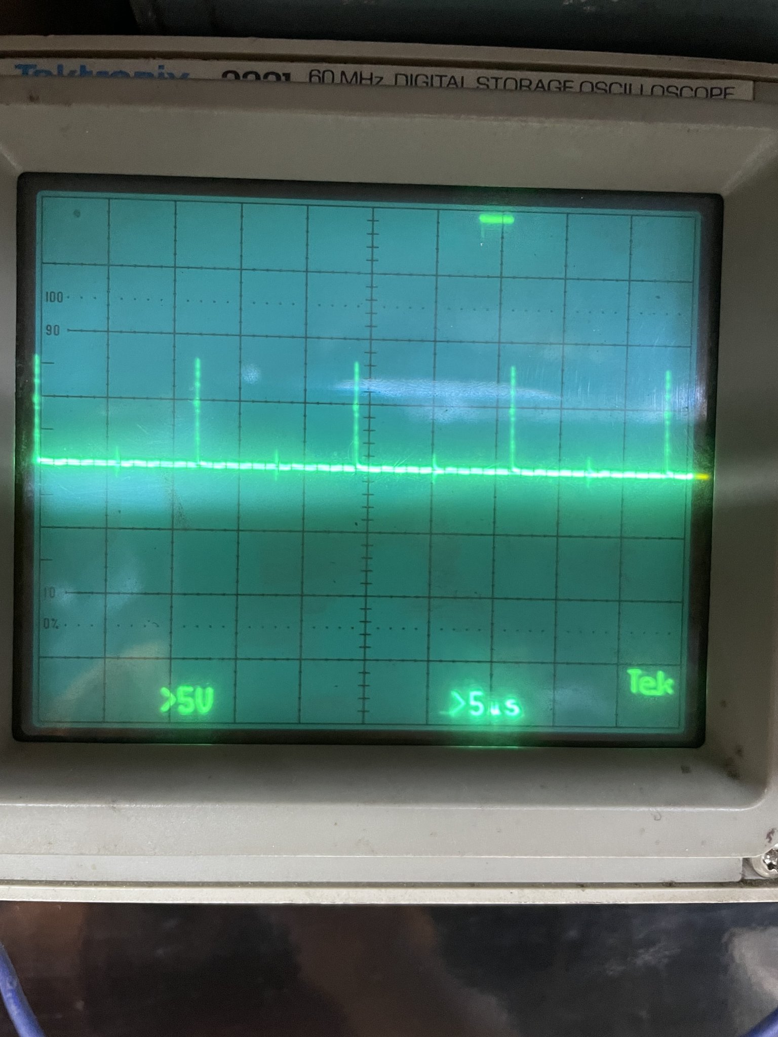

So this amp is still giving me fits. Lots of test time but I have dc offset issues.
I can adjust it down within 3mv or so of 0vdc, however, it fluctuates with or without a load connected.
Once I power off and on it may be as much as 200mv off.
The input voltage seems to have a significant effect on the dc offset as well. For example if I set it to 0mv with 13vdc input to the amp, it may be +-60mv at 12vdc.
There also seems to be excessive noise(slightly more than normal) on the output terminals.

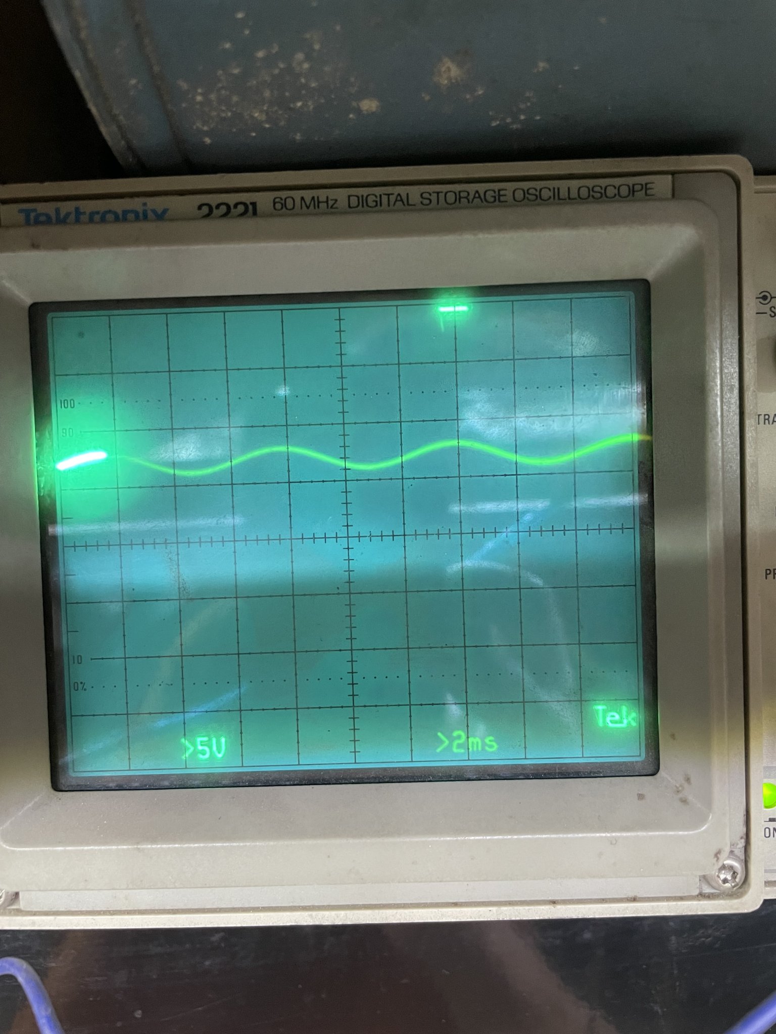

At 12.0v there is 16.4vdc at the reg input, and lots of noise on the output.
At 13v, there is 18.4-18.6 fluctuating and the noise is significantly reduced

no I found a bad zener at location D21. Replacing this stabilized the regulator voltage at 15v, however, I still have erratic dc offset and a lot of noise.
