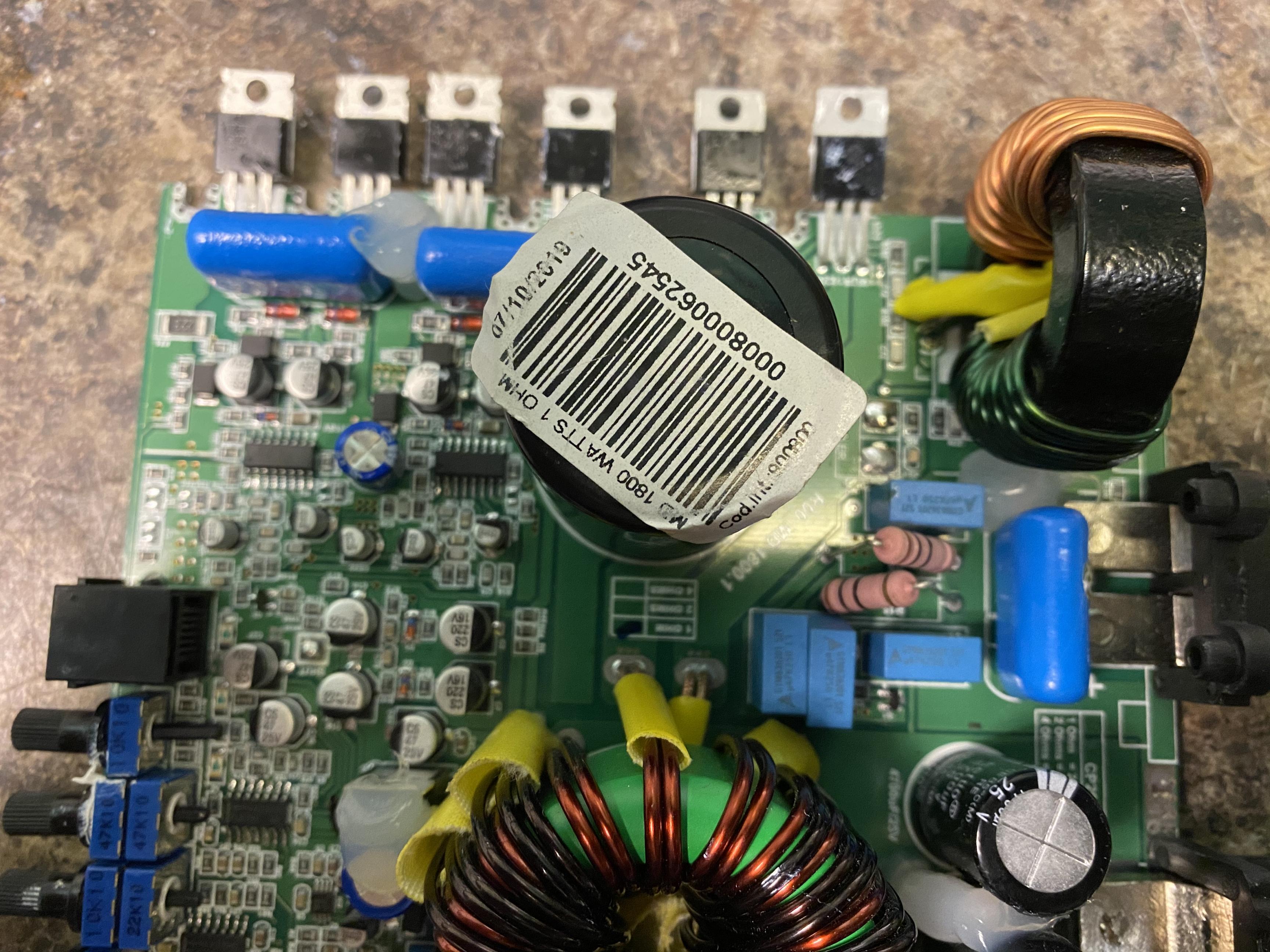

Taramps MD1800.1
Anyone know what diode they use in the remote turn on circuit ?
It’s directly connected to the remote terminal

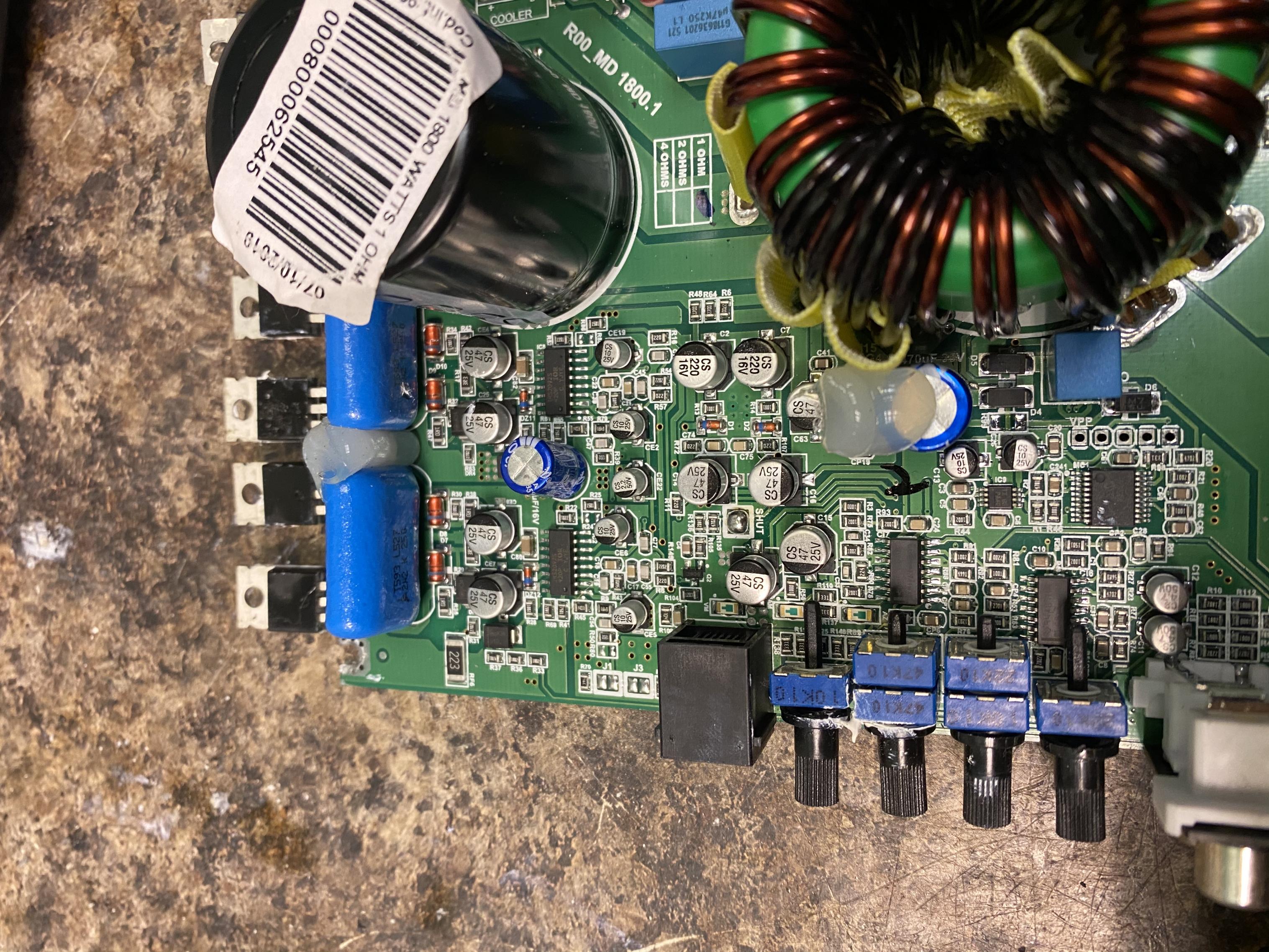

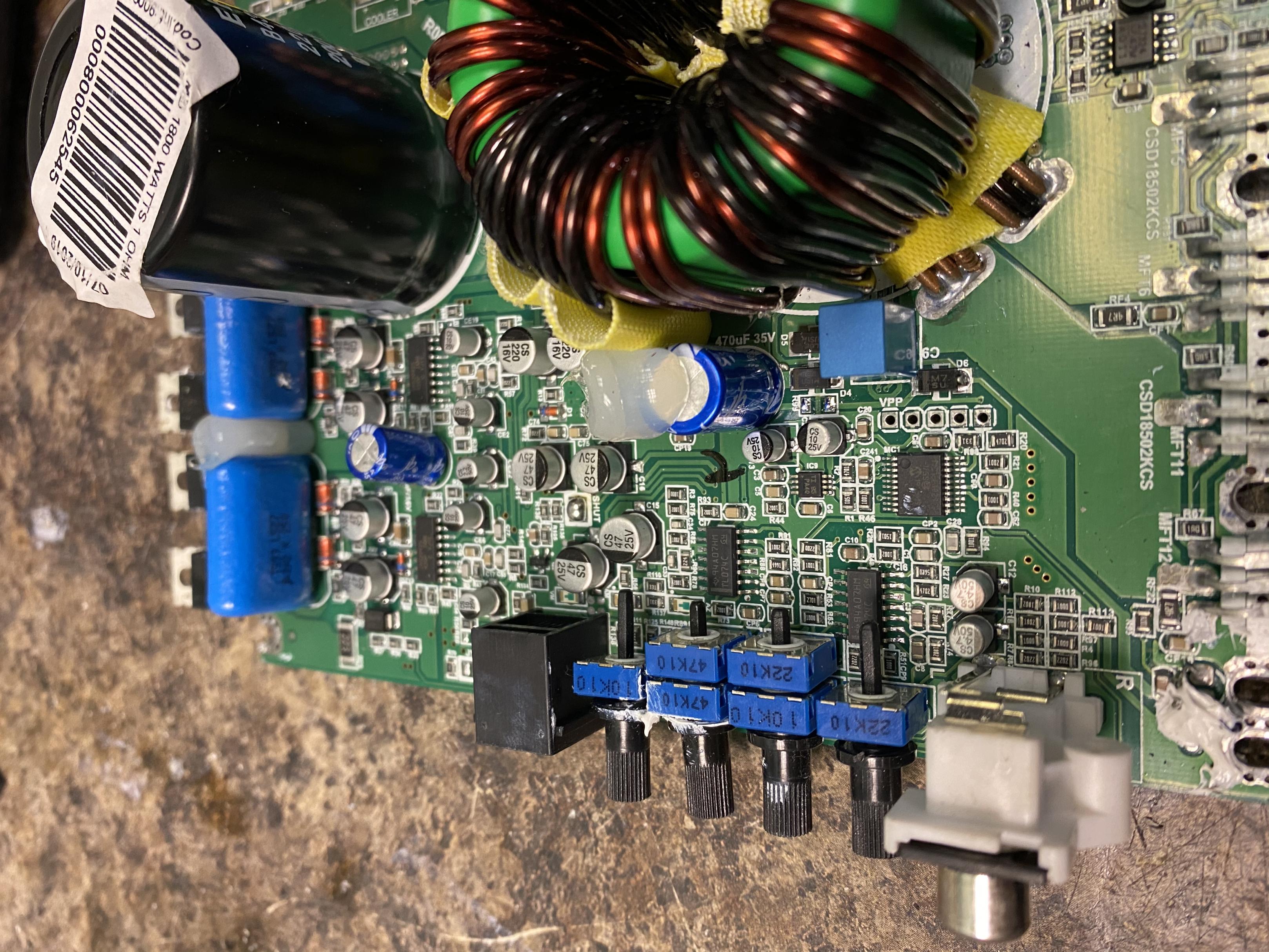

Replaced the diode and amp still doesn’t power up .
I’m not getting any voltage on the gate legs for the fets .
Only thing I see is Q1 marked 6CW and the gate driver ic .
Would posting the voltages on the gate driver ic help determine if it’s defective or not ?
Here are some pics let me know if you need more
So it was received as repaired before? I believe it was 4r7 1206 resistor which is missing.
If no one can help today (i am not in my shop and dont have any of schematics) - I can tomorrow check for schematics from a similar series amplifier.
But it should be an easy job with multimeter - IC9 should receive Bat+ voltage on pin 1,2 to produce regulated +5Vdc at pin 8.
If IC9 is bad and shorted, it can damage its input feeding resistor. Again - check with multimeter backwards from pin1 if its not connected to that resistor.
