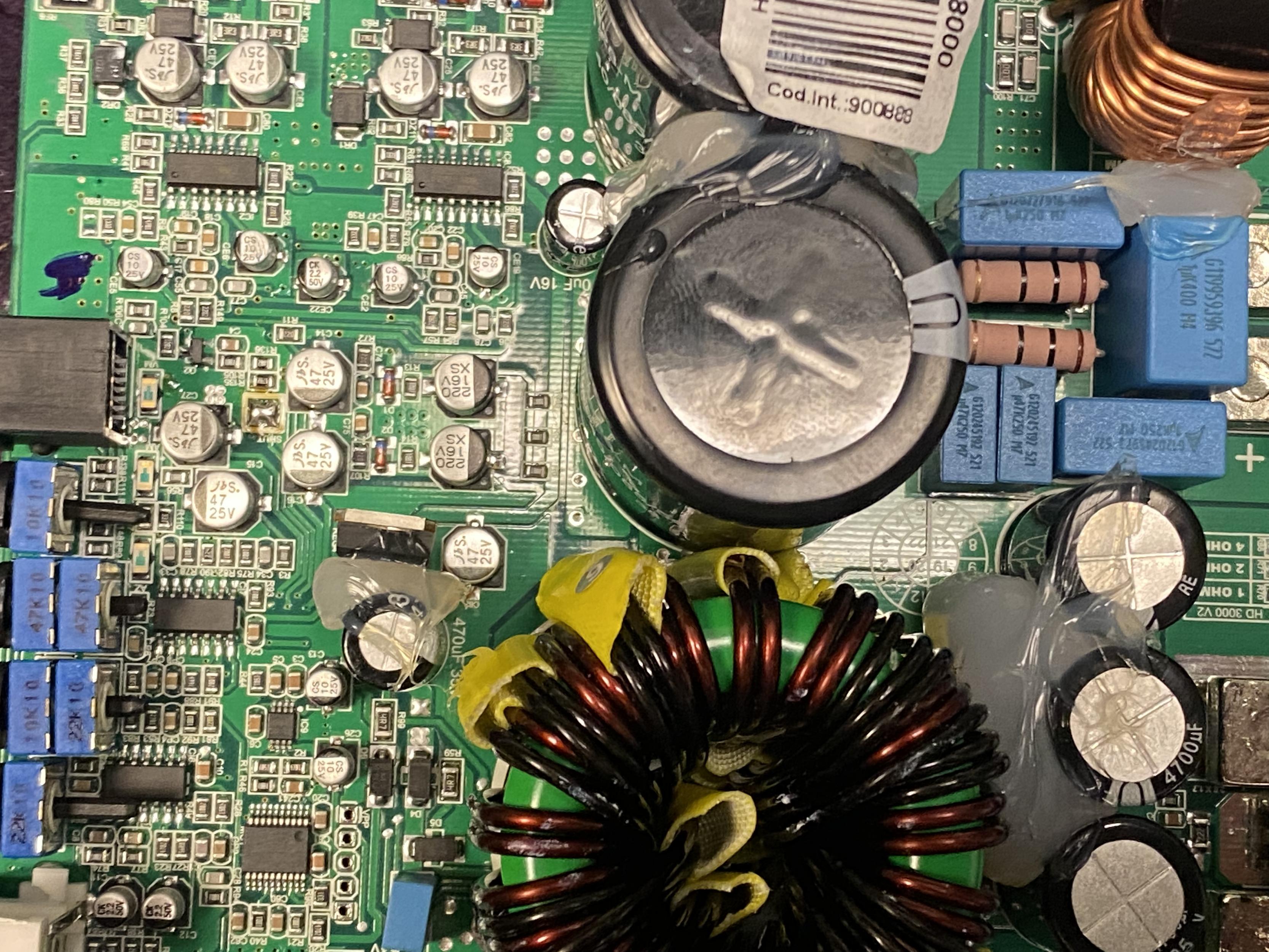

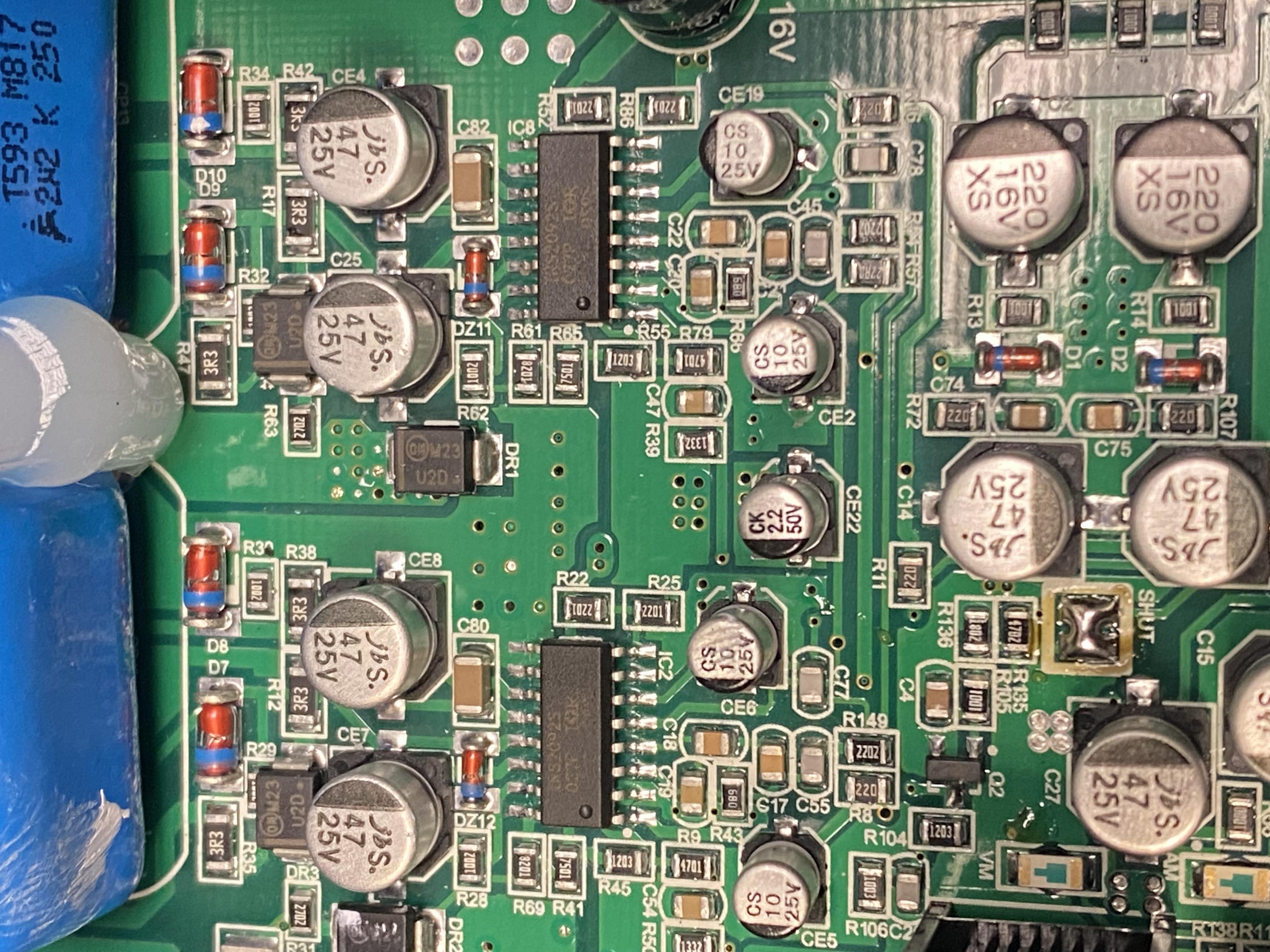

Are you sure you dont have any open 3R3 resistors at the output stages ?
I will ask for the schematic of this version
All 3r3 resistors test fine off board .
R6,64 test fine off board
D1,D2 also test fine off board I replaced them to be sure
Same issue amp protects and I get dc voltage across speaker terminals
What is the voltage on R98/C61 when the amp is shutting down ?
Are R33, R36, R37 within tolerance?
R98
1 side :0.00
Other side :0.00
Measured directly across cap :0.00
C61
1 side:0.00
Other side :0.00
R33,36,37 all are within tolorance
1 side :0.00
Other side :0.00
C61
1 side:0.00
Other side :0.00
When amp powers up both sides are at 111.2 volts
When amp protects the voltages drops slowly to 0.00 volts on both sides
R37 sees rail voltage along with R36 and R33 reduce voltage to form a voltage divider along with R40. +111.2 rail voltage means your power supply is set at around 13.5V, and that is correct.
Do you confirm that when the amp is playing music and when it protects there is no voltage change in R98?
Yes 13.5 volts
The amp will not play audio since it almost instantly protects and there is 30 volts measured directly across speaker terminals
