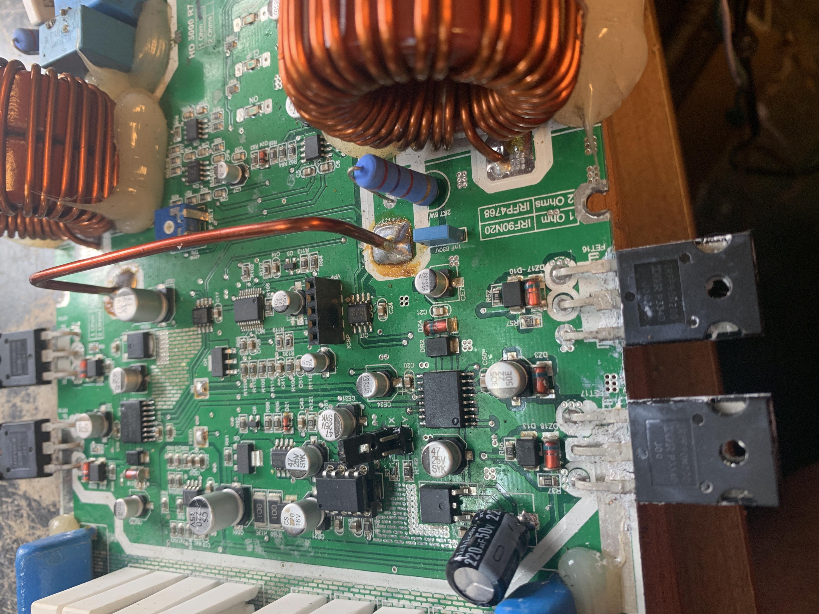

I have a Taramps HD 5000 that has one of the output mosfets heating up a little more than the other three. There are a total of four output mosfets (IRFP90N20D).
It has two independent output inductors and they are using IR2010s driver ICs to drive the mosfets. Both sides are identical so I was camparing one side to the other and I found some differences in the voltages on the mosfet heating up versus the one in the same position that is not heating up.
The one that is heating up I have voltages as follows:
Gate 81.5
Drain 153.1
Source 81.8
The one that is not heating up I get the following:
Gate 75.0
Drain 153.2
Source 75.0
Across the speaker terminals I gat a voltage of -1.748
From positive speaker terminal to ground I get 75 volts
From negative speaker terminal to ground I get 76.9 volts
I was wondering what might cause this one mosfet heat up and have different voltages.
In the picture I have attached the mosfet that is warming up is located in the bottom left of the picture.

The voltages don't match. The source of the high-side FET connects to the output. The source voltage has to match the output voltage.
Was this with the amp connected to a load?
Have you tried to swap the FETs to see if the problem followed the FET or with the location?
