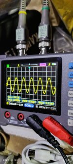

I'm going to attach the board back to the heatsink and test with the speakers and an input 1K sine wave.
Sorry about the delay Perry took more time putting the amp together and getting the input than I thought.

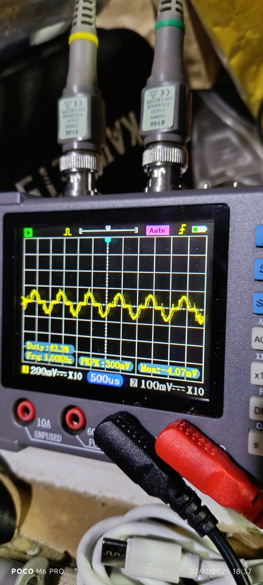

In the attach image those 2 resistor has the signal input on them. On the side that's coming from the op-amp is the nice looking 1K sine wave, but on the side going to the IC is the weird looking sine wave.
Also channels 1 and 3 has a loud popping sound periodically. But no sound and on the terminals that the speakers are connected to there's no voltage.
The distortion isn't unexpected. When the IC is functioning normally, there may be absolutely no audio visible there unless the IC is driven into clipping.

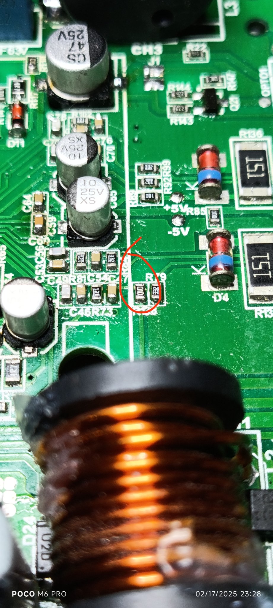

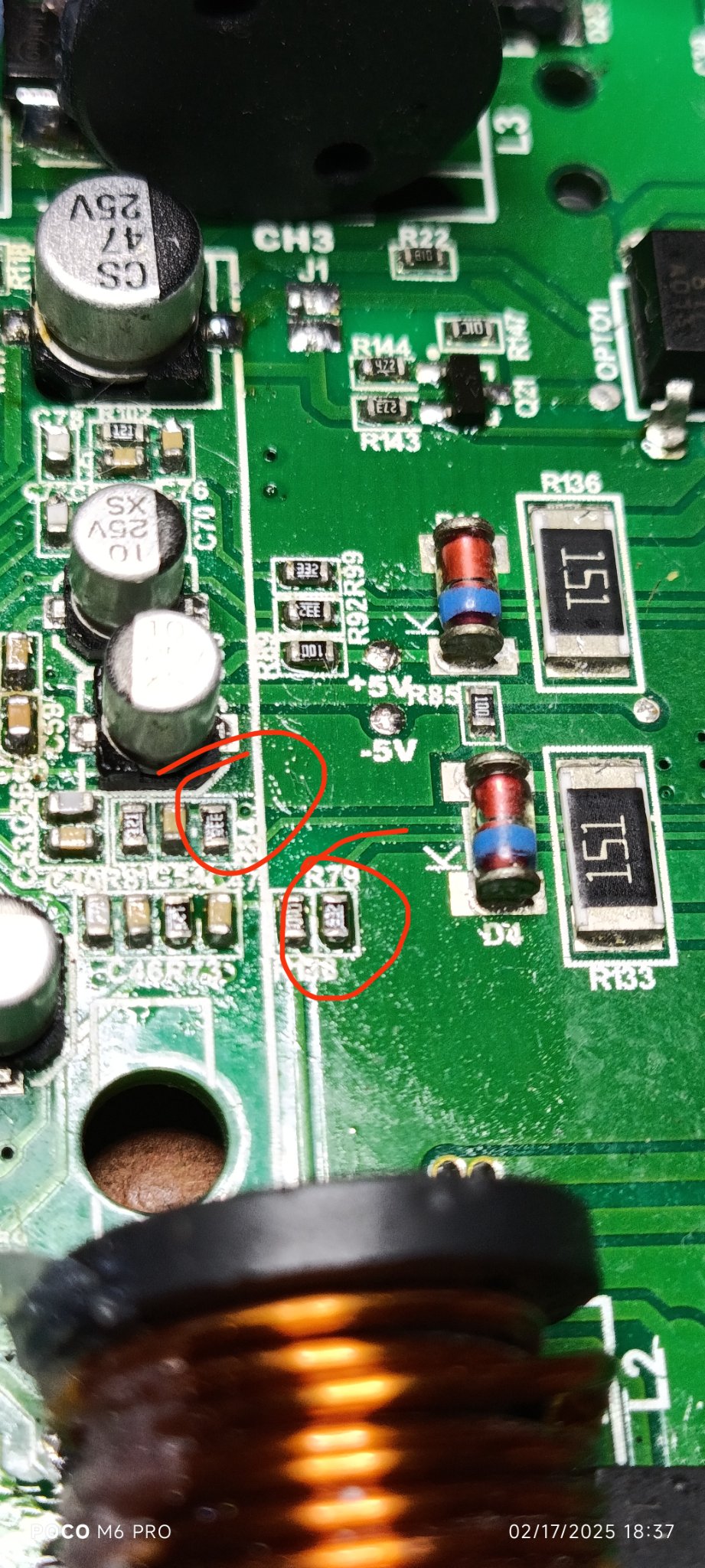

This resistor 01D, which is a 100K, it measures the 100K or close to but then drops back down to like 70K and then goes back up again. Also the CSD what voltage should it be exactly?
That resistor is connected to the op-amp output on the top side, which also goes off to the ceramic cap on the left. Then the other side goes off to one of the pins on The IC.

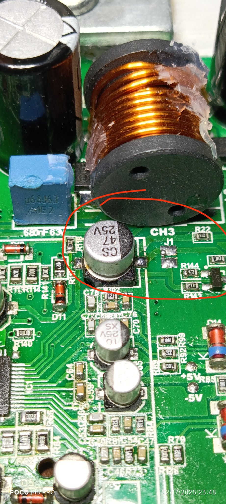

Circled is what's connected to PIN 48 when the empty pads are shorted there's no CSD voltage.
How would know if the protection is coming from the IC or external? Because the amp is still on when the pads are shorted. With the IC de-soldering the amp LED comes on for a bit and then goes out, but it's also trying to pull more than 1 amp.
