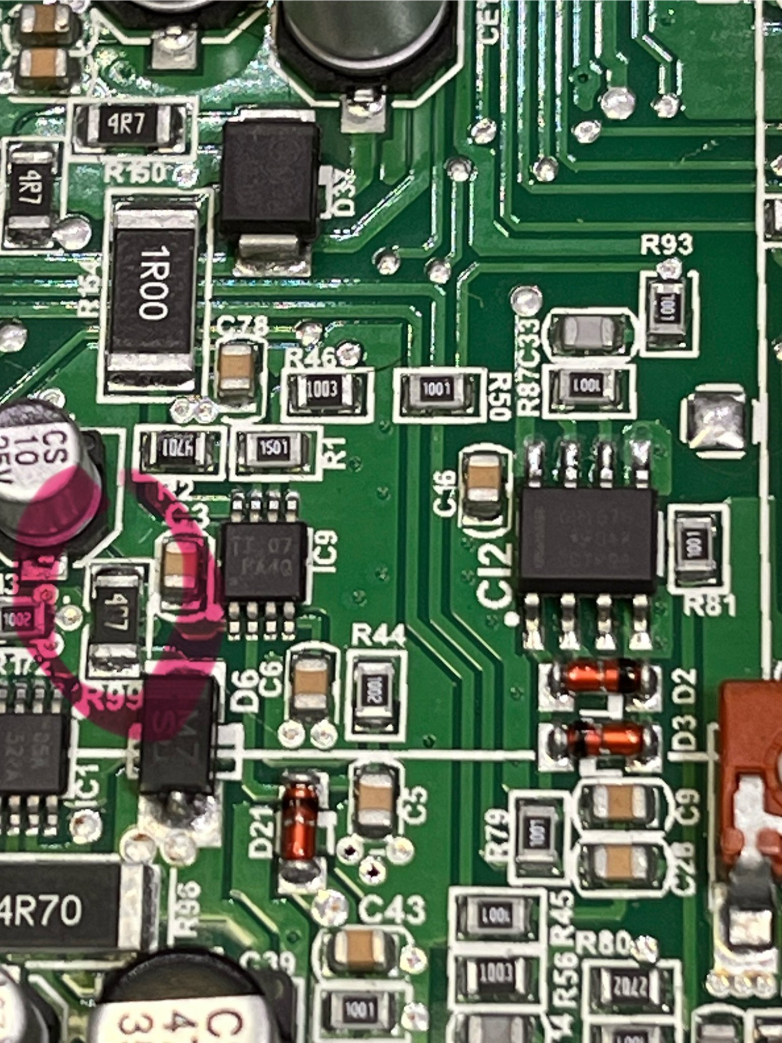

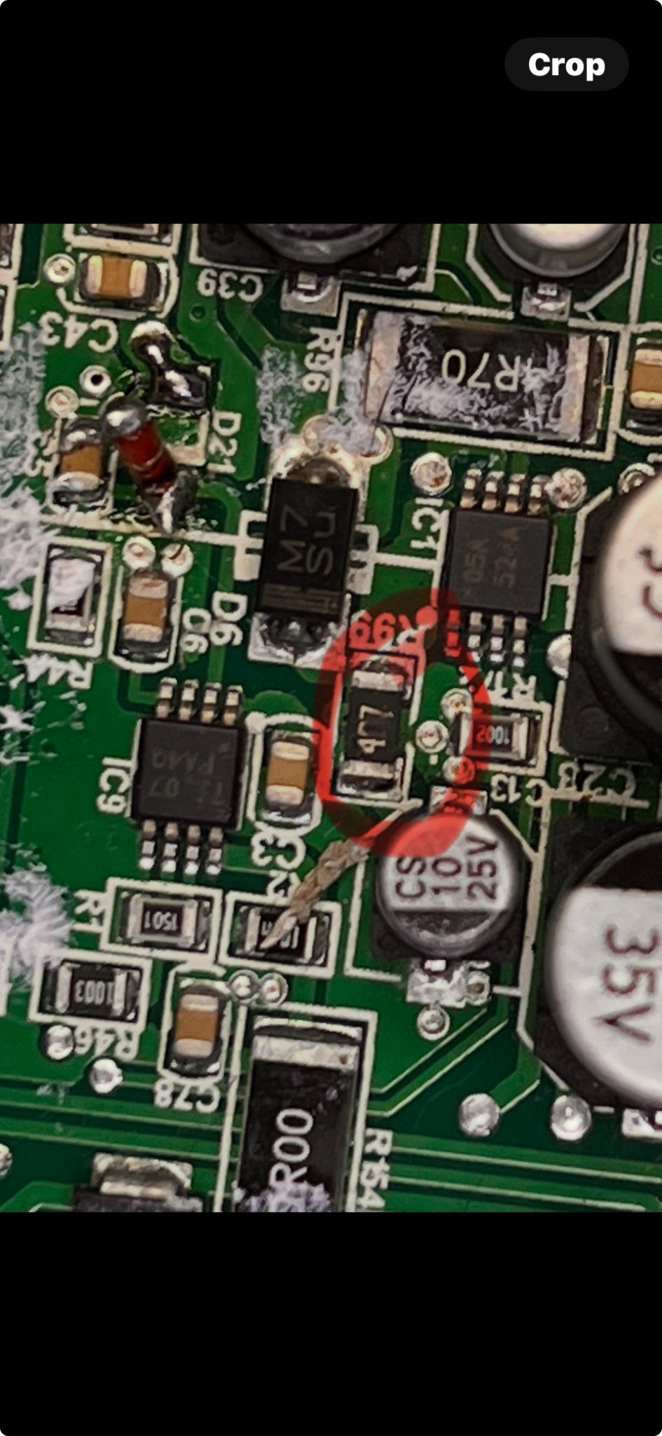

Hello, my question is what is the part number of those ICs (IC1, IC9), they are shorted and the 4.7 resistor (R99) is open, could someone guide me to put a replacement? Thanks

You can also contact Taramps directly. They have a number on their website that you can use for help with repairing their amps. Just ensure you have the model, serial number, and board version on hand. Sometimes if the amp is still under warranty they will ship the parts free of charge. From my experience with the MD *k which I think you are repairing 99% of the time when IC( goes) you will also need to change the MCU. I remember when I had a fault like yours the guy from Taramps told me that I would also need to change the MCU. he said if memory is correct that IC9 is for under voltage and when that IC blows you will need to change the MCU.
