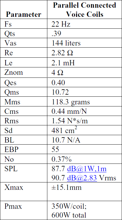

I would also like to use one of the Shiva 12" drivers that I have on hand. I took the Hornresp parameters supplied by Don and hopefully updated the information for the Shiva driver correctly.
I am primarily looking for bass extension to the low 30Hz range. I believe that this design gives me 30Hz - 80Hz ±3dB.
I would appreciate any comments or suggestions. I would especially like to hear if I have missed something.

Moving the mouth should be okay - doesn't look like the path lengths change much at all, so you're likely to get away with it.
Might be worth double-checking what happens if you enable Lossy Le on Hornresp - drivers with lots of Xmax and high inductance are often more accurately simulated with Lossy Le (or semi-inductance, if you've got the additional data) in place.

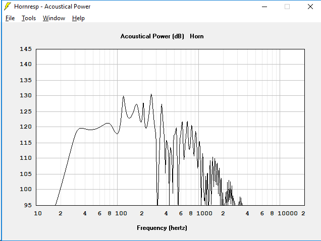

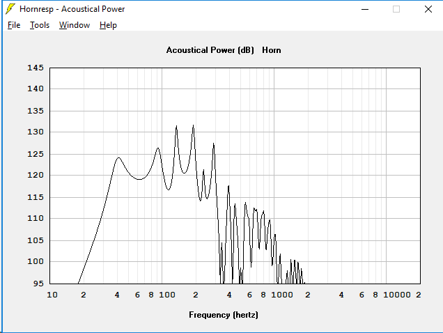

Another 12" Driver
That response curve suggests that particular driver does not really want to be mounted in a TH.
Hi Brian,
I have seen the first 12" driver used and the results are reported to be good. Is this speaker also not the best choice for a TH? The graph looks very similar to the Shiva graph to me, but I am not sure what difference I am looking for.
The second image is the Beyma 12LX60. Am I correct that this driver is a better fit for a TH?
Thanks for your help.
