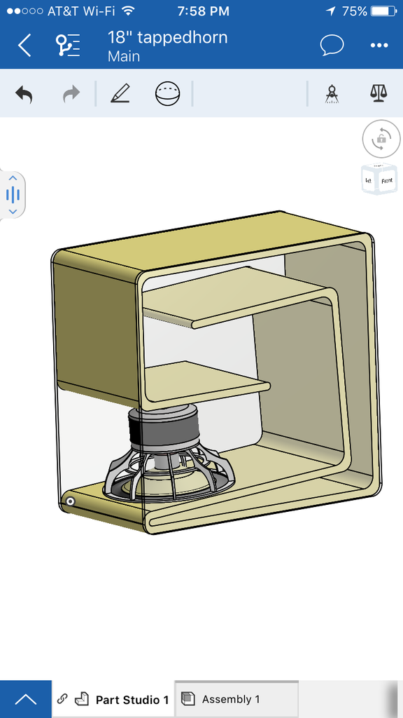

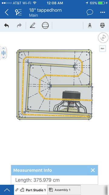

I have made a 3d model of a tapped horn / tapped pipe where the different variables for throat / mouth and length can be changed and it will redraw itself to the new parameters automatically. This is a part of a set of subs that I plan to build, but I think that the idea of it, the 3d model that you can plug numbers into is a good idea for the community to have, and would like to have some people try it out to see if it's something worth doing more of.
Link to model
DISCLAIMERS: (please read)
The model is made in Onshape. You need to signup for a free account to edit the model, but there is not software to install it's all in browser, unless you plan to use a mobile device. Then there are apps for that (mobile is a better UX actually, I used my phone to make the model.)

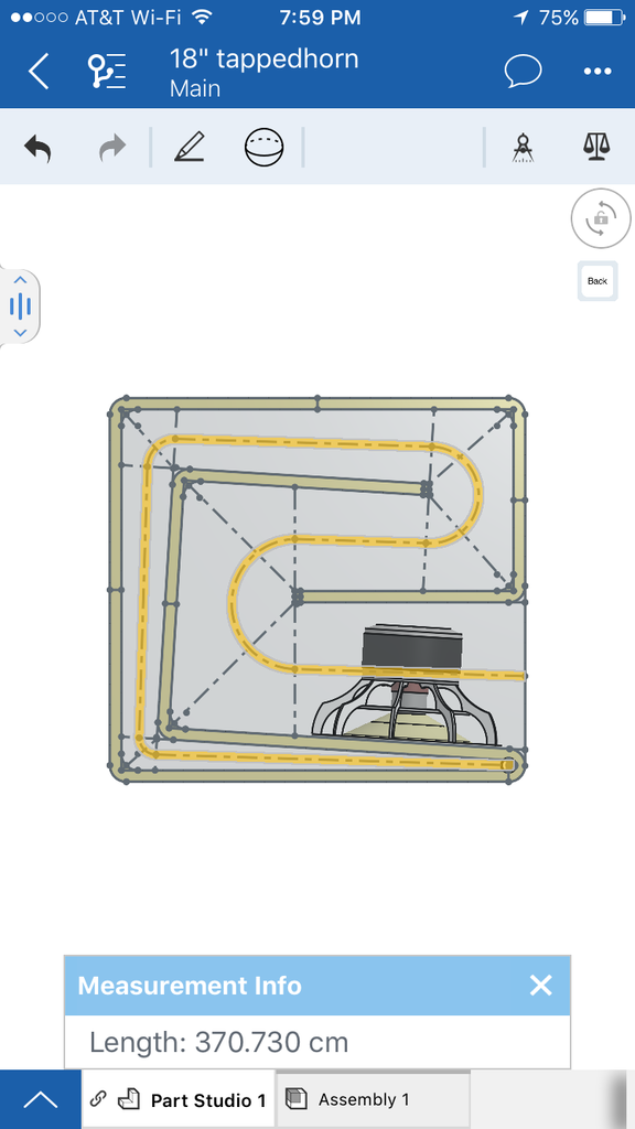

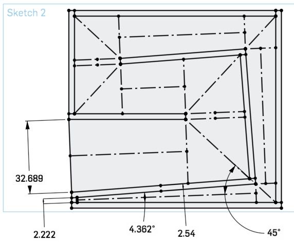

The length variable is NOT accurate, however if you view "Sketch2" there is a dashed line running down the center of the horn, select all of it's segments then tap the calipers icon on the top and it will give you a very close approximation of the actual length, then you can adjust the variable up or down and remeasure. I'm not sure how to fix that. I tried using a correction algorithm that got it closer, but it still wasn't right.

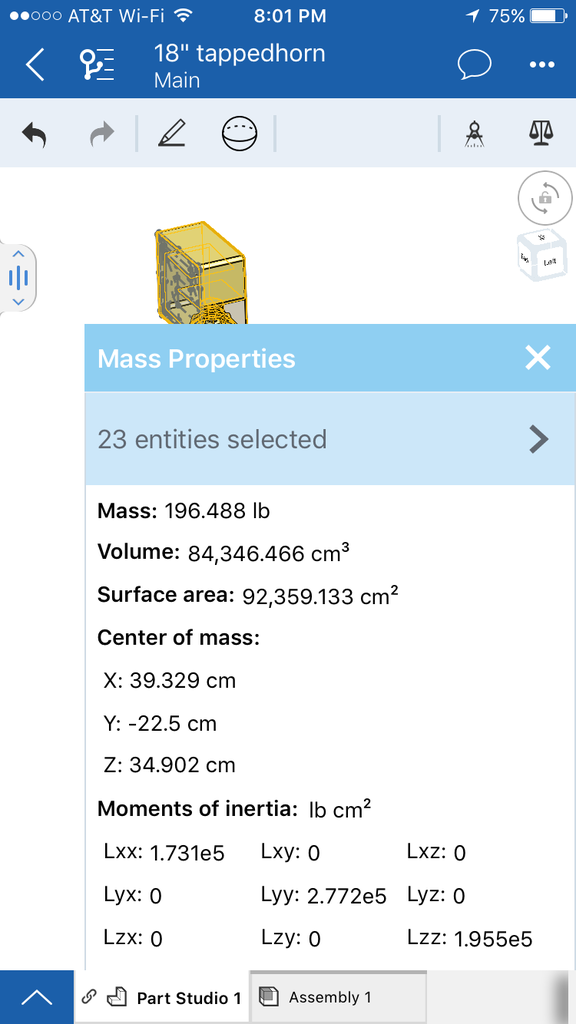

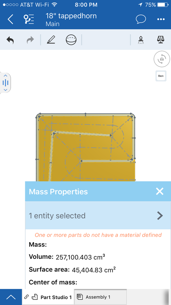

If you select part4 and press the scales icon it will tell you the total volume of the horn.
If you select all of the parts (except part4) it will give you an estimated weight (for plywood and polycarbonate and an as of now imaginary driver)
The model is meant for stacked cnc cut plywood with polycarbonate sides, if enough people think it's a useful idea then I will make a few for more affordable, less wasteful construction, and more flexible fold styles.
it's constant flare only, I haven't tried compound flares yet, not sure how that would behave.
If you go too high or low with the variables the model will twist itself into a knot, just hit undo and it will go back together. This isn't the most flexible folding style, but it looks really nice with clear sides and it keeps the mouth on the floor.
The driver in the model is one I'm designing custom for this sub, it's not done, and is just there to give a size reference.
This looks very similar to Brian Steele's Horn Folding Spreadsheet, it even offers the same layout. I haven't ever used his, so not sure what it's capable of (if it can do complex flares or just a constant flare) but the thread is here, actually I'll just link to a post in the thread that shows a screenshot of his spreadsheet so you can see what it does.
http://www.diyaudio.com/forums/subwoofers/171747-spreadsheet-folded-horn-layouts-22.html#post4443437
Anyway, I like stuff like this, as long as it's accurate. I see you are using advanced centerline, so that's good. If it's accurate you get a thumbs up.

It's not quite advanced-centerline. He's using curves through the corners, which can make the estimated length a bit longer than that estimated via the advanced-centerline method. I also suggest taking cross-sectionals that are perpendicular to the centerline, though that could lead to some "estimations" having to be made at the beginning and the end of the line if the termination of the horn at the mouth and throat are not perpendicular to the centerline. The later versions of my spreadsheets take this into consideration.
Anyway, it looks like a pretty decent utility. Certainly looks easier to use than my spreadsheets... 🙂
It will be easy to change it to advanced centerline if that is a more accurate measurement. The dashed line does not control any part of the model, and is just used for the measurement so it can be changed without effecting anything else.

I have updated the model to use flat panel construction because it will be useful for more people. After experimenting (a lot) with Advanced centerline and other techniques I've come up with something different altogether. The new technique breaks up the horn into straight and corner sections similar to the advanced centerline technique and results in an exact volume match, both section for section, and as a combined volume.
I think that any variation from simulation that appears as a shift in tuning of path length should be accounted for in simulation. Measurement of path length is not the place to correct for this shift in tuning. It should be accounted for then the path length modified to match the offset from actual length to apparent sonic length. The difference being that using a measurement that is less accurate to the physical dimensions, and more accurate to the apparent sonic dimension masks the issue, but will never be totally accurate, and may not be consistent.
Edit: I forgot to say, the length variable is now accurate as well.

Not sure exactly what you are trying to say here, but it sounds like you don't think advanced centerline is totally accurate or consistent.
As far as i'm concerned advanced centerline is tried and proven and the most accurate and consistent you can get without going way overboard (see second quoted post below).
Please review these two posts by Soho54, who developed the advanced centerline method and did more work on this than any of us can imagine. But long story short - if you are not using advanced centerline I would never use your app or recommend it.

Far left is centerline. Far right is the curves you were originally using in post 1. Neither of these are accurate, this is proven. Neither of middle left or middle right are accurate either.
Only the middle method (advanced centerline) is accurate. There is no other simple method that is accurate.
You can attempt to reinvent the wheel if you want but advanced centerline is proven and accurate. The rest of us will be using advanced centerline while you do your experiments and eventually end up at the same conclusion.
Just to be really really clear here - centerline method is not accurate. Choosing the more accurate path through the bend is not making a different tape measure, it's using a tape measure to measure the best path.
I wrote out a ton of words to explain my point of view better, as I feel there was a misunderstanding of what I meant, but after reading it to myself this is the only part that really matters in the end:

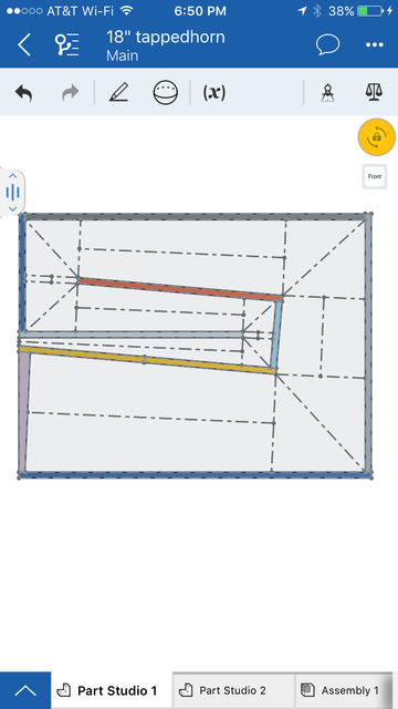

Advanced centerline is easy enough to add to my model and I don't see any reason not to, choice is good, also anyone can fork my model and make changes as they please to measure however they feel they want to. I think that the more people participating the better. The idea is to make it easy for diyers to take an idea from hornresp to 3d design without mucking about in cad for hours, just plug in your numbers and print out a cut sheet.

Just quickly reversed the values and it seams to handle it well enough.
The wedge shape in the throat make a lot less sense when it's that large, so it might be worth changing to a flat board even though it would be less accurate.

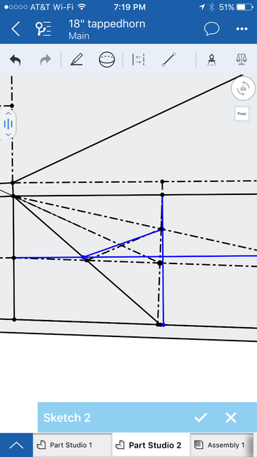

I think that i will handle different folding patterns as separate models in the same project, (tabs on the bottom). Unless Onshape adds global variables the numbers will have to be entered for each one.

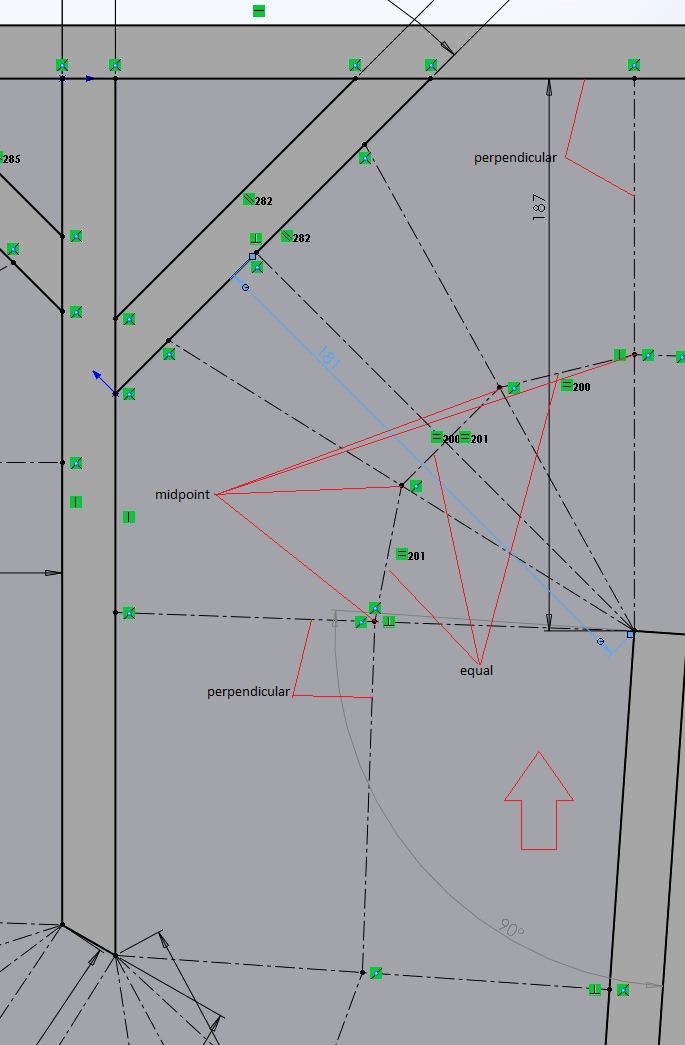

I do have one question about advanced centerline. I want to make sure that it is implemented correctly.
The blue line is parallel to the first and second straight sections centerlines. The dotted line is connected to the midpoints. Which is correct? I have been assuming midpoints, but I haven't been able to find that written anywhere.
This is the way I did it.
The lines are always connected to the midpoints of the width lines.
The 3 path lines around an approx 90 deg bend are equal
The first width line at the beginning of the bend is perpendicular to the preceding path line.
The final width line is perpendicular to the outside face.
Attached screen grab shows a Solidworks path sketch as used to generate the unfolded path length. I turned on the sketch relation symbols (The green marks)
Extra labelling added with red annotation lines.
Hope that helps!

Yes I use exactly the same method.
This would unsurprisingly result in a slightly longer path length - But of course there would be more volume around the bend.
Regards Xoc1
I use a simple rule when laying out the path - for any sample point where the centerline passes through a cross-section line without bending, the centerline should be orthogonal to the cross-section line. This usually results in the cross-section lines never being at right angles to any sides of the horn's path, unless that section of the horn is not expanding or contracting. When laying out the sample points for the path, none of them should violate this rule.
For the purposes of the discussion orthogonal = perpendicular.
I agree that the perpendicular rule is the way to construct the width lines. Where I differed is at the exit of the bend. Here I have chosen to construct the width line perpendicular to the outside wall. The reasoning behind this is that it represents the shortest distance. You could easily change the geometry to make the width line perpendicular to the following path line. In practice the difference is probably tiny. In the example I posted changing the width line geometry at the exit of the bend makes it 0.12mm longer. Far less then my construction tolerance in the real world!
