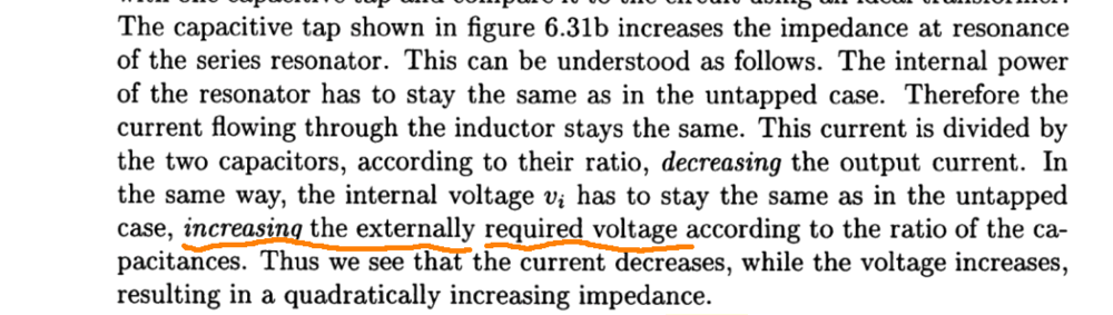

I have recently came across a text of impedance transformation provided by a tapped capacitor arrangement.
Its a rare and unique text explaining the working of tapped capacitor network in terms of conservation of power.

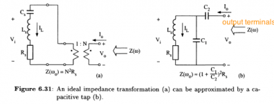

figure 6.31a) is an untapped case when no tapped capacitor is used..fig 6.31b) uses a tapped capacitor network(C1&C2)
The law of power conservation states that..If the magnitude of the power of an individual component in a circuit increases to a certain amount then there should be some compensatory change by the same amount in power of another component to maintain the overall power of the circuit constant.
In case I IL and Vi is constant, in second figure with use of tapped cap. Vi and IL changes which decreases the output current Io and increases the output voltage Vo, hence the latter can be thought of as increase in impedance.
Case 1 Vi and IL constant and power is conserved, whereas in case 2 Vi changes , IL changes which results in increase in Vo and Io,
My query is:-what kind of compensatory change is produced or observed when Vo and Io changes with the use of tapped capacitors, hence increasing the load impedance???

This is a TUNED circuit. The impedance transformation works over a -narrow- range of frequencies around resonance. Typically less than 3:1, or say 500Hz-1500Hz. Not a 1000:1 broadband transformation like we need in audio.
This is one of the classic ways to match transmitters to antennas, or to match radio IF coils into transistors.
You might want to learn to use a Smith chart if you're doing this sort of stuff much.
Networks of individual capactors and inductors only work narrow-band for impedance conversion, you need a transformer or resistor-divider for broadband conversion, only a transformer can do broadband low-loss impedance conversion.

These situations are more conventionally handled by using parallel-series impedance conversions, but the algebra can quickly get complicated. Conservation of energy can provide a shortcut.
Could you please elaborate what kind of shortcut does it provide..I don't get it..
Conservation of energy can lead to simpler algebra. However, you need to be careful if the circuit includes resistance because that will dissipate energy, or a power source because that will injuect energy. Use whatever technique seems best to you.
For the particular circuit you showed us the parallel-series impedance transformation may be the simplest technique to use.

In fig 6.31a) IL and Vi is constant and in fig 6.31b) due to presence of two capacitors IL and Vi changes hence reducing the the output current Io and increasing the externally required voltage (i.e output voltage Vo) underlined. So my question is why this external voltage increases which is technically equal to increase in impedance...Is it a compensatory change just in order to conserve power in circuit..??

In both diagrams the impedance at resonance is given by the formulae (w0 is the resonant angular frequency, 1/√LC). At resonance the L and C impedances cancel exactly. In (a) this means they act as a short circuit at resonance, in (b) the tap between L and C prevents this cancelation, its takes a bit of algebra to figure out the formula.

I am thinking this way....the parallel RC combination is transformed into series equivalent with a new value of Rs and new value of capacitance (C1//C2)...let say Ceq..which is in series with Ls due to parallel to series conversion..
Now as per your statement the tap prevent the cancellation of impedance of reactive components at resonance...so it implies that Ceq and Ls will have some impedance (which won't cancel)and will contribute to some power dissipation in the circuit along with Rs.
So mathematically Power = VI and in case b) Vo*Io = individual power dissipation along Ls,Ceq and Req..(as with the absence of the tap, Power dissipation of circuit (Vo*Io) will be equal to power dissipation among Rs only............your comments...

C and L do not dissipate power, they merely store it for a while. Only R can dissipate power.
Adding the extra capacitor between the tuned circuit and the outside world can be considered to reduce the coupling between them. It increases the external voltage needed to get a particular internal current going.

I got your point...Actually due to the presence of capacitive network current divides and reduces in the output branch. Power equals VI, hence I changed here and to maintain a constant power V changed to the same amount, this amount depends upon the ratio of capacitances (which varies the current in the circuit).
