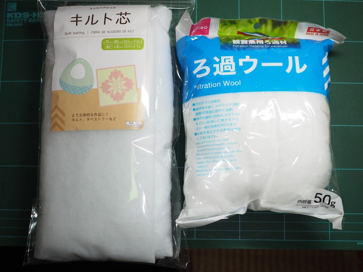

I'm quite new to speaker building and wondered if you could answer a few questions about the damping material you used?
It looks like you used a small amount of very thin felt, thinner than I can find in any audio shops. What is the reason for such a small amount, and such thin material?
I understand the mass of the polyester wool is critical, is this true also for the felt?
What is the purpose of the mesh, and what kind of mesh do you use? I haven't seen this being done before.

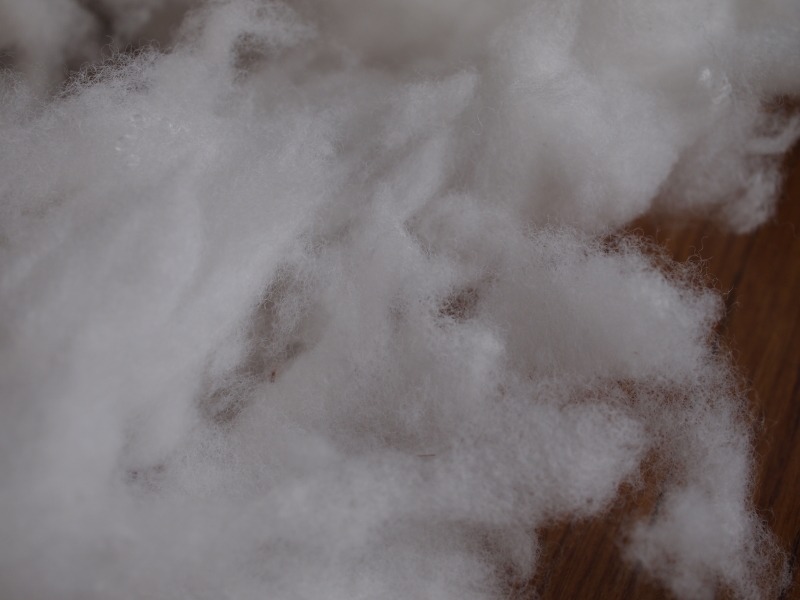

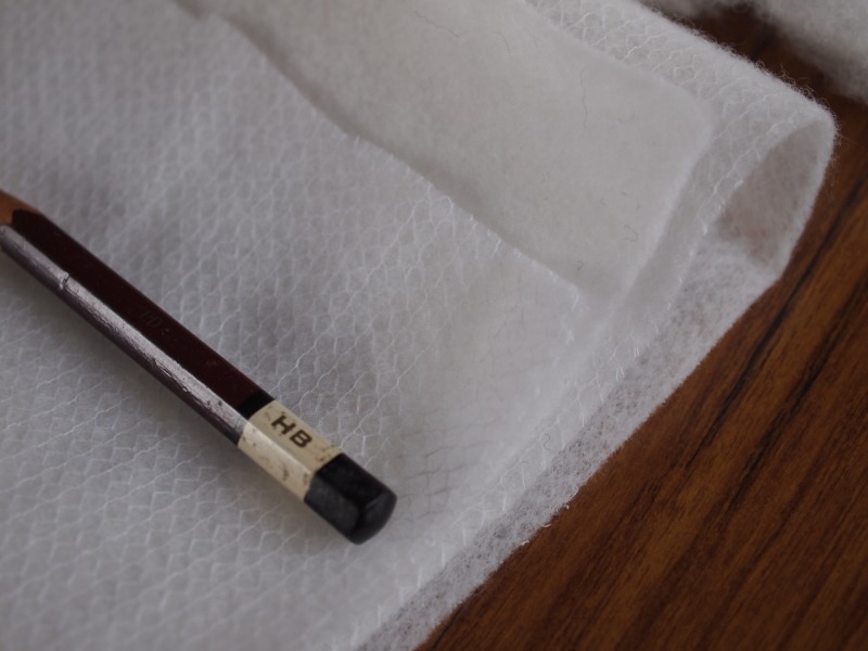

Thank you, I actually have some 15mm thick cotton damping material (recycled cotton fabric type) but it's not really felt, it's much looser. I don't know how that would affect the acoustics for this application (directly reflecting surfaces). I'm wondering if having a thinner and possibly denser damping was intentional in this build - e.g effectively damping reflections without interfering with the volume of the enclosure too much.
Dear Julesm,
I am of the "I don't want to use sound absorbing materials" school of thought, so I either don't use them, or if I do, they are made of low density, lightweight polyester.
I do not use high-density felt, and I do not use audio sound-absorbing materials because they are too expensive.
I usually use "quilt padding with mesh" (Photo 1) and "polyester cotton" (Photo 2) for sewing.
We can also substitute quilt batting [100 yen(US$0.75), 75cm x 80cm] and aquarium filters [100 yen, 50g] (Photo 3) available at 100 yen stores in Japan.
