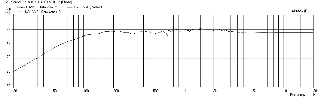

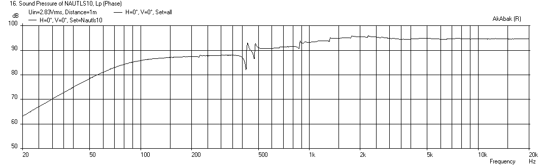

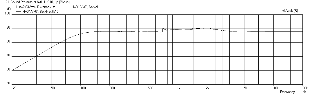

Here is what it is capable of:
402191d1393333563-3-4-driver-very-good-dispersion-high-xmax-nautaloss-ii-2-drivers-polar-1m.png
Needs a sub woofer though as sealed alignments don't go much below 150 Hz. In the same thread there is also a Nautaloss subwoofer.

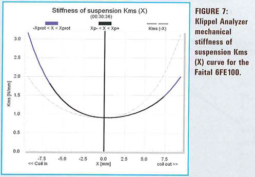

Faital 6FE100. I had a thread over in multi-way where I initially had a few measurement issues. After sorting these out, it basically seems Cms is about half what it should be and the rest of the data naturally follows suit.
Factory data:
426375d1404219801-small-signal-loudspeaker-parameters-some-questioning-6fe100_spec-sheet_ts_param.png
2008 Voice Coil / Vance Dickason data:
426379d1404219801-small-signal-loudspeaker-parameters-some-questioning-6fe100_vance_dickason_voice_coil_2008.png
426378d1404219801-small-signal-loudspeaker-parameters-some-questioning-6fe100_kms-x-.png

I pushed some ~20Hz-30Hz sine at ~12V into them for a few hours with zero measured change after the motor had cooled.
The upside to that low Cms is high excursion-limited power handling. 🙂 I don't see how Fs could be lower if I measured at higher excursion since the suspension only gets stiffer and things would start to be non-linear anyway. Not sure I'll ever drive them hard enough in everyday use to loosen it up too. Maybe I'll give'em some more time on the "burner" and hope for the best.

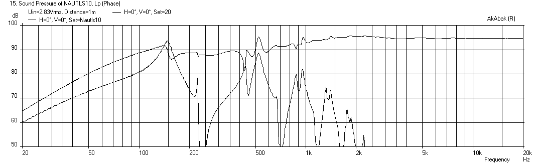

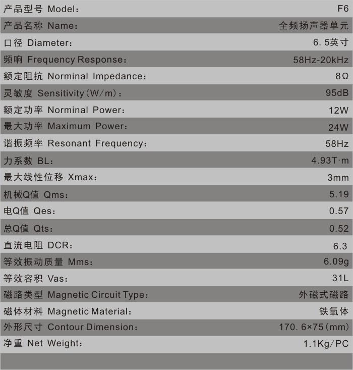

Sim of 60 in long TL with Lcao F6
I modeled the 60 in long TL starting with a 8 in x 8 in baffle where driver is mounted tapering to a 8 in x 2 in tail or terminus. It is moderately stuffed with damping material equivalent to a pressure drop of 7500 Pa/m^3. There are two cases with the vent open and closed.
With rear vent open freq response (4 pi open space far from walls or floor) - you can see the effect of baffle step loss:
Note that the vent does not appear to help the bass much and actually causes a cancellation dip.

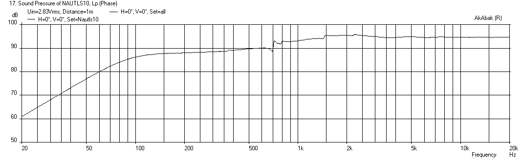

Here it is with rear vent closed (sealed TL):
I think you are far better off to make a short (36 in long) sealed tapered TL like the Nautaloss, where the intent is to absorb the rear wave:
427832d1404934133-tapered-tube-fr-enclosure-nautilus-nautaloss-lcaof6-sealed-36in.png

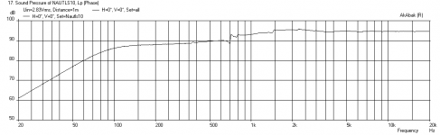

If we apply a 1mH & 7.5ohm BSC circuit, here is what we can get:
427833d1404934133-tapered-tube-fr-enclosure-nautilus-nautaloss-lcaof6-sealed-36in-bsc.png
This response is actually even smoother once real stuffing/damping is applied. If we include the effects of floor bounce (48 in high) and rear wall (60 in back) reflections in a well-damped (absorbcoeff=0.75) room, we get this:
427834d1404934133-tapered-tube-fr-enclosure-nautilus-nautaloss-lcaof6-sealed-36in-bsc-48inhigh-60inwall.png
In summary, I don't think you will be very happy with the 60 in long vented speaker. Make it shorter and make it sealed, otherwise design a traditional TQWT box type offset driver TL like a Voigt pipe, etc.

The design I provided you above with 36 in long taper going from 8x8 in to 8x2 in sealed end basically satisfies your request for 100 Hz extension (circa -3dB at 100 Hz). That is about as flat of a response as you are going to get from this driver in any alignment. Just be sure to use a BSC circuit for balanced sound. It should integrate very well with a sub XO at 100 Hz.

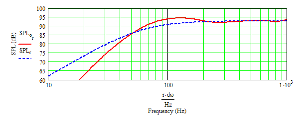

~2.629 ft^3 net Vb/~111 Hz Fp TL that may not need any baffle step compensation [BSC] and/or allow a lower 70-80 Hz XO point:
L = 27.125”
CSA [WxD] = 167.49”^2
Zdriver = 5.7”
All dimensions inside [i.d.] and approximate. Sim assumes a 1.75 lb/ft^3 stuffing density of polyfil, but most folks normally wind up with much less than suggested when tuned by ear and the driver is used wide range, i.e. will have a bit less flat, but more ‘lively’/life-like presentation, yet be better damped than BR or even some MLTL or TQWT alignments.
GM
