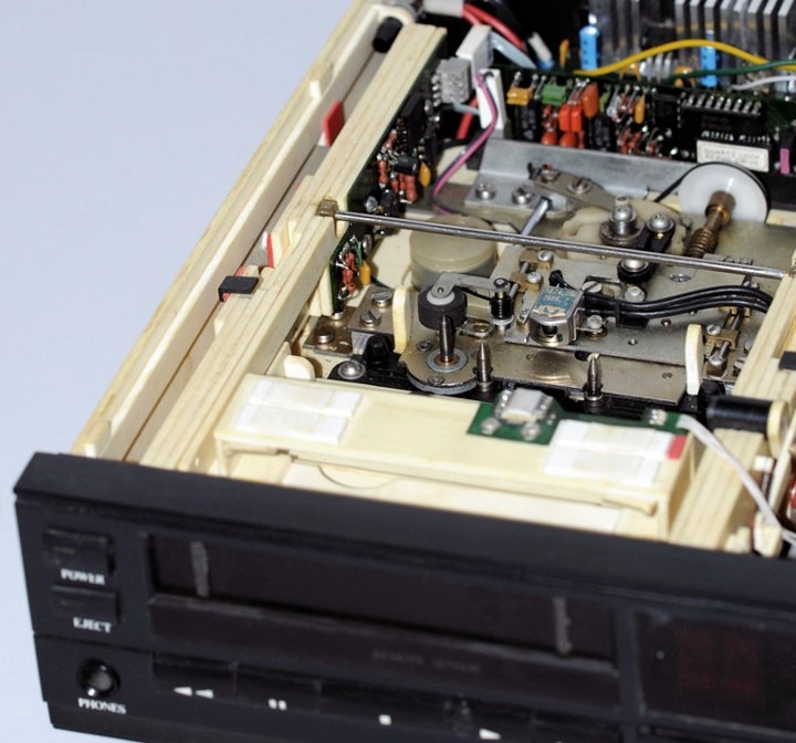

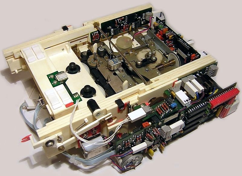

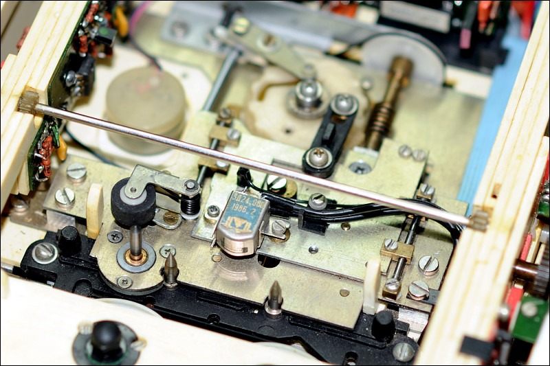

About 30 years ago, I tried to make my own mechanism for a cassette deck. Of course, I used some parts from branded tape recorders. See photos.This is not going to be "Dragon" killer , this will be decent Sankyo 2 Head Equivalent
The Capstan requires a high accuracy of treatment (near the units of micrometers), special steels, heat treatment. Bearings also require special materials - sintered bronze. The flywheel requires balancing. All this requires serious production, one CNC machine is not enough.
- Heavy CNCed Single/Dual Capstan with Optical Feedback [PLL Error Correction of Speed].
The optical sensor is also not the best solution. It will require accurate centering. Usually, integrating induction sensors were used, which occupied all 360 degrees.
You can try to make a direct drive using coreless motors (like a Revox B215).
- 1 Motor for Driving Reel [Current production Mitsumi motor can be used]
Bad solution. For the drive of the head block, it is better to use a separate DC motor.
- Solenoid Driven Head Block
This is a common mistake to believe that there is only a slippage in the supply capstan. There is elastic slippage on both capstans, the question is only in its size. Designing a closed loop is a very difficult question.And does it also mean that, the capstan on the incoming side is set up for tape slippage?
This will destroy the project. It makes no sense to try to develop what will be cheap. This is impossible. Currently, the development of a R-R tape machine is of interest, which can be sold expensive.it will be much cheaper to design a cassette deck than R2R financially
