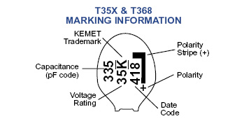

Correct, right legs in your pictures are positive (+) leads.
- most tantalum capacitor marking/bar indicate positive (+) lead
- which is opposite to most aluminum electrolytics, where marking/bar indicate negative (-) lead
Typical dipped tantalum marking, lifted from KEMET literature below.
See page 63, KEMET dipped tantalum:

In many electronic parts, the longer lead is the positive lead (provided that they are unclipped). This is true for both tants and normal electrolytics.
Better be safe than sorry: tants can pop nastily if they are connected in reverse polarity, so there's no need to be ashamed for checking before mouting them!

It's not so common, I've hundreds of old computer components using tantalums with zero failures and have often put them in old amp projects that never failed.
The main problem is when someone self-designs something and doesn't leave enough margin. For example, if you have a 14V circuit you might accept using a 16V electrolytic but you'd be wise to step up to a 20-25V tantalum.
Reverse polarity is a different matter, they'll destroy themselves right away.
