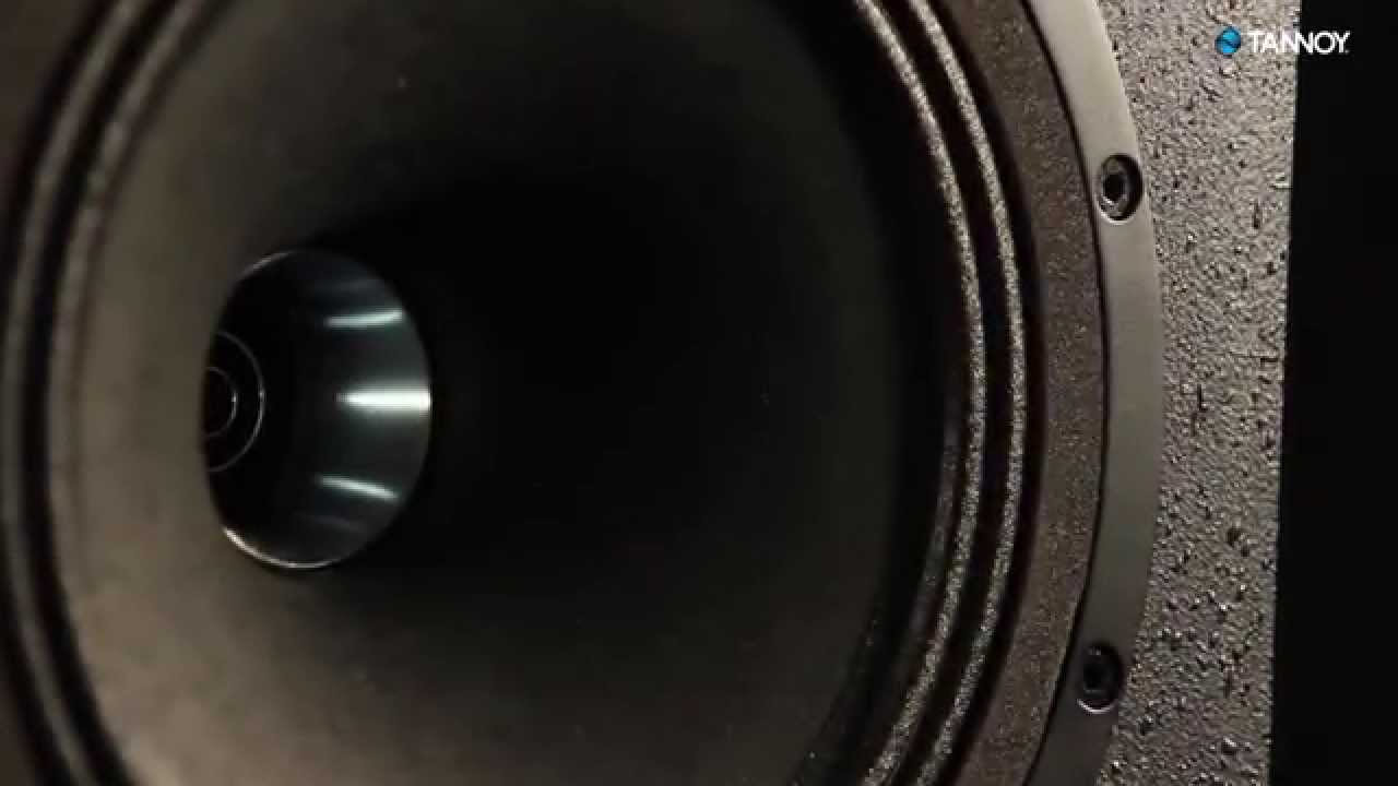

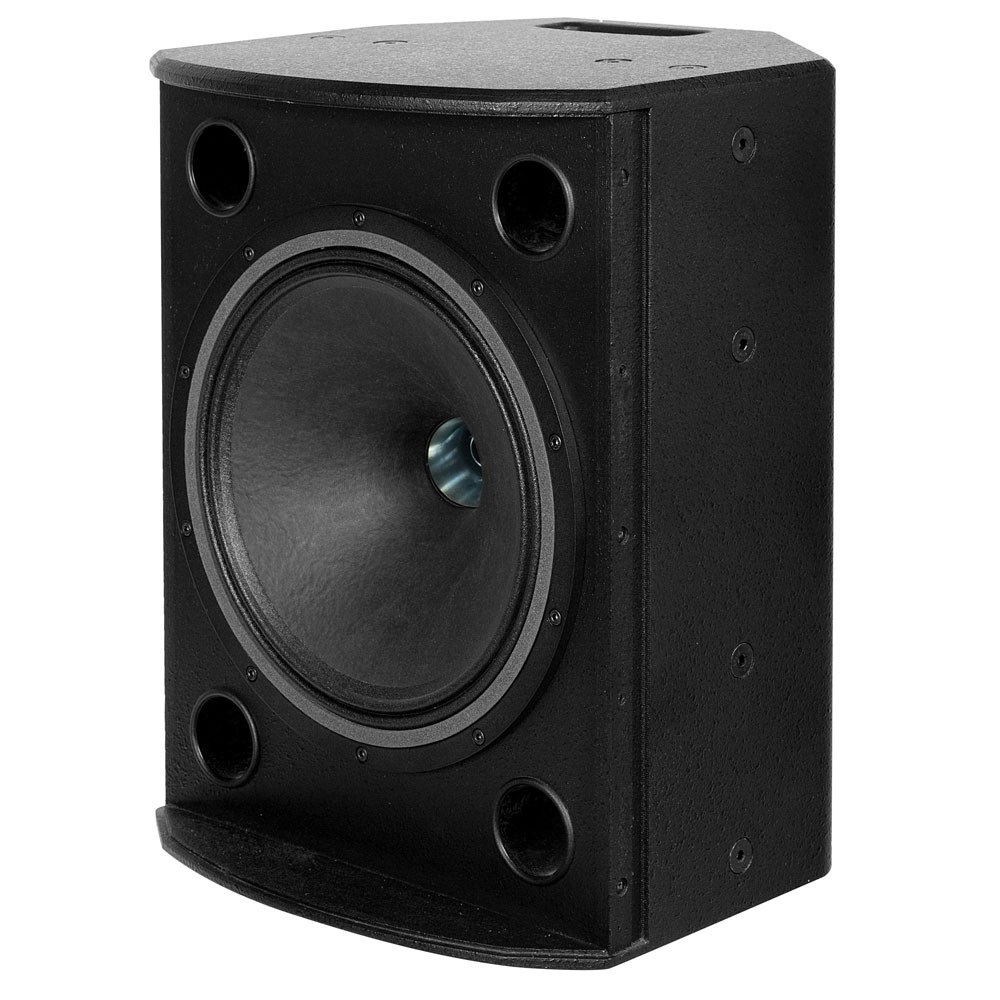

Hello everyone. I have recently aquired these speakers at a price I simply could not turn down (£150 for the pair!). Now, I knew beforehand that they were really designed to be used with some sort of low frequency reinforcement, and I am hoping to acheive this by building new enclosures for them.
I have previously build enclosures before, not least the awesome Sachiko back loaded horn for the Fostex206E. So, my question would be does anyone one have any suggestions and / or experience that they would like to share? I will be contacting Tannoy in an attempt to get the Thiel-Small parameters in due course. In the meantime, the mids and highs of this driver are simply awesome and I am very happy with them.

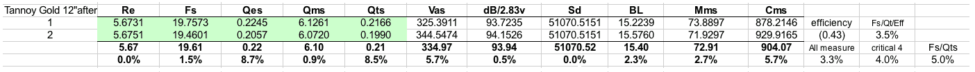

The box i designed for the 12” gold was as large as i could make it using the measured T/S. It was probably tuned a bit high or wasd a bit small if it was based on factory specs. It certainly provided significant bass impact.

It is one of Tannoys modern PA drivers and a fair bit more efficient than their classic 12s. To get that efficiency Fs will have been raised quite a bit higher than that of a 12" Monitor Gold, HPD or K3149.
Since it was never meant to be used without a bass except as vocal PA that is not a problem in its intended application.

these are having highish Fs , really made for smaller cabs- stage monitors
no use of having full bass enclosure , you need bass helper with them
simplest Fs measurement will reveal is it 3142 or not
for full bass duty , magic (type) number is 3134 , used in TDM12 and CPA12
but , don't fret - you have awesome base for great spks there
just an idea - put them on OB and use whatever sort of bass helper you like most
