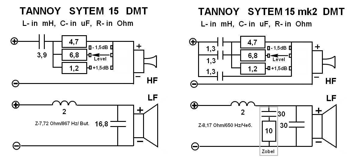

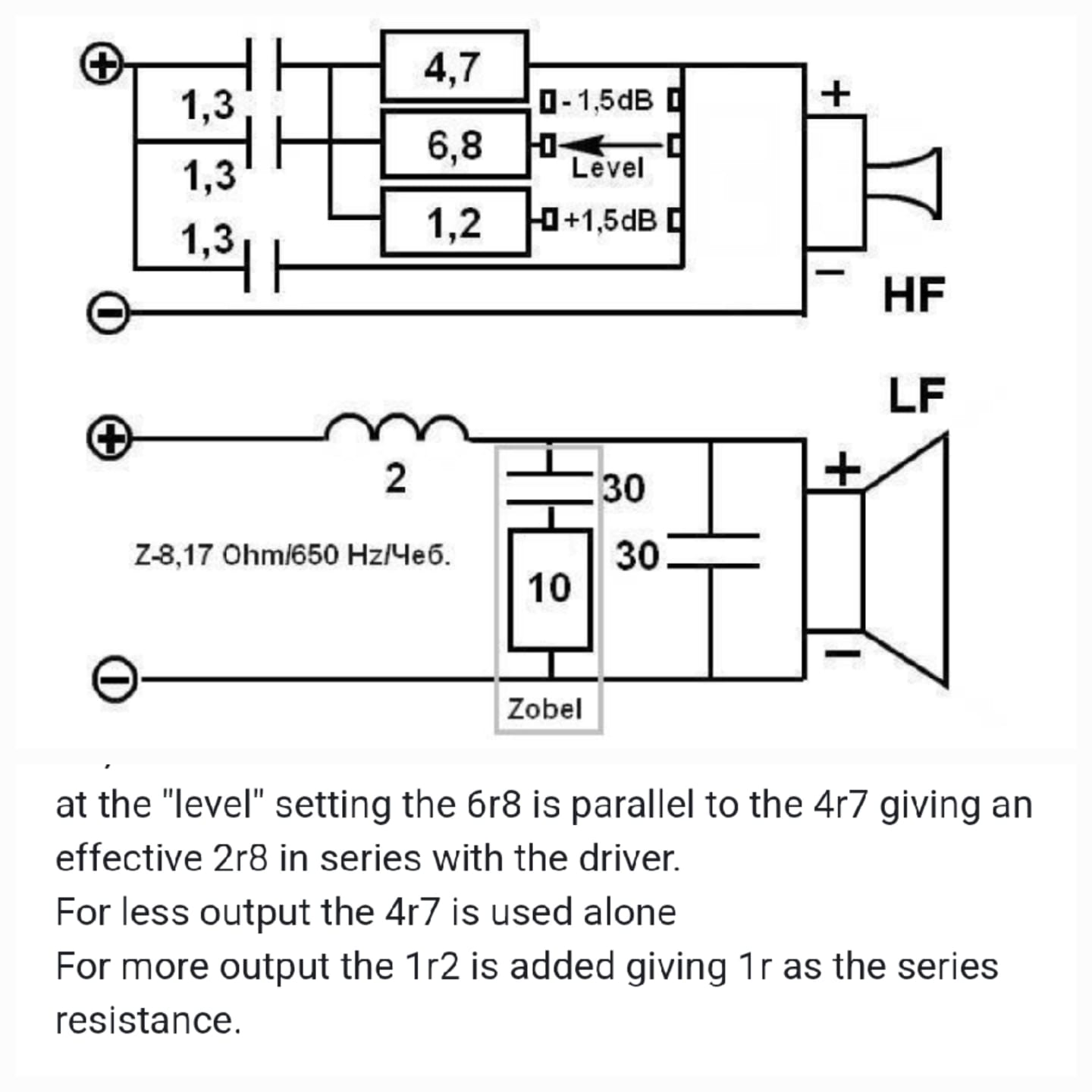

I got a question about the tannoy system 15 DMTII crossover.
The resistors for setting the tweeter level.
If i would make my own crossover.. can i only use the 6,8 ohms for a "level" position.
Or is the 6.8 always parallel to the 4.7 making it a 2.8r?

About the Difference between MK1 and MK2,
Is there a sonic improvement between them in the high section?
MK1 3,9uf before a resistor.
MK2 two parallel 1,3uf with a resistor in series. And than a 1,3uf parallel to that.
Hope i explain this right😂

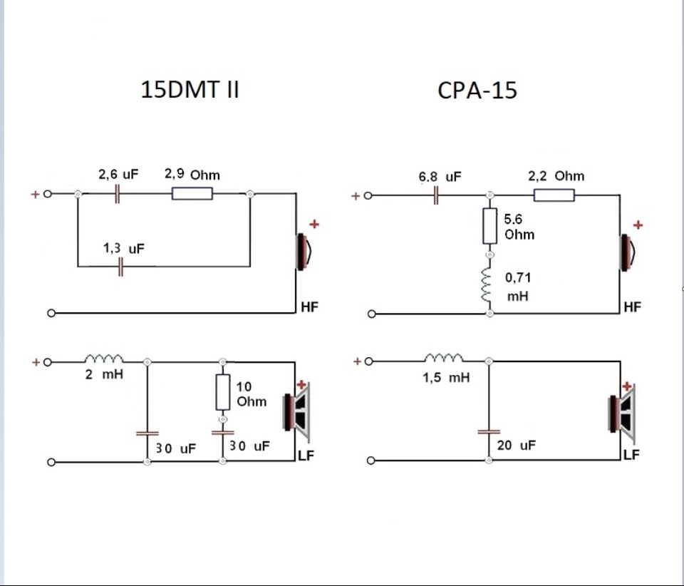

When I looked for alternative boxes and crossover solutions I happened upon Zen Mods blog and his various experiments and projects with Tannoy.
I reached out to him and after some discussion he made a recommendation of transplanting the 3833GG drivers into an MLTL enclosure he had designed for his Tannoys using the much simpler CPA 15 crossover design.
He even provided me with some models comparing the response curves of both crossover designs.
I believe his experience with these drivers is very valuable.
Perhaps it is something you would like to consider in contrast the the large Arden reflex design and more complex DMT crossover.

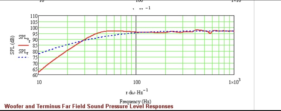

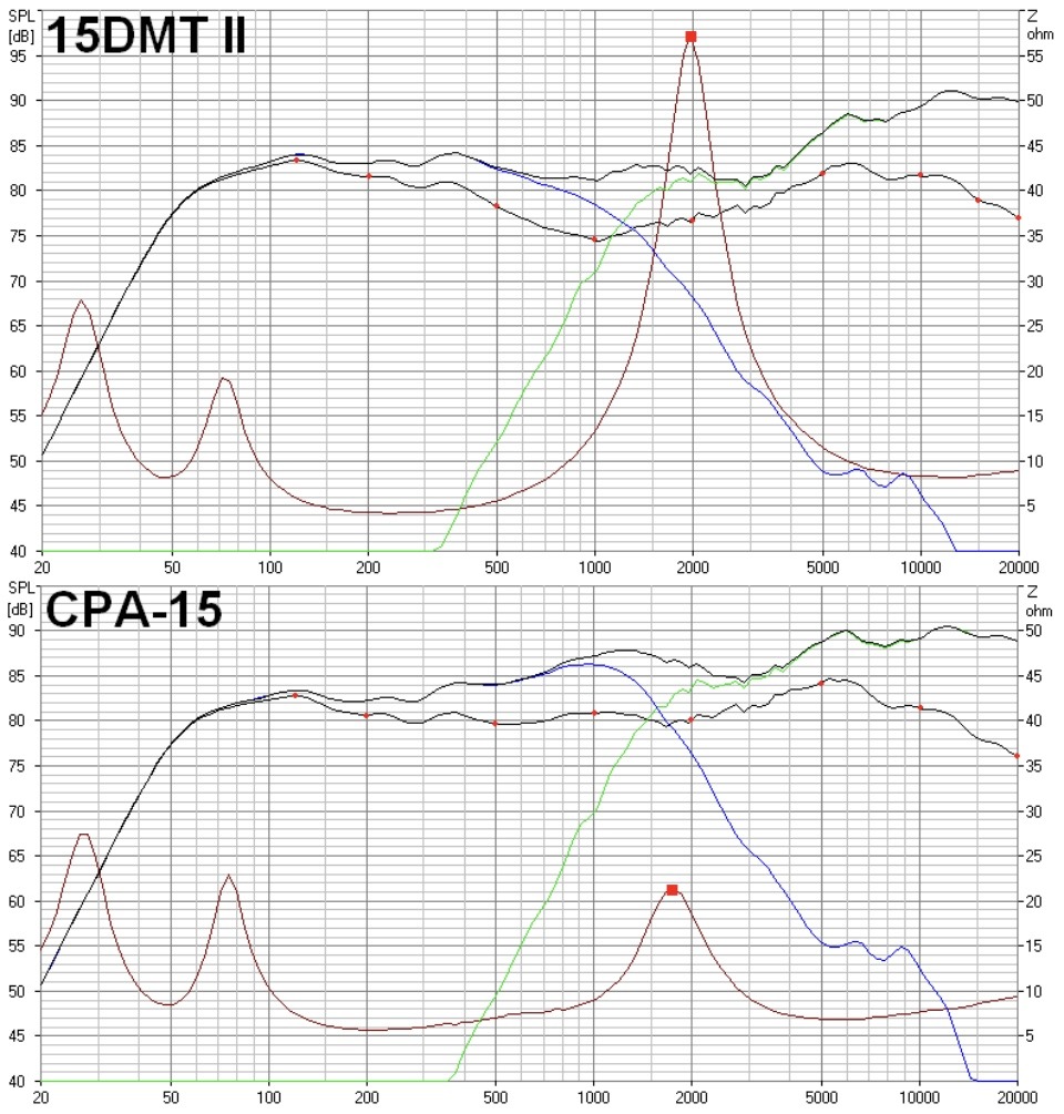

This is some images if the data he sent me.
The MLTL dimensions are reasonable…a bit taller than you mention at 46 inches.

Thank you for the files.
Unfortunately a higher cabinet is not an option.
To be honest I normally don't understand anything about graphics/measurements.
My ears tell me if it is good or bad...
What I can see is that it's more linear?
Did zenmod specify how much resistance the coils must have?
I am not using the CPA crossover yet…I do intend to when I find the time to build the MLTL cabinets.
I’m finishing a second Babelfish J2 to experiment with some active multiway projects I am interested in. One of which will use a 12” K3149 Tannoy in OB with woofer support.
Zen has built the MLTL cabinet already and my understanding is that he is using this minimalist CPA 15 crossover.
15AWG .71 mH for high frequency should be fine.
Reactions: Zoef

The HF section of the DMT MK2 crossover has 2x 1.3uF parallel (2.6uF) with a resistor in series. Parallel to that a 1.3uF capacitor.
The HF section of the DMT MK1 version has a 3.9uf cap with a resistor in series.
Isn't this exactly the same?
(Yes LF section is different)
If so, could i use the HF section of MK1 and the LF section of the MK2?
And if i should/must stay with the MK2 topology:
Can i put in 2.9uF with a resitor in series and then a 1uf parallel to that?
(I've seen crossovers for sale on "the bay" that use 2.7uF with 1.2uF.)
