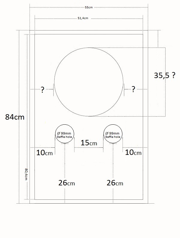

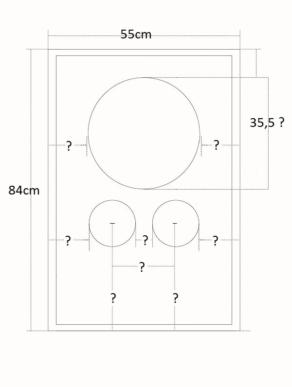

@chromenuts
How are you?
I was wandering if you could do me a favor. Could you meassure your speakers for me?
I would like to build the speakers very close to original. Only in a domestic version. (some fancy veneer on them )
I attached a little sketch with some question marks.
Cheers!
Cheers!

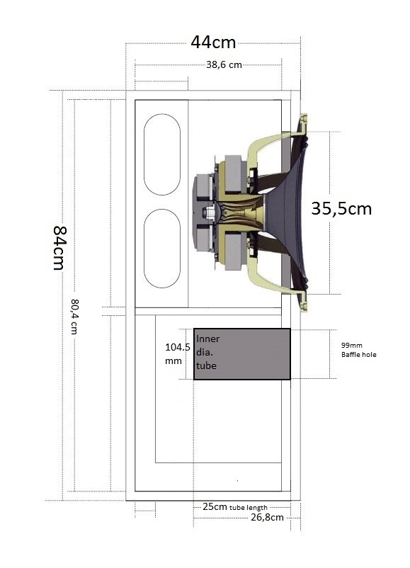

I ditched this idea.I did a quick sketch of what I have in mind.
So nothing is to scale etc.
I was thinking, maybe sand down the cabinets and give them a dark stain like tannoy uses in their prestige series. Then paint driver frames gold.
Maybe try to remove the ornaments on the cabinets.
I know going this route can lead to some "problems" sound wise. Diffractions etc etc etc.
Since the DMT's where used in studios where they where build into walls, hung from the ceiling or placed on whatever was useful, I think I can get away with building them in a cabinet.
And I will not be using them for critical listening anyway.
These will be used for day to day "normal" use.
Background to high volume dancing in the living room. But still delivering a very good quality of sound.
I find myself in the strange position that I do not take the time anymore to sit and listen/analysing the sound. I'm more feeling/enjoying the music.
And caring less about..is the image spot on etc
(But maybe that's the point of good music/sound?)
Going to be a fun project.
Since i need to build boxes (of almost the same size as the dmt's) to fit inside of the furniture, i can make it easier on myself and just put some nice veneer on them.

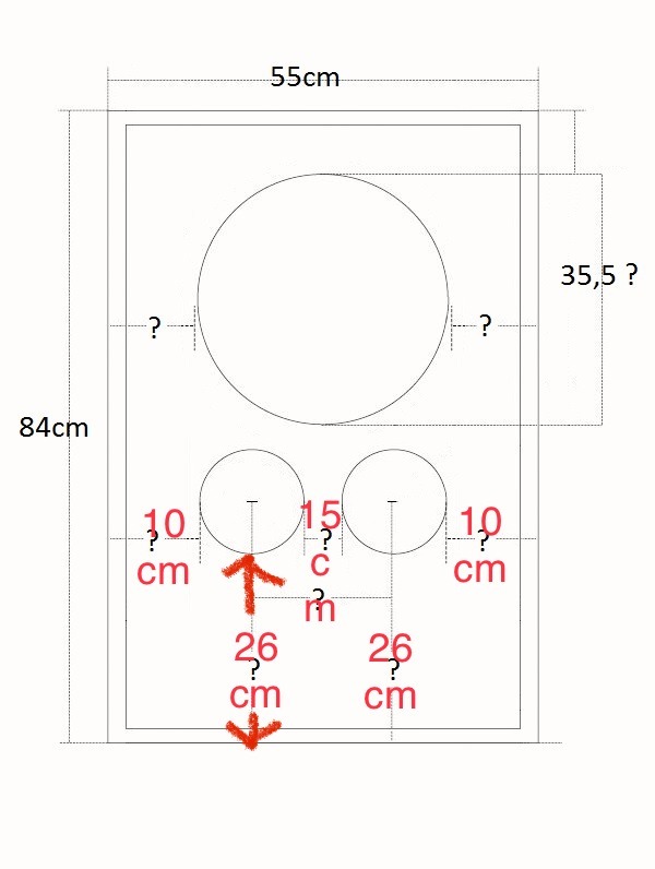

Ah That is great!
Thank you so much!!!
Ofcourse, let the drvers sit. I wouldnt touch them either!
This is a really great help!!!!
I have not had my DMT speakers open at all yet because I am playing with 3149 drivers I bought without boxes or crossovers for now.

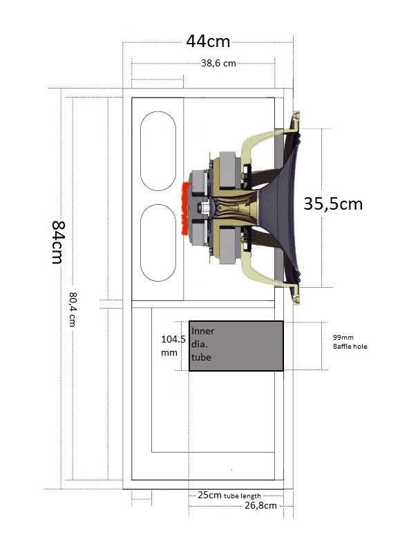

From what I’ve read, there is a lump of mastic that is placed between the back of the driver magnet and the bracing (red in pic) to provide better coupling.
Yes, I read that also . I think it was the hilberink site.
To be honest, I don't think I will go that far.
The bracing I show here is of the legacy Arden's
To my eyes it looks a bit better than the bracing of the DMT.
And I think construction will be a bit easier haha.
