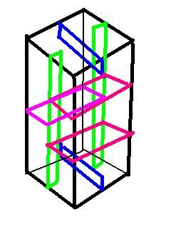

Looking at Sreten's drawing, I wonder if that much bracing is needed in a small cabinet like mine. It's going to be around 36.5 liters, bracing not included (approx. 25x30x50cm). I will add some top-bottom and front-back bracing, though. It will need some re-calculation.
Do I need to screw all the braces to the cabinet, or is just glueing sufficient? I can imagine glue stretching somewhat (and maybe breaking?), while screws are much more firm. Besides that, It would be impossible to screw all braces into the baffle, since that is designed to be able to come off, in case it needs to.

a partition running from top to bottom and side to side glued and screwed into place may suffice for a cabinet of this size. The partition should have two very large holes cut in it to form a spectacle shape. If the partition is placed off centre and possibly off vertical it will result in all the unsuppoted panels being of different shapes and sizes giving rise to a very wide range of much smaller panel resonances.
Adding a little bit of damping could well result in a very dead cabinet.
Arrange for one of your spectacle openings to be directly behind the driver/s to allow terminal connections etc.
Using the above method will result in the largest unsupported panels being the back and front. Consider using very thick material for these, try 30 to 40 mm thick.
The external size is now very much bigger than your 36litres, possibly over 50litres.

Glueing the braces will be fine, adding screws is pointless.
The number "8" frame described by AT is good for thin, tall,
and deep cabinet designs, not so good for bluffer shaped
boxes. If the box is very tall 3 holes are better than 2.
IMO the boxes are quite large and the bracing is needed.
Variations of the bracing is possible. Use an 8 frame offset
forward + the original back brace @ 0.4 x hieght and join
them. Use 2" for the front baffle braces and join these to
the baffle not the cabinet, or other variations.
Massively thick baffles and backs reduce the actual volume to
percieved volume too much IMO, bracing is much better IMO.
