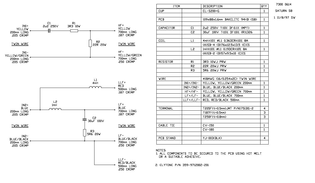

I bought a pair of Tannoy S8 LR DC units(2064) . I am planing to build diy S8 LR cabins.. Unfortunatelly I could not find the xover shematic and parts list of S8 LR speakers on the net. I found some pics of S8 LR xover only. You can see it the pics below.. The values of the parts on it are clearly visible except of the coil... I have no idea about the specs of the coil.

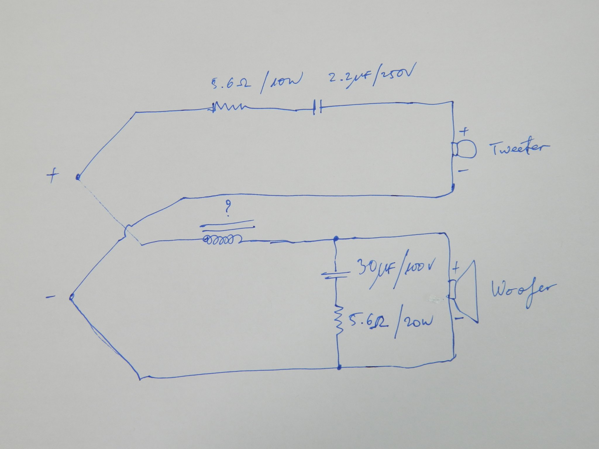

I only can guess the schematic base on your photos of the crossover. I don't know the value of the inductor. You can find the value of the inductor if you have a LCR meter.

Hello tuantran,
Thanks for your reply. The problem is, I don't have the xover, I could only find the pics of the xover that I shared. So I can't measure the coil's value. The crossover info according to the manual is, "frequency is 1.5 kHz" btw..
Thanks for the info and graph again.
