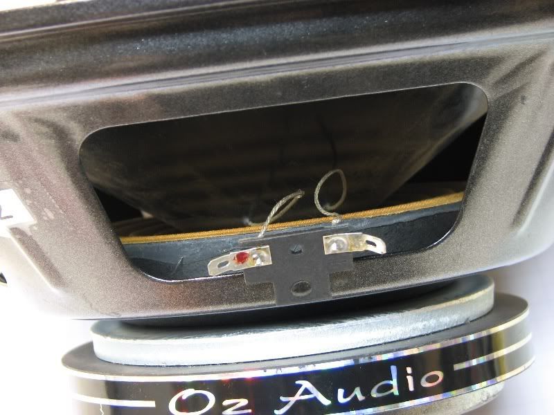

Either both voice coils have been burned out due to overloading or there is a break in the connections between the driver terminals and the voice coil.
To have the voice coils replaced would be uneconomical in terms of this level of speaker.
To check the connections, examine the flexible tinsel leads that carry the current into the voice coil from the woofer terminals. There could be a break at one or other end of a tinsel lead, which you may be able to resolder.

Thanks Galu, the woofers looks in good condition with all wires and connections looking like new. These speakers have been sitting in storage for around 10 years but were working before they were put there (I'm not sure there was any overloading). There has been large flucutations in heat and cold in the storage area. Anyway, I suppose they go to recycling now... thanks for your help
The fine voice coil wire can corrode and become open circuit as a consequence of bad storage.
The ported enclosure is tuned to the electrical/mechanical parameters of the woofer and, without knowing those parameters, it would be nigh impossible to source a suitable replacement.
Your best bet would be to look out for woofers coming up at online auction - if the price is right!
