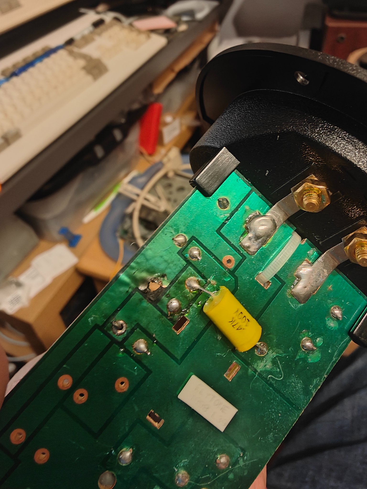

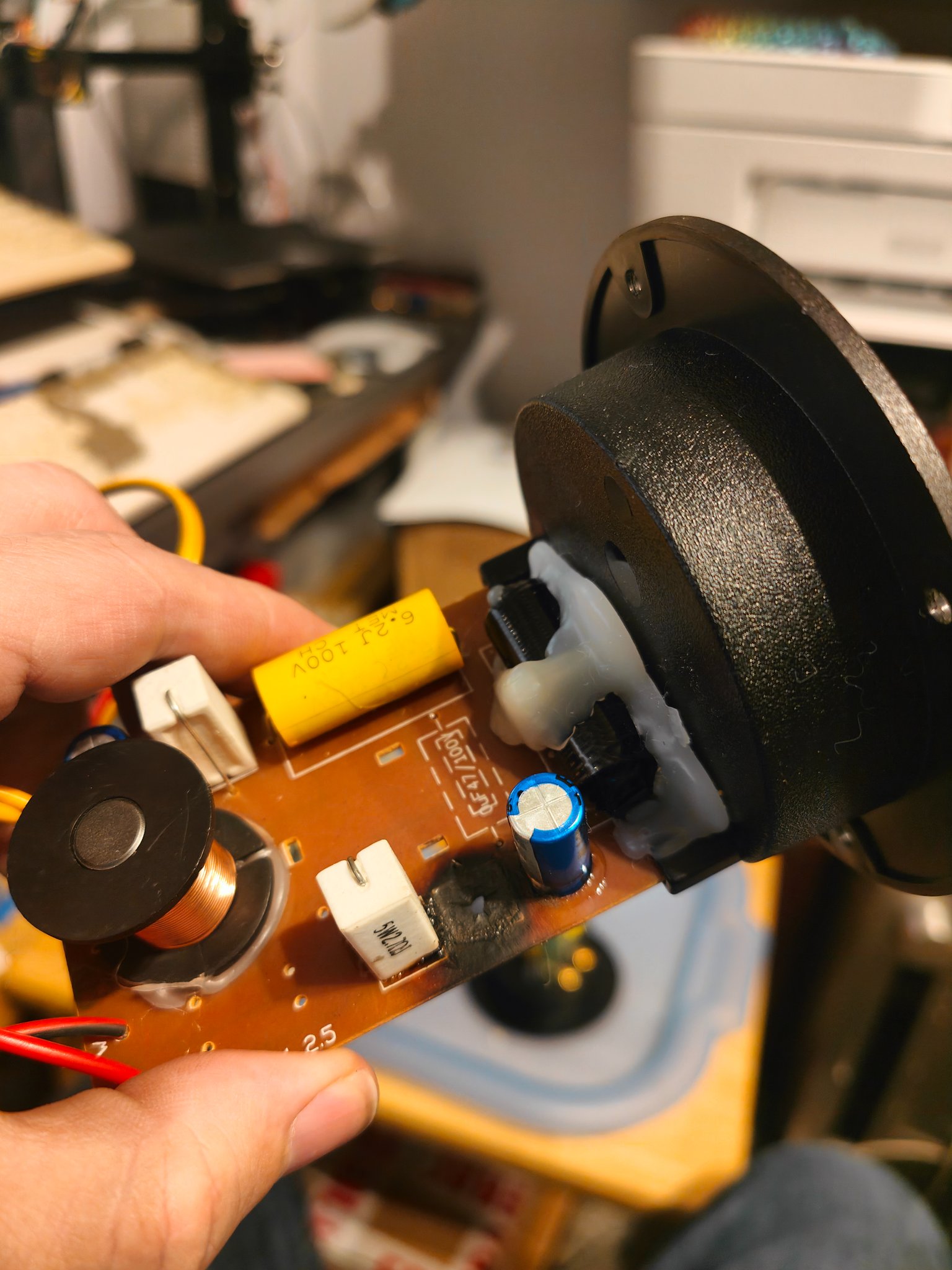

I suspect tha Amp to be ok

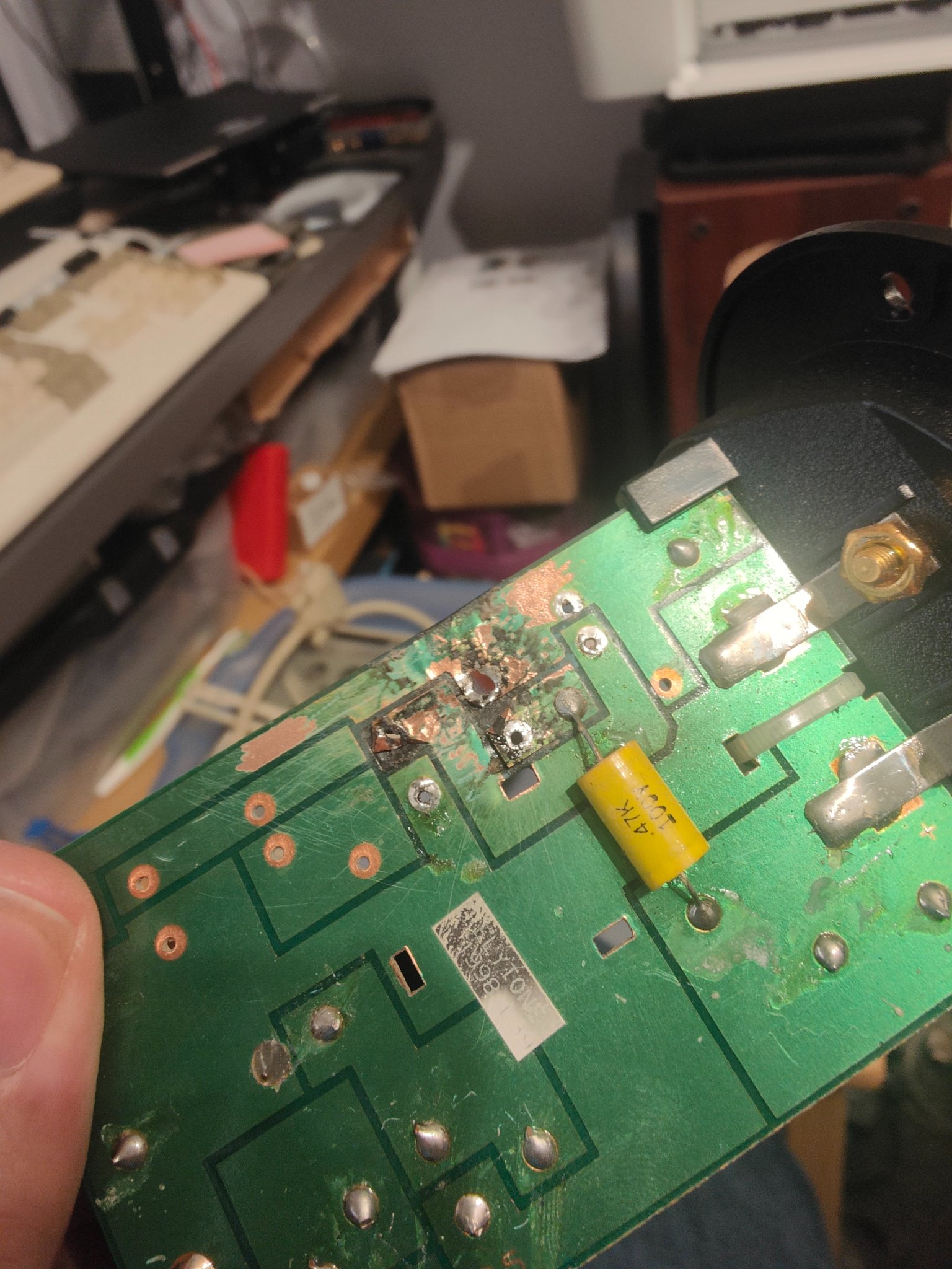

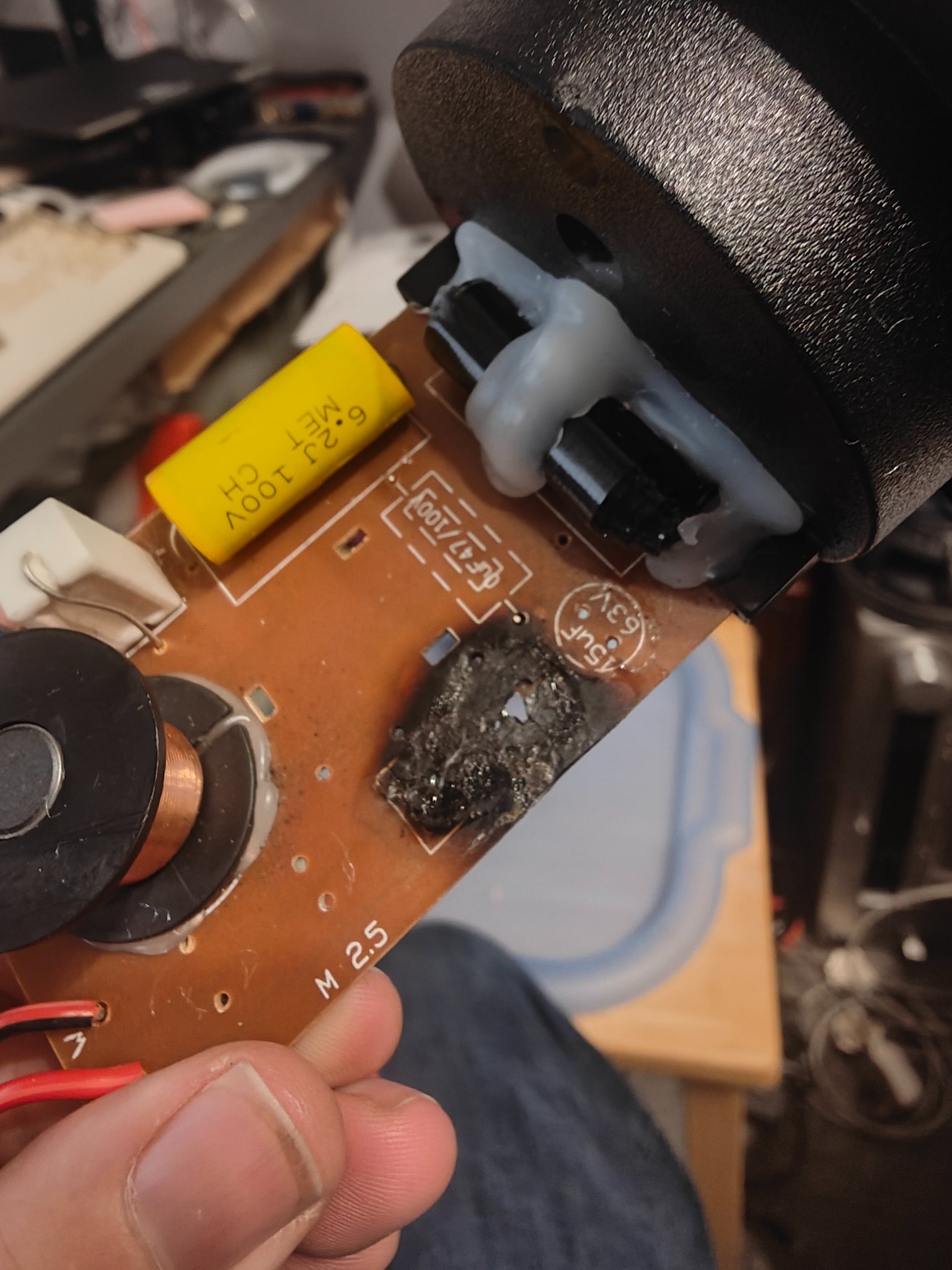

I suspect the amp is oscillating at supersonic frequencies producing a continuous current capable of frying the resistors in a high pass tweeter filter.
The burning smell can't now return as the path for this continuous current has been broken by the fried resistors which have become open circuit.
N.B. I wouldn't risk using this amp on a new or refurbished pair of loudspeakers.
If the tweeters have a DC resistance of 4.6 ohm, this is consistent with a nominal impedance of 6 ohm and shows that the voice coils are not open circuit.
Although encouraging, this does not mean that the cylindrical voice coils have not been distorted by excessive heat - only by applying a music signal as detailed in post #2 can you eliminate that possibility.

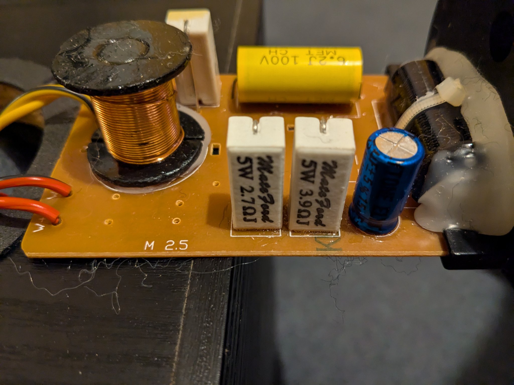

Having made sure the tweeters are working properly, I would be tempted to replace both of those "side by side" resistors with the same 2.7 ohm 5 watt resistor value simply to note the result. Try it on just one speaker for now until we see where that gets us. Oh, and use another amplifier for testing!

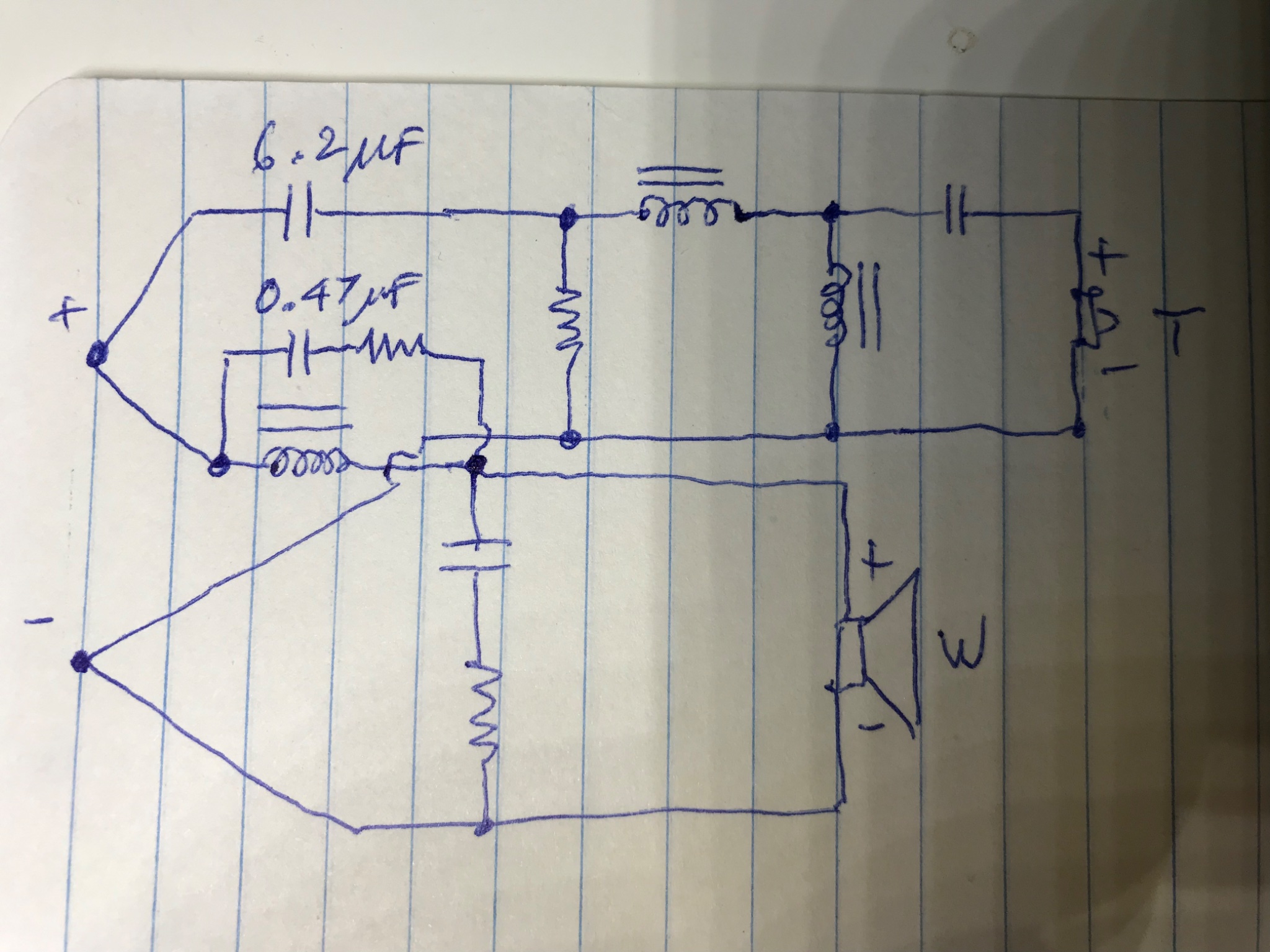

You can fill the values of the remaining components.

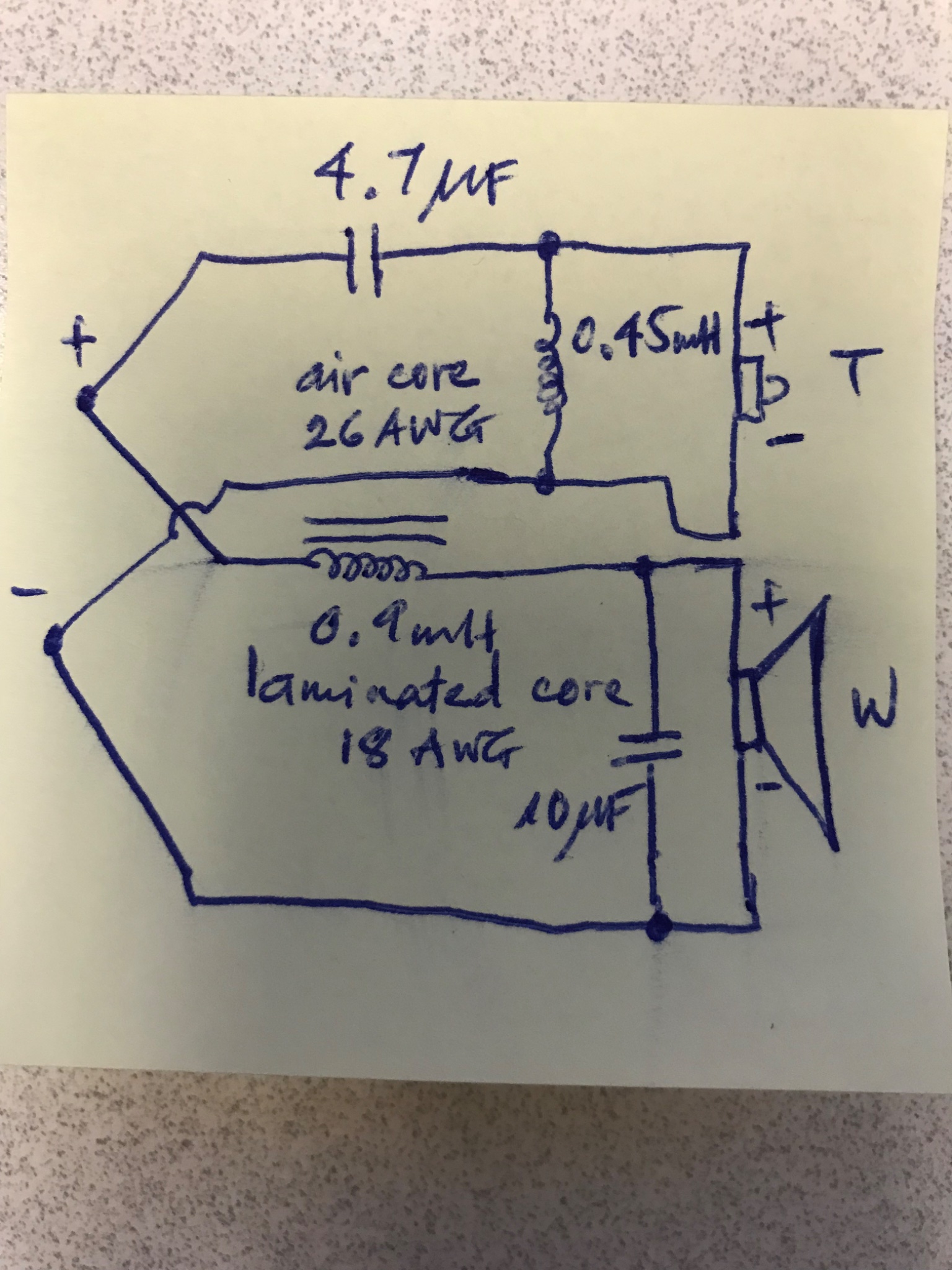

Given the non-critical task that these speakers are being asked to perform, I'd be greatly tempted to remove the damaged crossover board by disconnecting it from the speaker input terminals.
I'd simply connect the mid/bass driver directly to the input terminals then also connect the tweeter to these terminals, but via a series 4.7 uF NP capacitor. https://wilmslowaudio.co.uk/monacor-mkp-polypropylene-capacitors/47-fd-monacor-mkp-capacitor
There would be no harm in trying it, Simon!

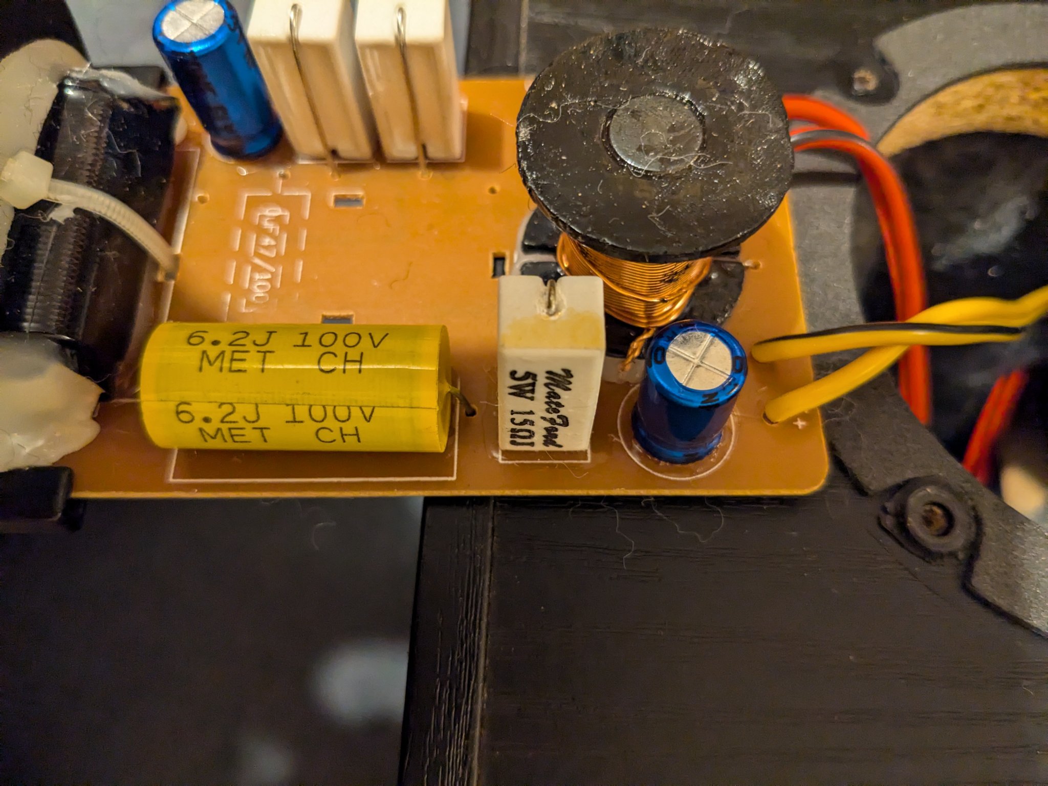

P.S. You could use the 6.2 uF that's on the board in a preliminary test.
Thanks for that idea..
As for the 15uf Cap, it states to be +/- 5%, so not sure what I can do.

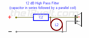

To be certain, we would connect a 3.3 uF capacitor in series with the positive tweeter terminal and a 0.22 mH air core inductor across the positive and negative tweeter terminals.

I would need more information before commenting. Which Diamond? Photos of crossover board?
N.B. Repairing the original Mercury crossover is obviously the best course of action provided you can find the correct components to replace the damaged ones and can patch up the damaged PCBs. I was merely suggesting a a simple fix to get the speaker up and running in a way adequate to its application.
