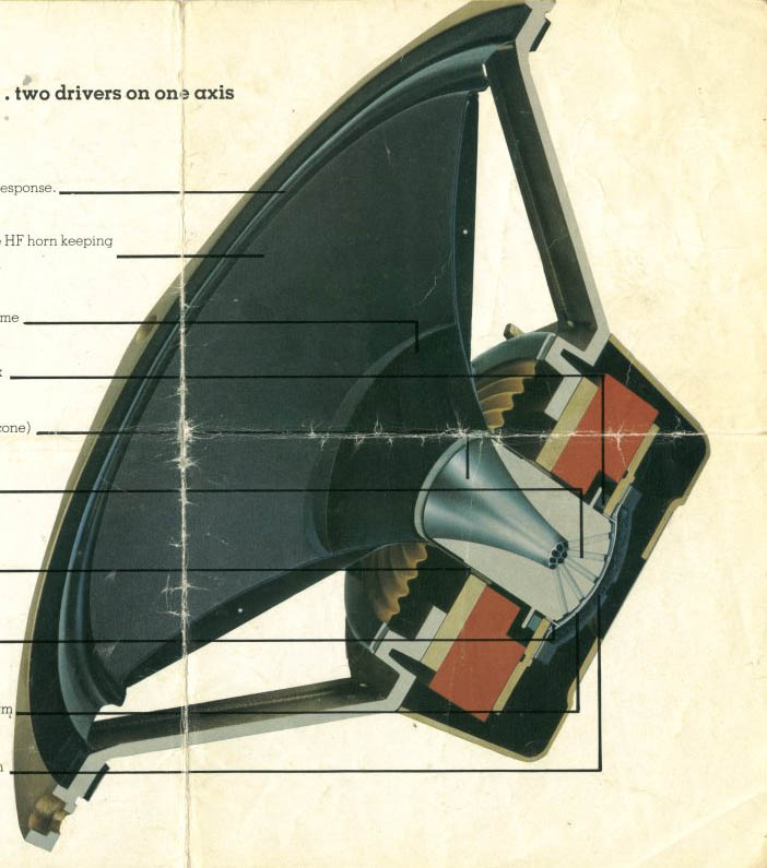

The reason this came up was that I have just started a Part time degree in Design, and the workshops in college are fully equiped for plastics and ceramics, as well as the usual wood and metalwork stuff, and to me the obvious easy thing to have a play with would be a mid/high horn.
Having owned a pair of Tannoys years ago, I remember well the sweet sound of the horn loaded co-ax, and I thought this would be a good place to start playing with my own designs. The idea of simply copying the flare rate of the cone looks do-able, but what I would really need for that is a photo of one of those half sectioned drivers that used to appear in marketing stuff.
I will probably be using a JBL pro compression driver for first experiments, maybe upgrading to the TAD if successful!
However, to broaden the subject, if anyone has any info on making compression drivers, that might be fun to have a go with as well:devilr:
Your wish is my command.

The curve in the section looks kind of like a section from an ellipse. Are you thinking about tractrix at all?

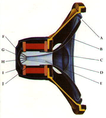

Hey Brett great pic! Since I own 3 of these beauties HPD385) I would love to have tis pic in higher resolution(to my email ) as I am about to totaly dissasemble it for cleaning and adjustment but the mafnet is hard to open, I thought a pic of the inside might help me to se why.
Panos

Send me a PM with your email addy and I'll send them off later.
If you go to the Keiwa site, and scroll down to "Roll Surrounds, Driver Construction, Crossovers, & Curiosities" there are a couple of links where an HPD has been disassembled for surround replacement. These might show you in more detail what you're looking for. Lots of other cool Tannoy stuff on the site too.
There is also another cross-section pic here
You may be right, but until I can get them drawn out properly it's hard to tell. As for the format and final results, I have no preconceptions about what I will produce yet, it is a long term project after all. The only thing I think I will insist on is that it is an axisymetric design, I have heard far to many honky sounding other types to even consider them.
