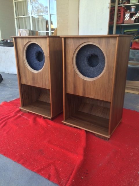

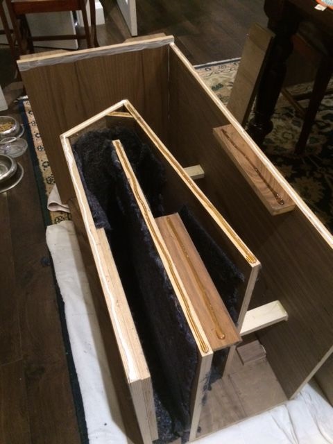

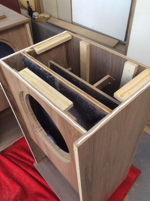

My 10th pair of GRF's...this one in American Walnut, on Euro Birch ply. Extra bracing.
Denim/wool lining.
Plinths 50mm.
Monitor Gold's 15's, with standard xovers.
Sounding fantastic.
Denim/wool lining.
Plinths 50mm.
Sounding fantastic.

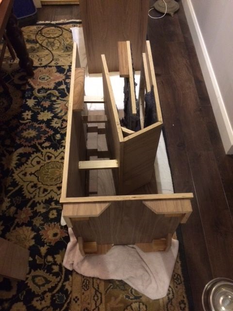

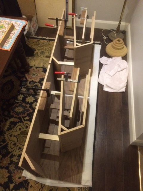

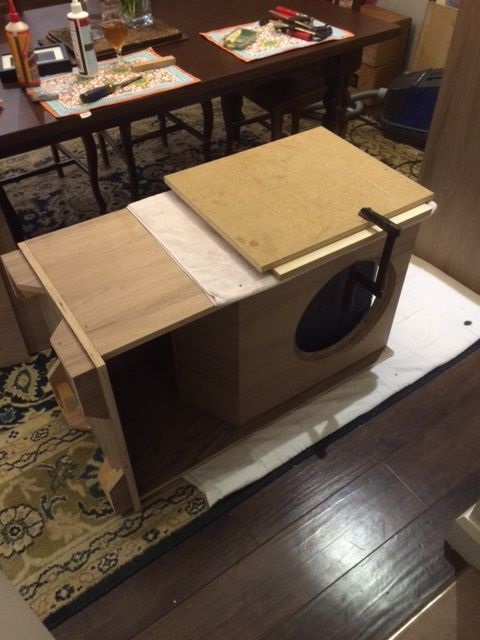

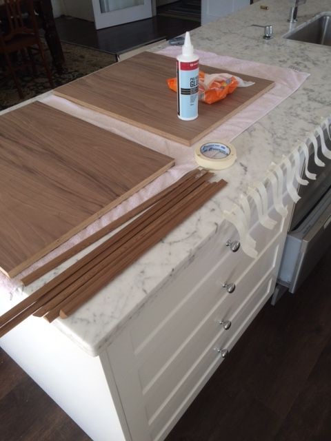

Beautiful!

Charles, I've built these for others...not mine...though I quite enjoy the 'grumbly' nature of the bass.

Andrew, these are beautiful. Thanks for sharing. I'm something of a huge sucker for all things walnut, to boot. 🙂
