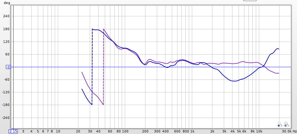

Here's a phase measurement I made of my Precision 6's (in blue) overlayed with a MarkAudio CHR-70.3 in a DCR box I built (in purple) using a swept sine technique in REW.
Clearly their brochure is misrepresenting their product.
It should be noted this was an in-room measurement with both speakers in the same spot and the microphone in the same spot. Room colourations should be viewable as bumps/dips that appear in both lines.

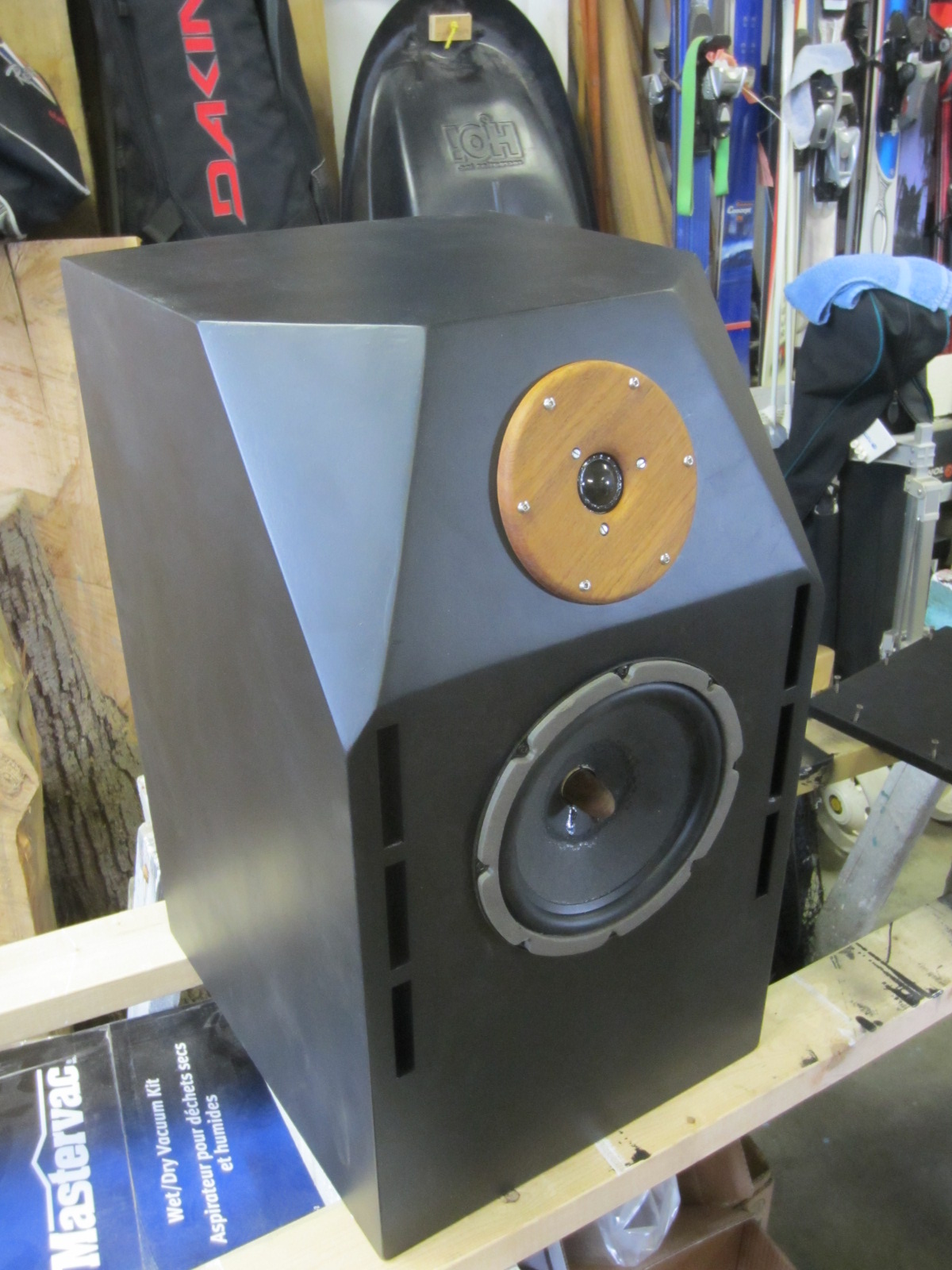

Additionally, another method for recessing the acoustic centre of the tweeter (provided the dispersion of it is good) is to angle it upward. I tried this in a different build of mine as pictured below.
Hi and thanks a lot for the extremely interesting graph.
But it is really so different from that of the brochure ?
As you say the measurements depend from room features so maybe the testing room of Tannoy was different.
They seem to me quite comparable results.
Very interesting but i was thinking about the centers of emission alignment thing.

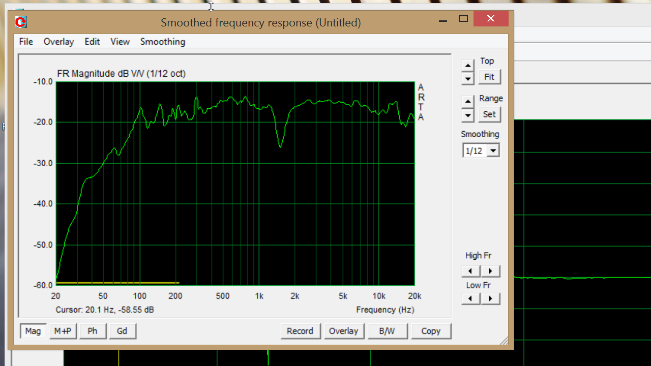

I was never quite happy with my System 800s, I felt they had a weird recessed, phasey quality to the midrange.
I recently measured them and found they had a 10dB notch over about 1/2 octave at the crossover frequency
I hope this is a factory quality control issue and they are not all like that.

I would try to get the freq response of only the tweeter connected without filter and see its flatness and the effect of the waveguide on its response
Is it possible that this 10dB peak comes from the waveguide ?
Maybe a new x-over could be the key to a more balanced sound.

Hi and ok i have found the response and filter.
I was thinking completely to something else much more serious
For me wrong x-over it is clear
You should extend the response of the woofer to fill the gap in the freq response changing some values in the x-over.
If you manage to find the TS parameter of the two drivers just design another one very basic and the sound will be perfect.
I was thinking about some nasty peaks but there is no things like that.
Good to know also for me ... nice response. Only wrong values of some parts in the x-over.

The graph I posted was a phase resonse graph, not a frequency response graph. Judge apples with apples, not apples with horses.
Edit: just noticed the article you linked has one phase graph that has very different scales than the graph I posted. The speaker in question in that article seems to have a similar but better phase response than the Tannoys, assuming the same general measurement process.
The graph I posted was a phase resonse graph, not a frequency response graph. Judge apples with apples, not apples with horses.....

I believe your last question was answered in post #4 of this thread. The Tannoys aren't horrible, just not the best and particularly not as good as their advertising suggests/claims.
