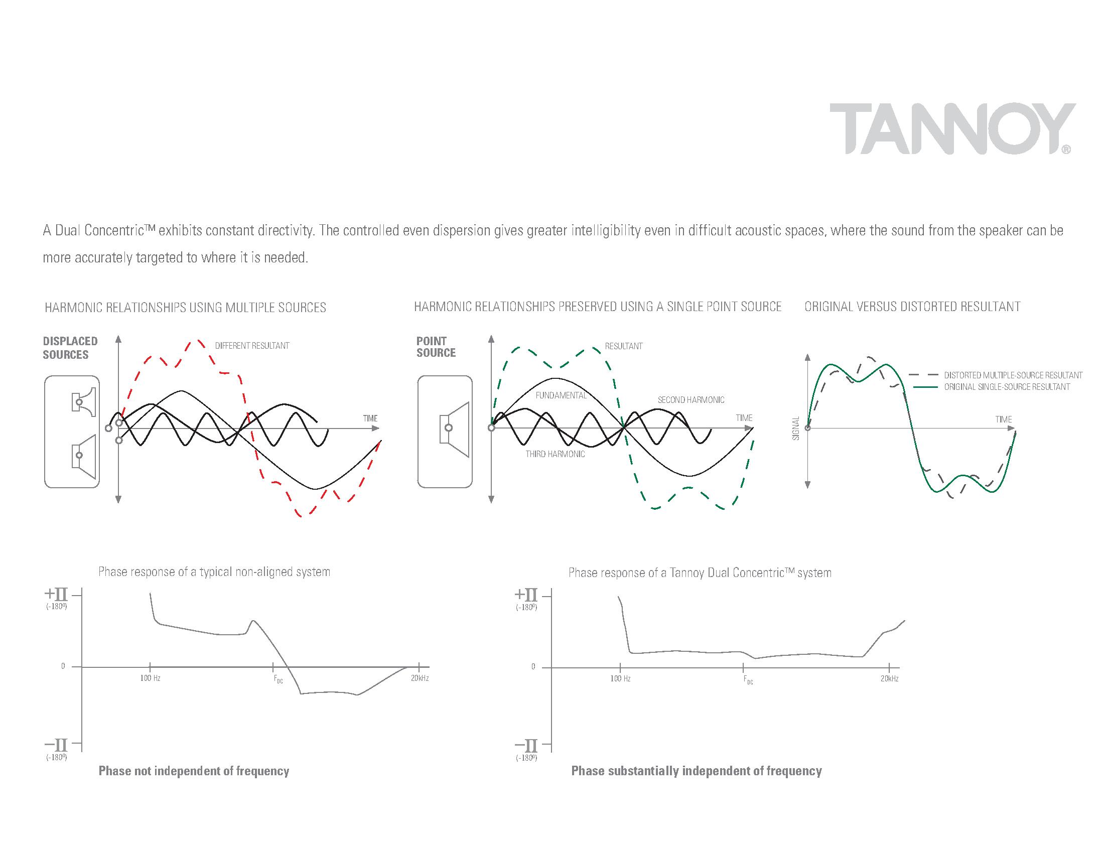

Hi looking at a brochure of Tannoy Precision line speakers i found the graphs attached
Is it true that Tannoy coaxials give a such good phase response ?
is it an important characteristic ?
Thanks a lot for any kind advice, gino

From the measurements I did on my Tannoy System 800s, their time alignment seems worse than a traditional 2-way box speaker, at least on-axis. The acoustic centre of the HF driver is about 2 inches behind the LF one giving a considerable time delay.
KEF's Uni-Q driver has better time alignment, as they stuck the tweeter on the end of the woofer pole piece.

The time alignment i can understand more easily. It is the delay between the drivers. The signal coming from one driver reaches the listener at a different time of the signal coming from the other driver ... this is fine.
Phase response is a very difficult concept for me to understand.
And also i do not know if it impacts sound quality.
But as i have big respect for Tannoy brand, if they show this very good phase response of their speakers i think it must be worth something.
Thanks again, gino

These are conceptual drawings, not measurements. It just shows the time delay on a tweeter is reduced by mounting it coaxially. Also they are mistaken, you want LINEAR phase, which can be a line with a slope, not constant phase.
Linear phase is equivalent to a constant time delay.

Time alignment and phase response are not the same thing but they are closely related.
I think the phase response of a dual concentric driver must be pretty bad unless the crossover was specially designed to straighten it out. Tannoy don't do this, they use quite simple crossovers.
There is no proof that phase is audible, but that doesn't stop many speaker designers believing that linear phase response through the midrange makes a speaker sound better.
I am mostly interested in the phase response not time alignment unless they are the same thing of course.
Well, the phase response and time delay are not the same, but they are related. A pure time delay causes a linear phase shift as seen on a graph.
Other aspects of a system can cause other phase shifts, and they add to the pure time delay. Of course, if the drivers are not mounted in a coaxial fashion, the pure time delay will change depending on which driver is operating. This is why coaxial mounting is done, to reduce this problem.
The old DC Tannoy arranged that the phase response from the crossover and the drivers were such that at the crossover frequency the treble was ~3" earlier than the bass.
That ~3" is the distance that the effect source of the treble is behind the effective source of the bass.
i.e. at crossover the two signals are in phase.
