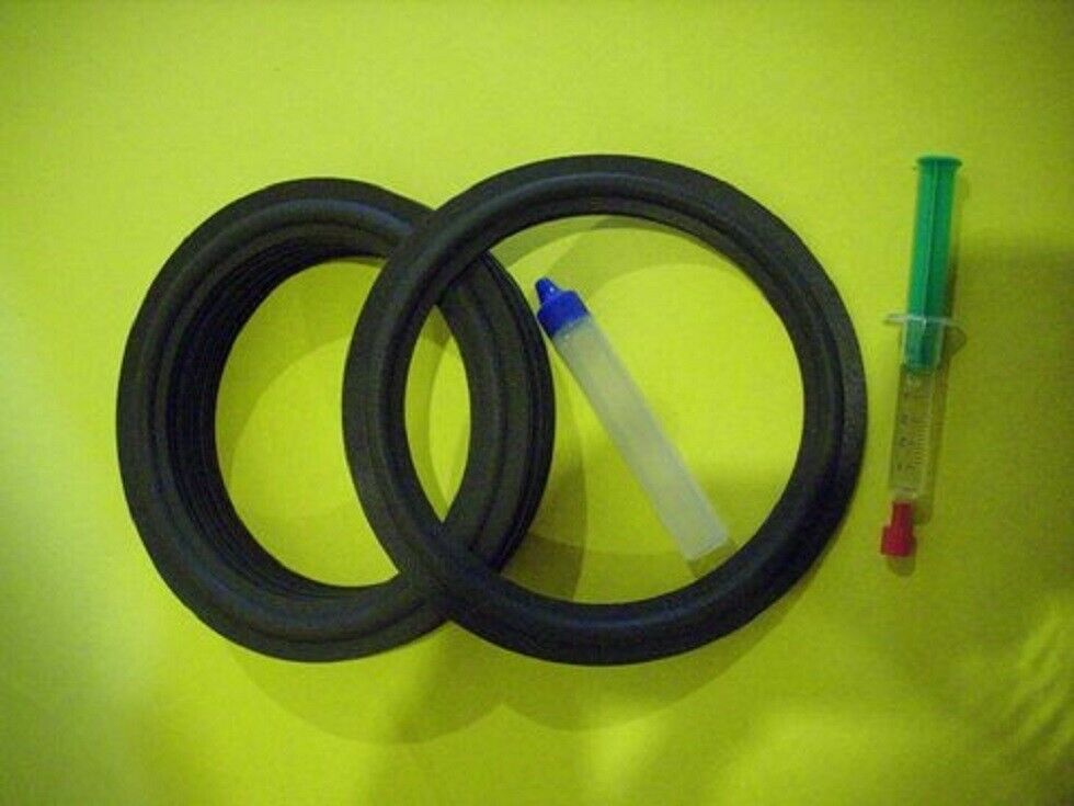

Ok, cancelled those foam surrounds, will send them back on Monday. Ordered some black silicone gasket instead.
Tried to buy it in some local stores at first, but nobody even knew what I was talking about. So this American bookstore 'a????n' should ship it soon.

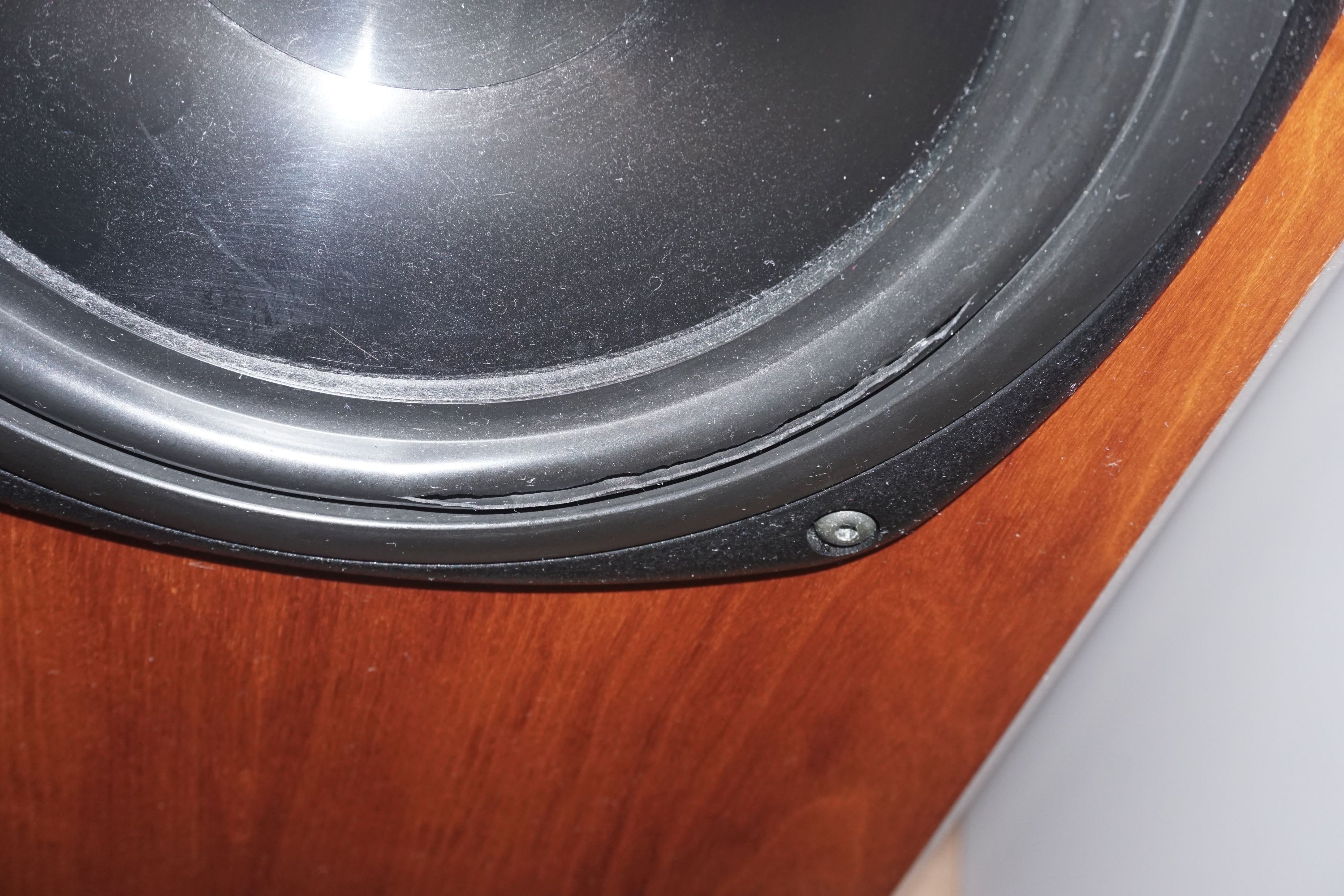

Ok, I started with a little experiment, just to get used to handling the product. Produced a 'simulated' surround cut, which I then tried to fix.
My simulated cut was much wider than the original one in the speaker, on the other hand, the speaker surround is much more flexible than my experimental foil.
It turned out that I would have to work really fast. After a minute or two the 'gasket maker' began to dry on its surface, while still smelling. On a soft surface, the sealant isn't easy to handle, this will be even harder on the speaker itself.
After about two hours I could hardly smell the solvent anymore, I have to say: it was a warm summer day with inside temperature well above 20 deg Celsius.
After drying over night, there was no smell anymore, the sealant had stayed perfectly flexible, and I really had to work a bit with my fingers to peel the sealant off the foil. Seems to work!

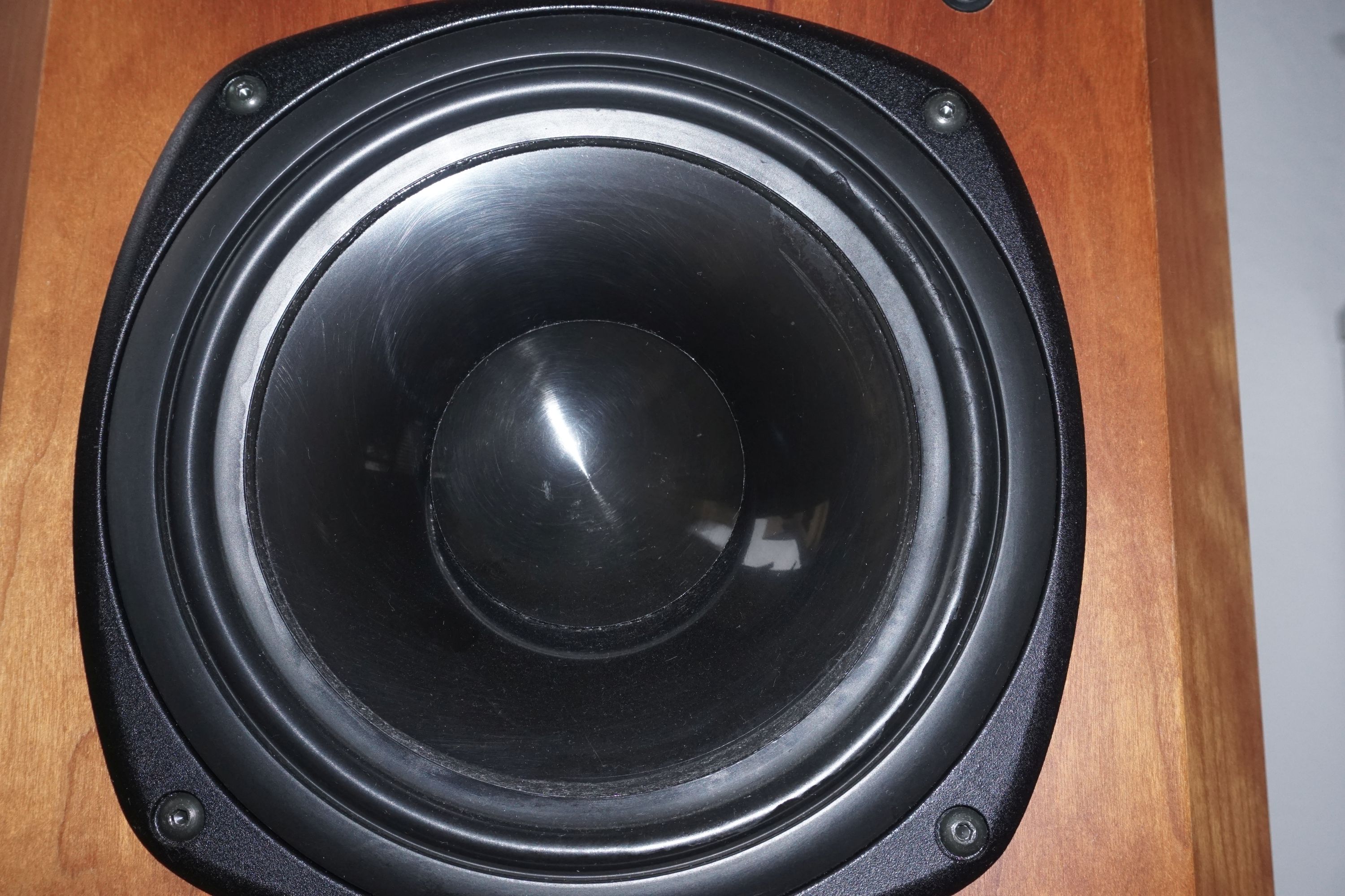

Now for my speaker!
On the table, the cone tended to drop around 2 mm downwards, so I added a bit of support before applying the sealant.
In German we call this tool 'The Third Hand' - what's it in English, by the way?

It wasn't really simple to apply the sealant on that soft surround, and the high flexibility of the surround prevented me from creating a really sleek surface. Well, the speakers usually are hidden behind the black grills, so form follows function, again!
Applying it from the backside - which was my plan - did not work out, because I had no backside access to the surround because of the geometry of the chassis.
After drying over night, all seemed ok. No smell, and carefully moving the cone forced no damage.
Now, after several days of test use, everything is still ok and I'm really satisfied with the result. The surface of the sealant might be a little nicer in the end, but this was really hard to achieve.

Thanks again for your hint! But unfortunately I cannot recommend buying surrounds from this guy. Communication with him suggests the assumption that he does not care about the material of the surrounds needed. He just sends out foam all the time.
After returning the kit to him, he blamed me for 'ordering wrong'.
I had to send a second, more sharply-worded reminder to finally receive a refund.
