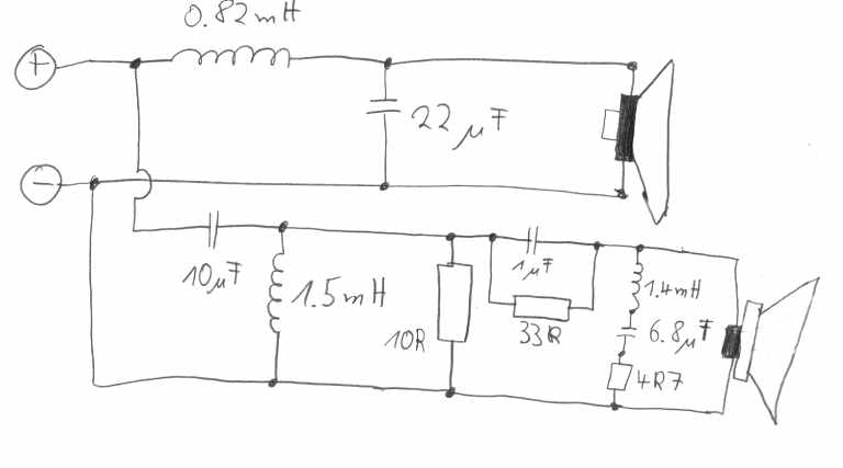

I am quite a newbie and need some help. I am looking for a crossover schematic to be used with a Tannoy K3149 driver. To my knowledge this driver was used back in the 1980's in the super red monitor spreakers.

Hi Alois,
I had the same problem when I got the drivers with a cabinet, but without xovers. I got some schematics, but wanted to avoid the step/down/up transformer choke. This is what I made then:
