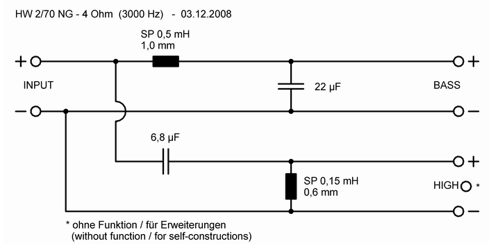

An off-the-shelf 8 ohm crossover looks like this:
532776d1456062082-classic-monitor-designs-visaton-hw2-70-crossover-png
A 4 ohm looks like this:
511639d1446156212-crossover-aura-ns3-tymphany-bc25sc55-stock-4-ohm-crossover-png
Crossovers | Visaton
You'd be lucky if that 8 ohm one works well with most speakers, and it would need some resistors for level. Might be OK with a 4 ohm bass IMO.

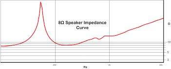

The total opposition to alternating current, or impedance, of a loudspeaker driver is the sum of its DC resistance and its inductive reactance, both of which are measured in ohms.
Now, the impedance of a loudspeaker driver is not a fixed value since the inductive reactance part varies with frequency.
Loudspeaker designers have to measure the exact impedance of the driver at the crossover frequency. The nominal impedance figure (e.g. 8 ohm) given in the specifications is only given as a rough guide to aid your purchase.
