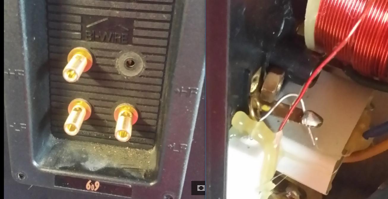

Got a pair of 609's Mk I and still working well. I lost one of the speaker connectors (or a child did!) and had to put another connector type on which over time has made that post come loose as it was not a good fit.

Hmmm, ok, maybe a photo helps, here is the back of the mk 2, looks like the terminals have a solder weld and that is it? So I could take my 609 apart and have a look and see if it is similar...
Looks like a bi-wire terminal. And it appears that installing new ones would just involve a nut driver… the soldering looks to be on a tab that gets bolted to the terminals. On the face of it i'd guess they are not standard ¾" spacing so you would need 8 individual terminals (best to replace them all). If they are ¾" spacing then 4 dual terminals

Dave, took back off, nut was loose on the back but am still missing the banana bit, terminals are 25mm apart, so looks like 8 individual terminals or ebay to find some parts to match the existing ones.

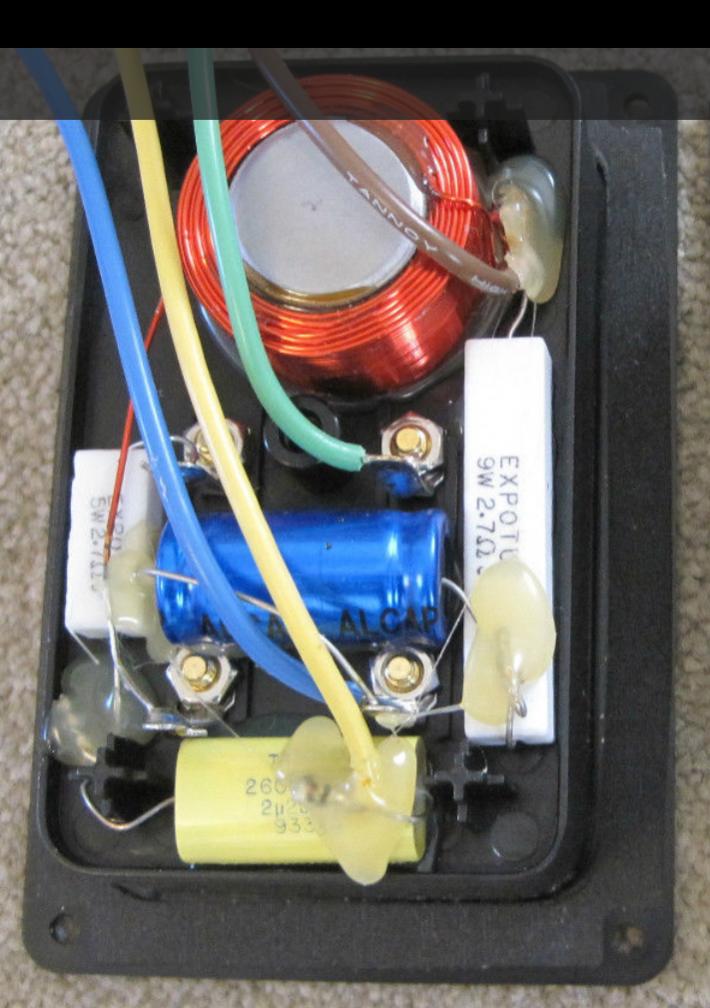

So I ended up buying some 2nd hand Tannoy 609II crossovers. They arrived and look in excellent condition, better than my 609 ones.
So am thinking of a small diy, swap out my old 609 crossover for this one and see how that sounds?
Is it as simple as unscrewing the driver and tweeter and I will find 4 connectors, yellow blue green and brown!?

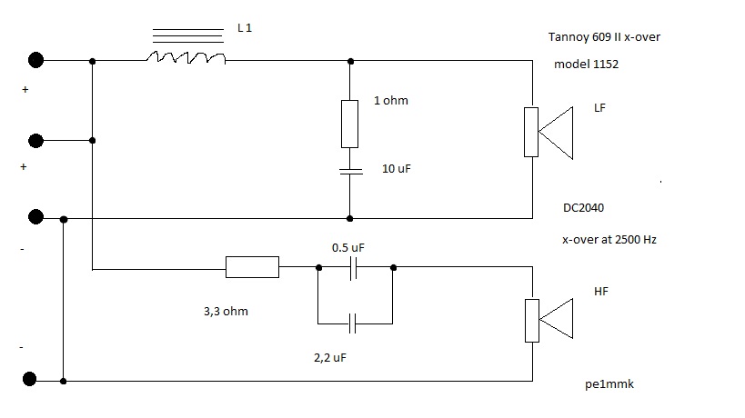

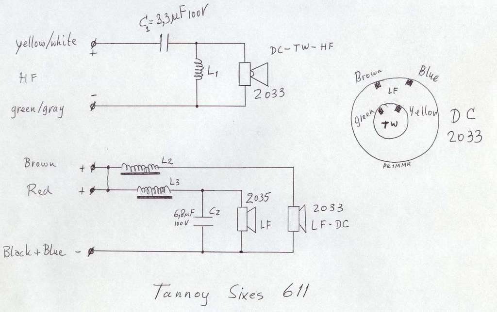

"The model 609 uses the DC speaker DC2033 and the 609 type II uses DC 2040"

I wish I had your Xover in my hands right now. I'd have it fixed in two minutes. 😀 Just buy a nice quality Speaker Banana binding post from an Electronic supplier or even Ebay and fit it to where the old one was. (use a socket to tighten it). It will not match the others but will work perfectly. Then you are using the original Xover and all is well.
On the inside of the crossover there is some clear almost translucent glue on the nuts which seems to keep them from coming undone. What would this be so I can buy some?
Thanx for the pictures irext. If the V1 indeed has a dual voice coil (and uses the coils differently) and the V2 does not, then the new XO is not really suitable at all. That makes the new XO a waste.

Yes, I already gave up on using the new crossover. Before I close it up, was going to put some of this translucent glue on the nut to make a good job of it, what would that be?
