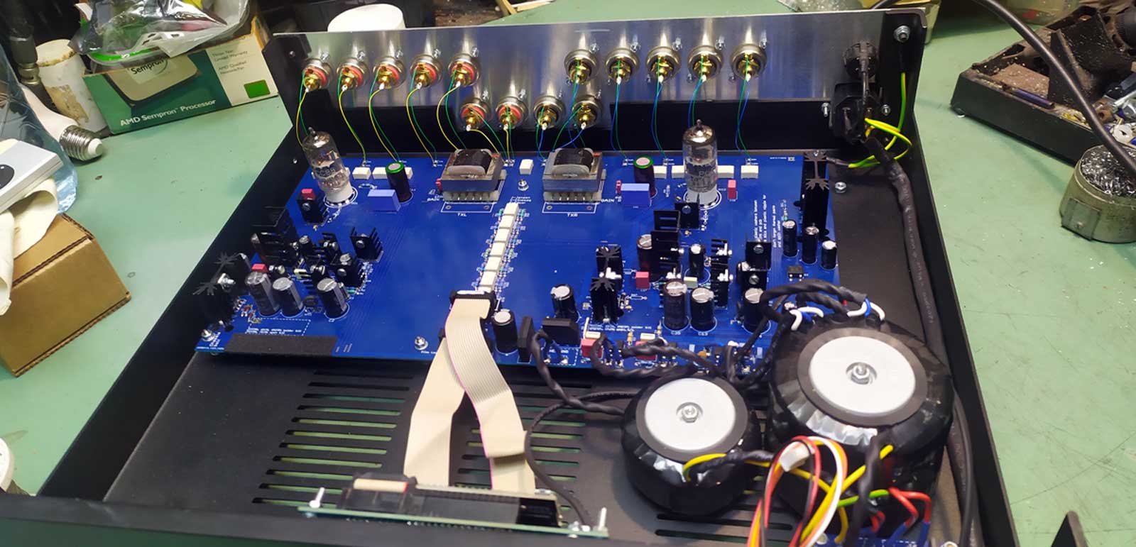

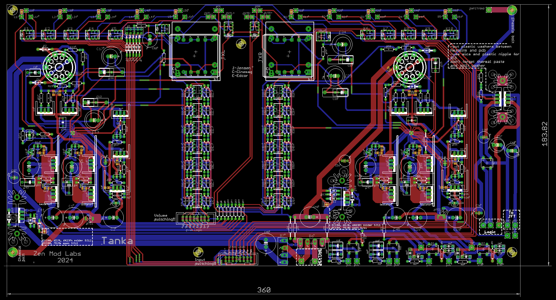

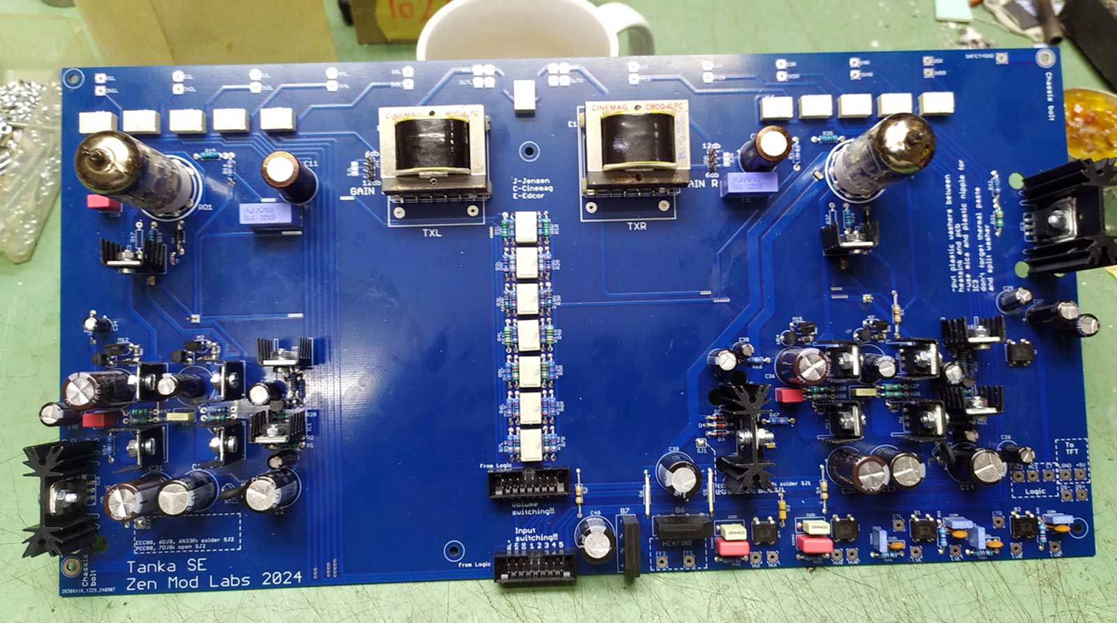

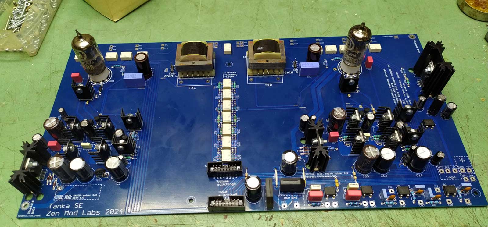

Tanka ........... SE and Balanced preamps, presentation
Official Court Jester
Joined 2003

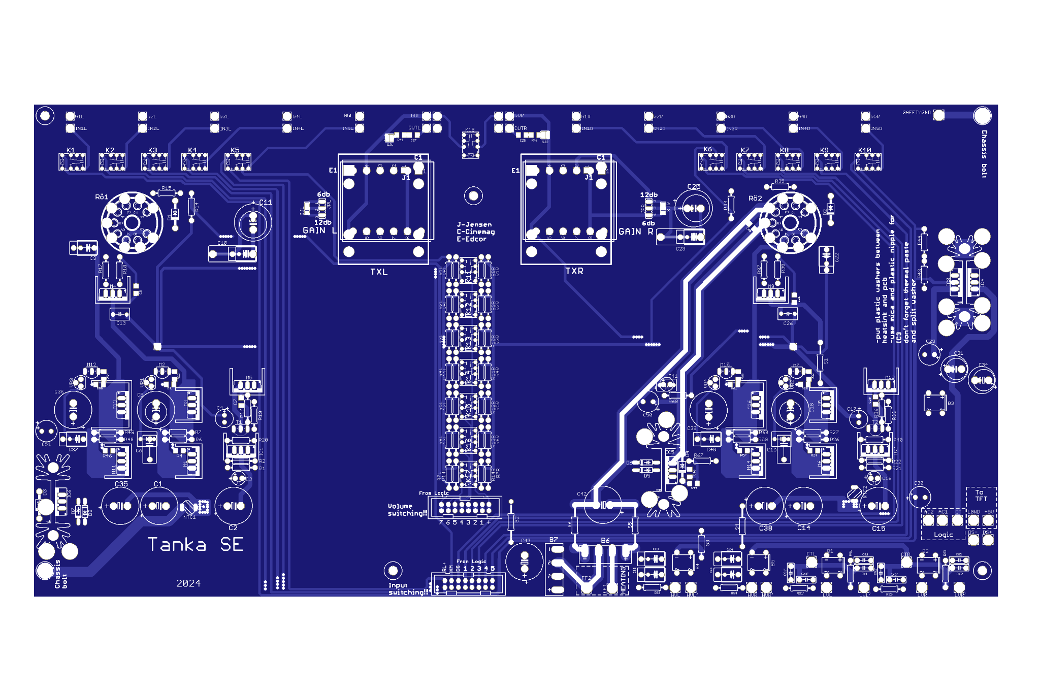

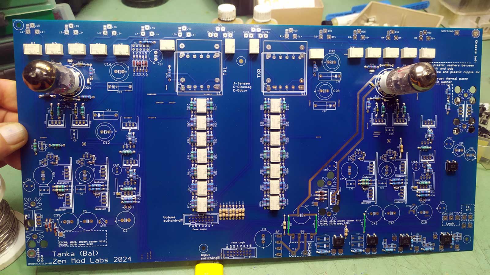

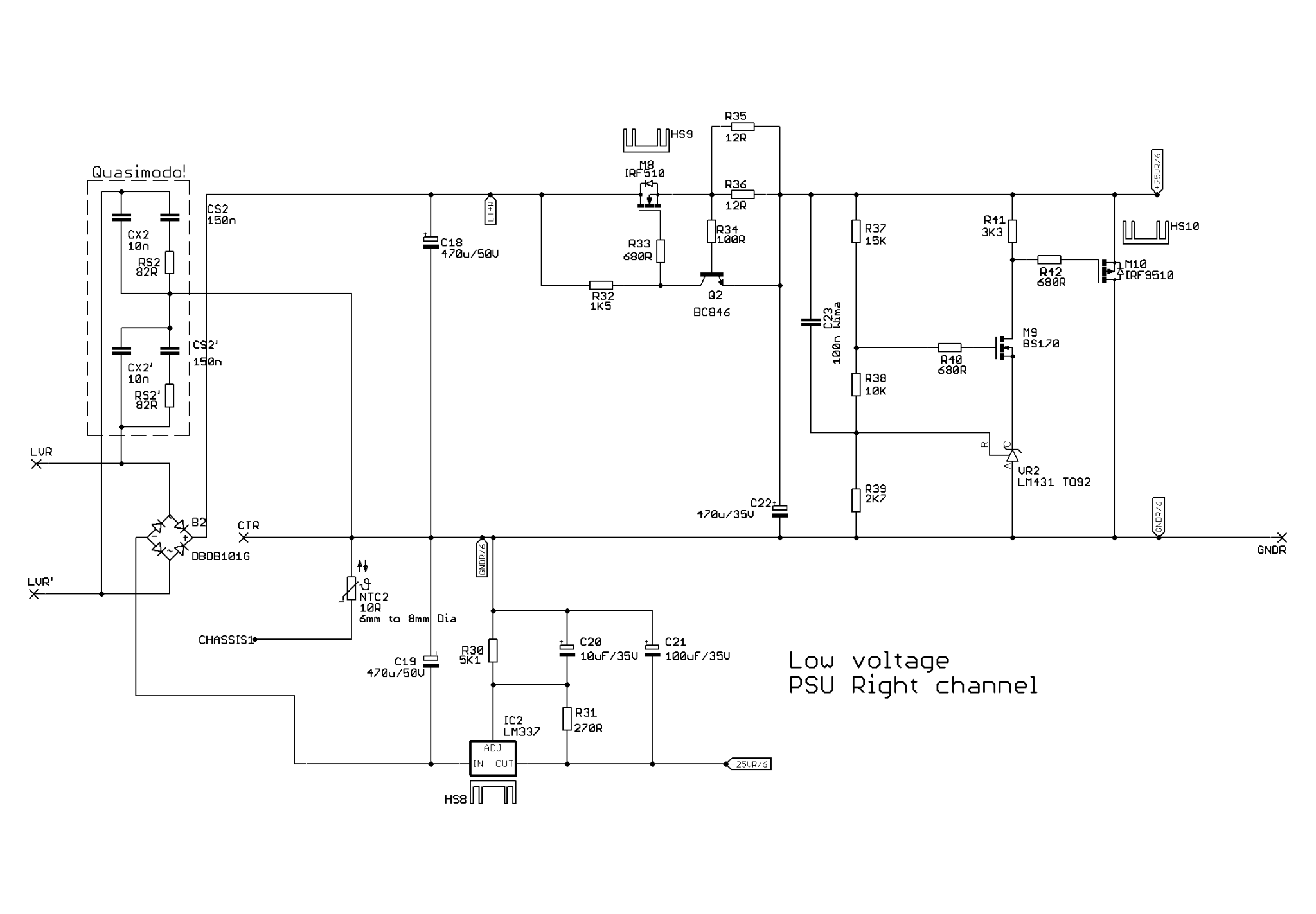

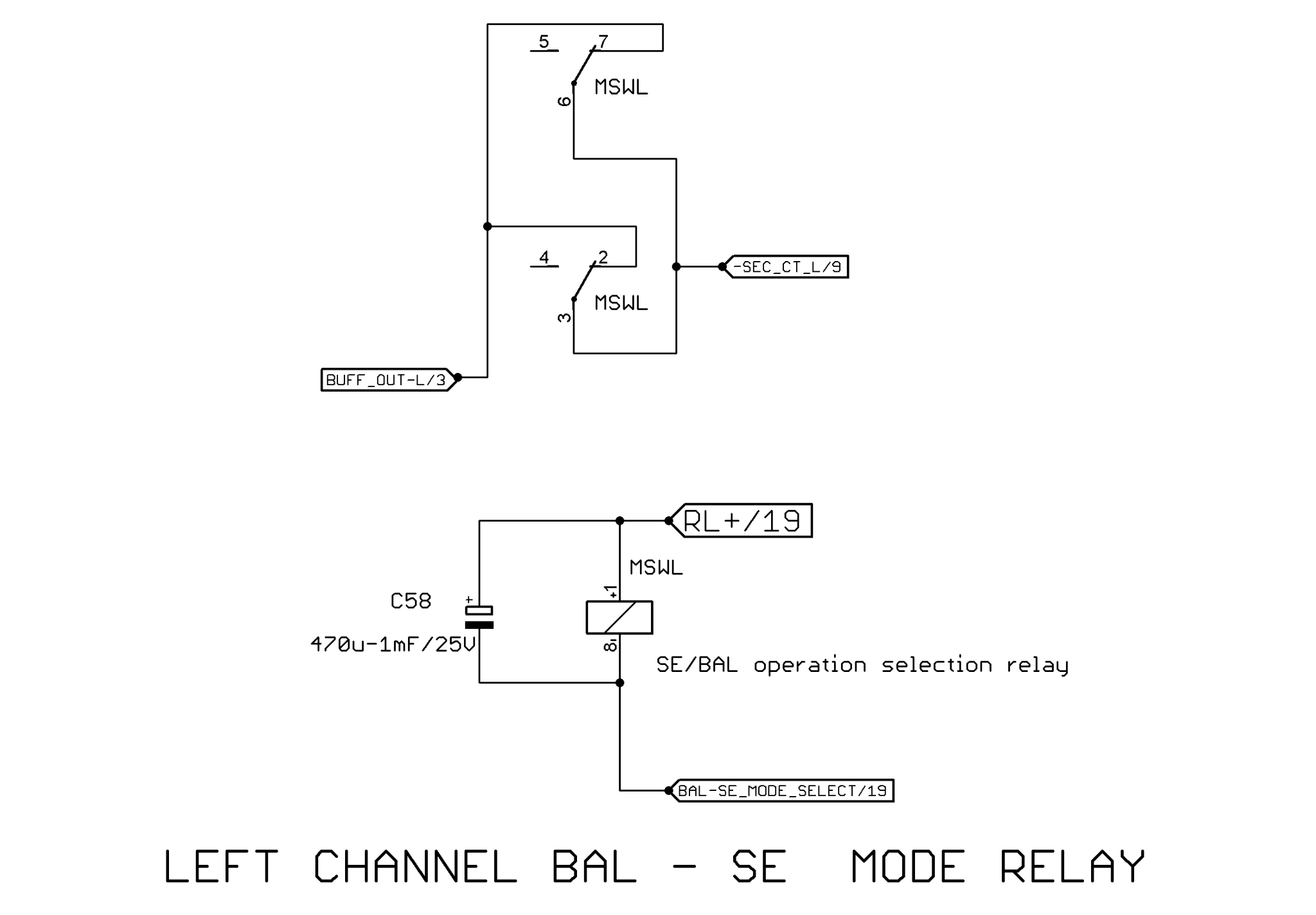

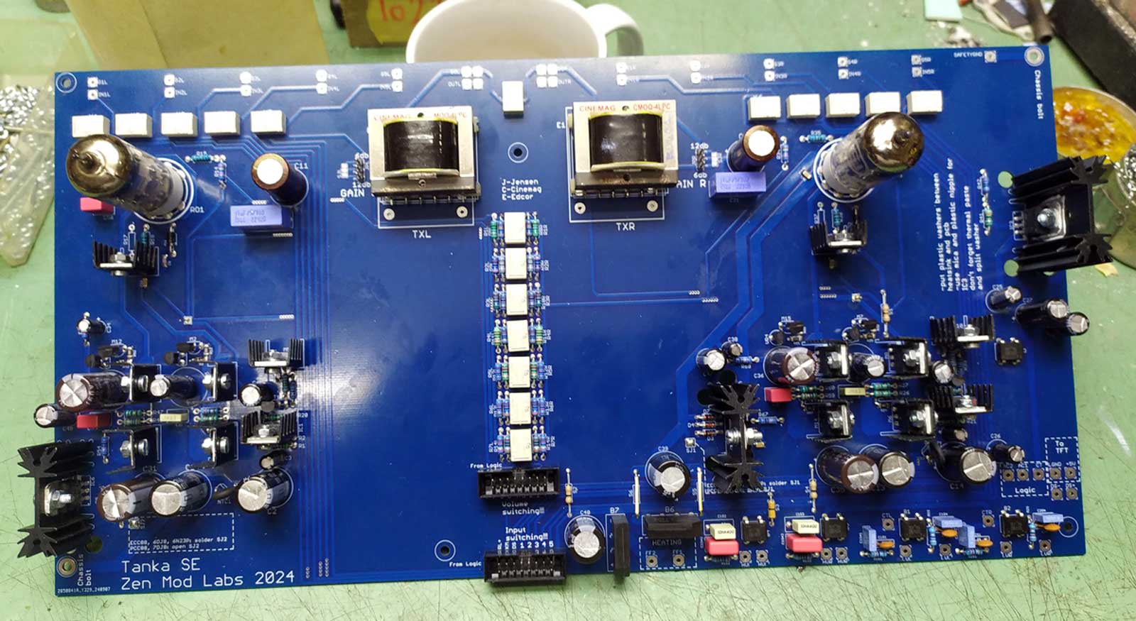

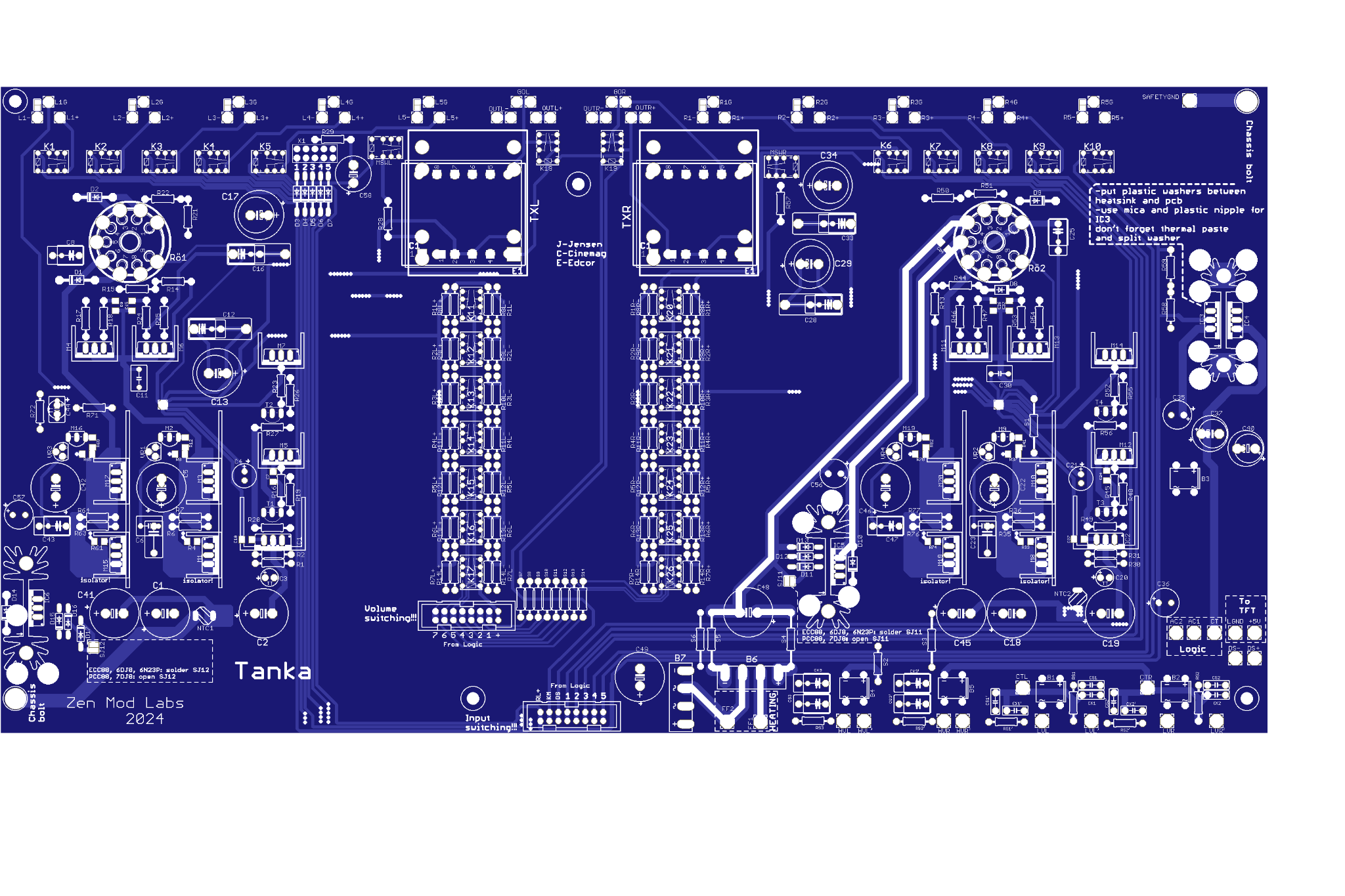

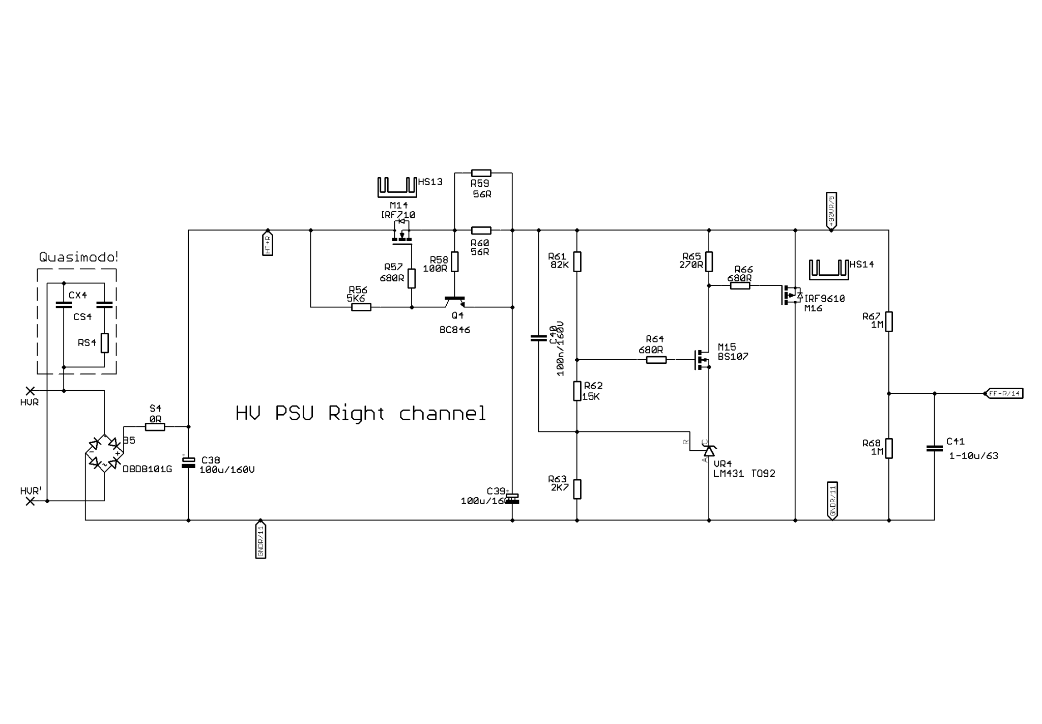

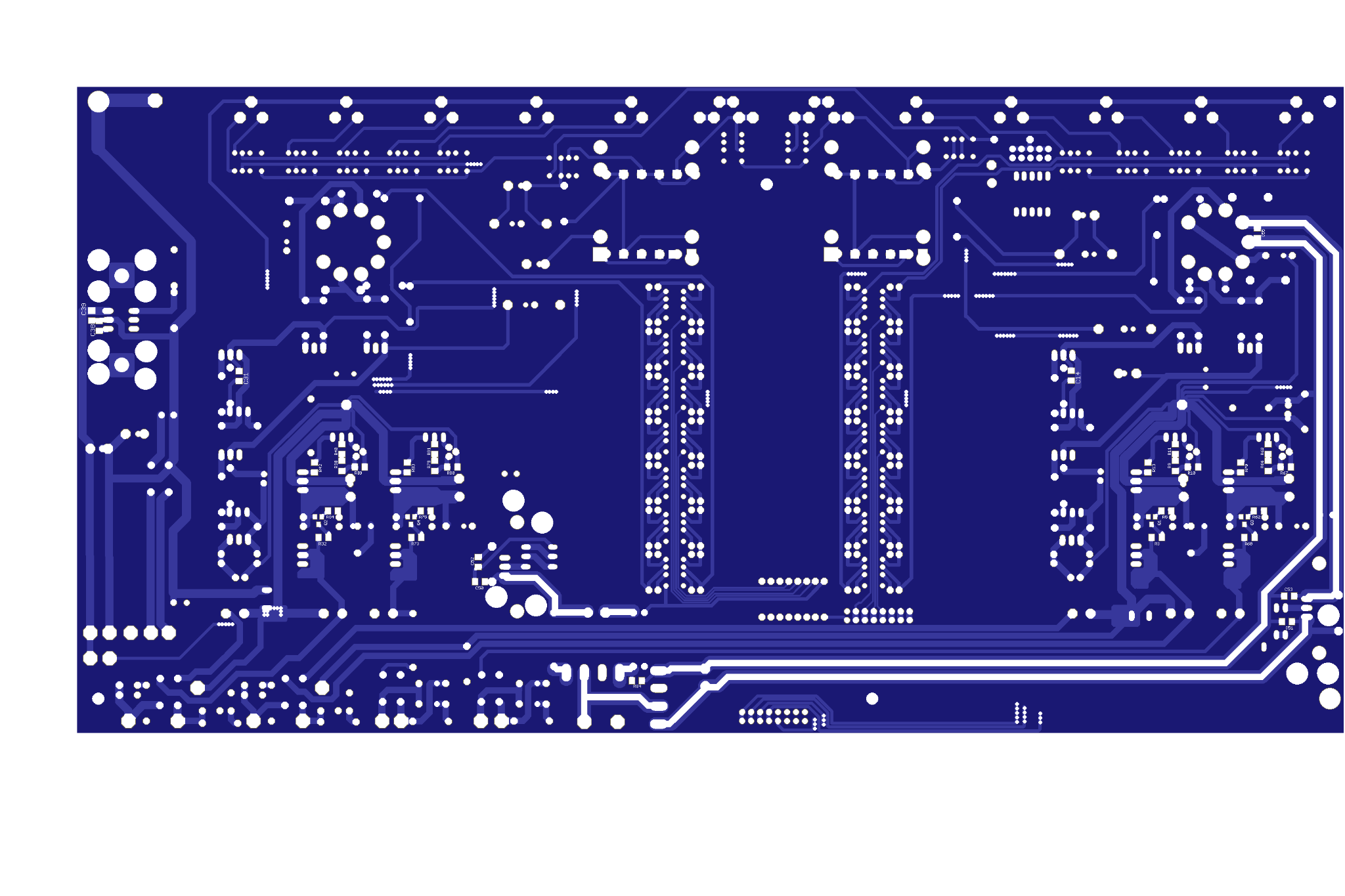

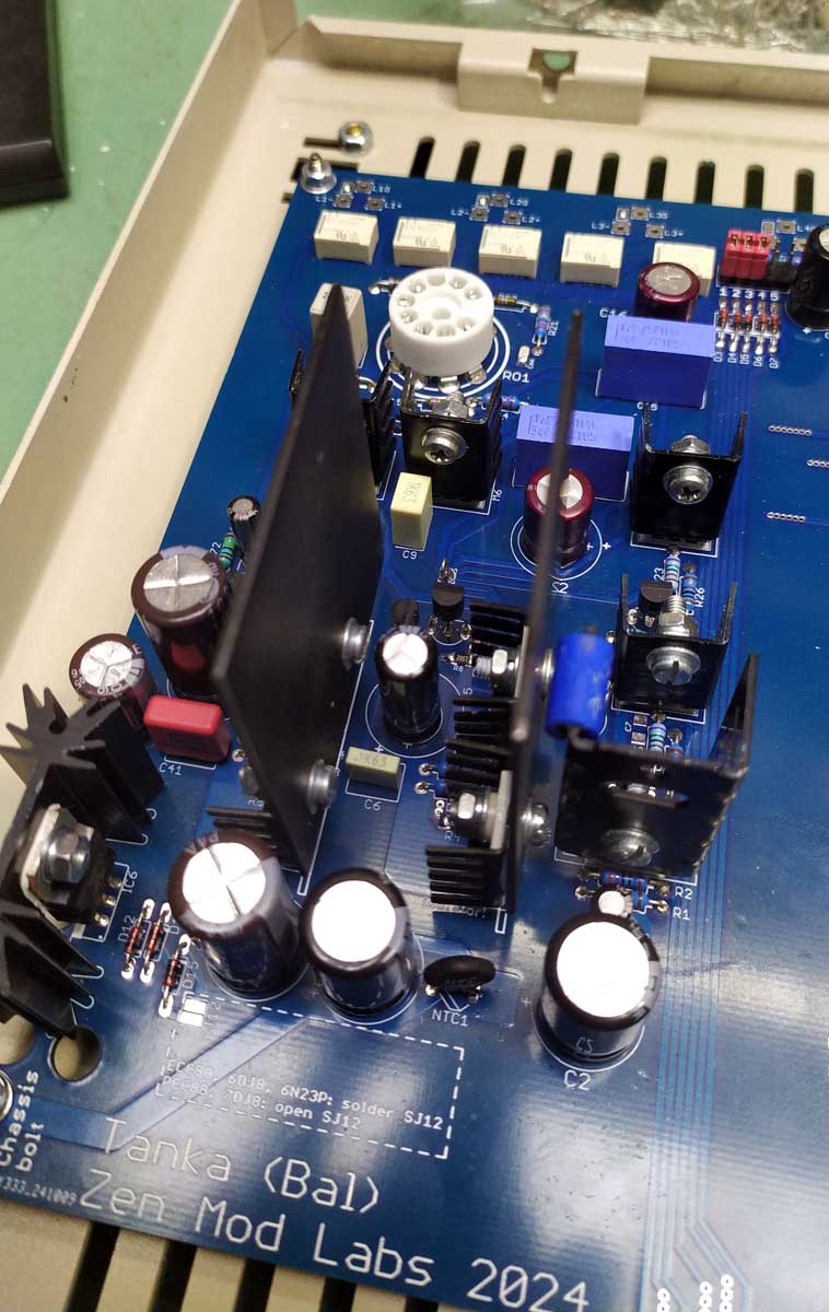

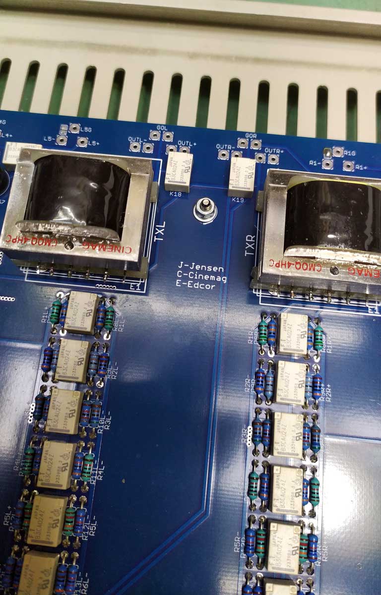

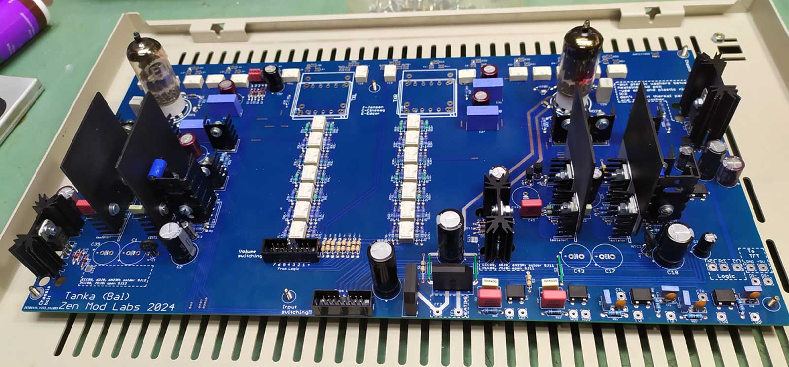

As title sez - one name, two preamps.

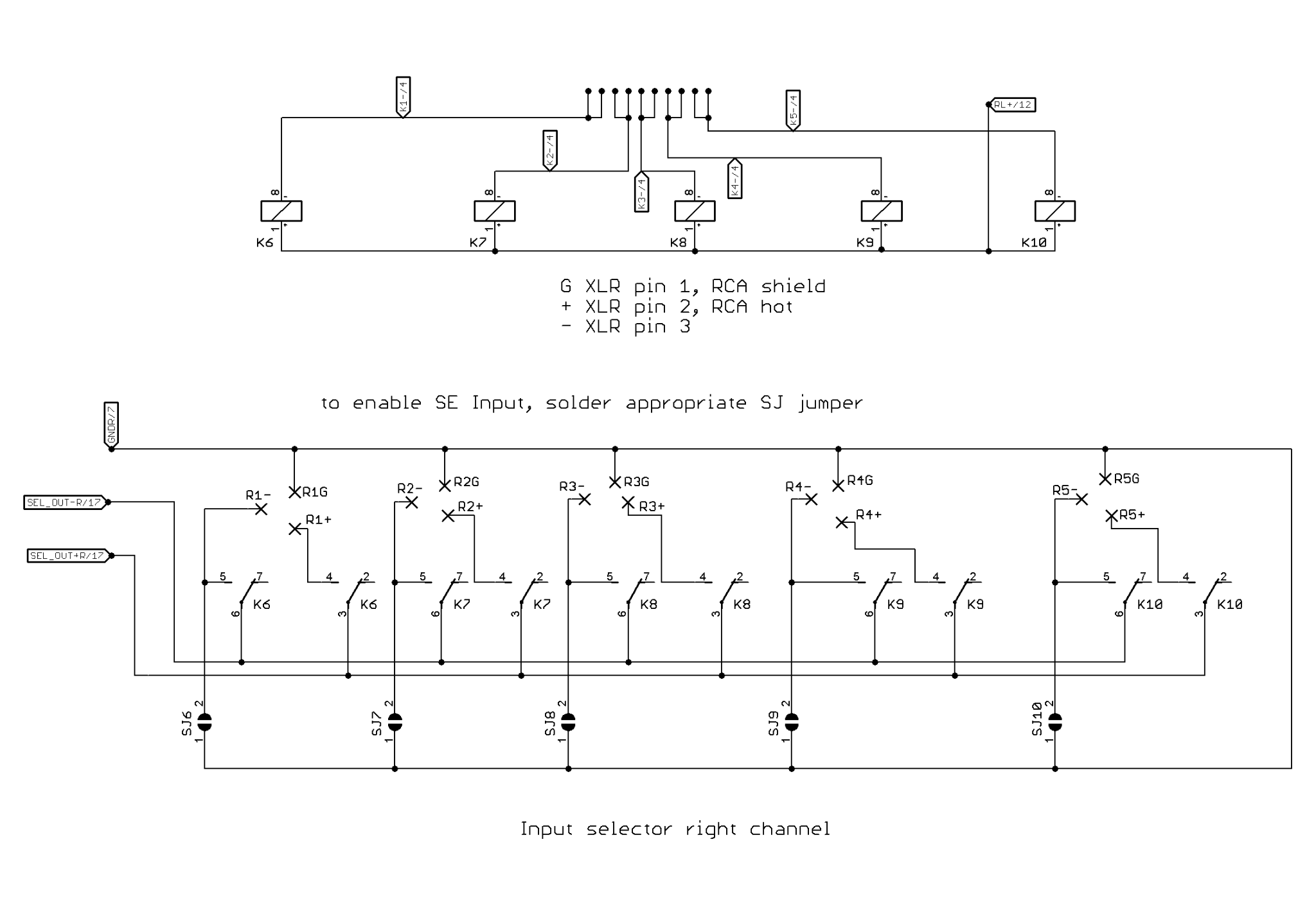

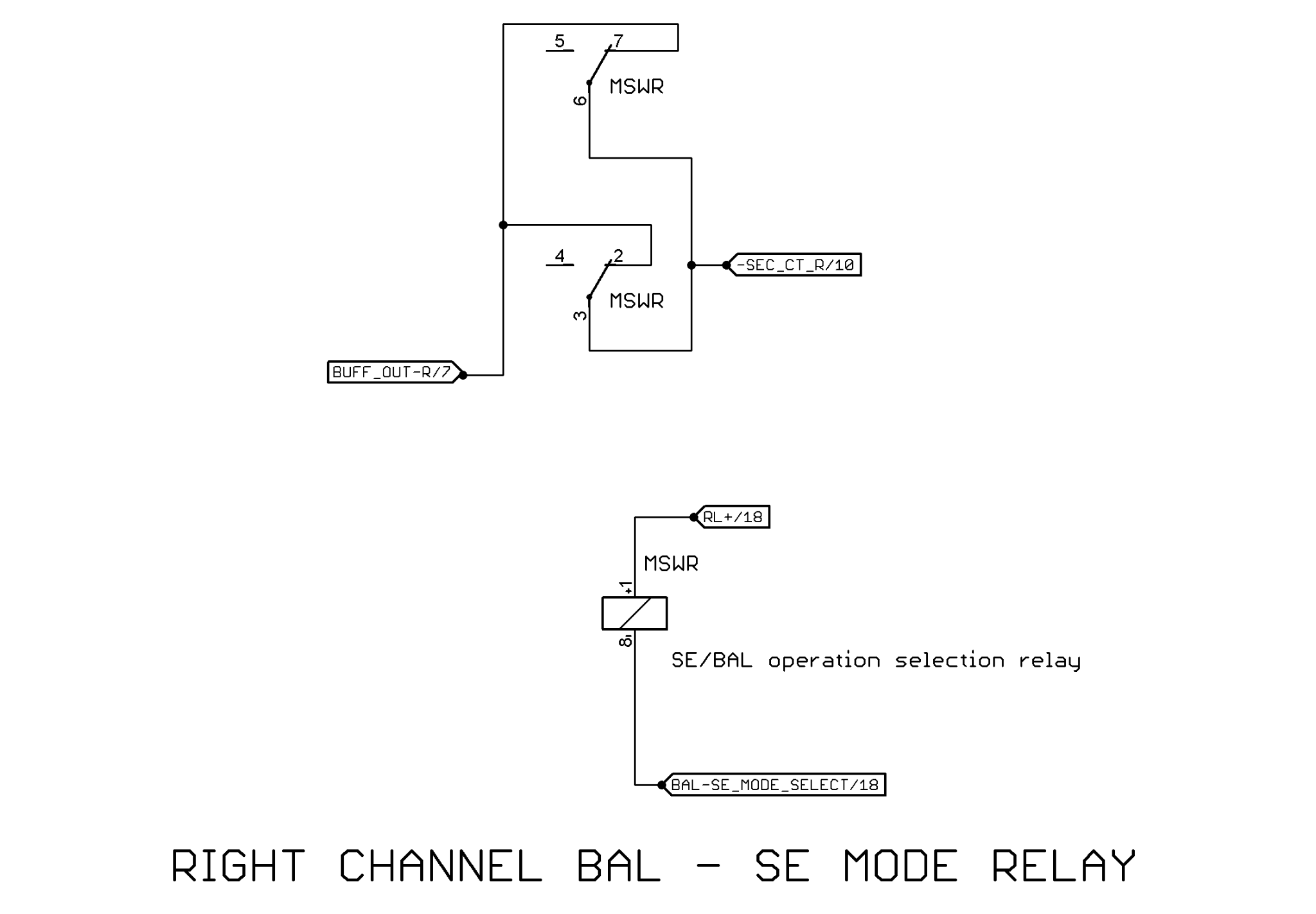

Tanka SE, logically, being for single ended signal arrangement, so 5 RCA inputs, and one RCA output; I'm usually mounting doubled RCA outputs, wired simply in parallel.

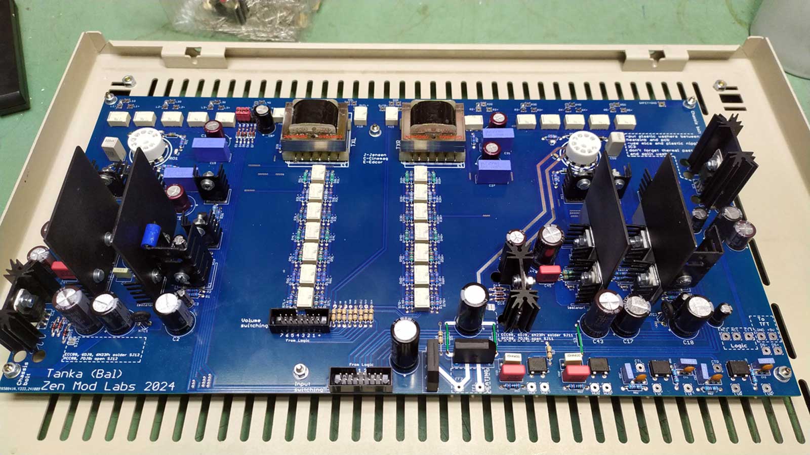

Tanka (no suffix), balanced signal configuration, any number of 5 inputs can be arranged as (permanently) SE/RCA, balanced output can be wired to one or two (parallel) XLRs, or one XLR and (parallel) RCA

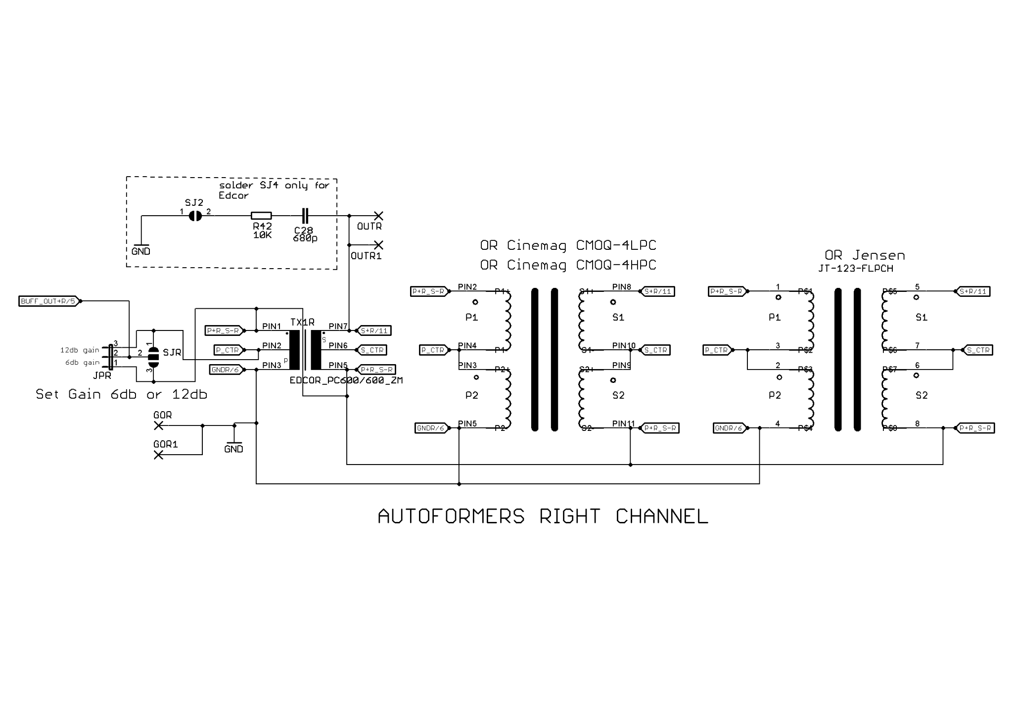

Tanka is is nothing else than tubed** Irreverent, which is nothing else than unnecessary complicated Fancy Iron Pre, having all the bells and whistles on board (big one), with integral 128 steps resistive attenuator, governed with little Arduino Gizmo and there is shiny TFT and heavy remote.
Dazzling, Shiny and Overwhelming characteristics speech: Fully dual mono, ultragigamega shunt regs, OhYeah! Gloving Toobz serving in buffers, precious Fujitsu relays for everything what's switched, volume attenuation constant Rin 24K, 128 steps of 0.56db each, ranging from -71.7 to 0db, and then (whadasurprize) autoformer (Cinemag or Jensen or Edcor repeaters) gain, settable to either +6 or +12db, yadayada.......
Button on front, fiddle left-right to set volume, push for incremental cycle through inputs 1 to 5.

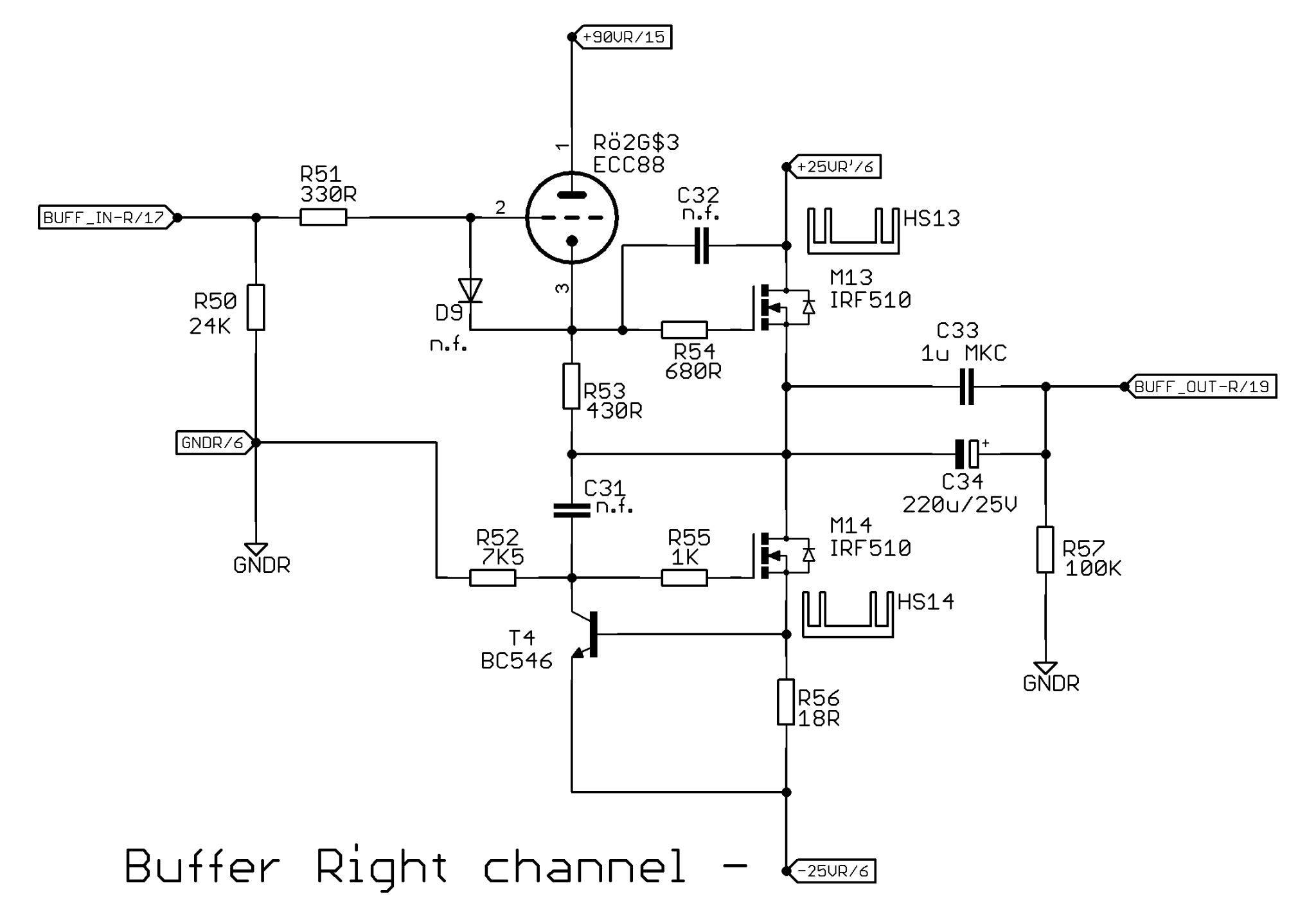

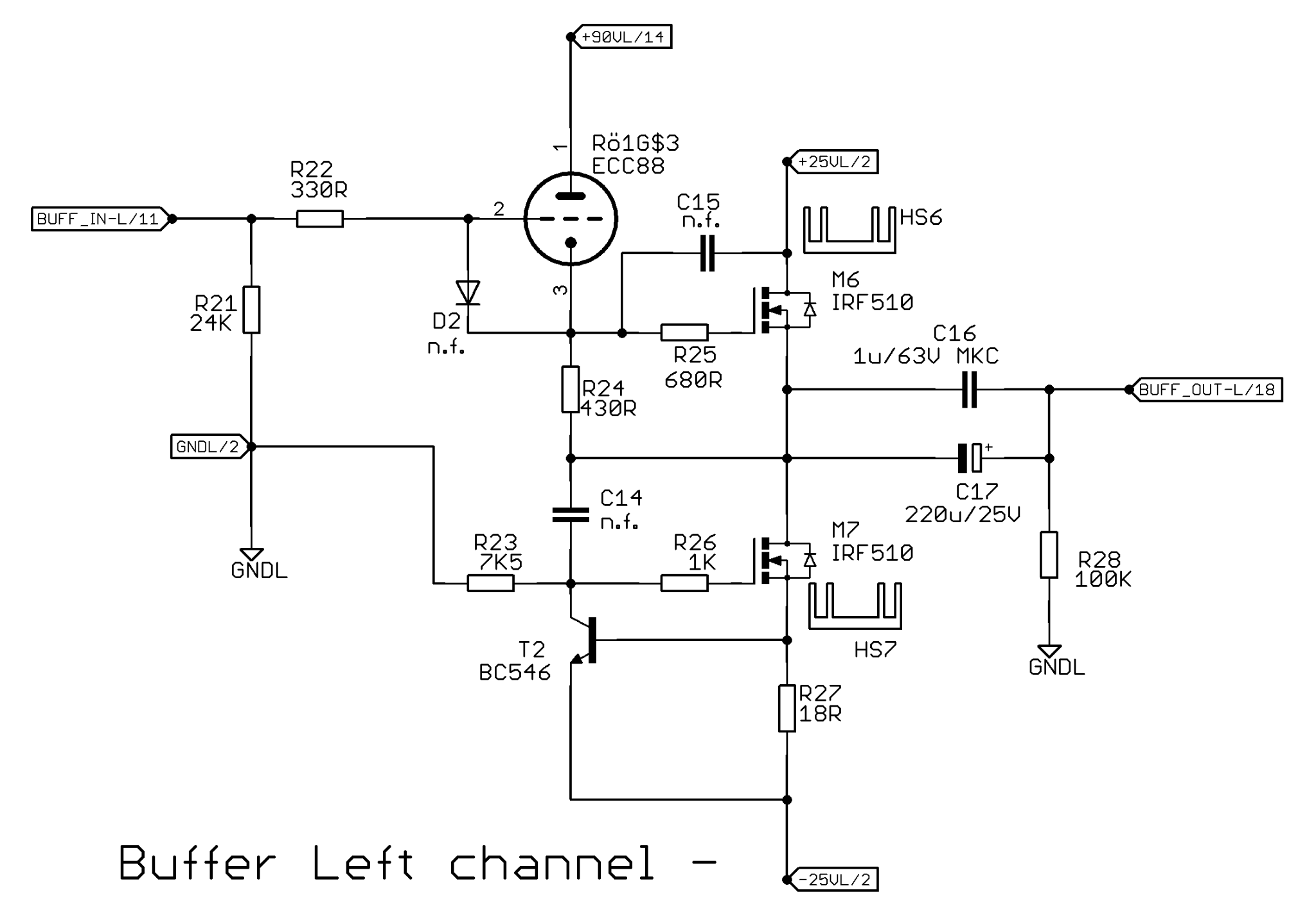

**Tube-mosfet compound buffer, instead of same-sex-JFet buffer, as in Iron Pumpkin, Irreverent

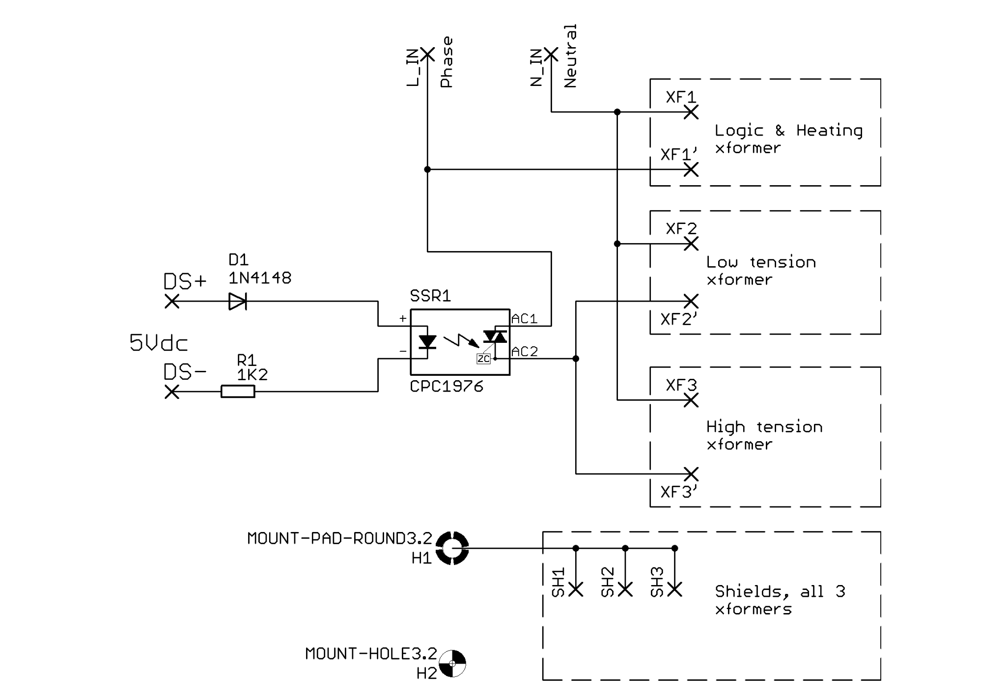

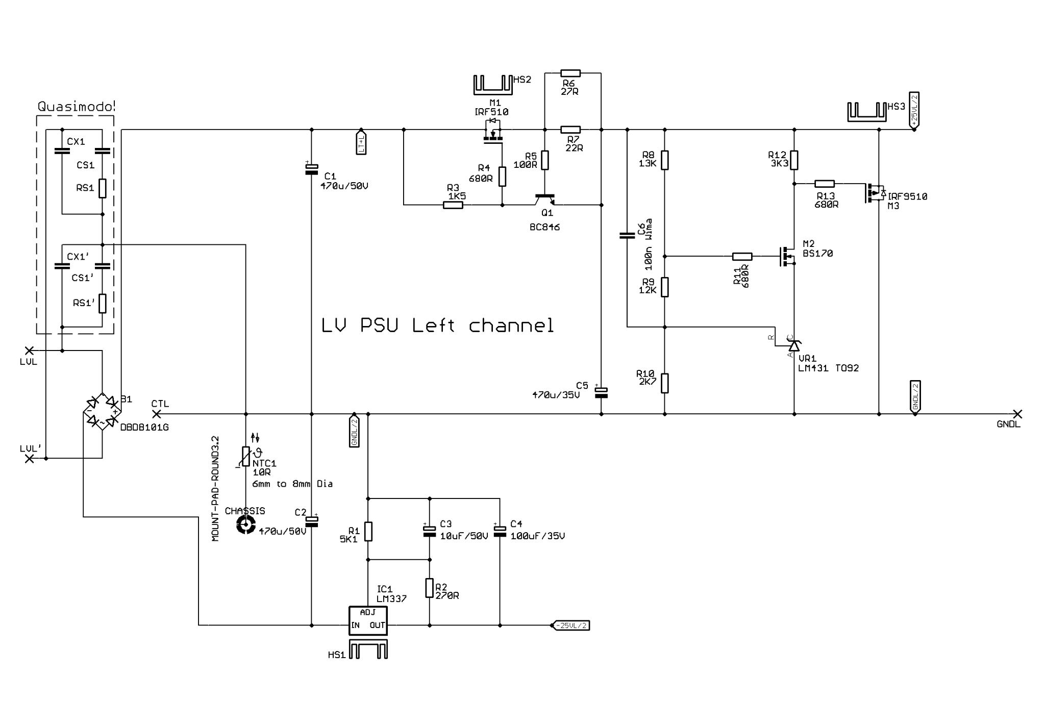

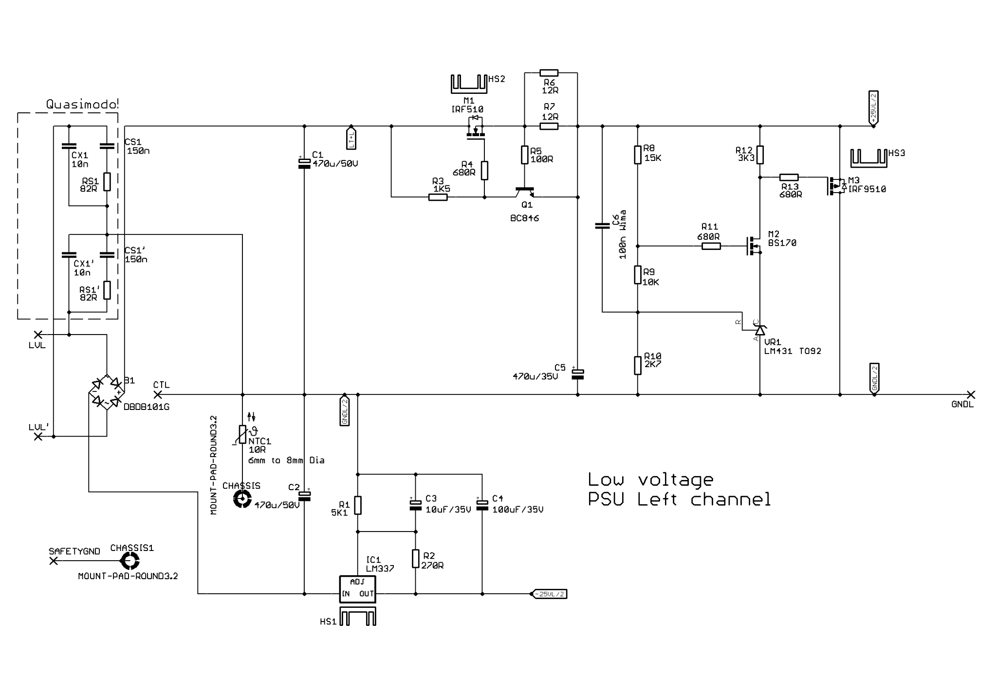

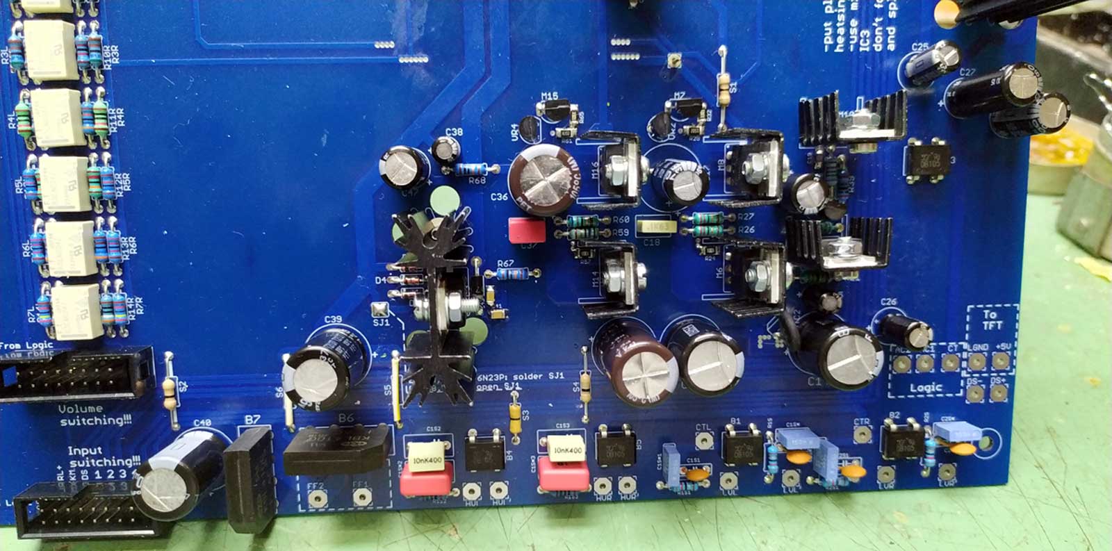

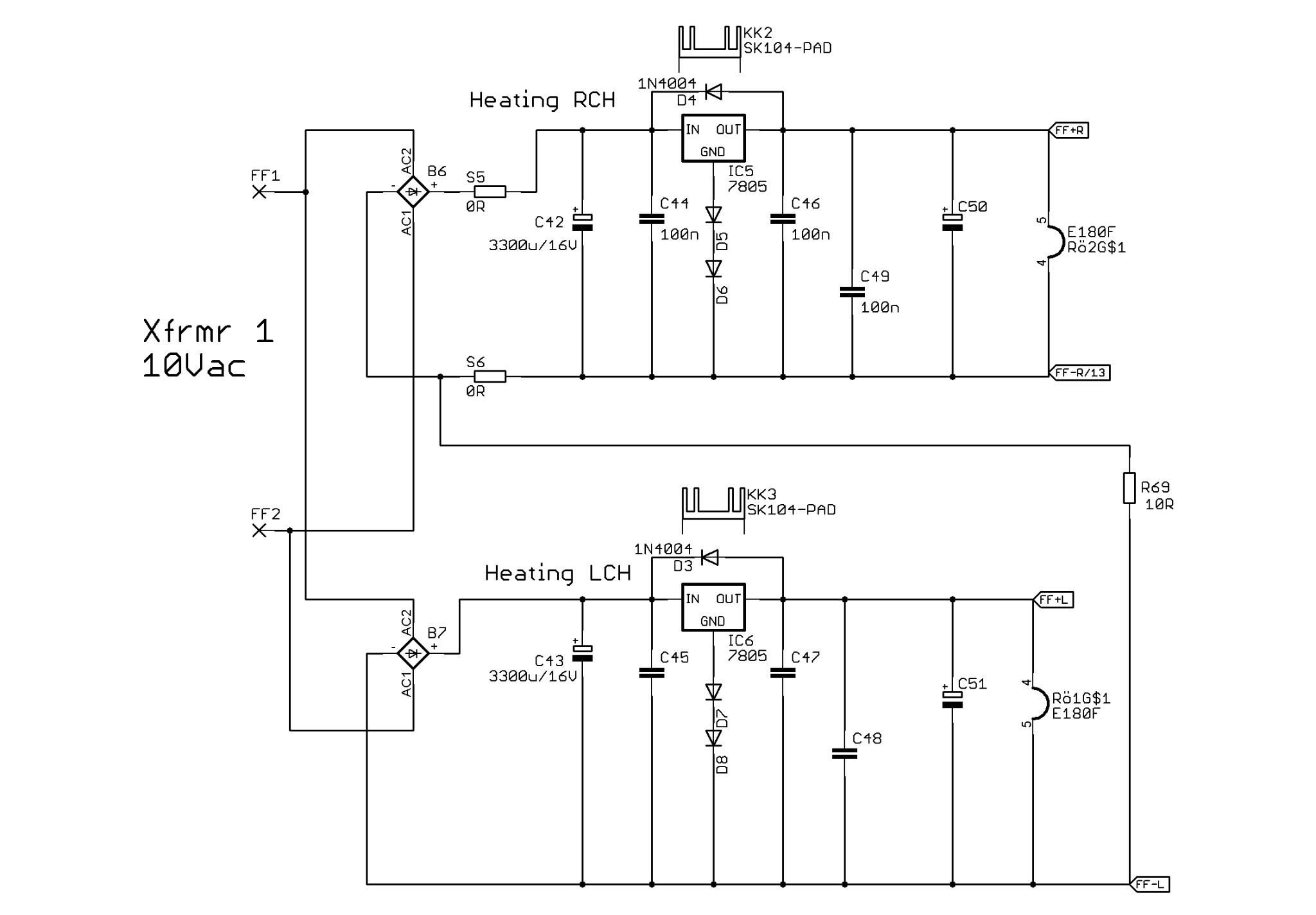

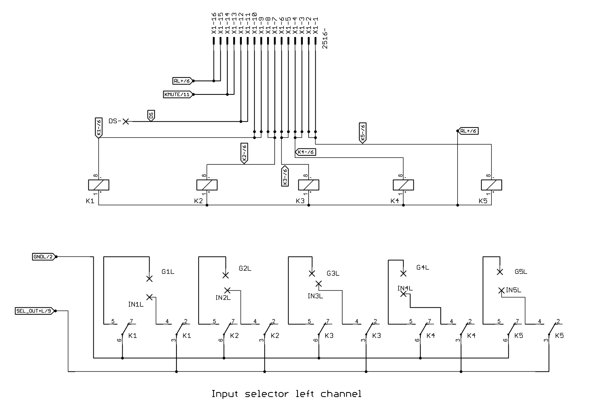

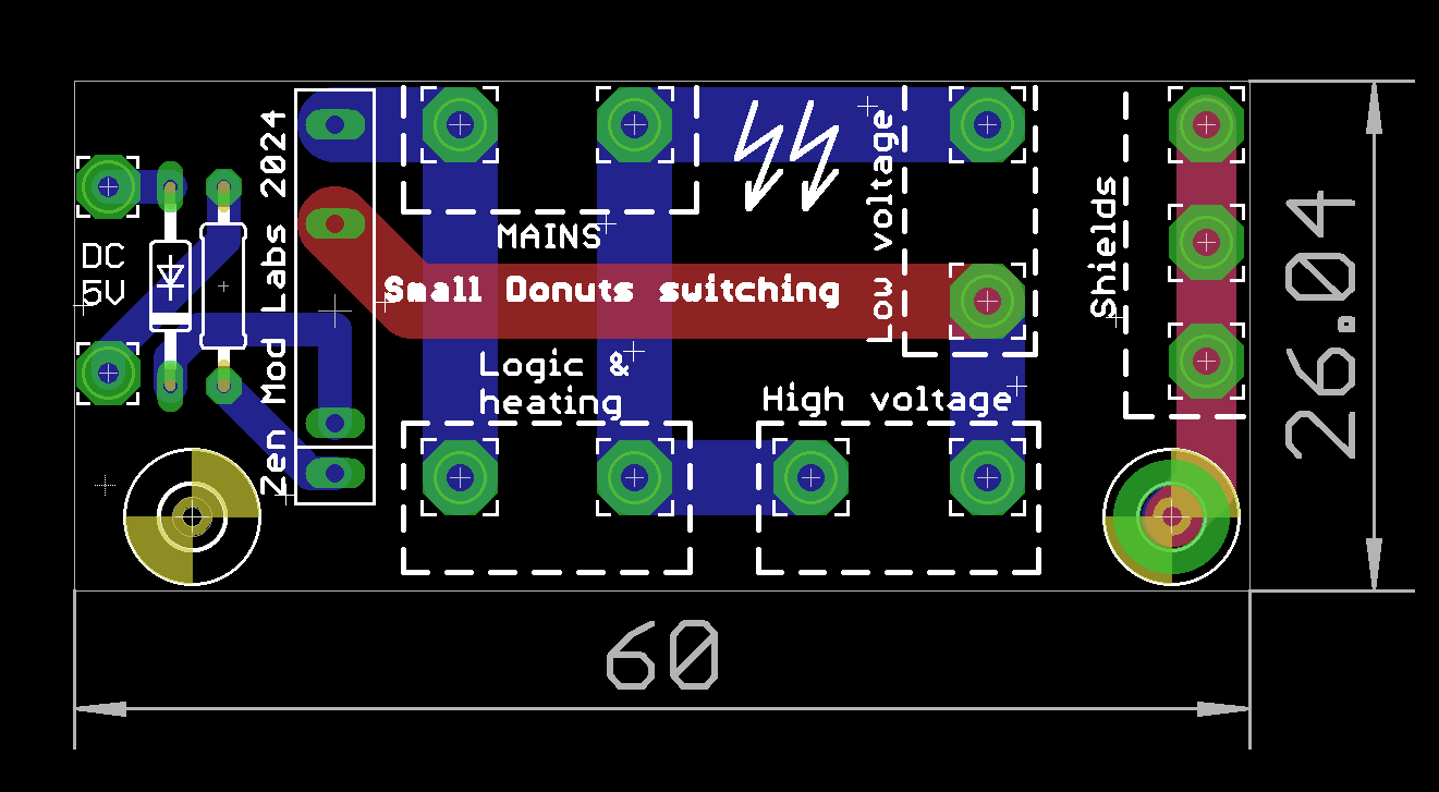

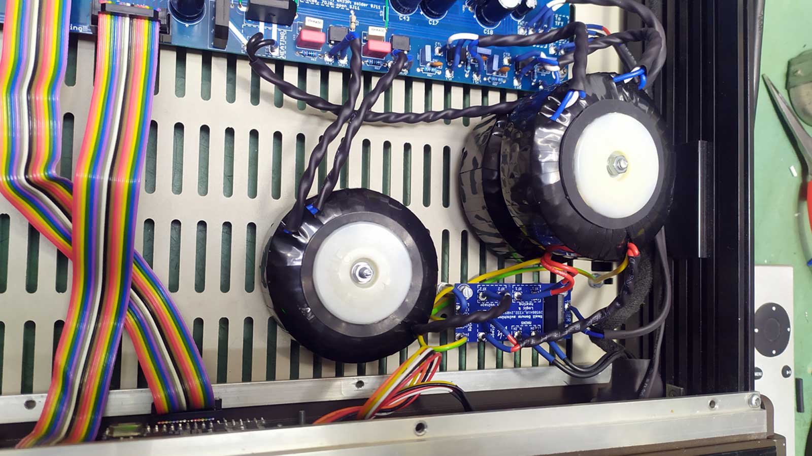

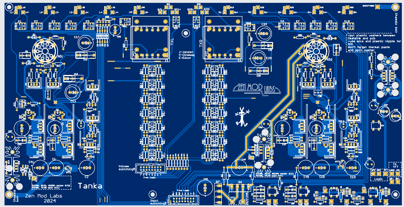

First what's common (for function) of both SE and balanced - little aux pcb, necessary for governing 3 separate custom made Donuts:

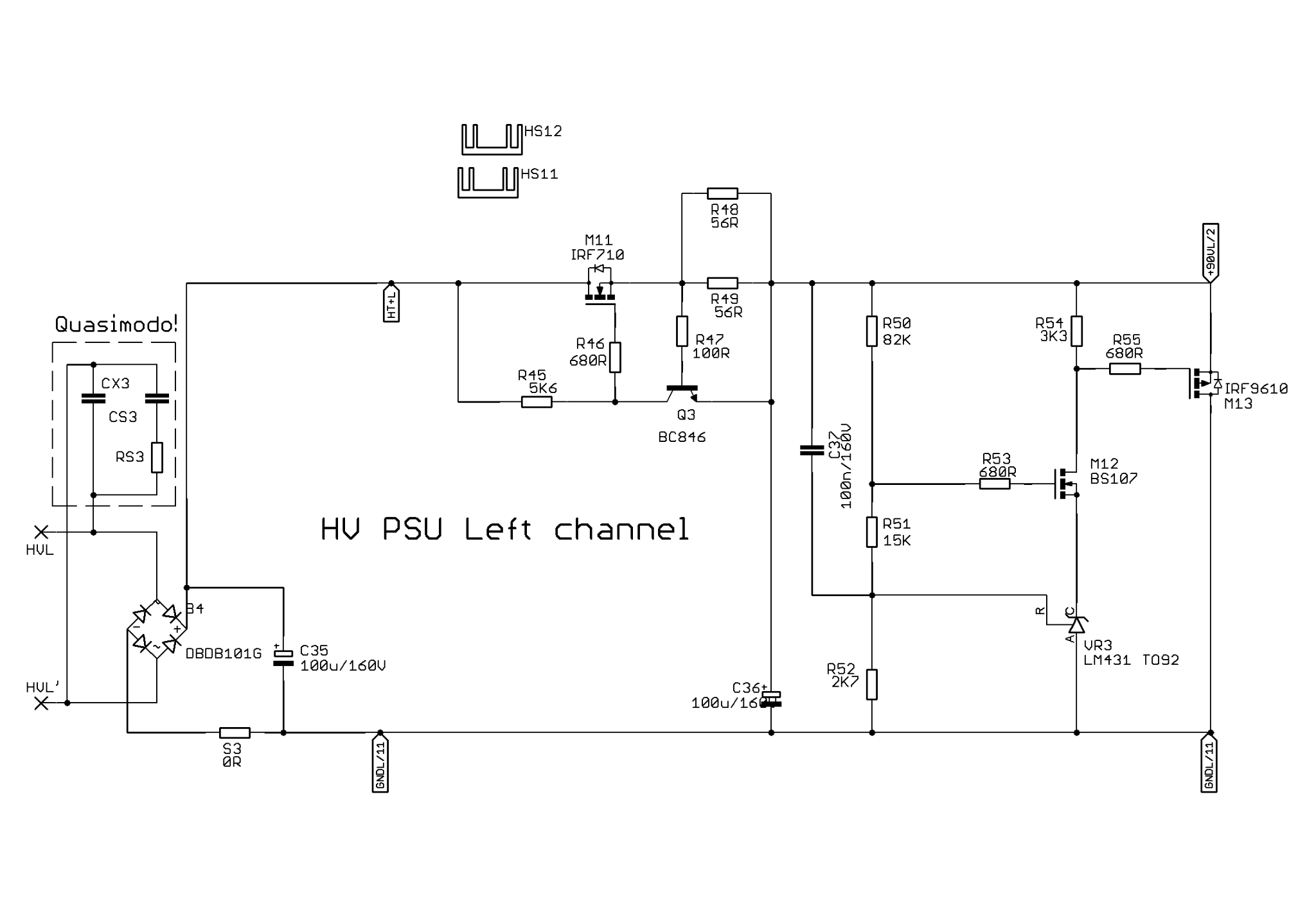

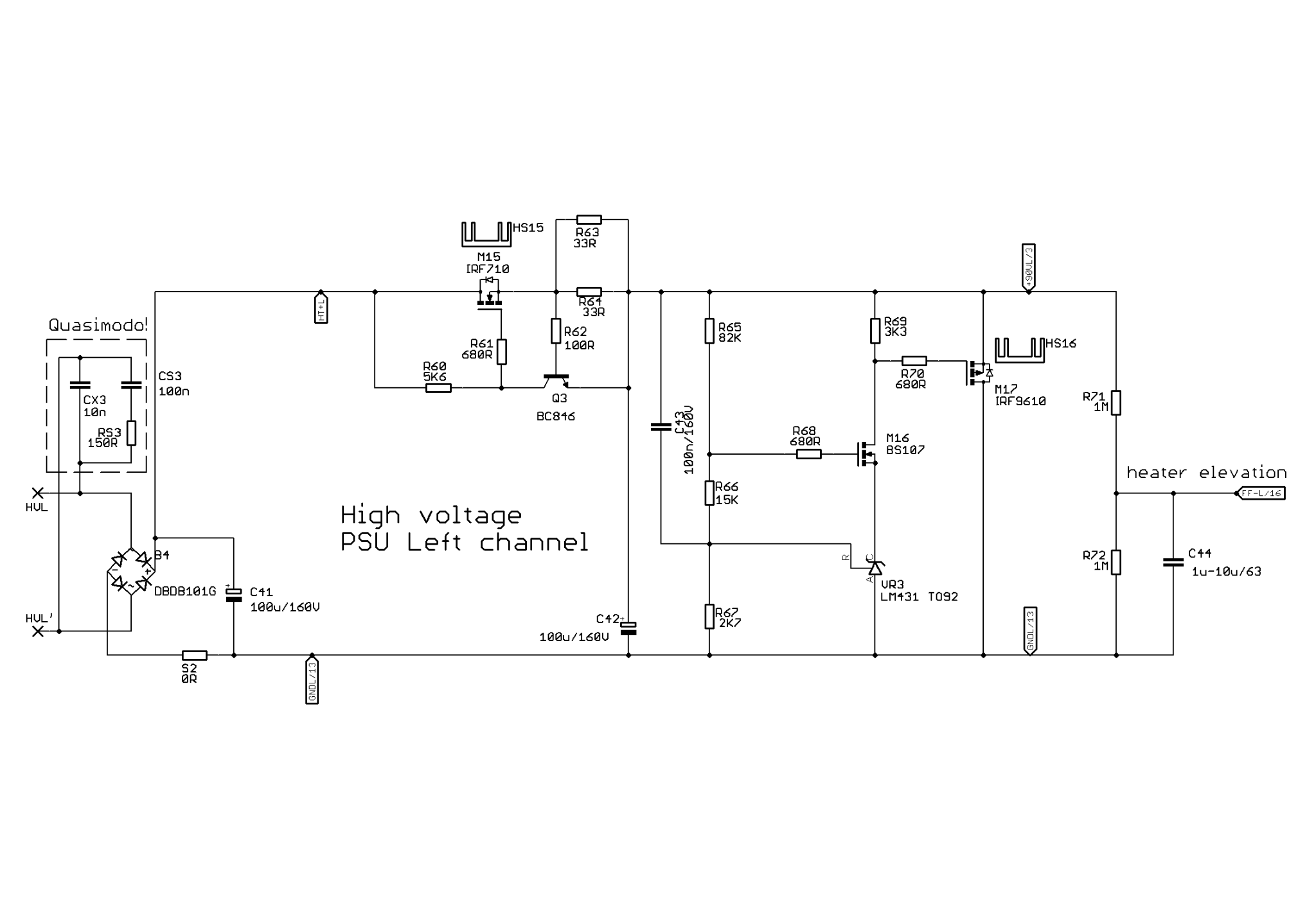

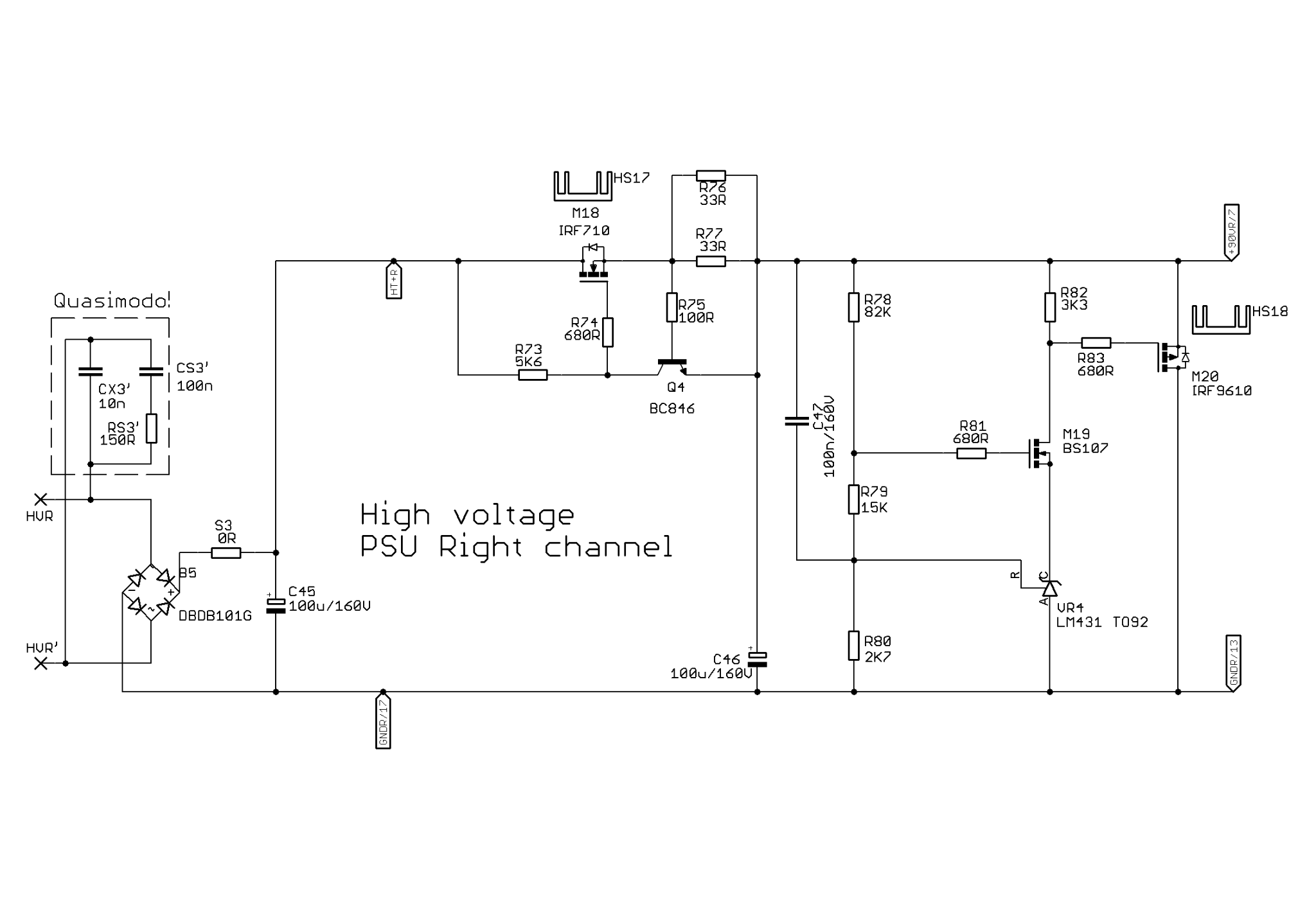

1. 30VA Donut, secondary 24Vct, relays and logic and 9Vac secondary - toobz heating; when mains switch is flipped, this Donut is energized pronto/directly...... then after some time (30secs) Arduino Gizmo is firing up solid state relay and energizing :
2. 30VA Donut, having two independent 56Vct secoondaries, each for one channel Low Voltage regs
and
3. 20VA Donut, having two independent 100V secondaries, each for one channel High Voltage regs

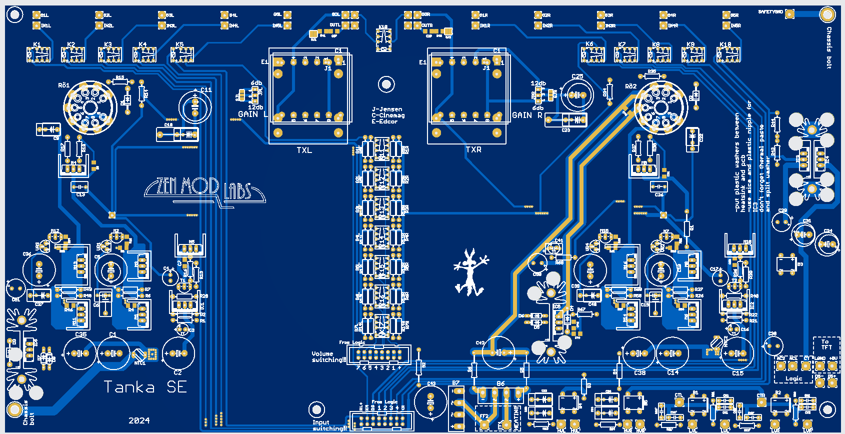

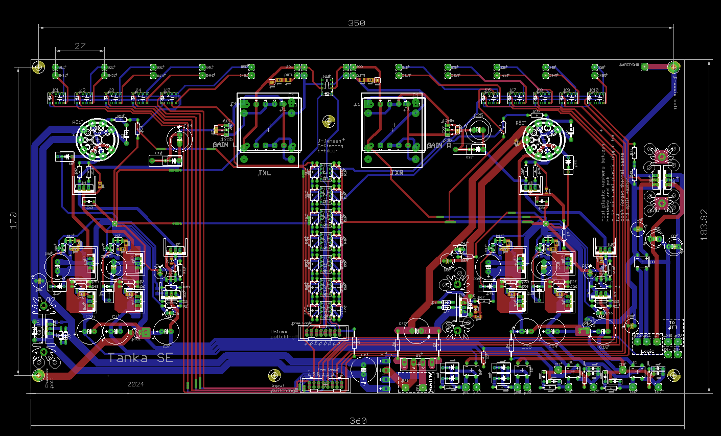

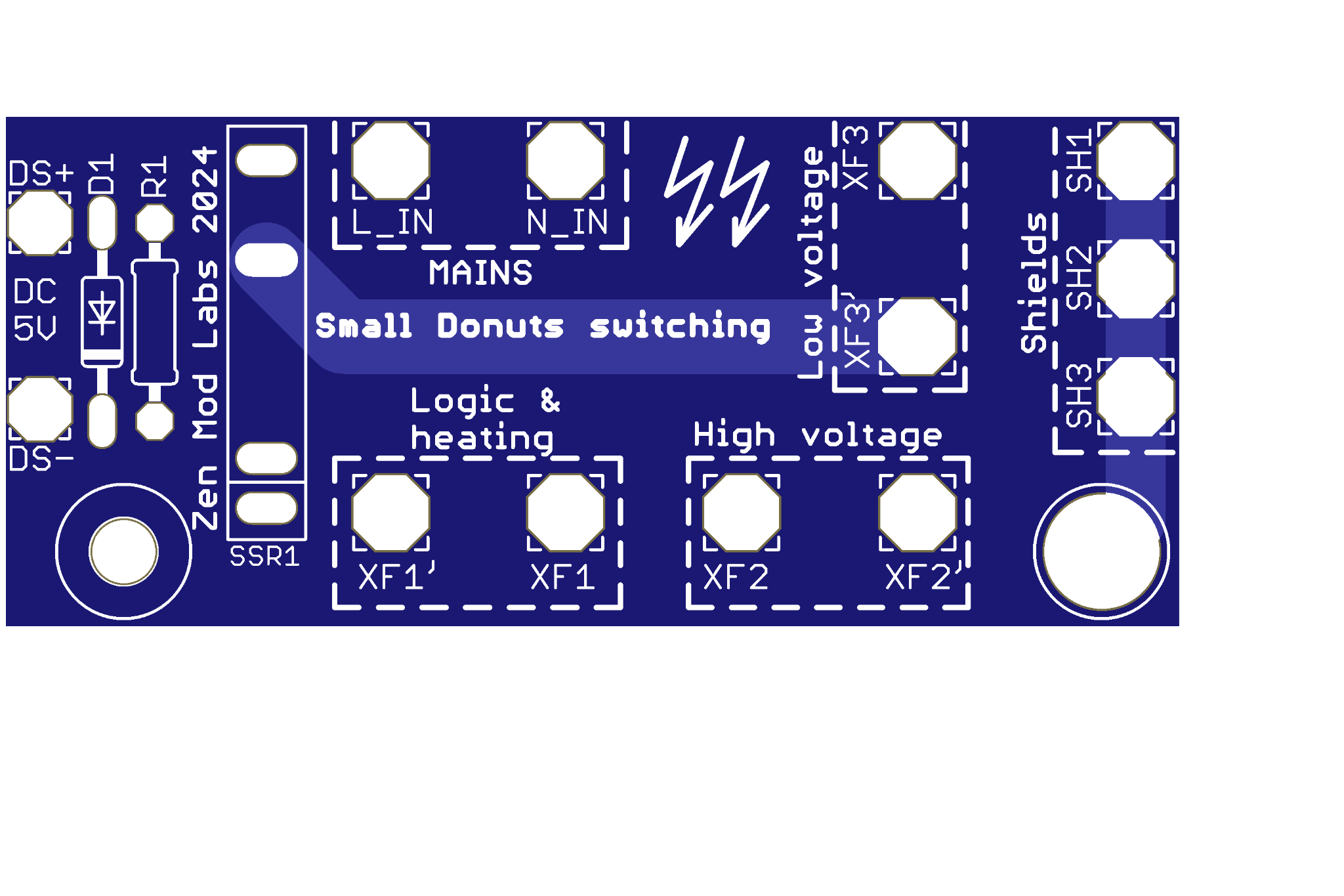

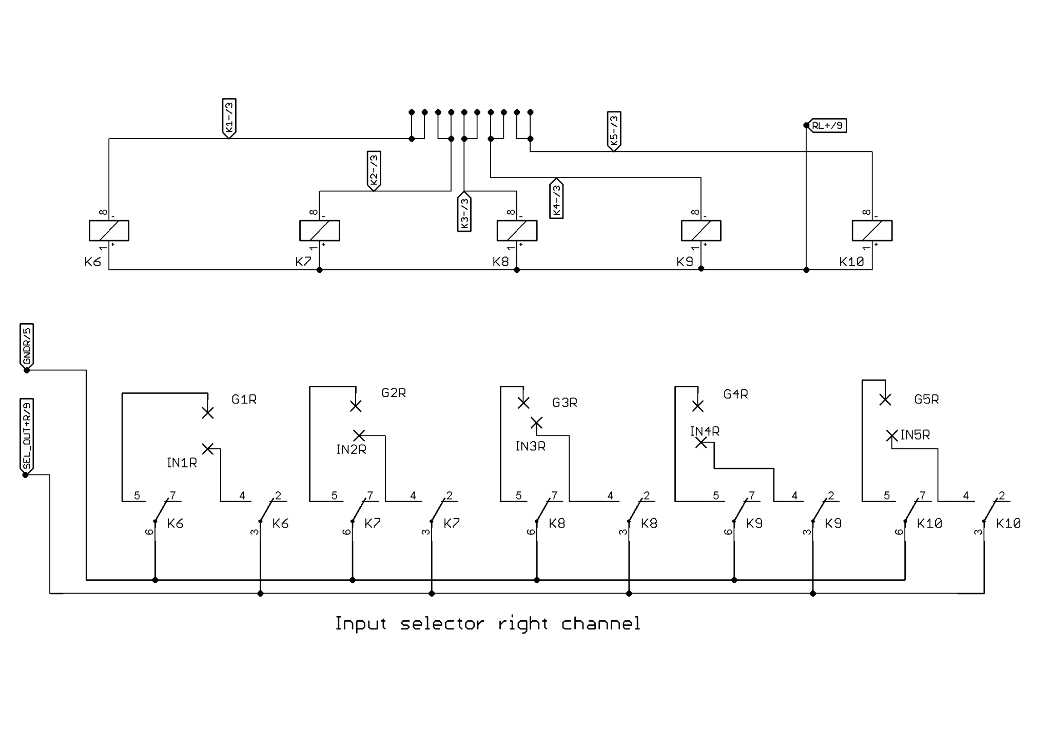

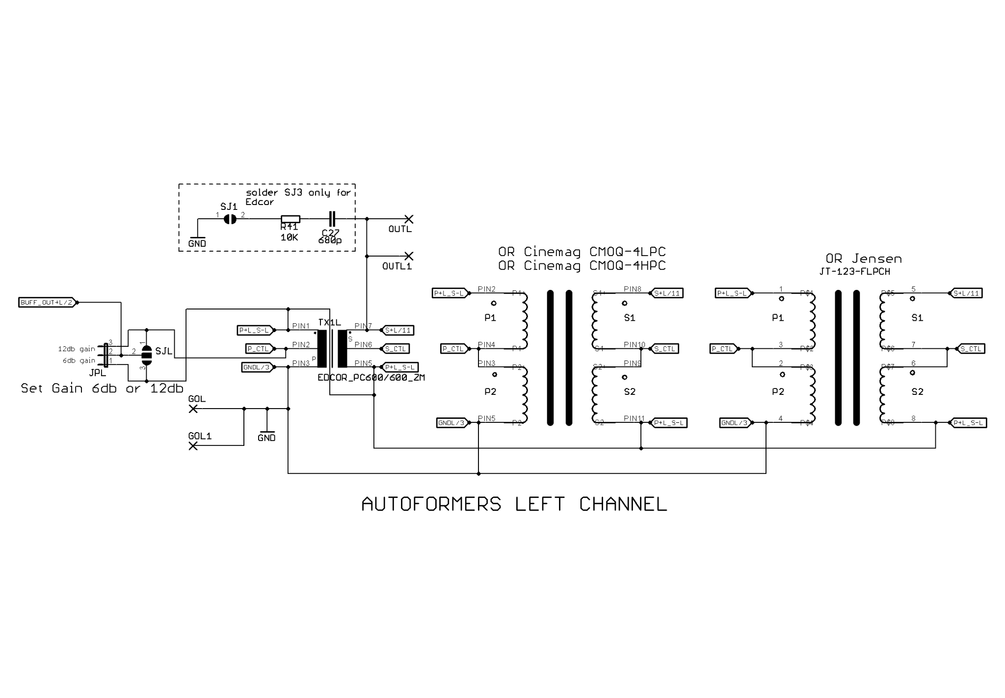

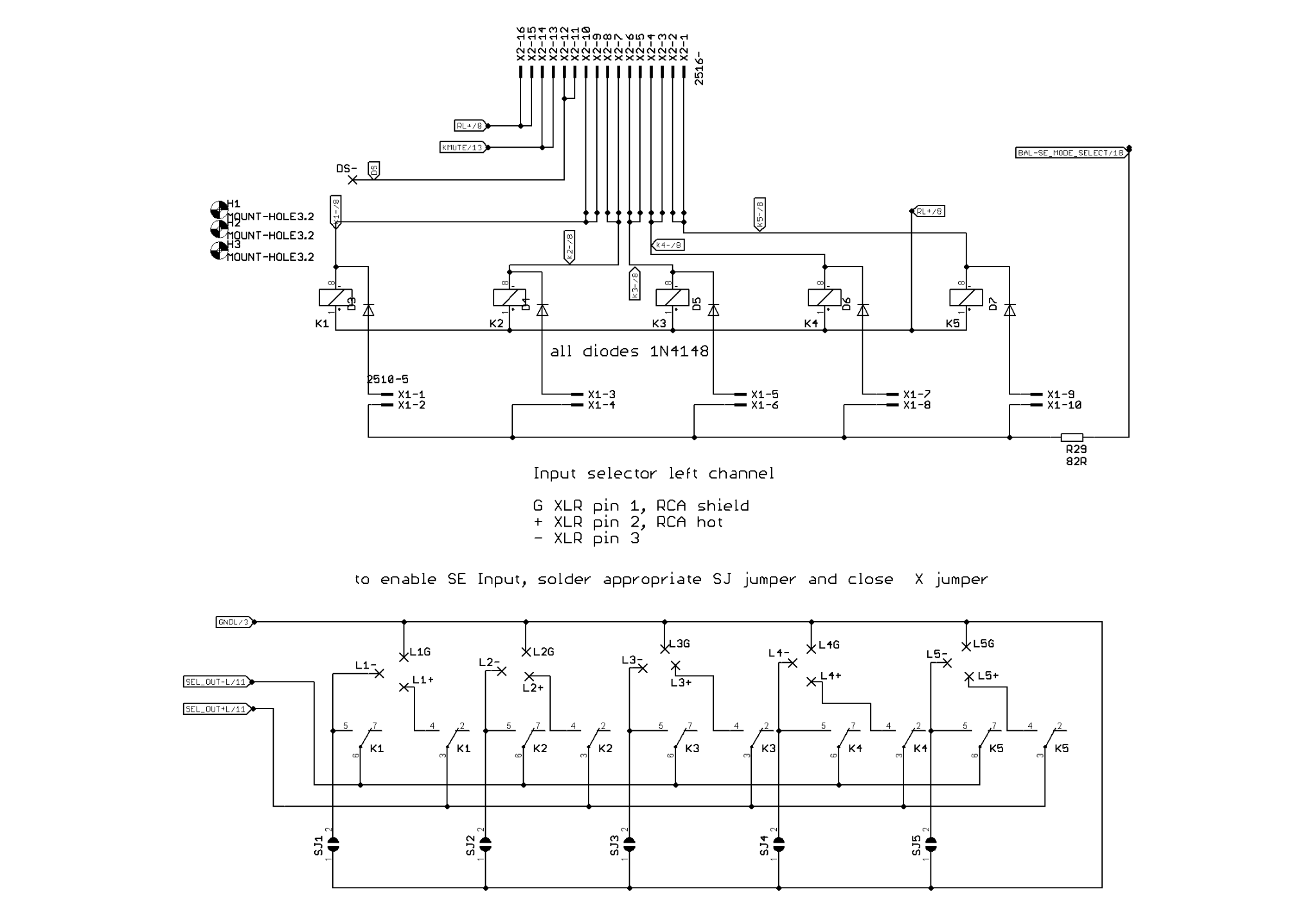

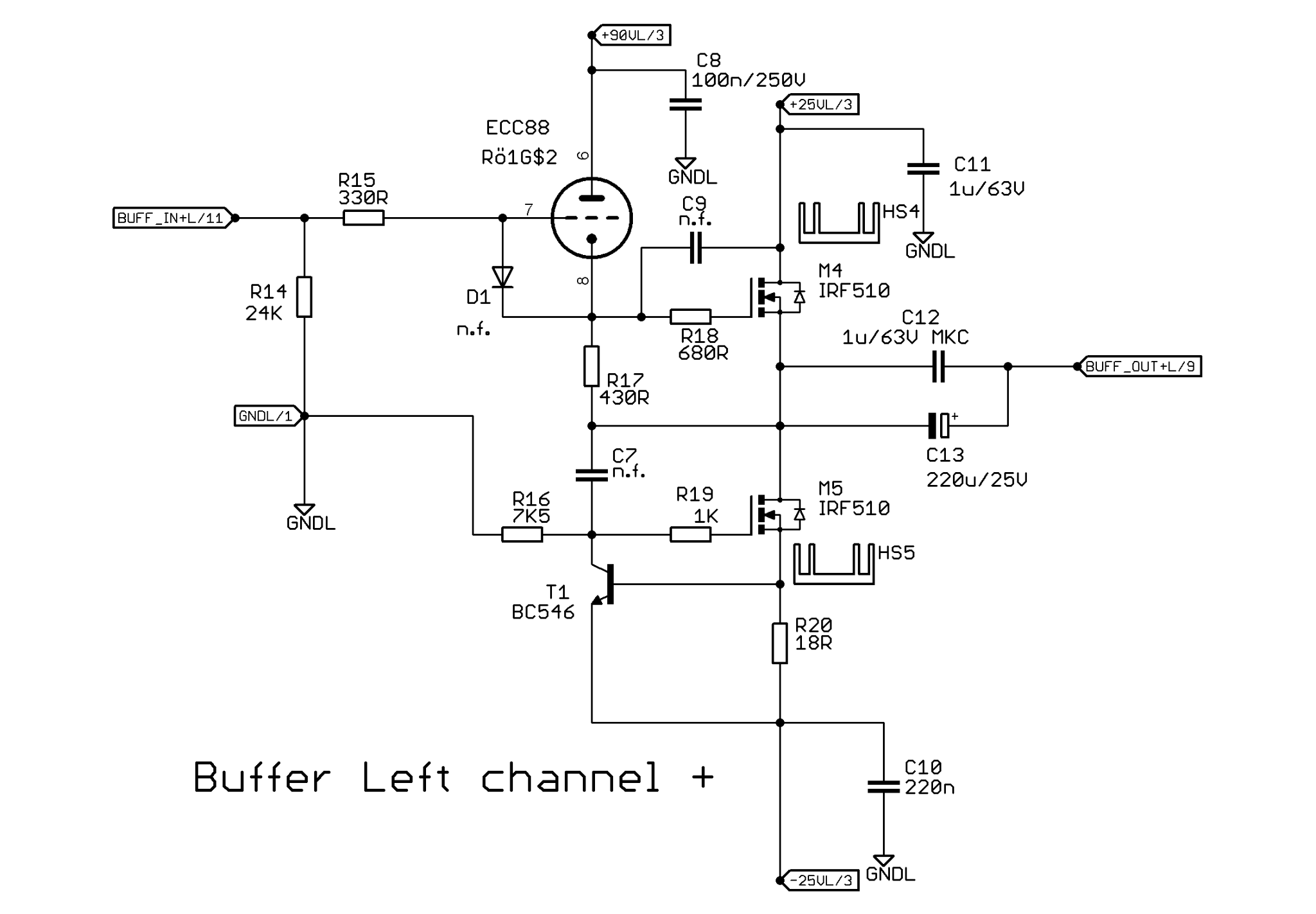

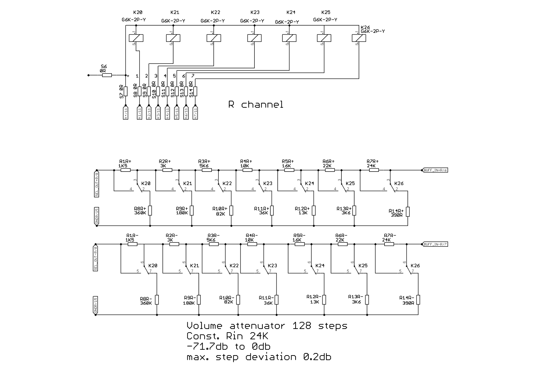

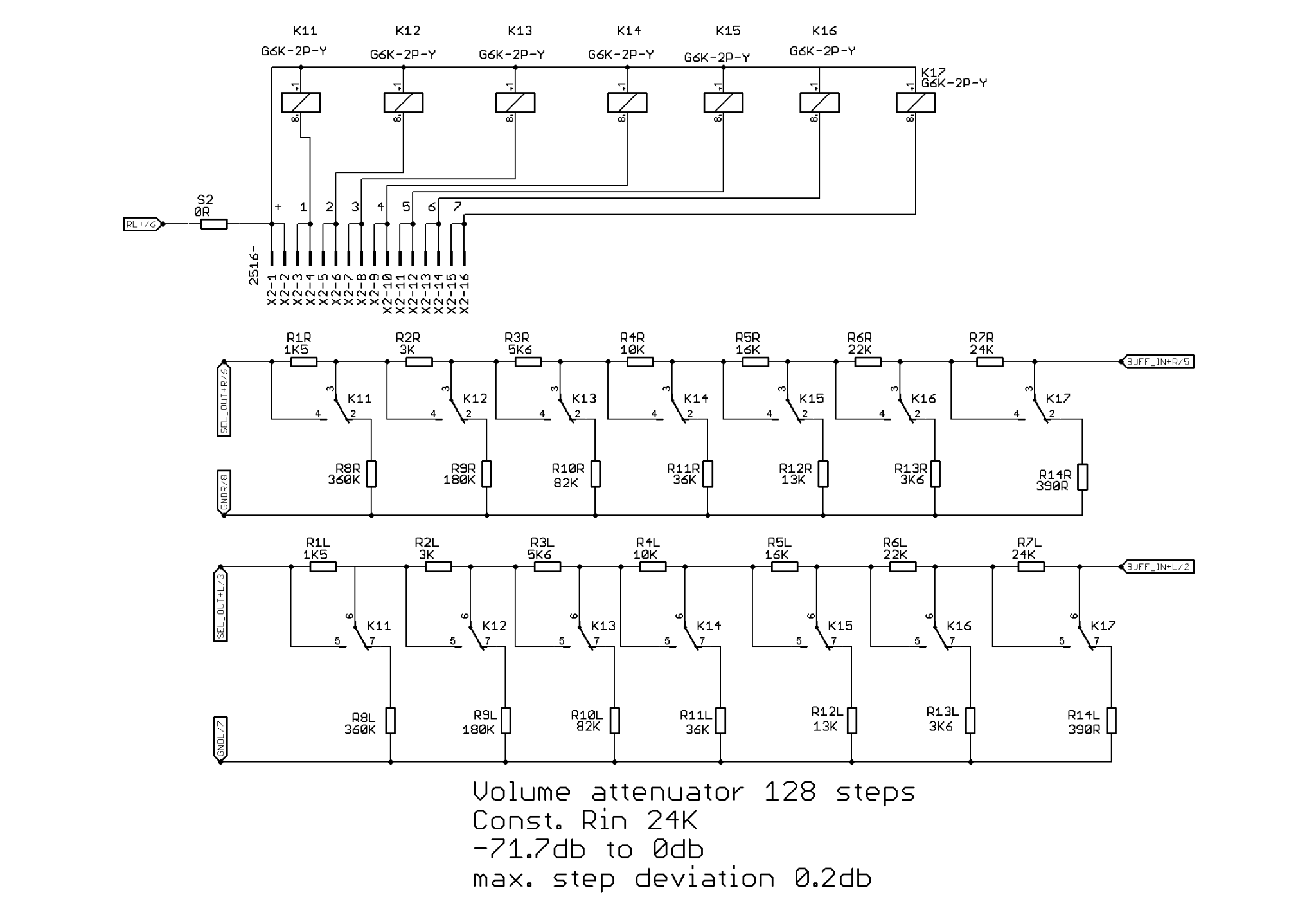

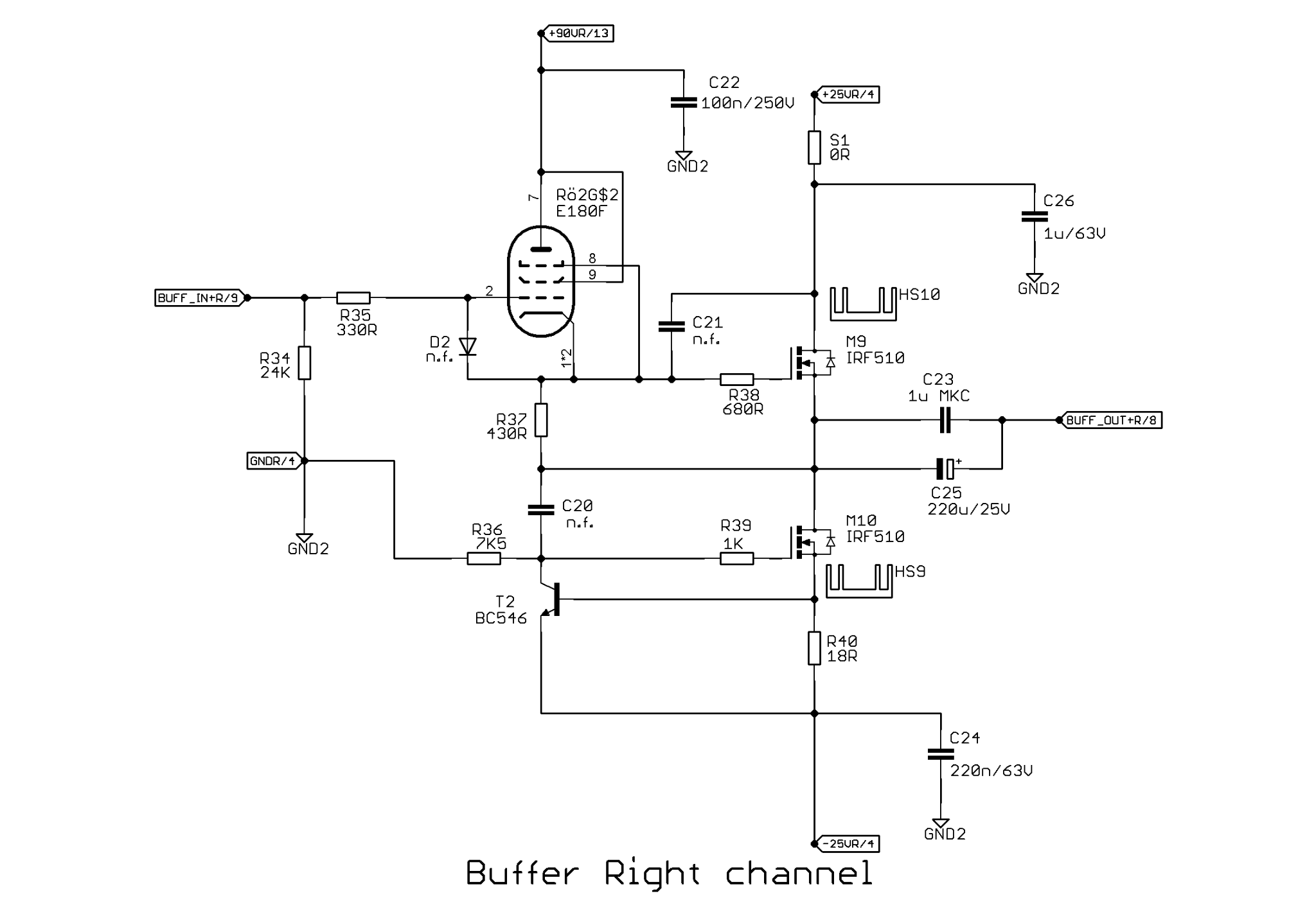

Now, Tanka SE funny black and white technicals:

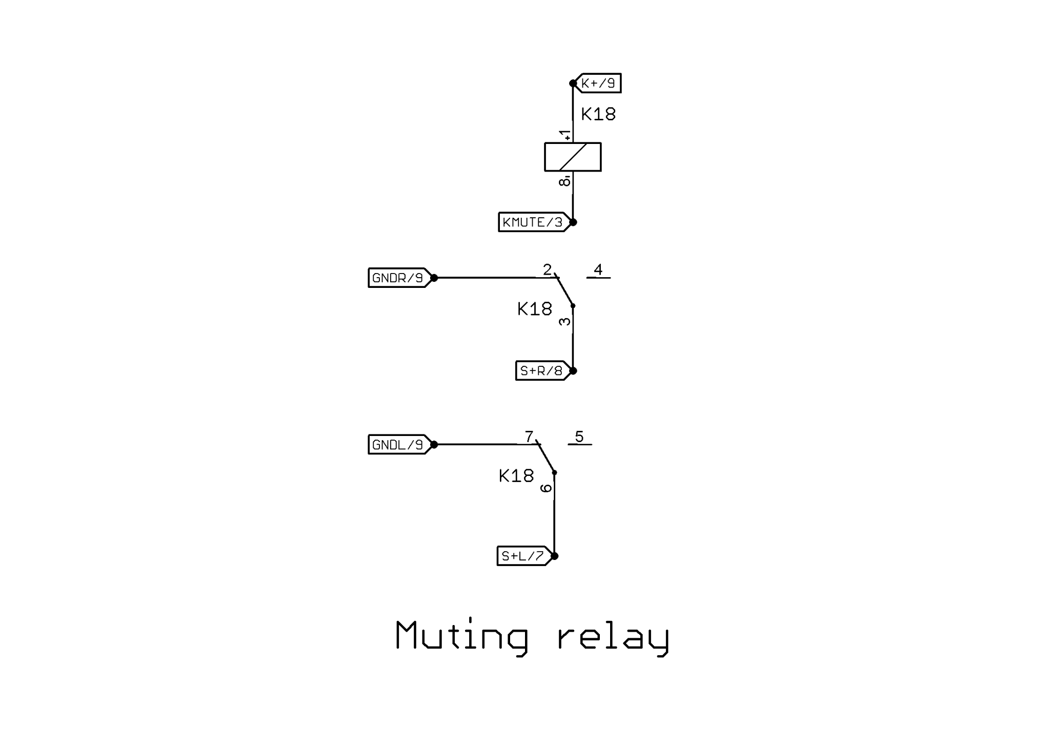

....... Now, Tanka funny black and white technicals:

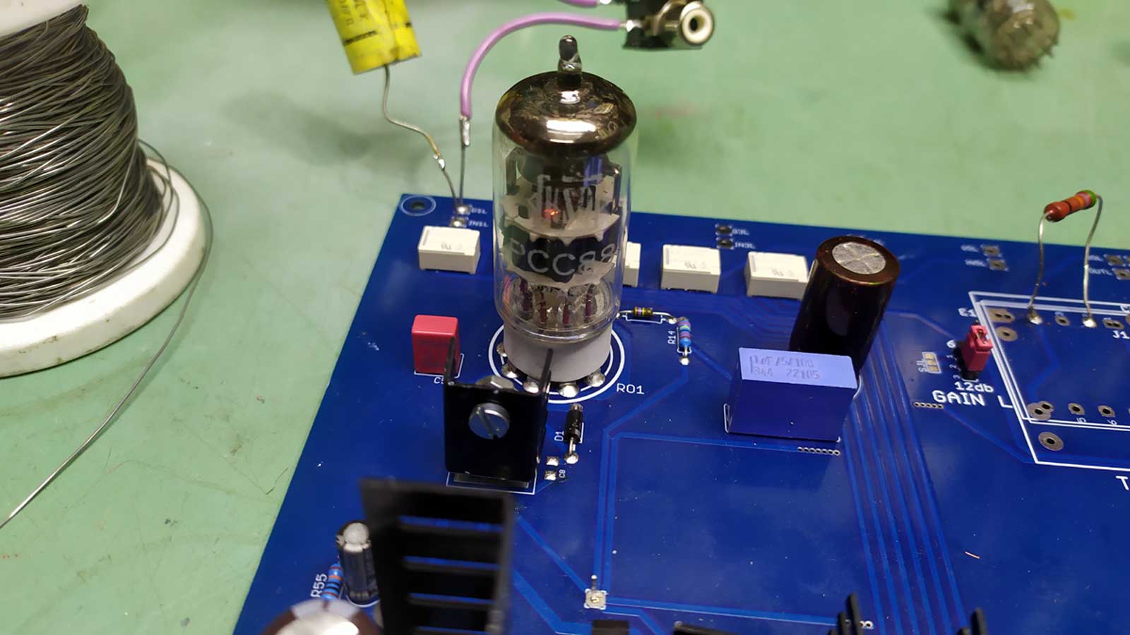

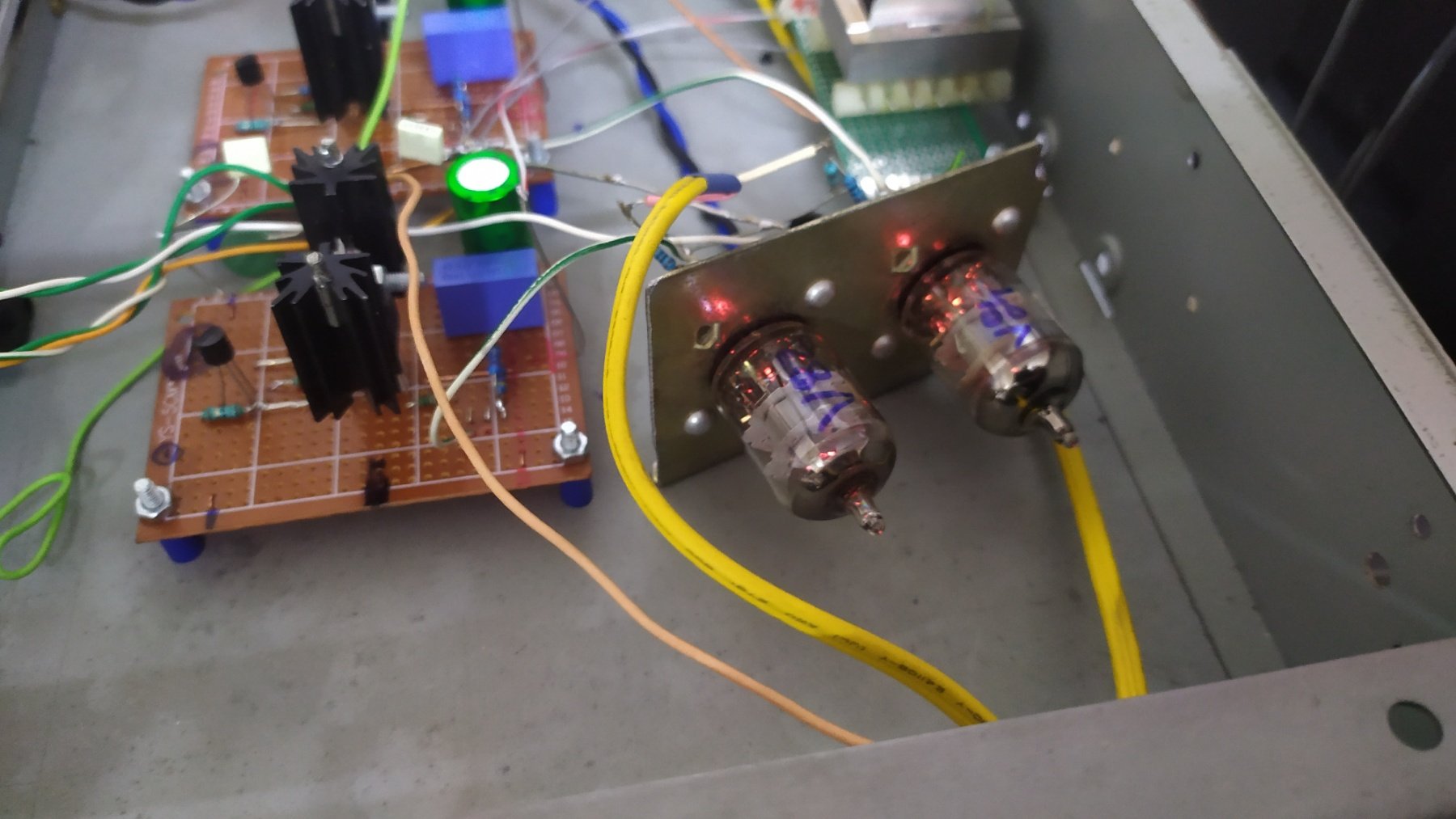

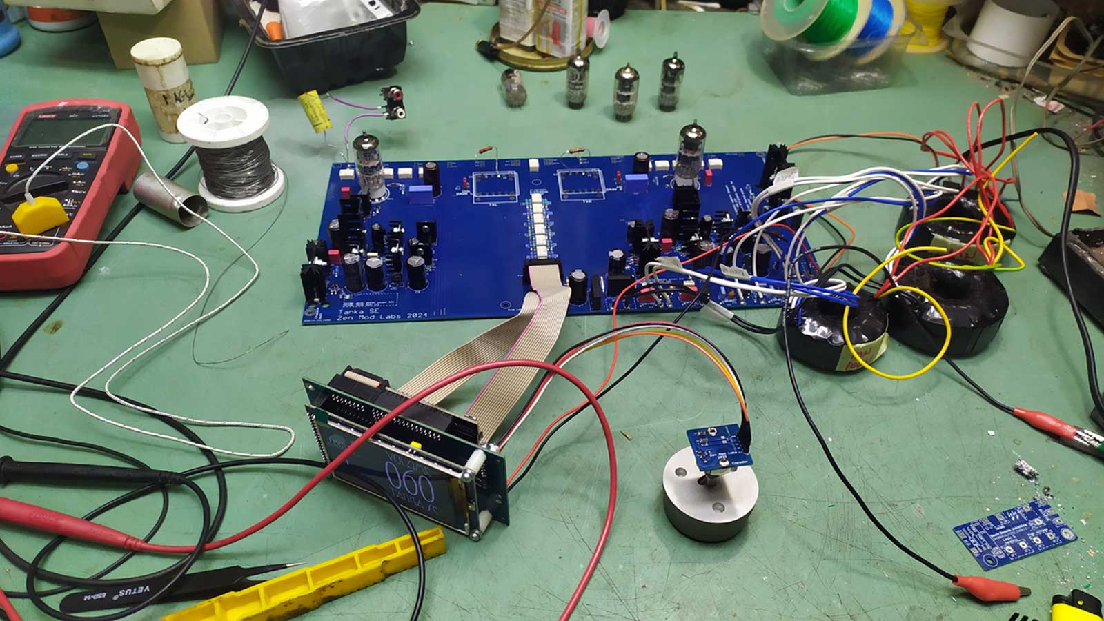

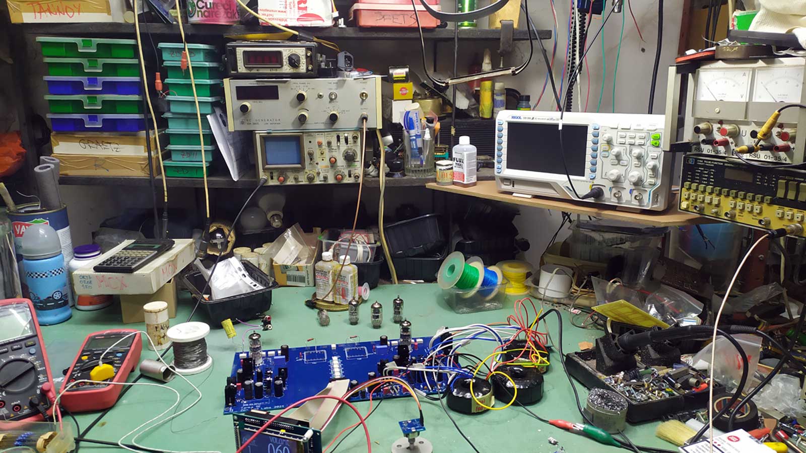

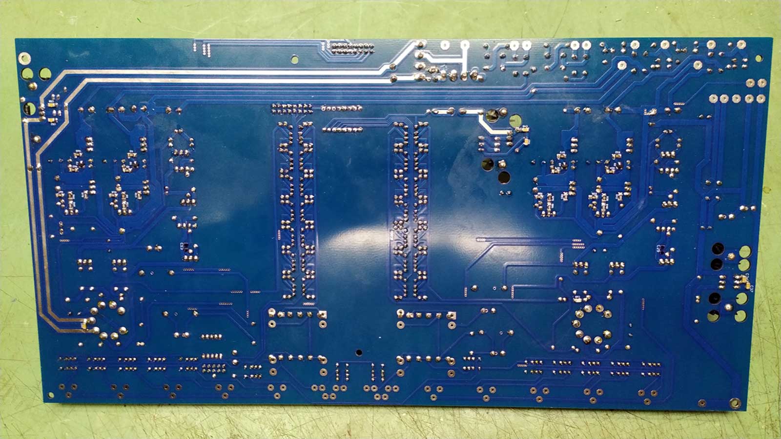

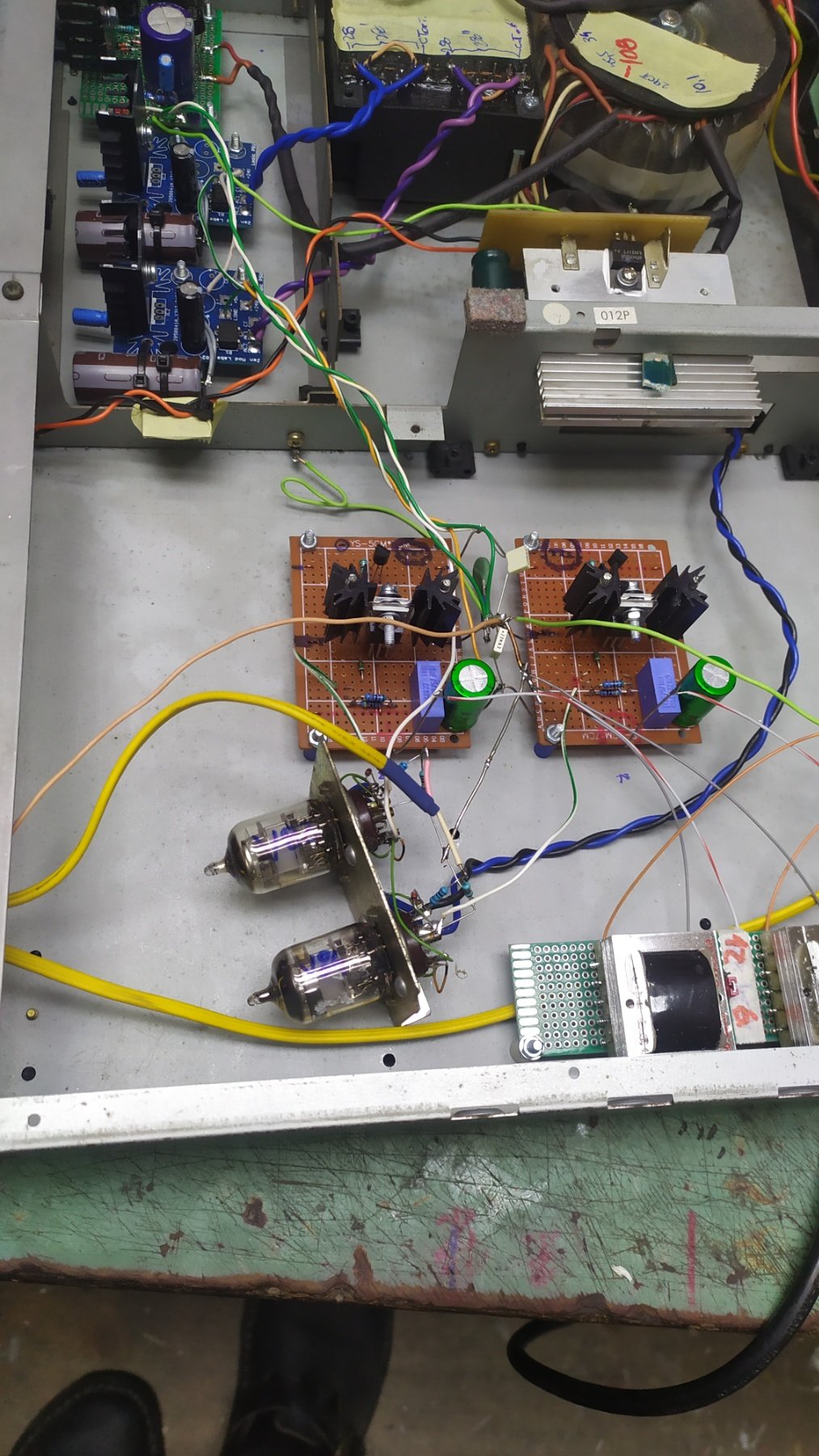

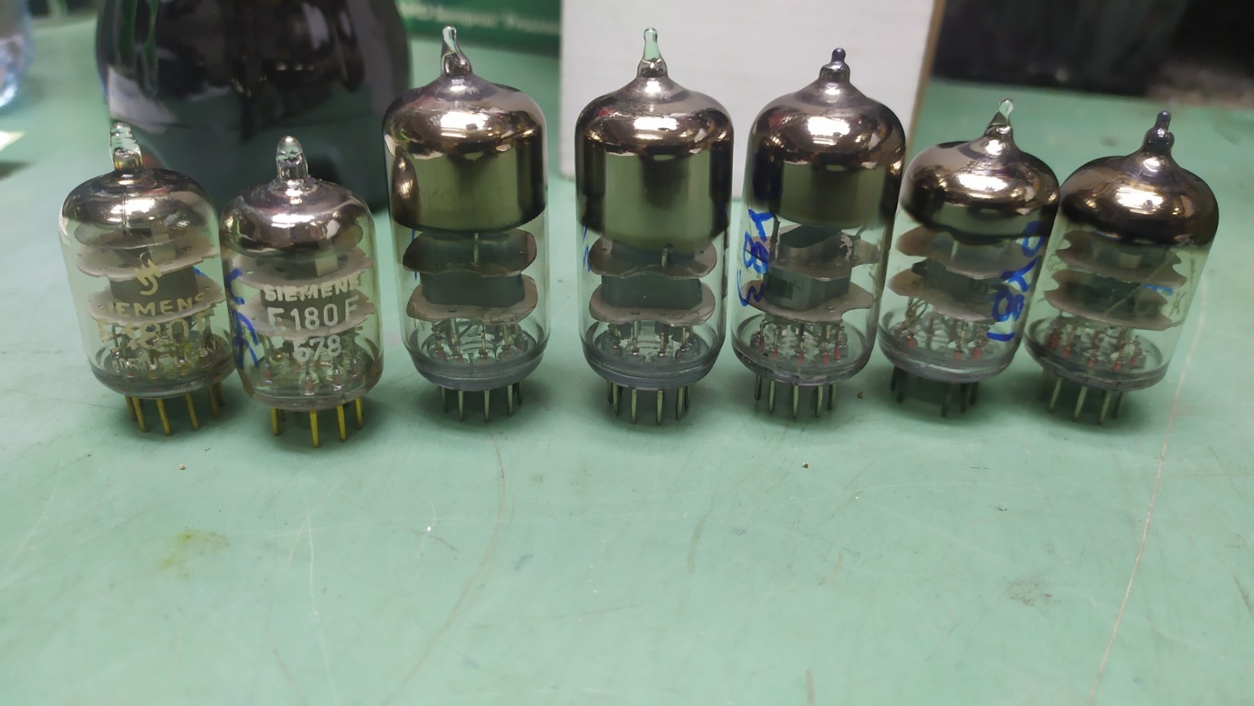

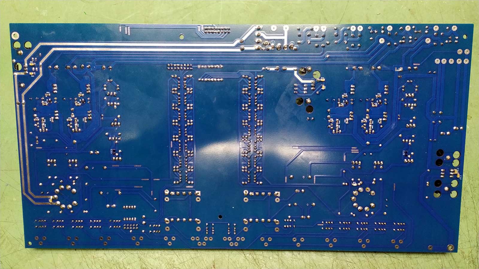

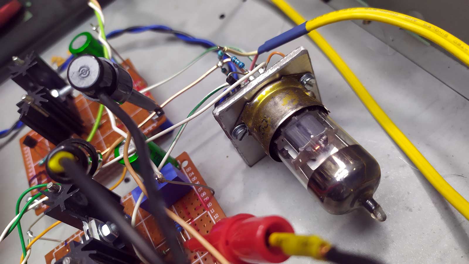

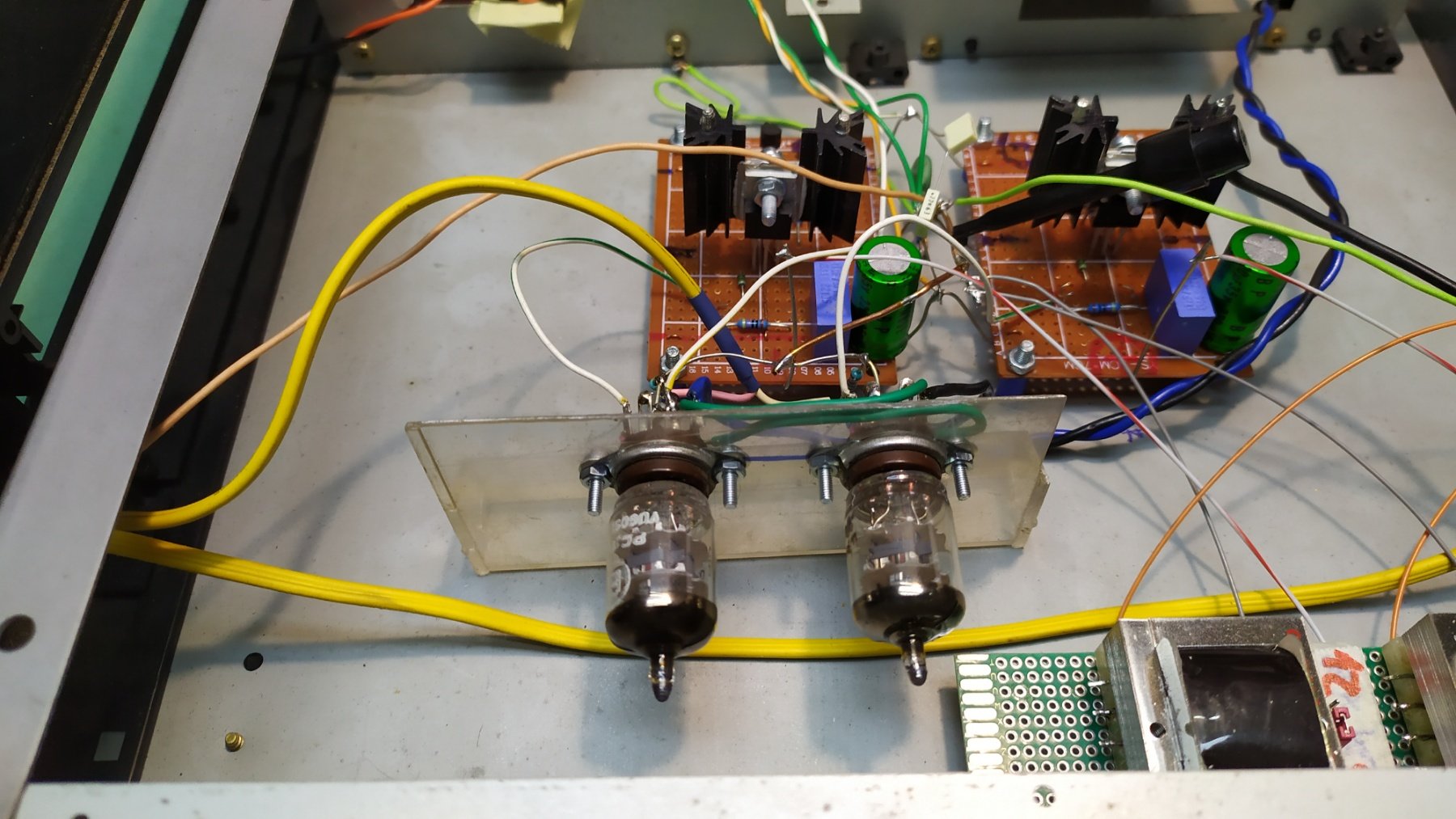

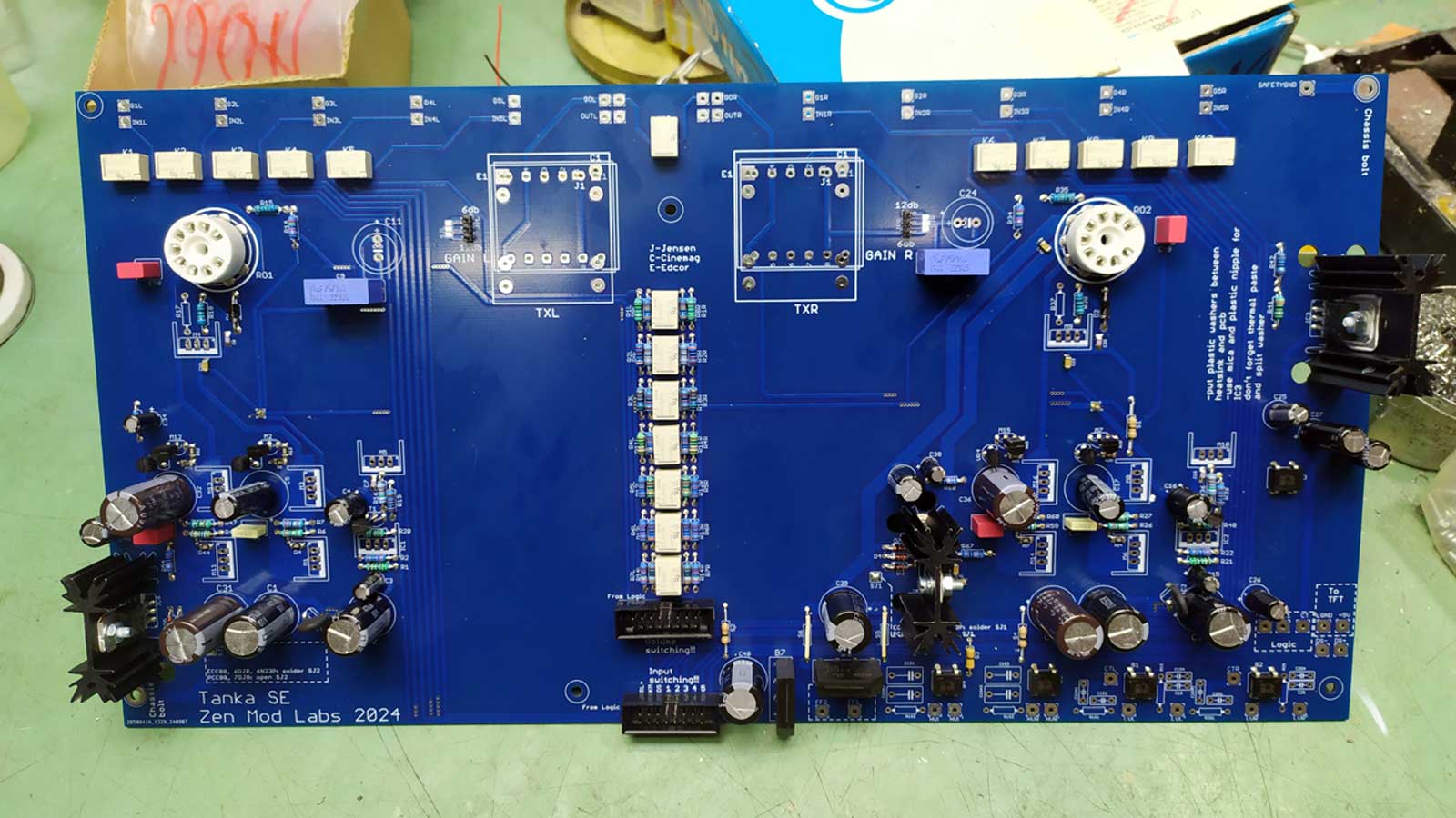

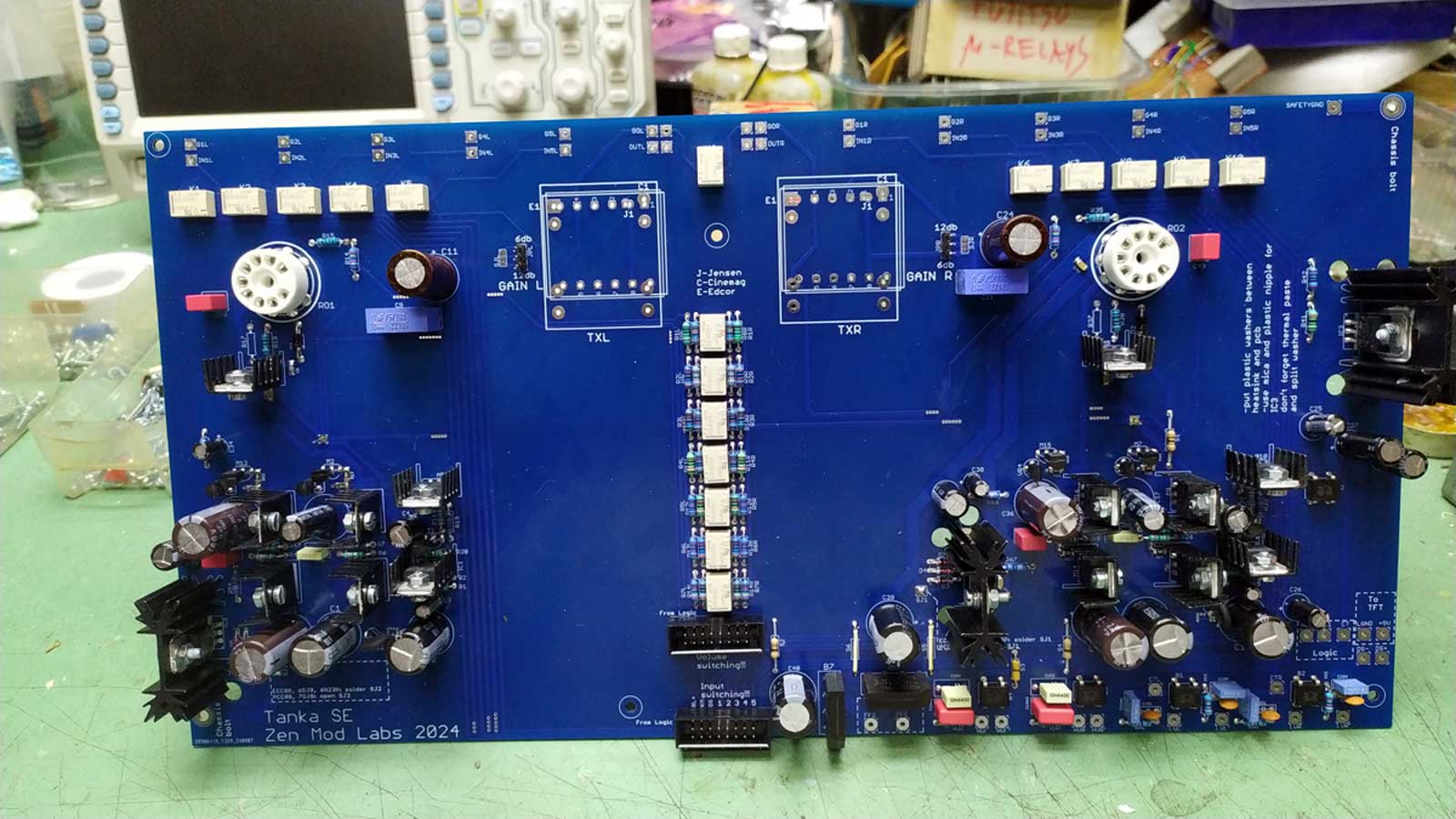

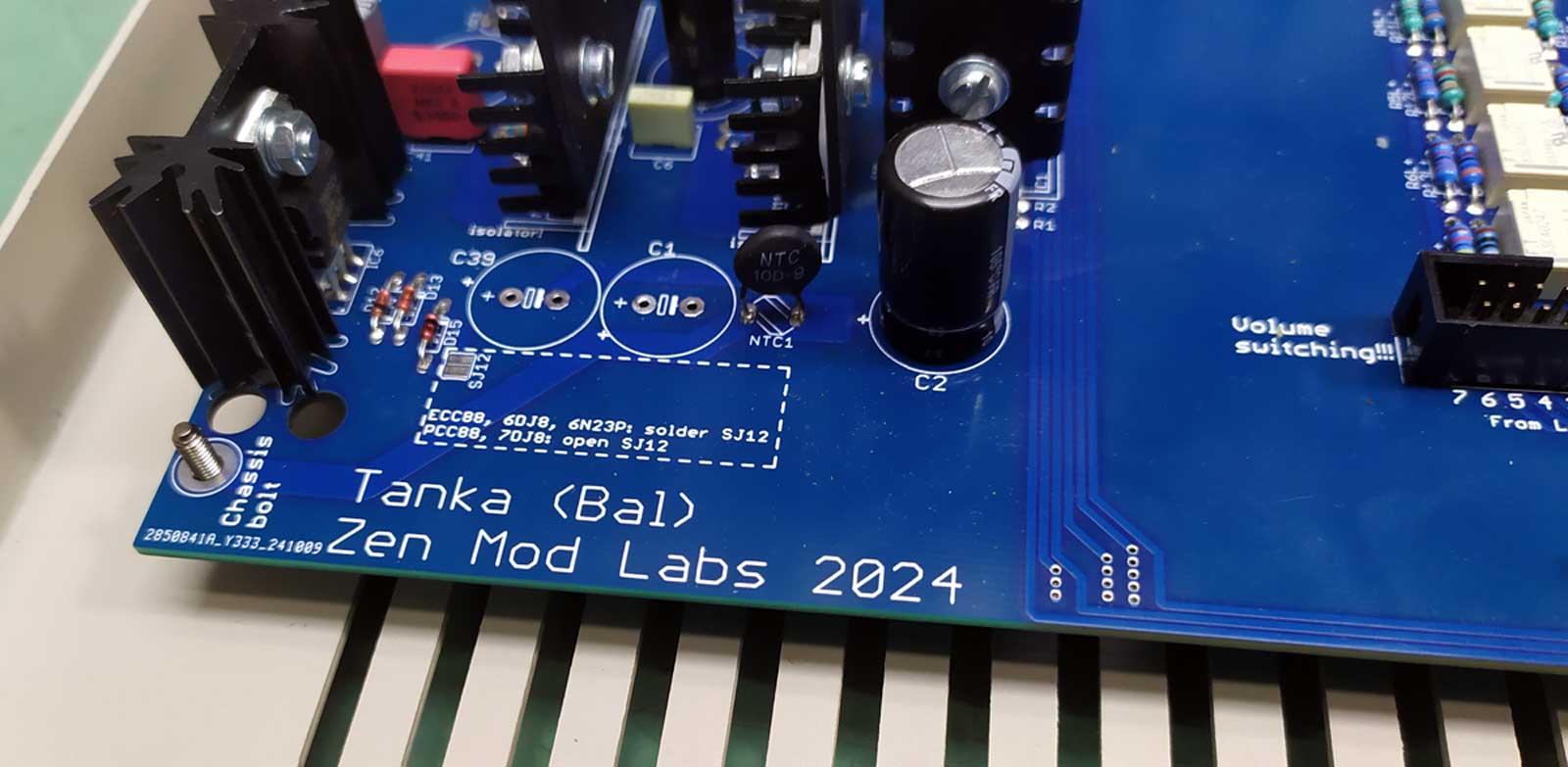

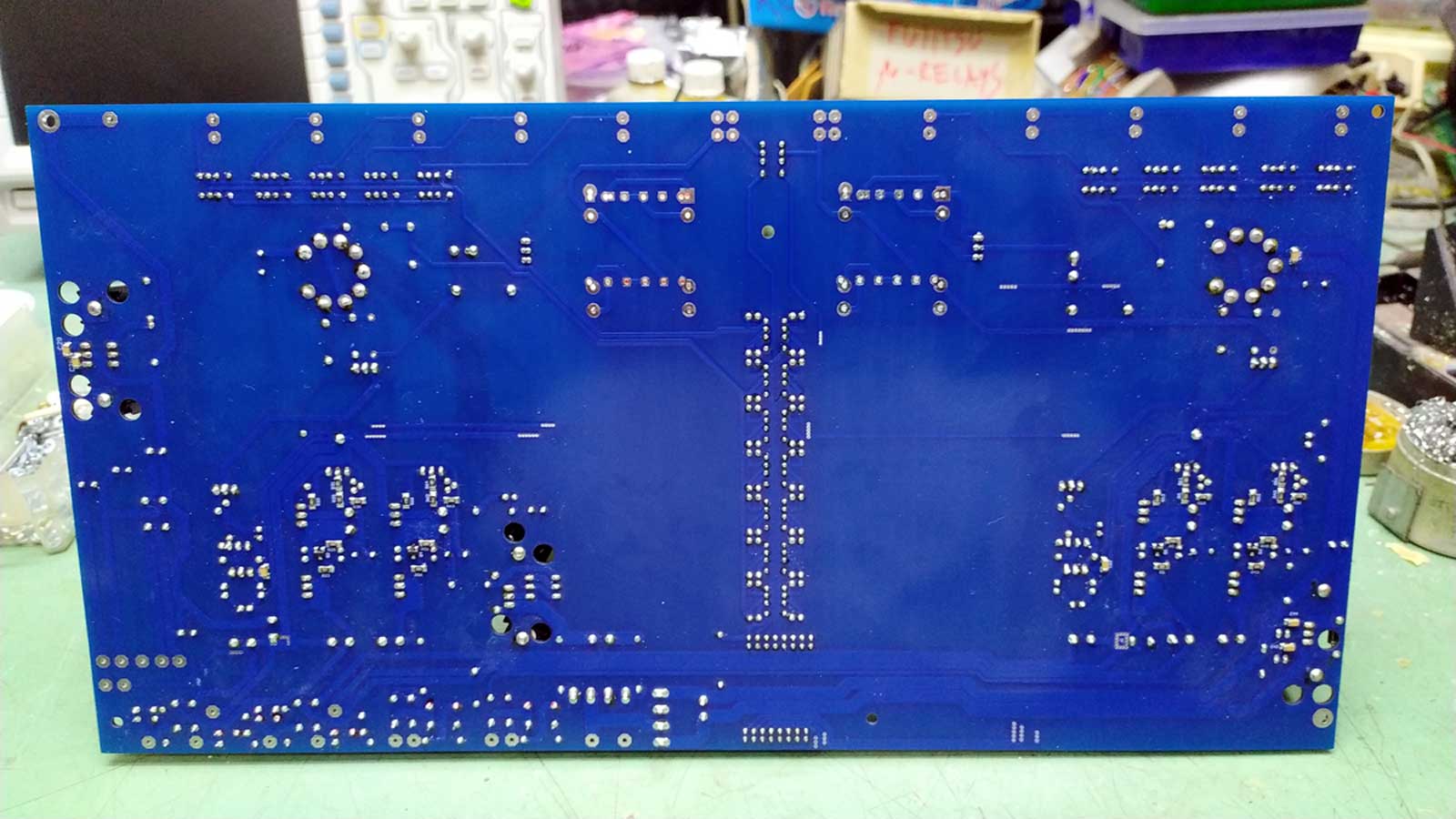

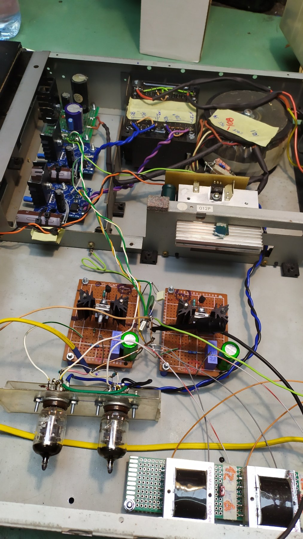

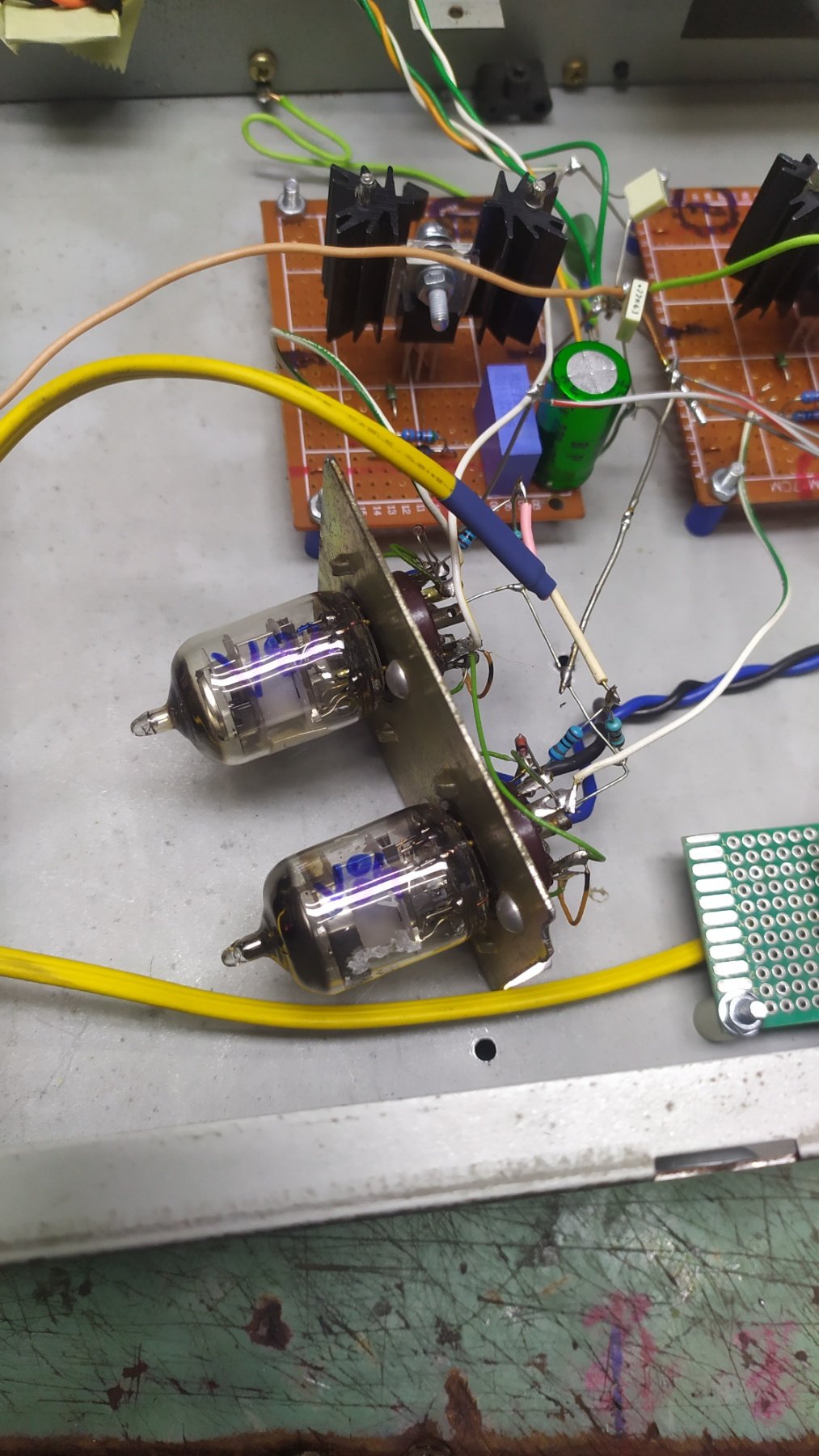

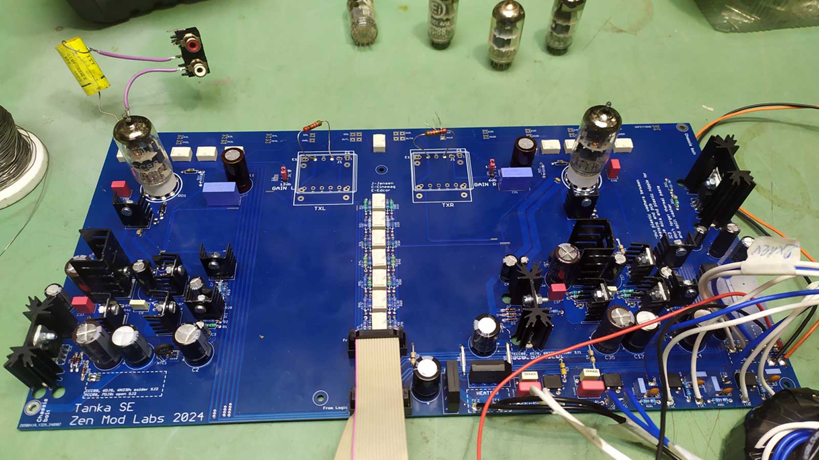

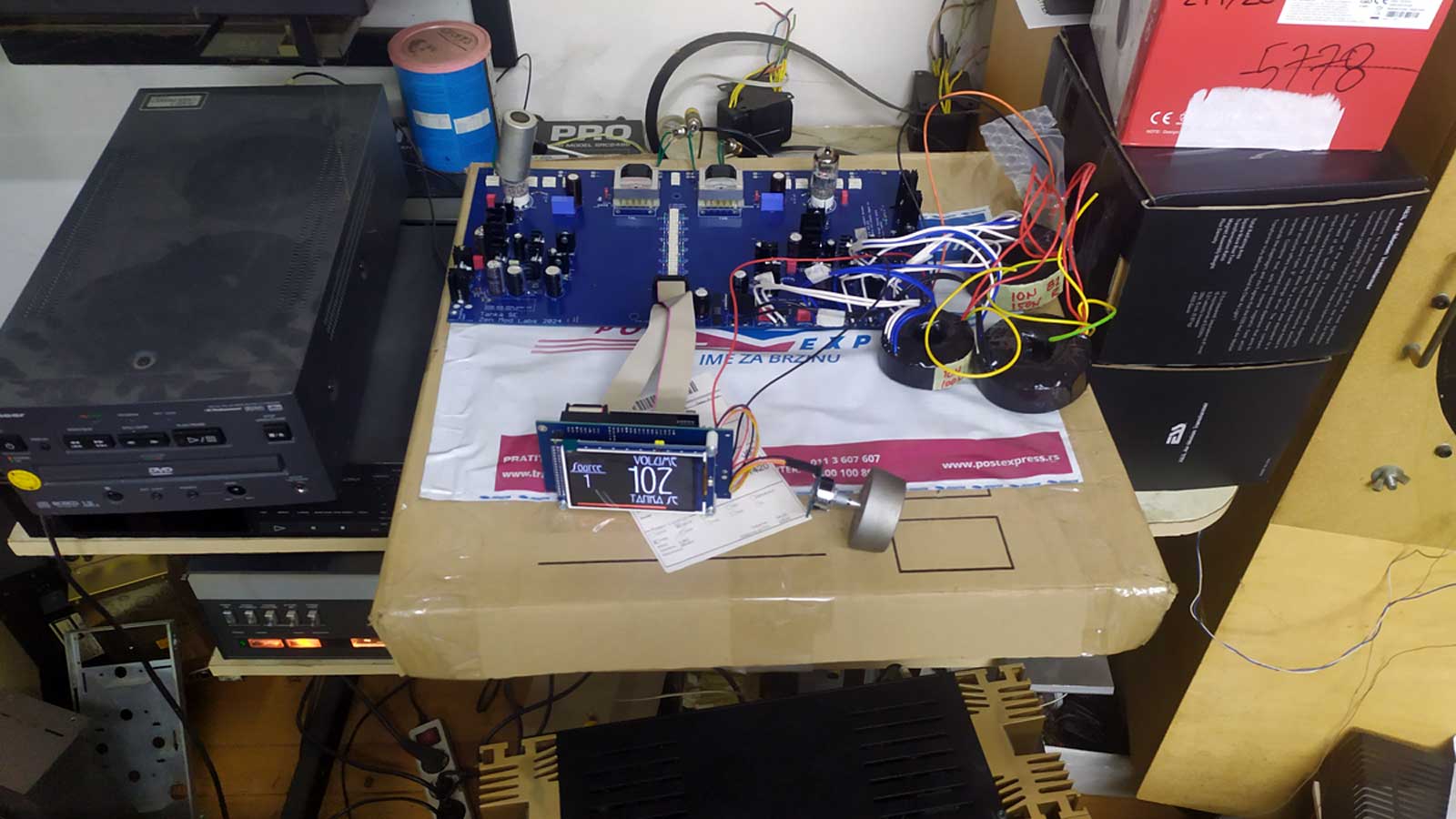

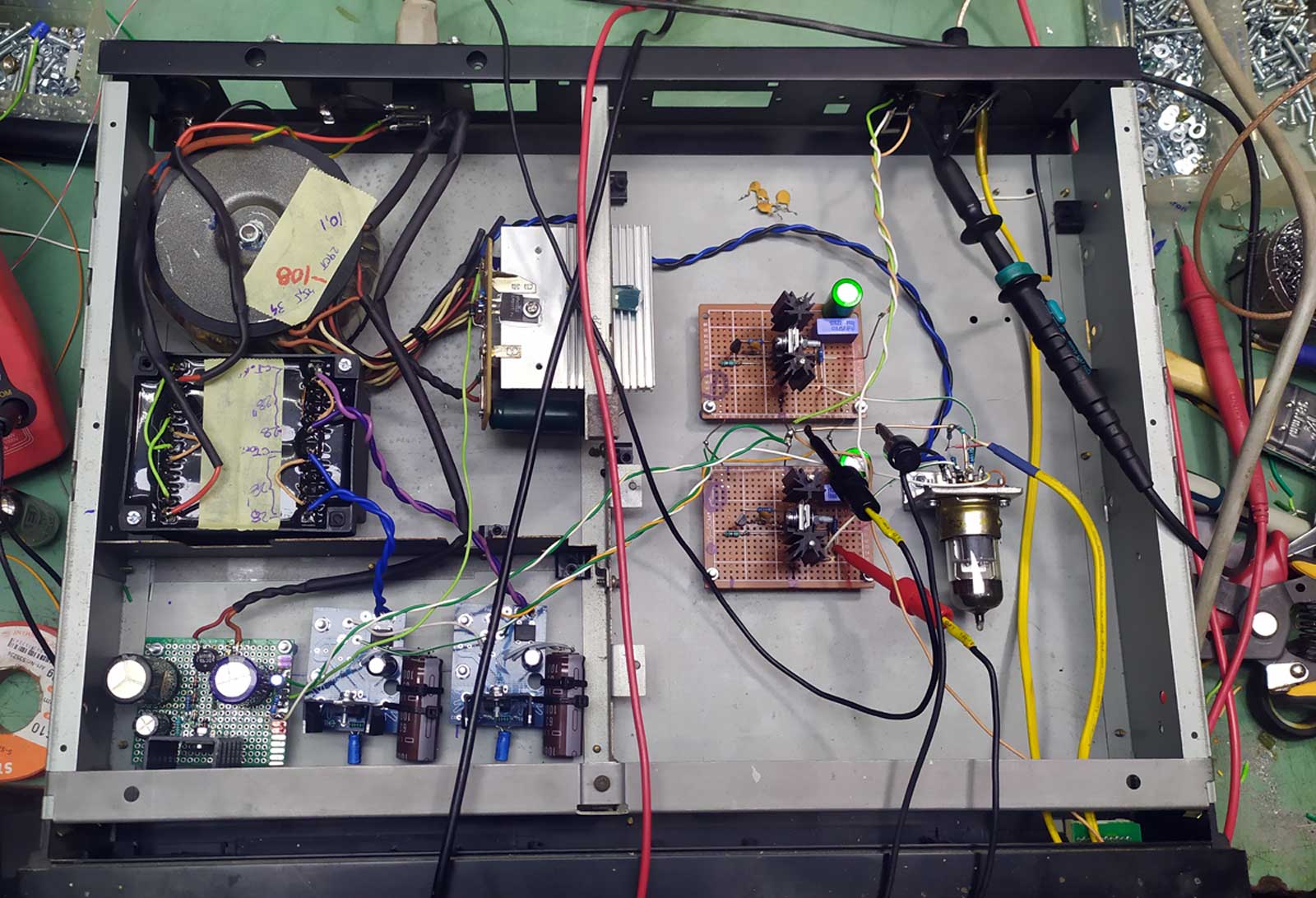

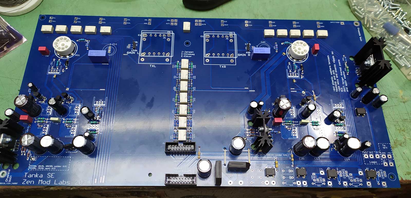

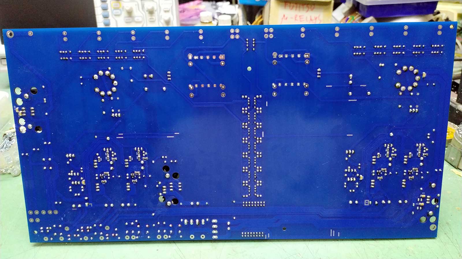

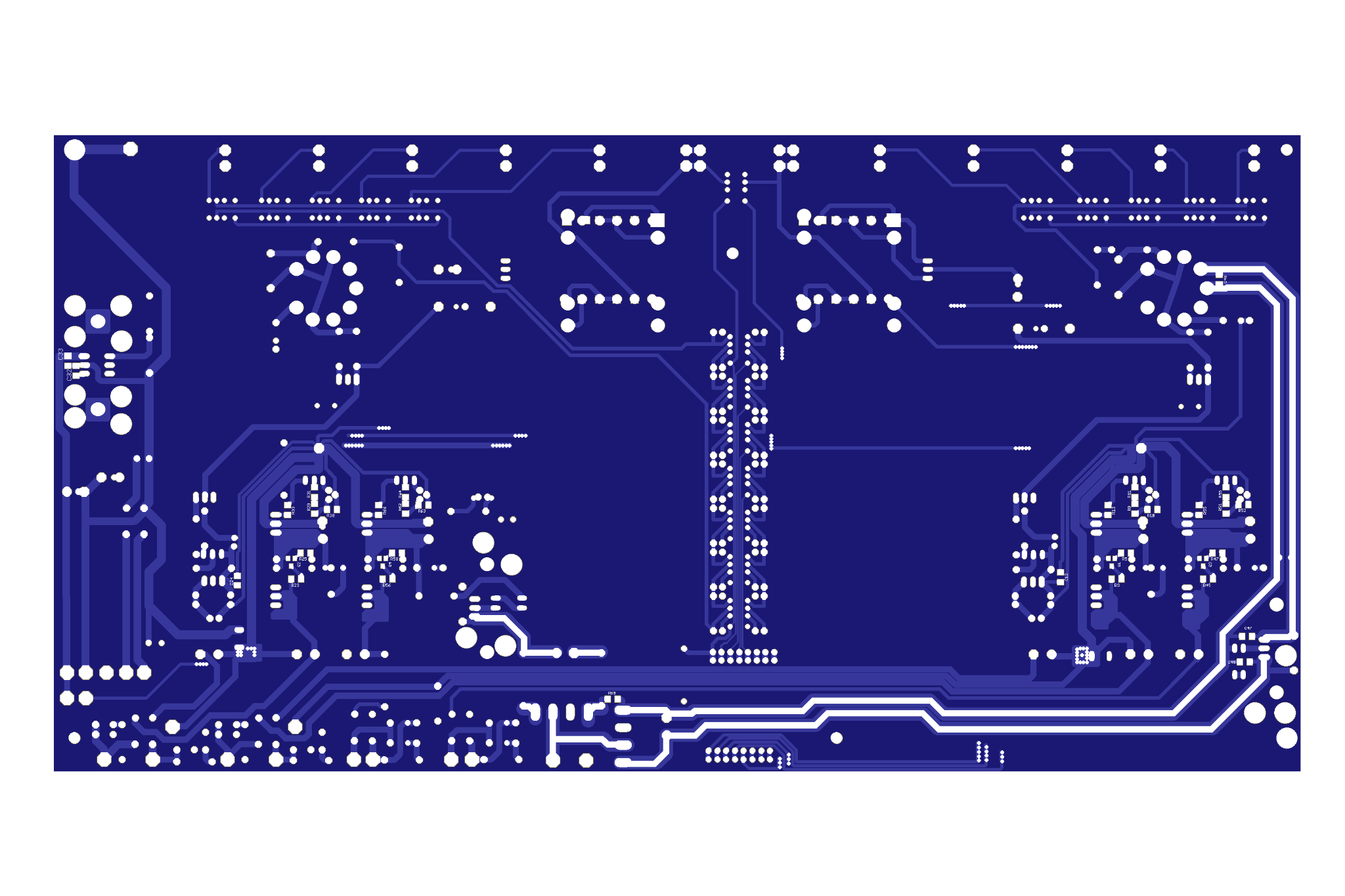

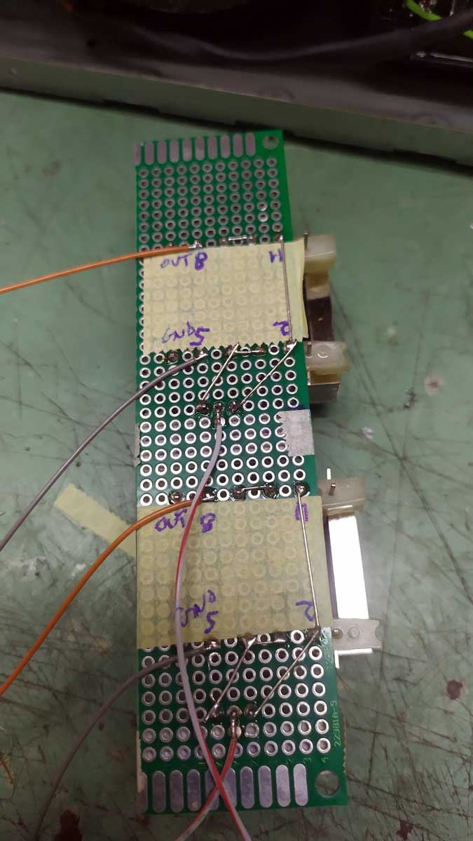

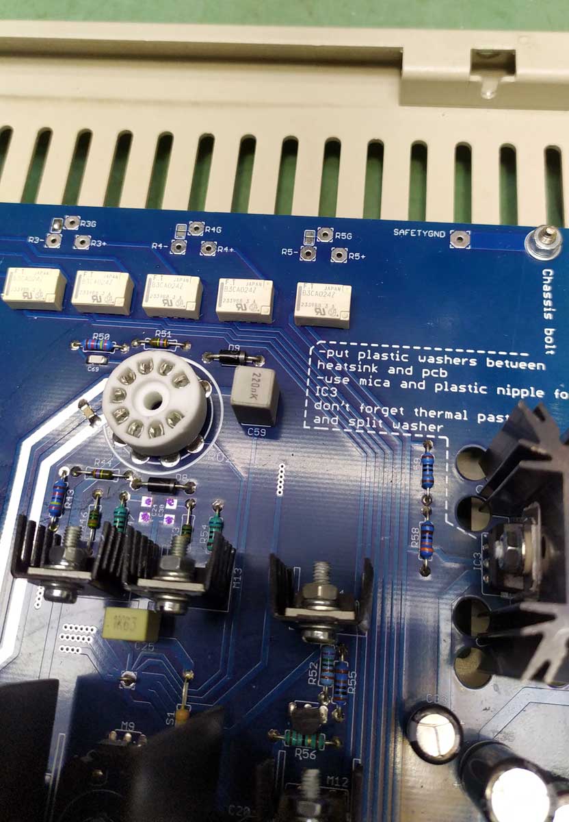

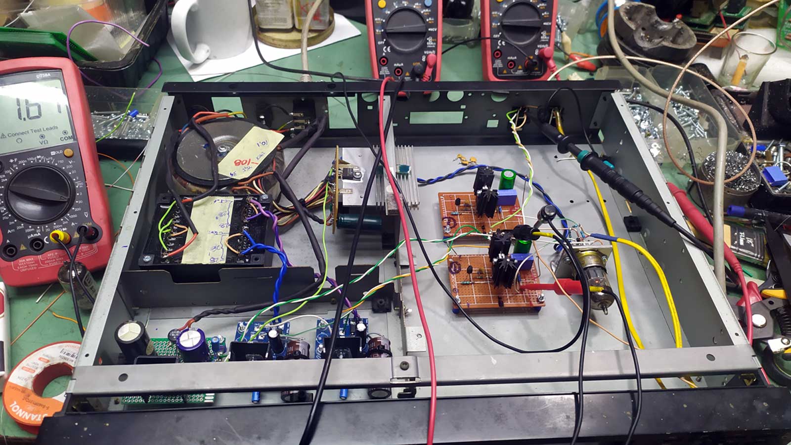

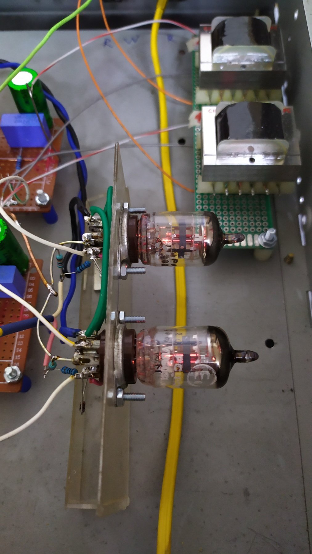

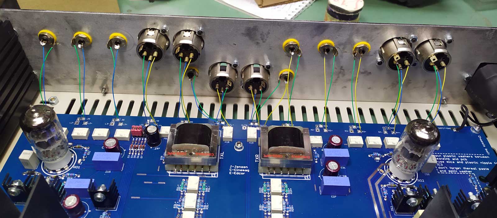

Prototyping phase pics
Tubes used PC900, E180F (connected as triode) and ECC88

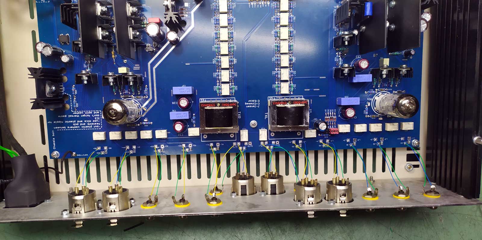

End choice is E180F for SE (needing one triode system/channel, and in this arrangement not possible paralleling 2 triode systems of ECC), and ECC88 for Bal (1 triode system per phase)
All named toobz are hefty xconductance and enough cojones for Iq; 90V at anode and Iq aroundish 10mA perfect

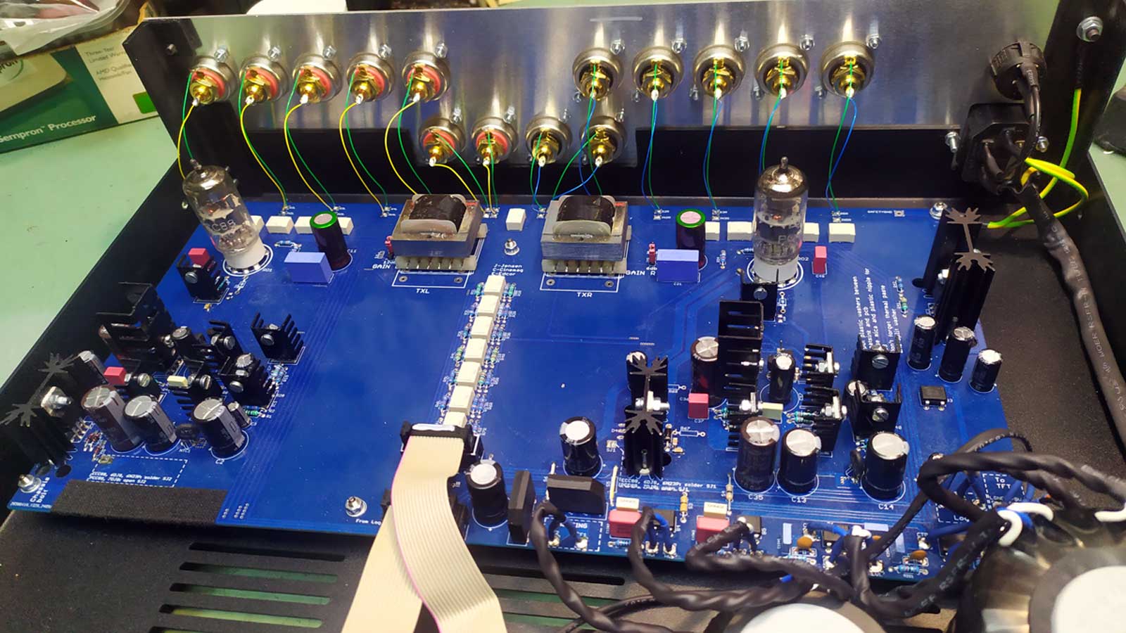

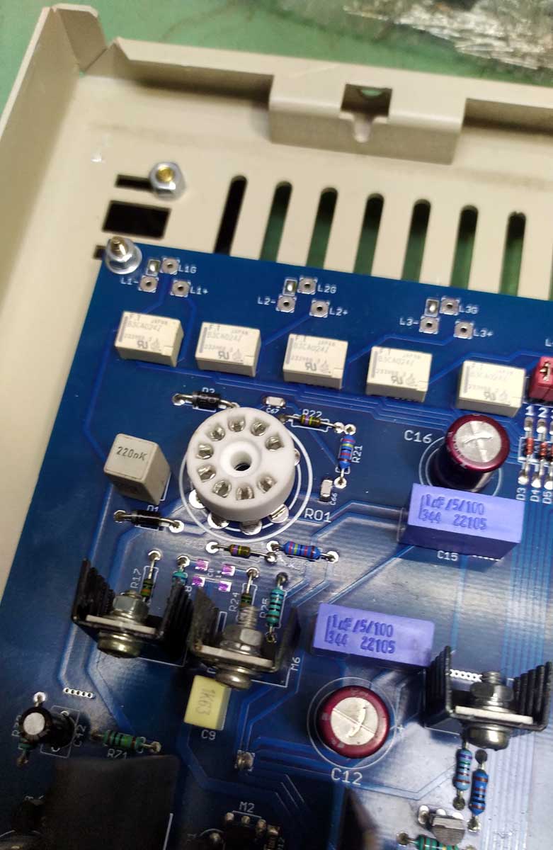

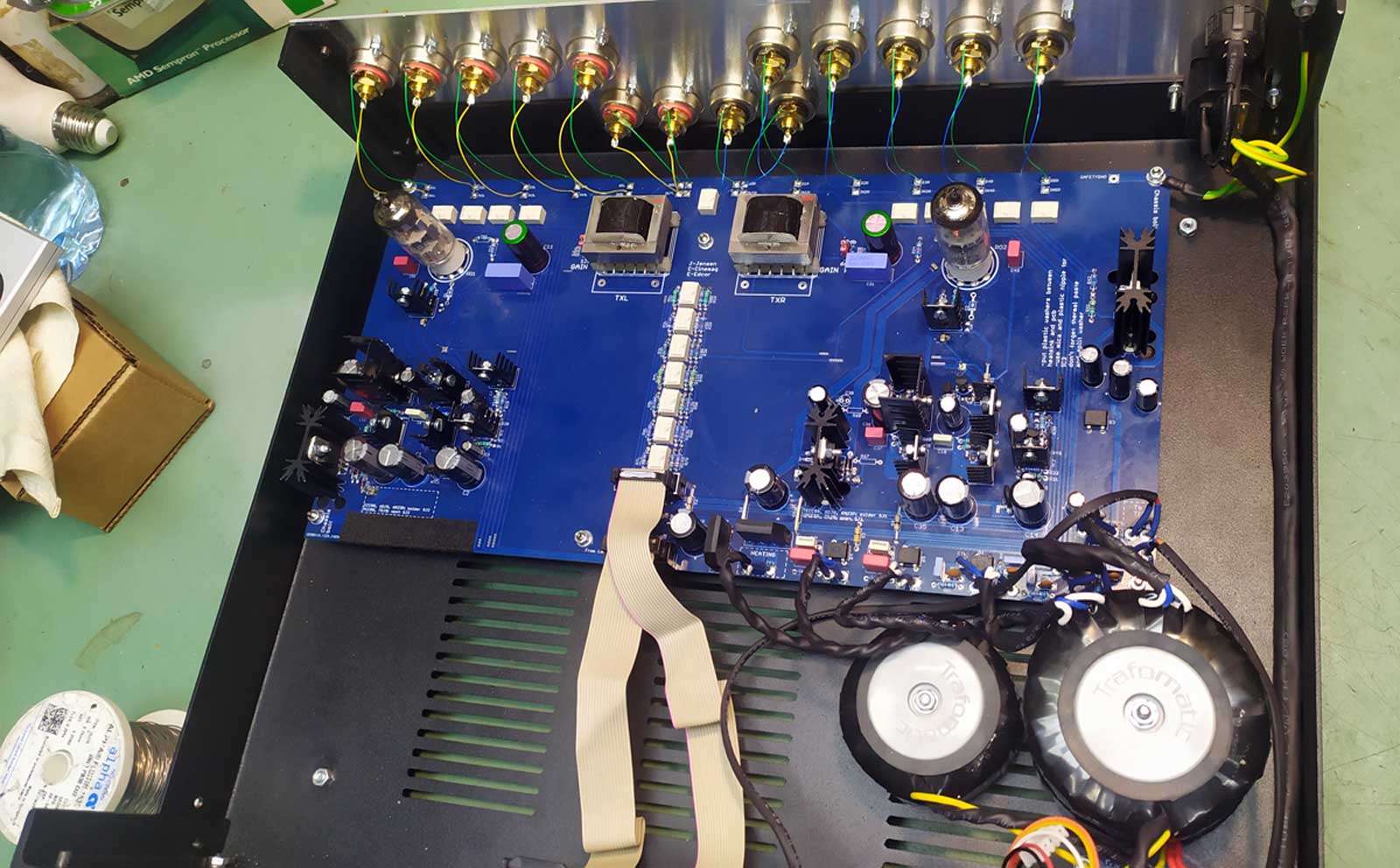

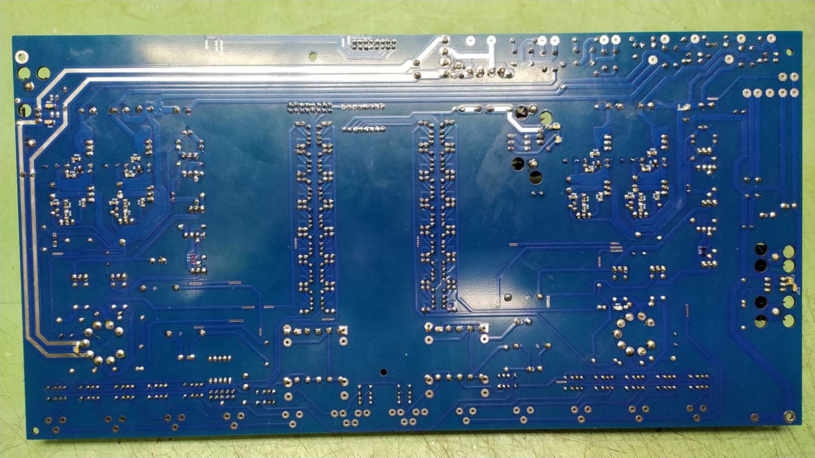

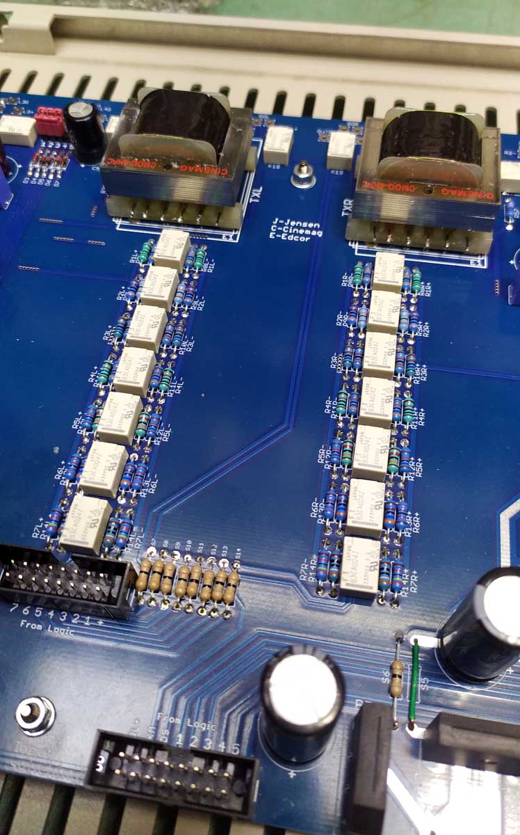

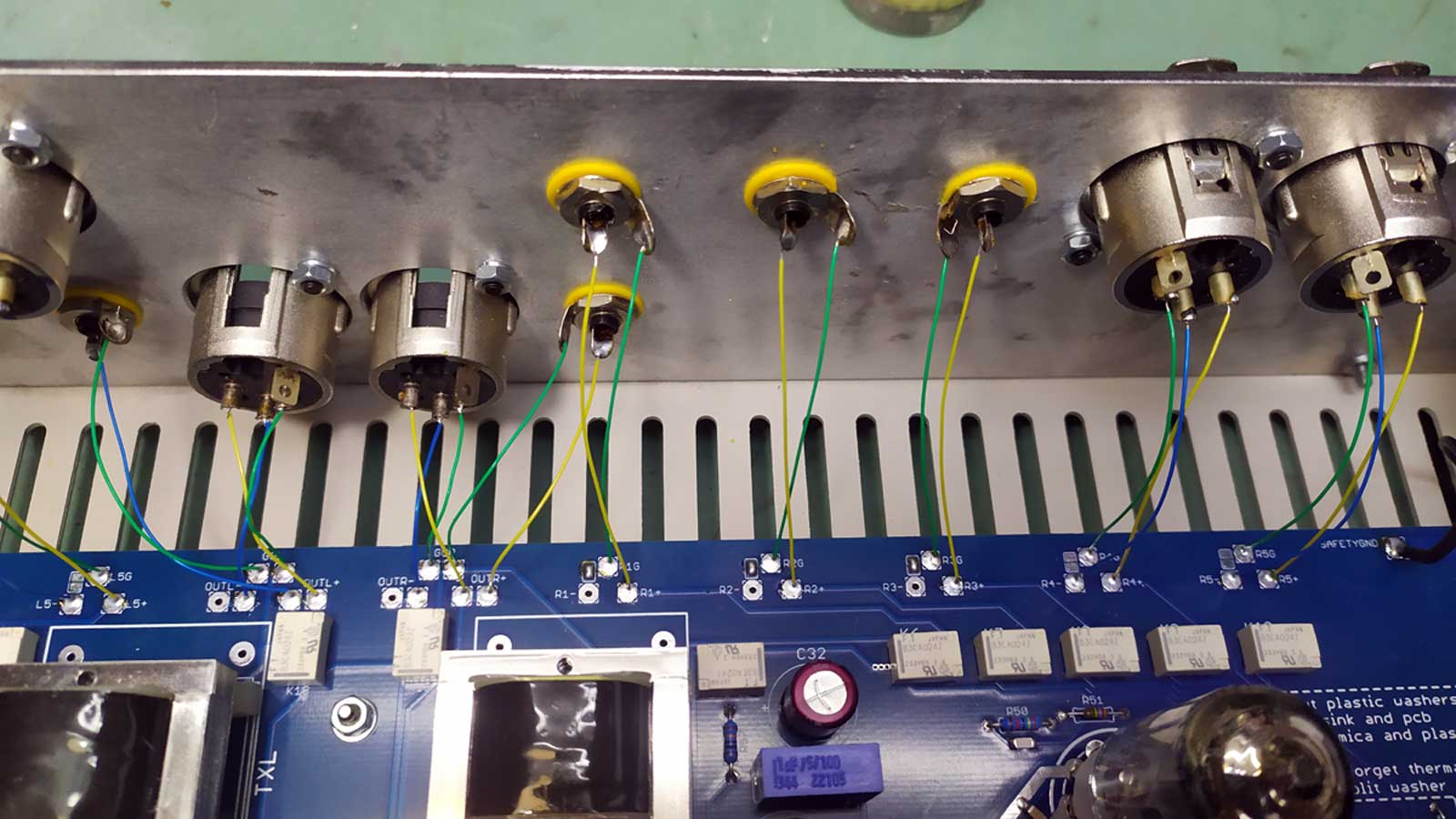

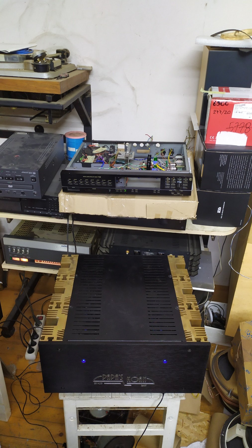

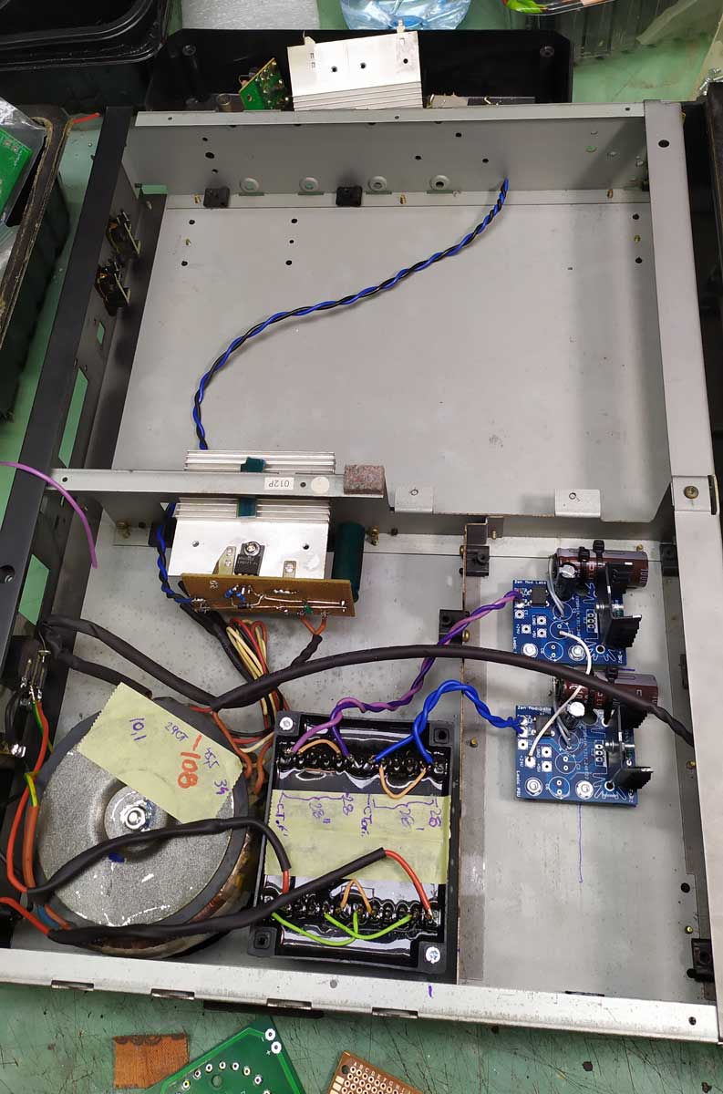

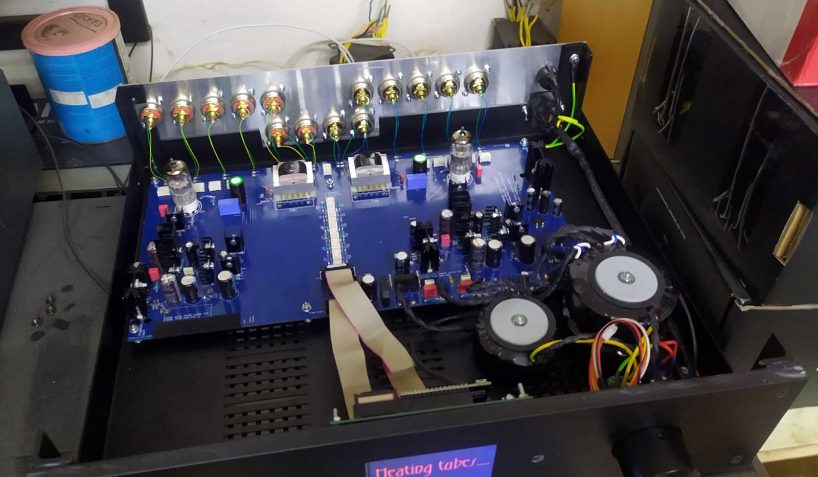

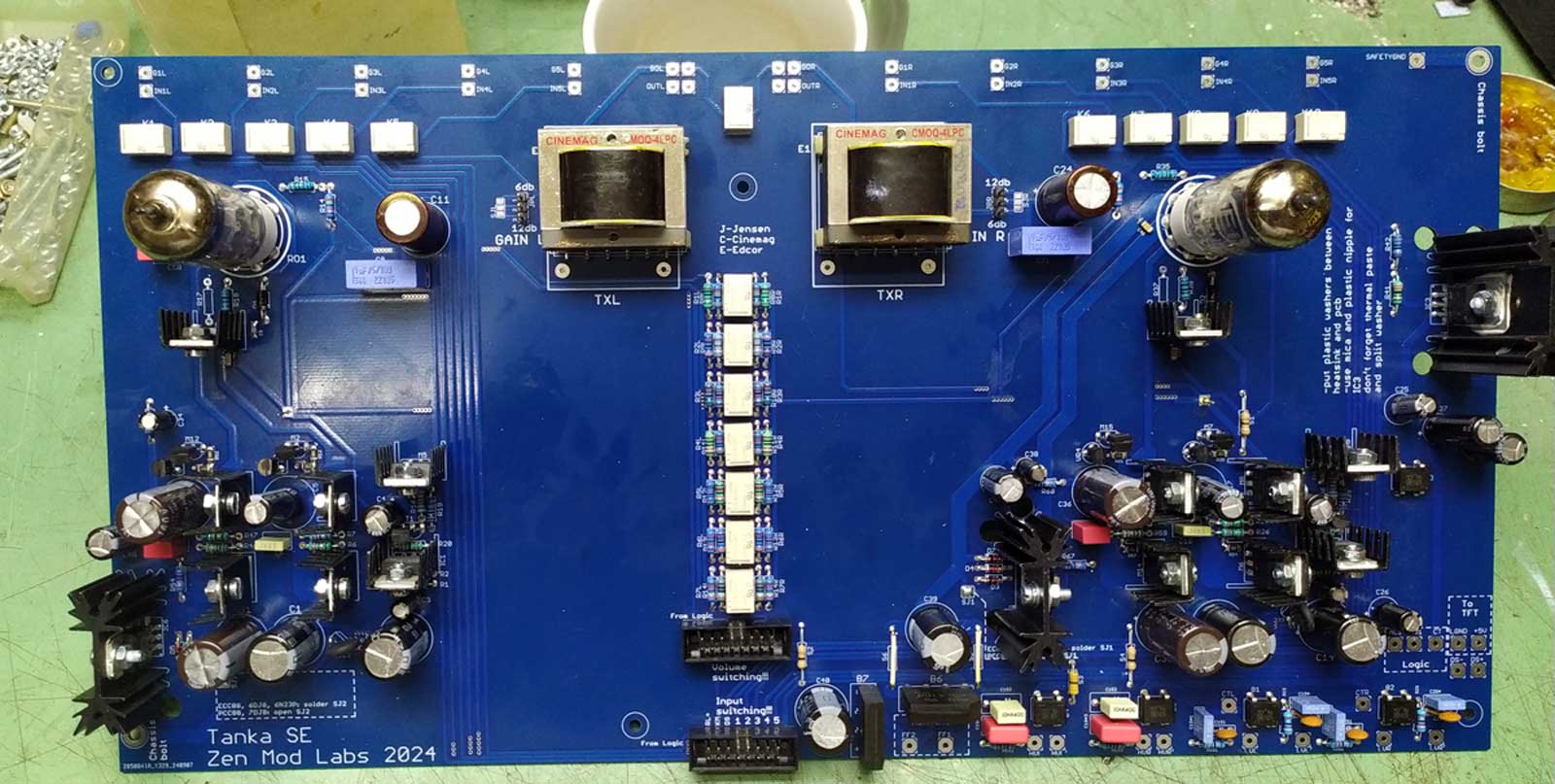

Tanka SE Zero specimen; in fact, this project was commissioned and this one is serving as proof of ZM's Cojones ....... and demo gadget.
To/for whom, my lips are sealed, IP is still al mine and will stay as such

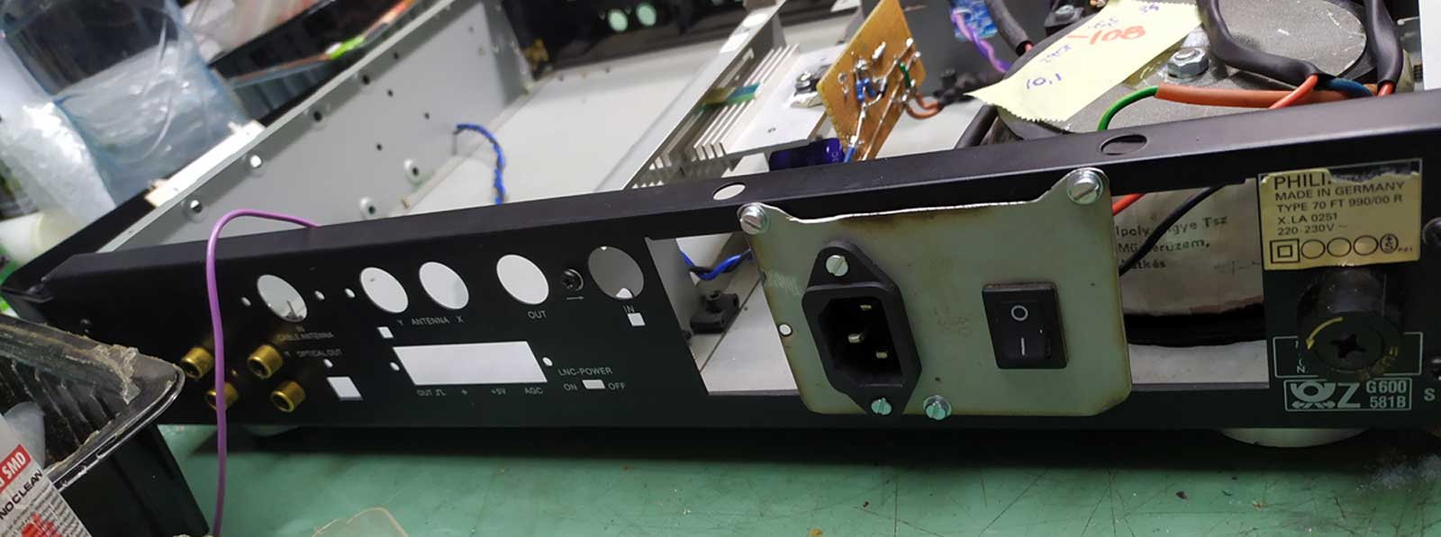

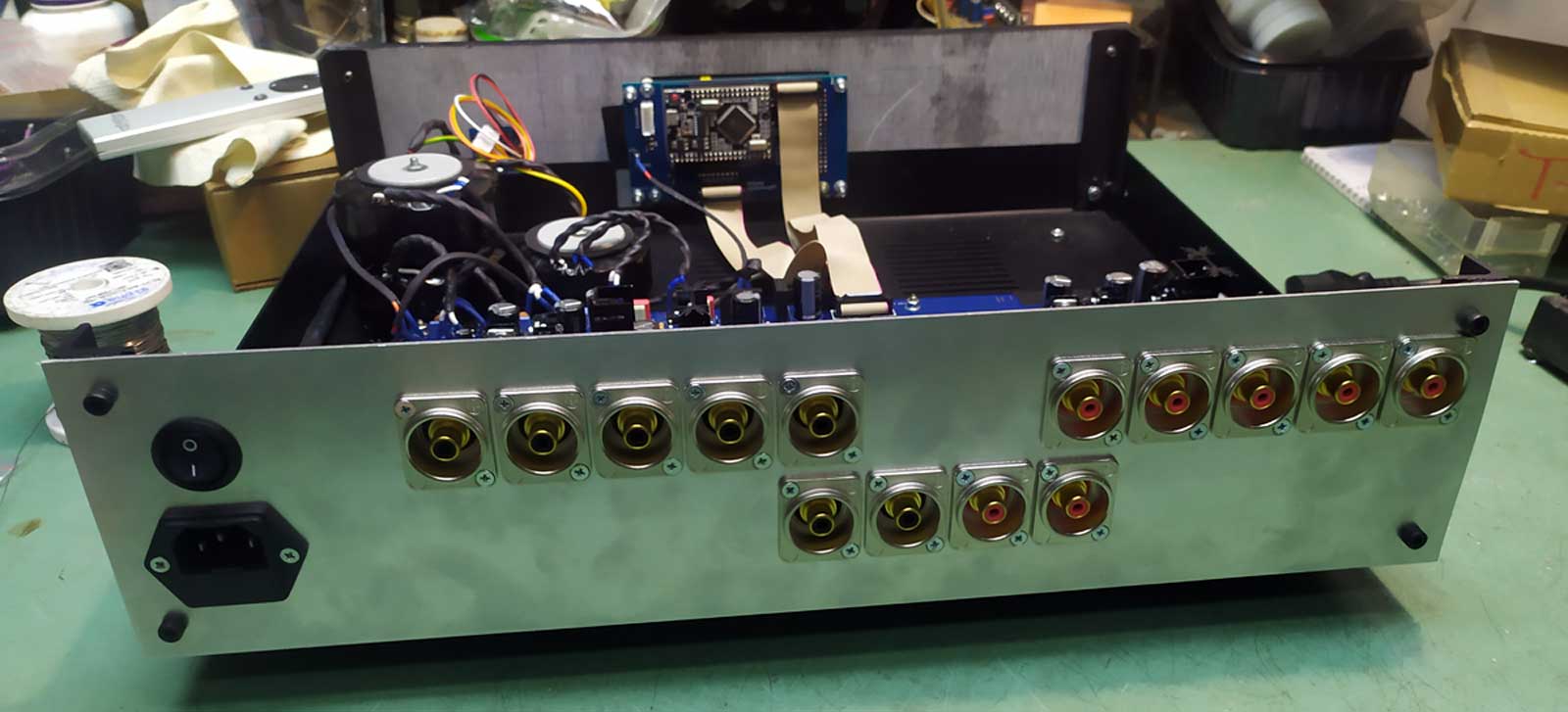

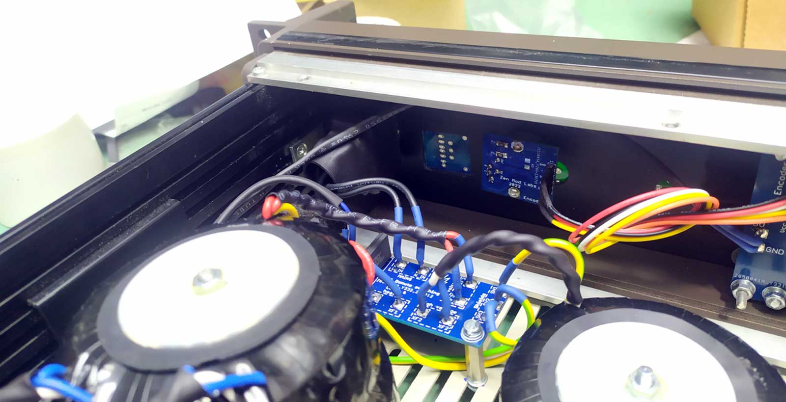

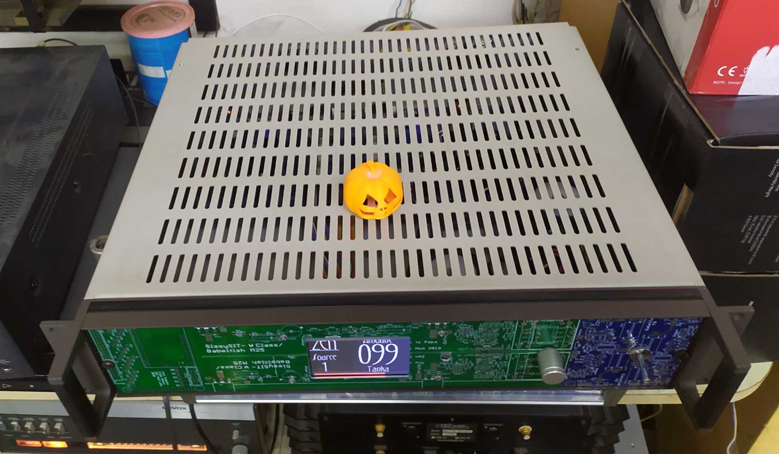

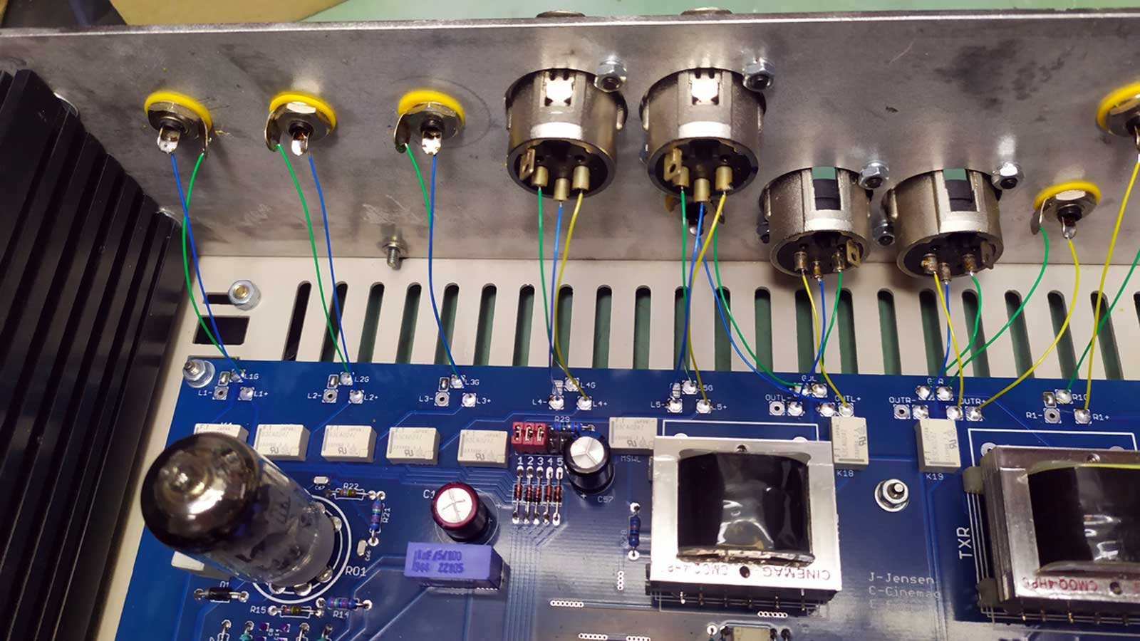

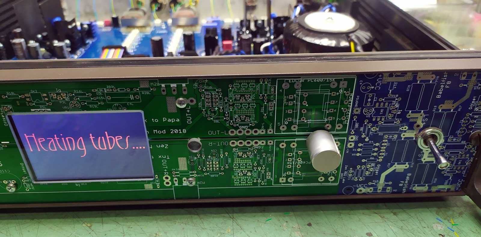

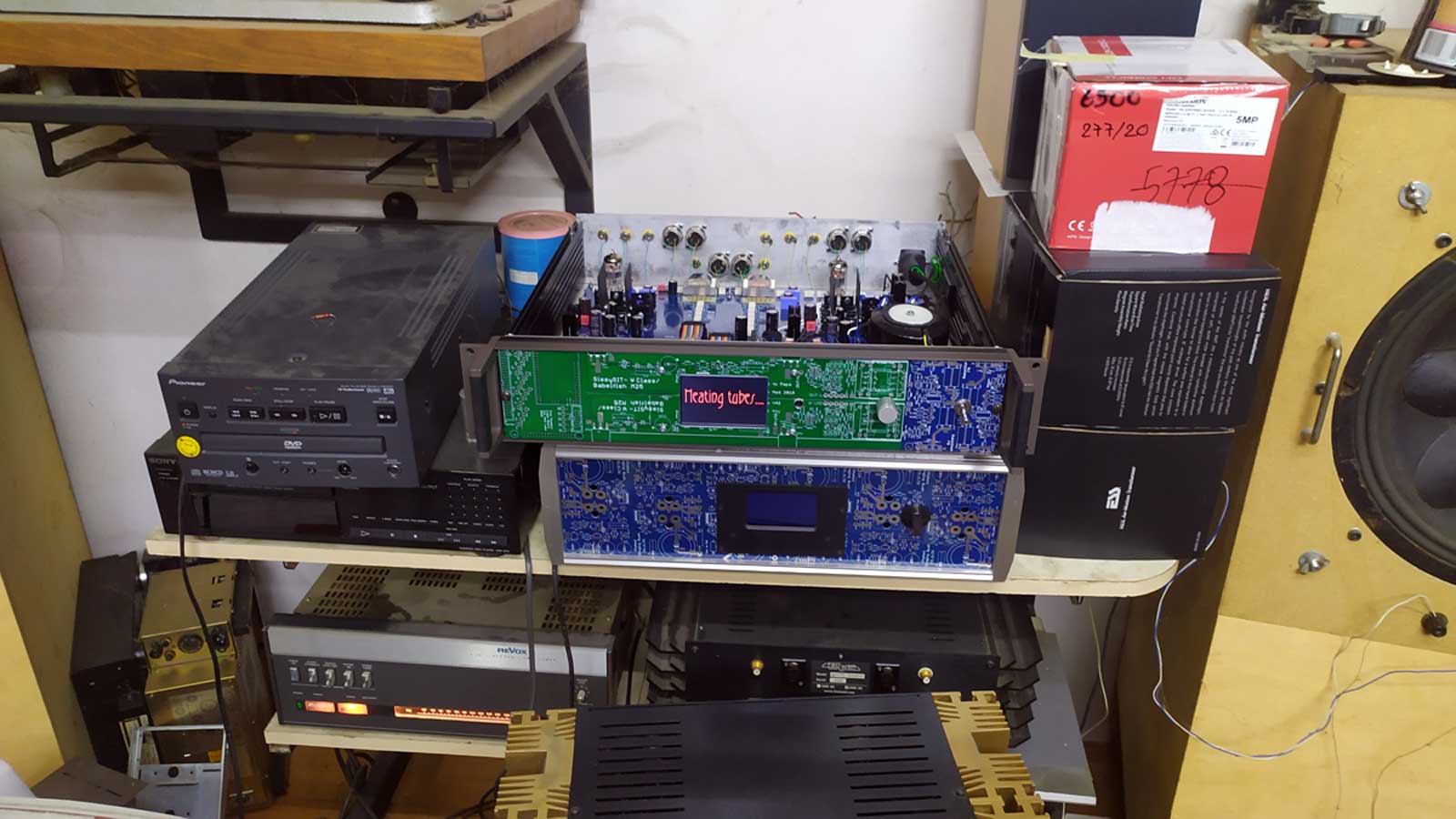

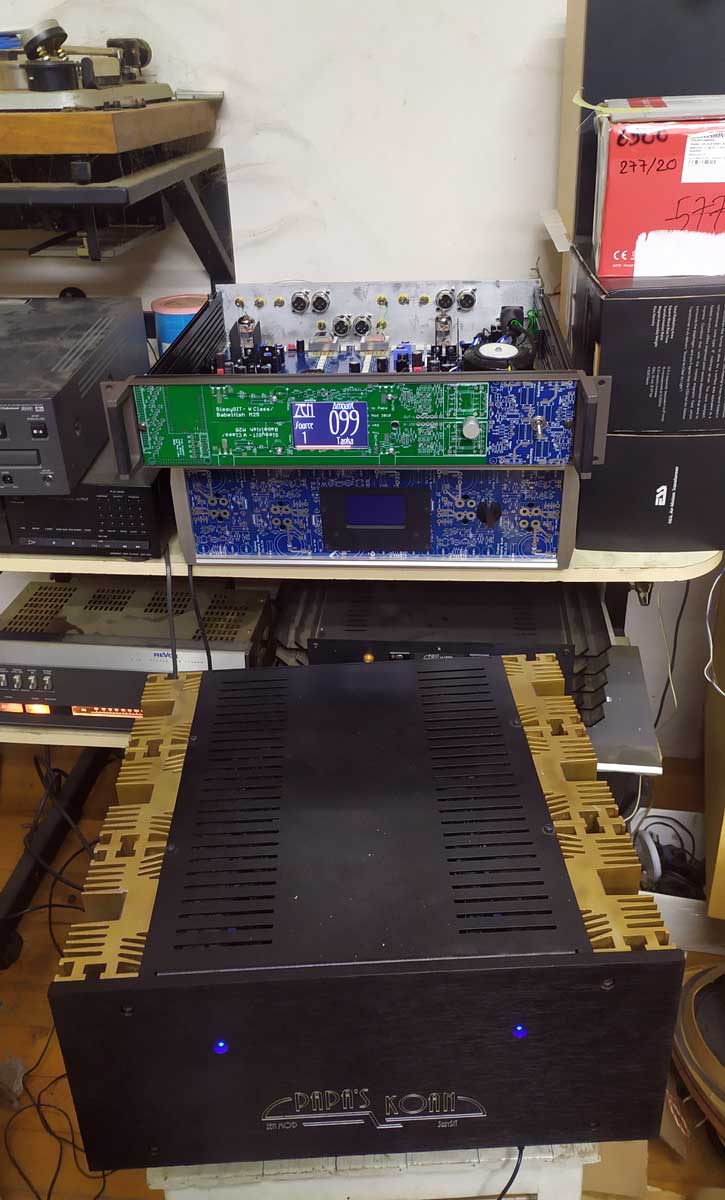

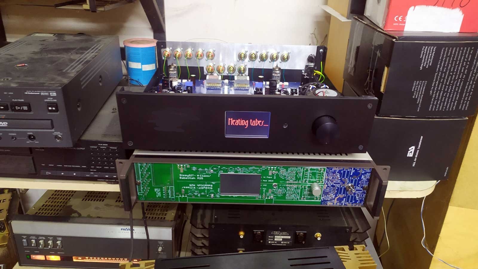

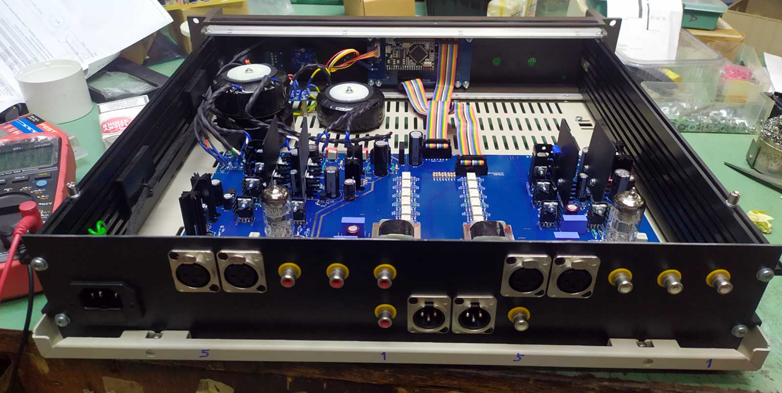

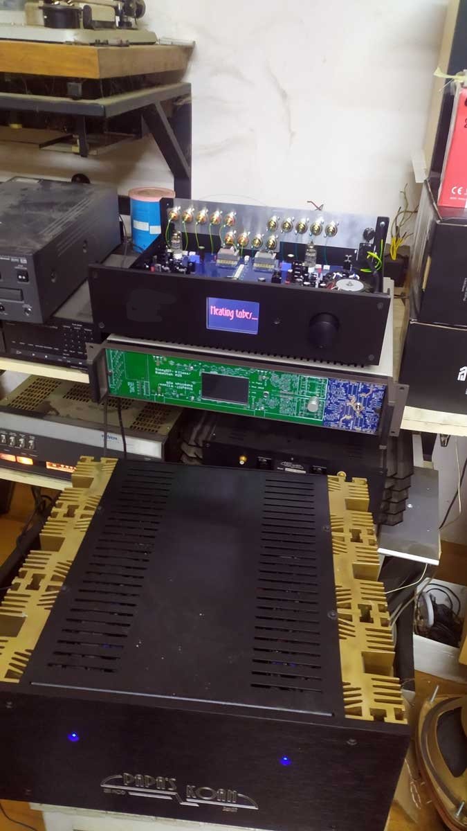

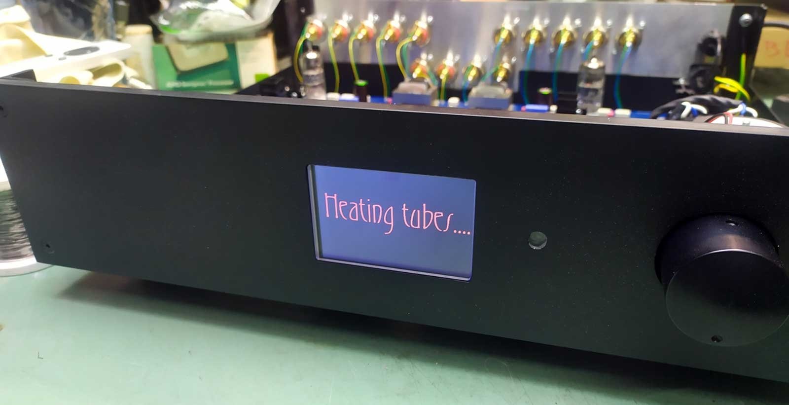

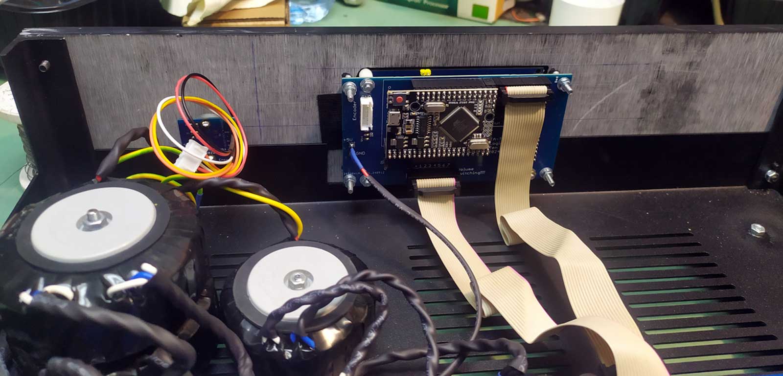

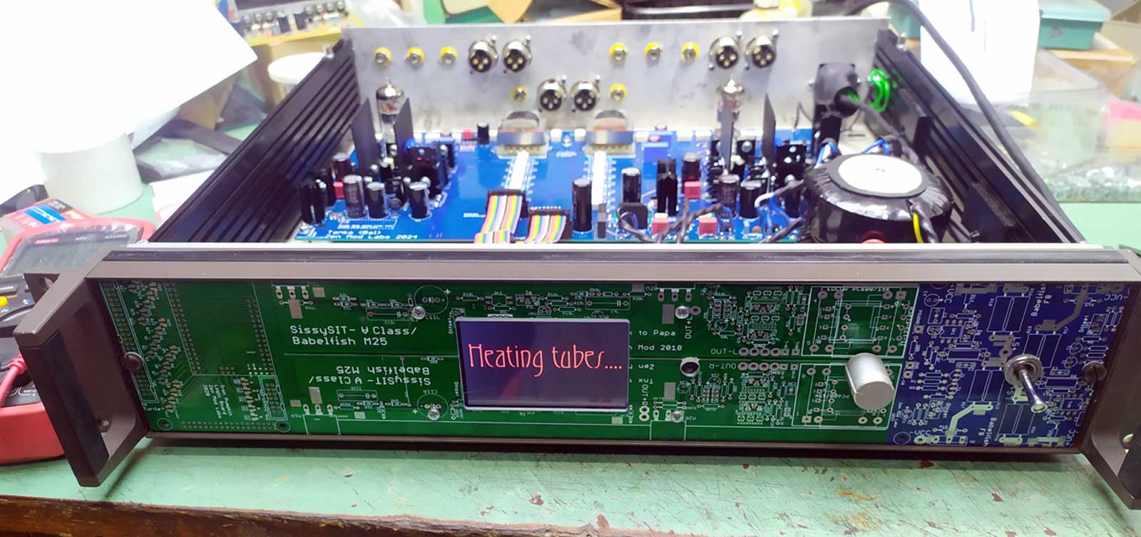

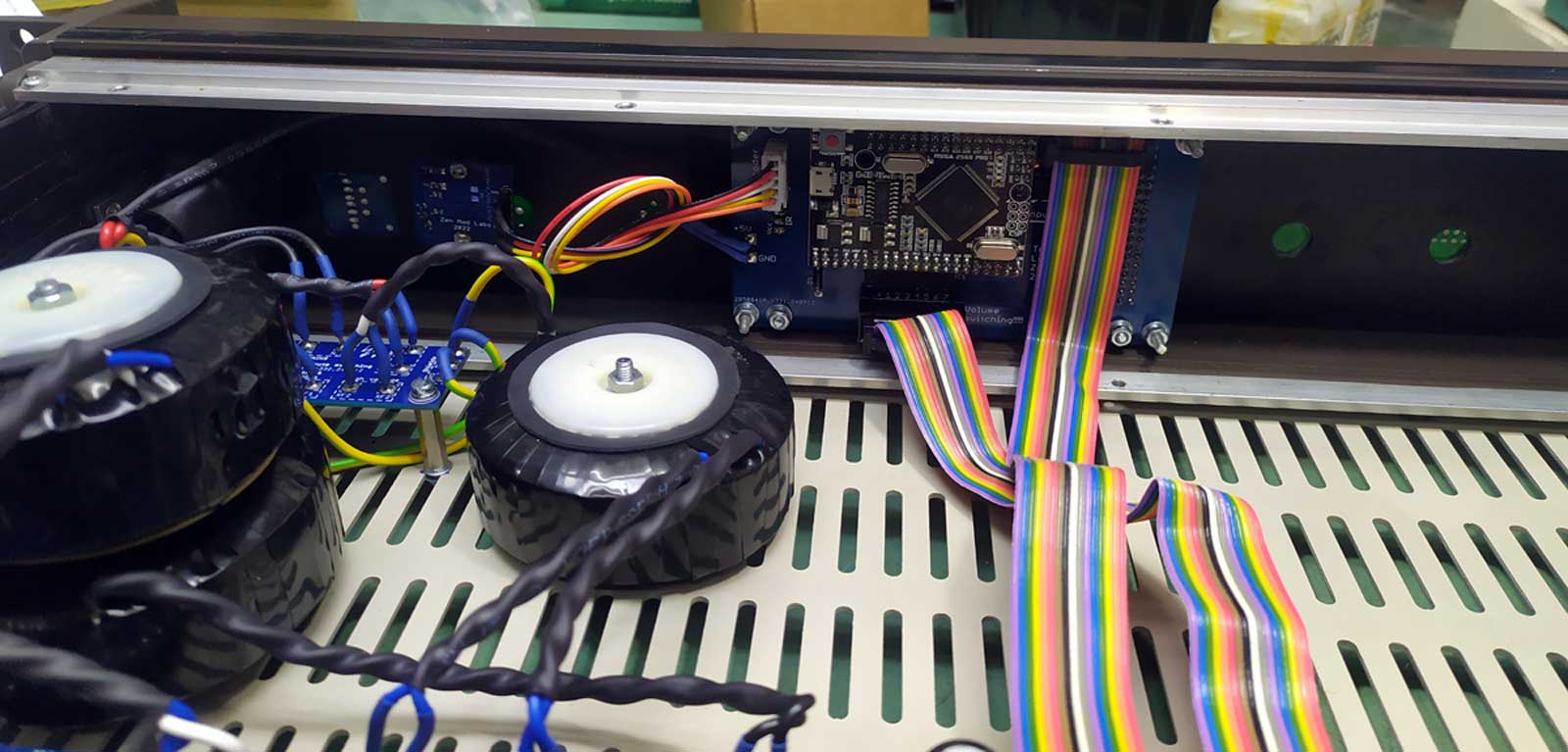

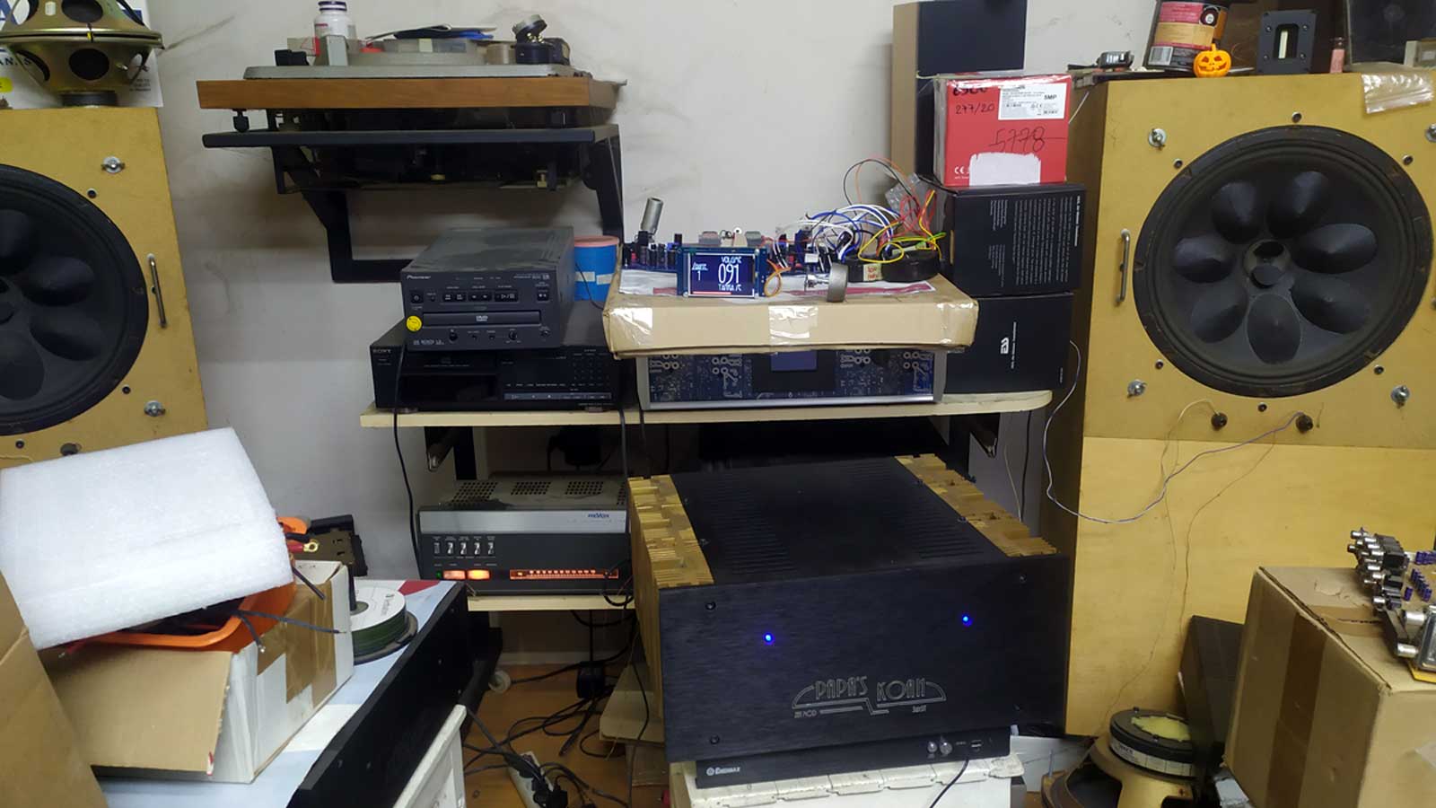

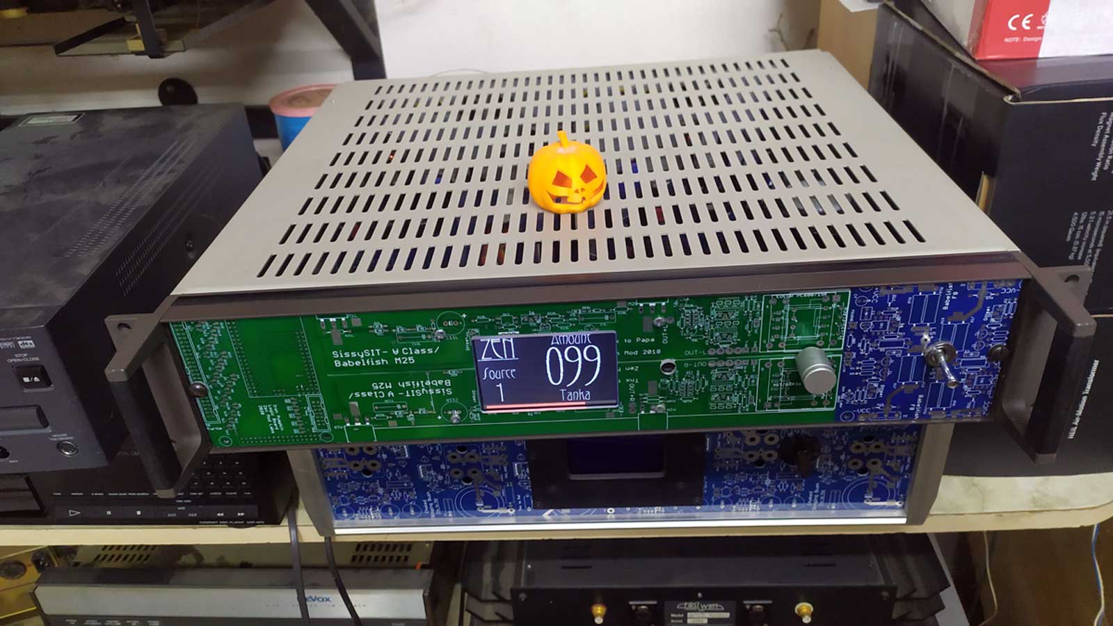

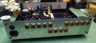

And then, my own workshop demo - Tanka, "industrial case", as way to preventing anyone to take it from my hands
Continuo

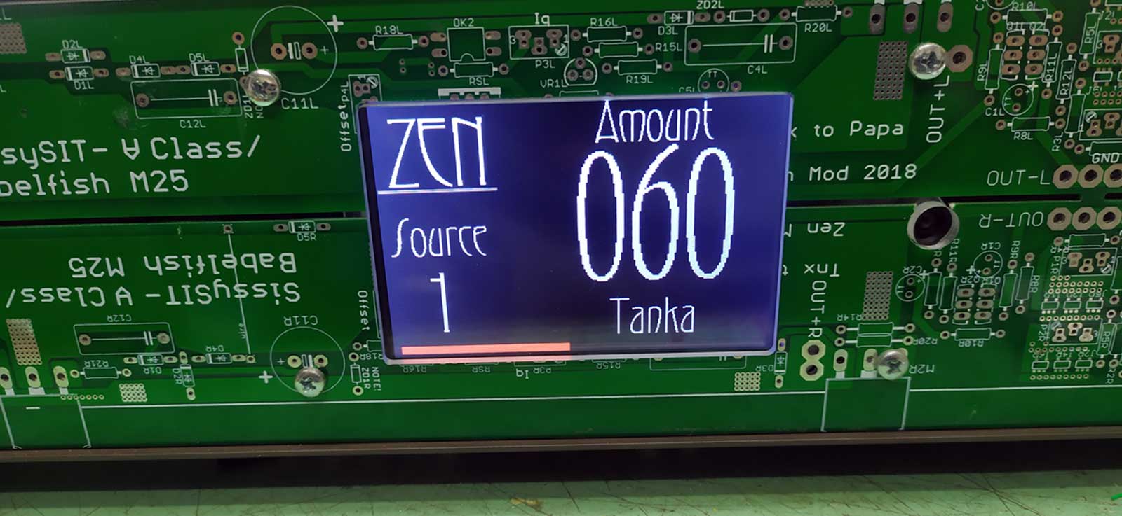

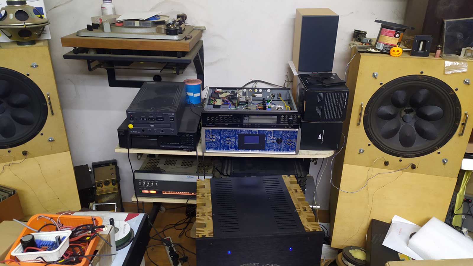

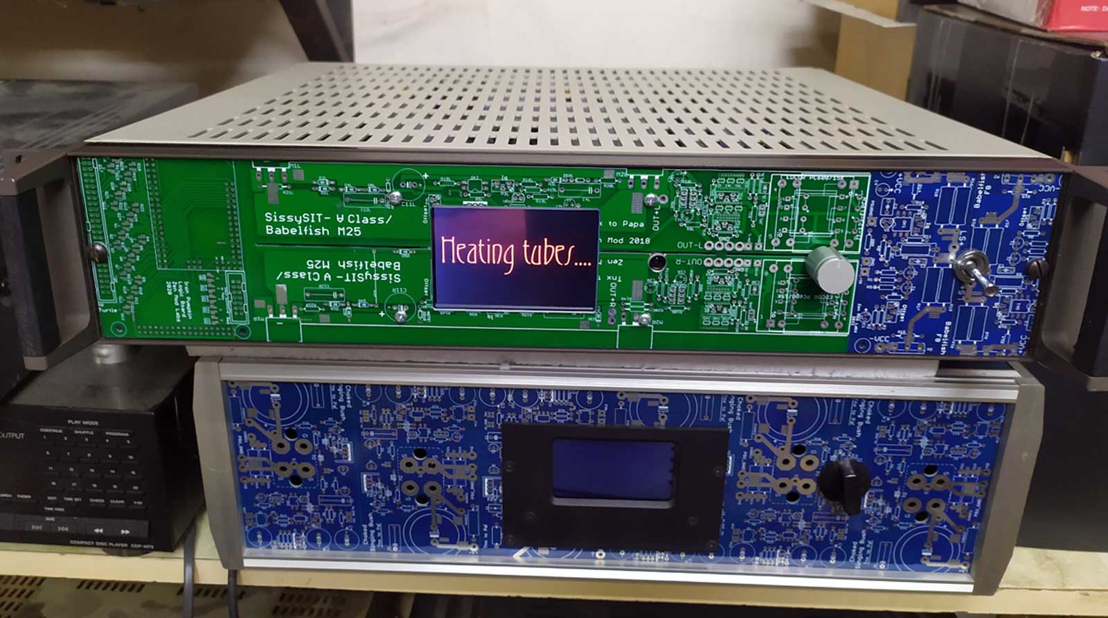

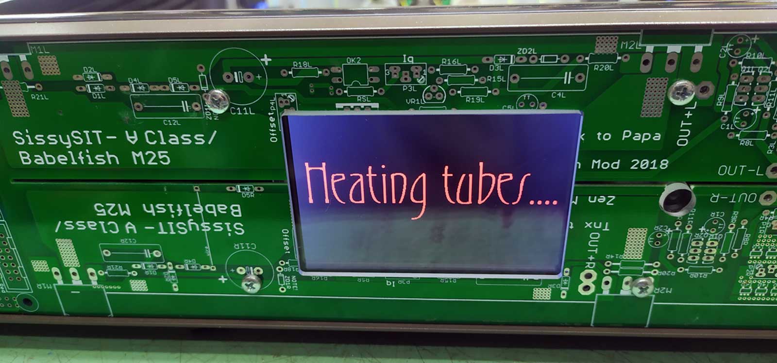

Lovely lovey work. If you believe in voicing, what amp did you voice/develop it with? I'm imagining Tanka gives extra tube goodness to F6/F5/F4 type, but some might be better off with Irreverent for Aleph J or M2 - is there such as thing as too much tube & Iron & H2 that things become gooey?
The script on the display is very cool!
I had a dream of using Tesla-handwriting font for Greeting screen and Gradl for functional screen
After some wrestling with conversion of these to Arduino, and then with all limits I had regarding size/definition, due to TFT library I'm using......... well, I'm mostly satisfied
btw. in my head - Gradl is Led Zeppelin font
Pa did use, as my fragile memory sez, some variations of both Gradl and Plaza, on FW products
heh, howza there not something as Zappa font????
never did even think of it!
ggle is my friend:
https://www.fontspace.com/category/frank-zappa
edit: Pa did have Adresack too
