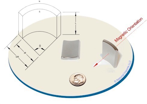

NdFeB arcs
There are very strong NdFeB magnets that are arc shaped, polarized N/S on their curved faces. They can be used to assemble two concentric cylinders with opposing fields to produce a gap - one long magnetic cylinder on the bearing shaft, and short ring on the tone arm joint - you would have a frictionless bearing. BUT you would also have very strong magnetic fields near your cartridge, and hence would likely need some "C" shaped magnetic shielding around the bearing shaft.
One could also wrap a small coil of wire on the edge of the arm joint that could run a small DC current to create a linear motor for anti skating.
