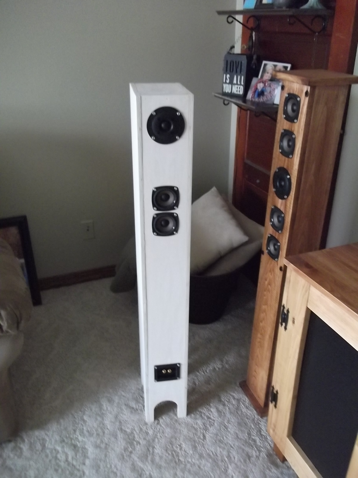

We'll I've been reading up on all the single fullrange MLTL using the now sold out tangband 3" and really got hooked on how good these little guys can sound.

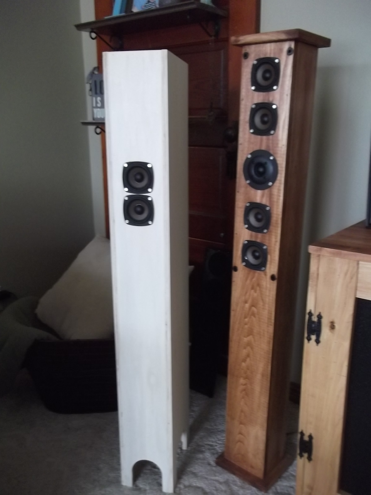

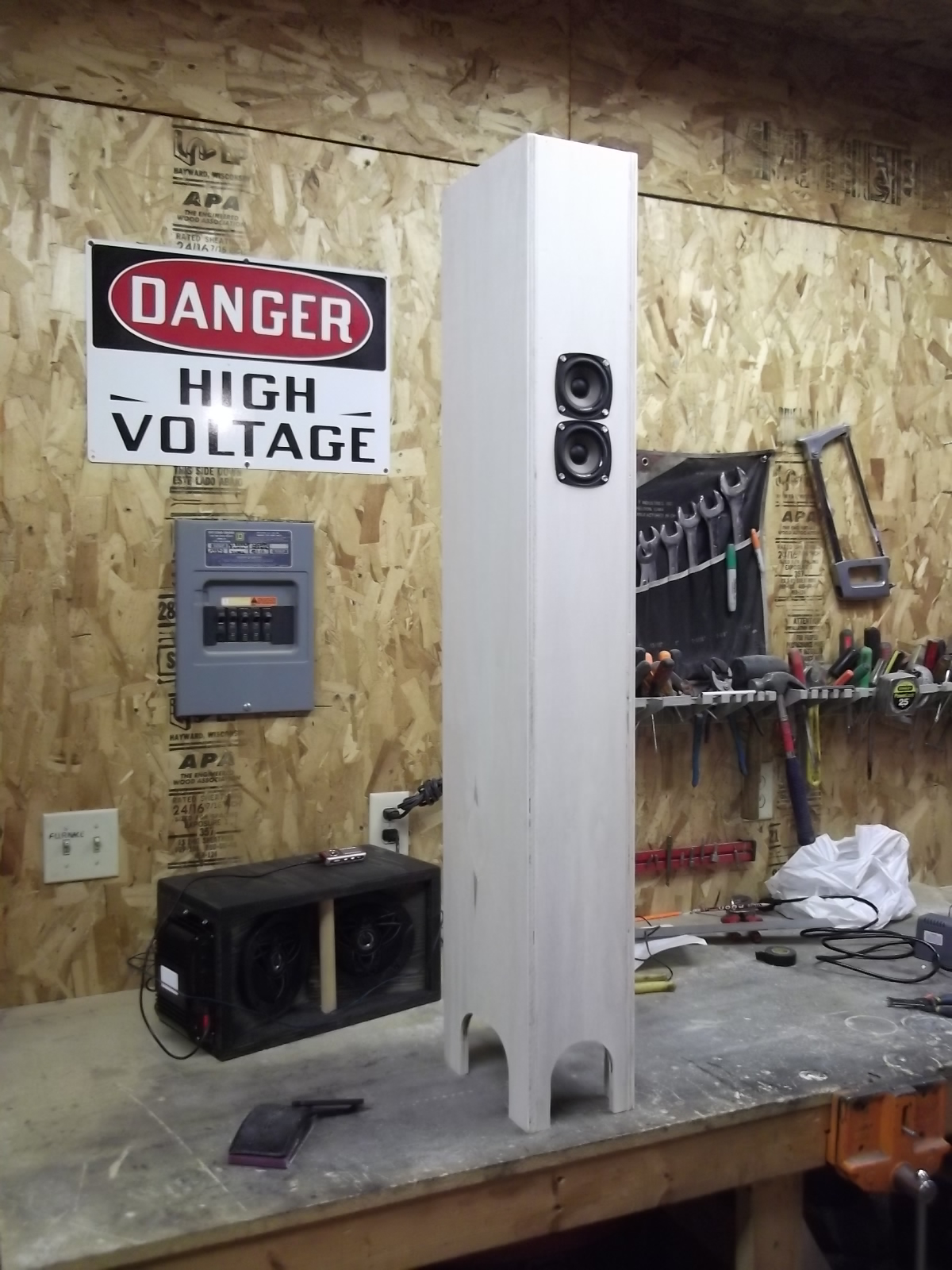

I had 8 of these in two sealed cabs. No calculations and with a helper tweeter all firing forward. So with the eyes rolling of the Mrs. I tore them apart to build a push-push bipole with 2 firing forward and 2 firing backward all in phase and the helper tweeter out of phase facing the wall.

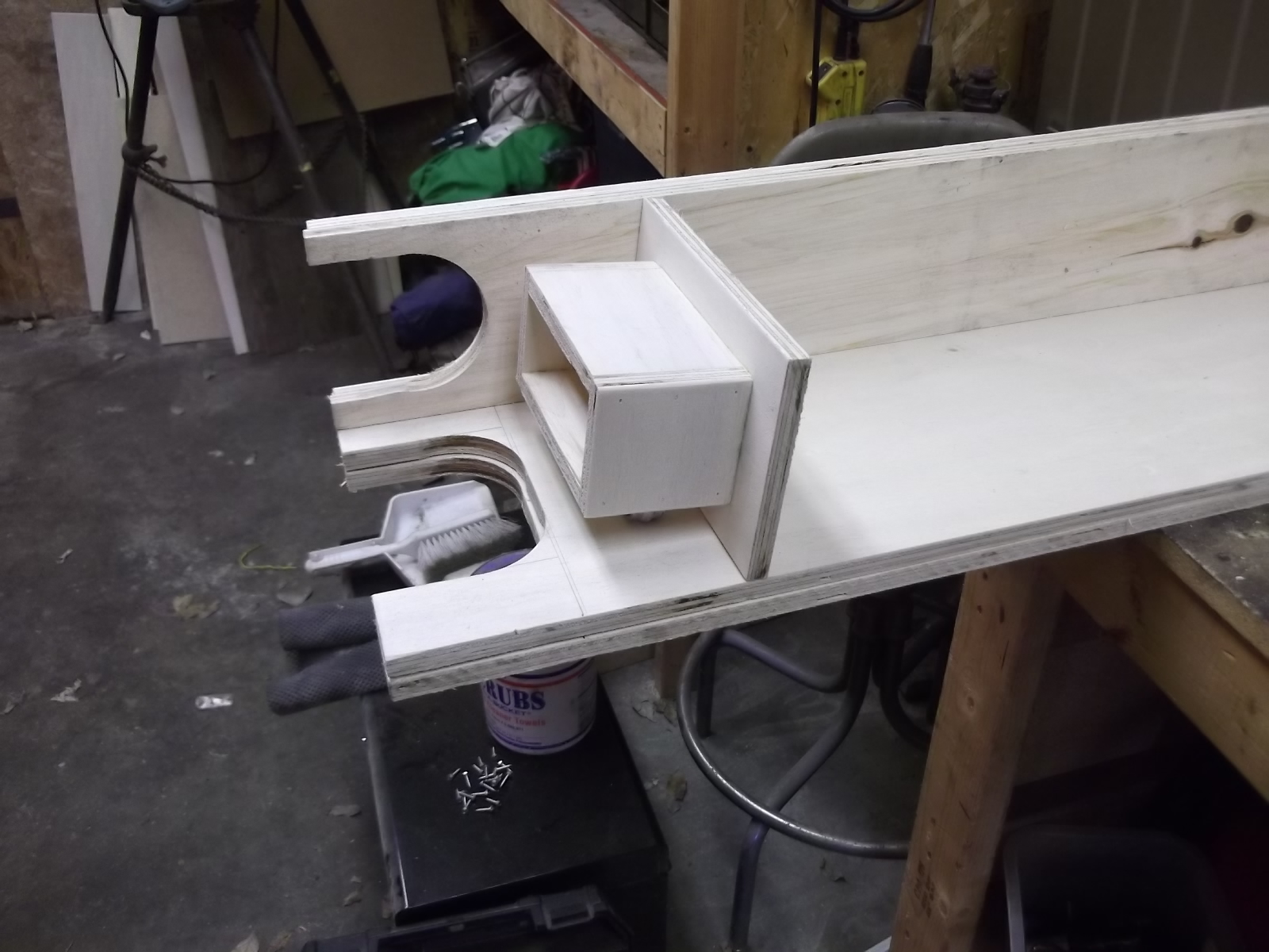

The tuned port is hidden and down-firing.
I have to give the credit to xrk971 for the calculations because mine were way off! Thanks again X
Well here she is and what it replaced.

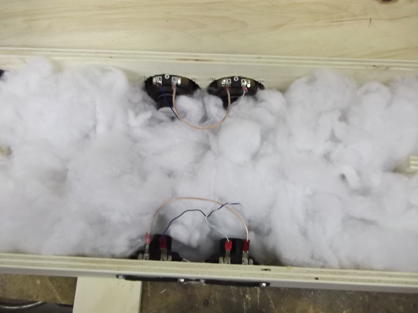

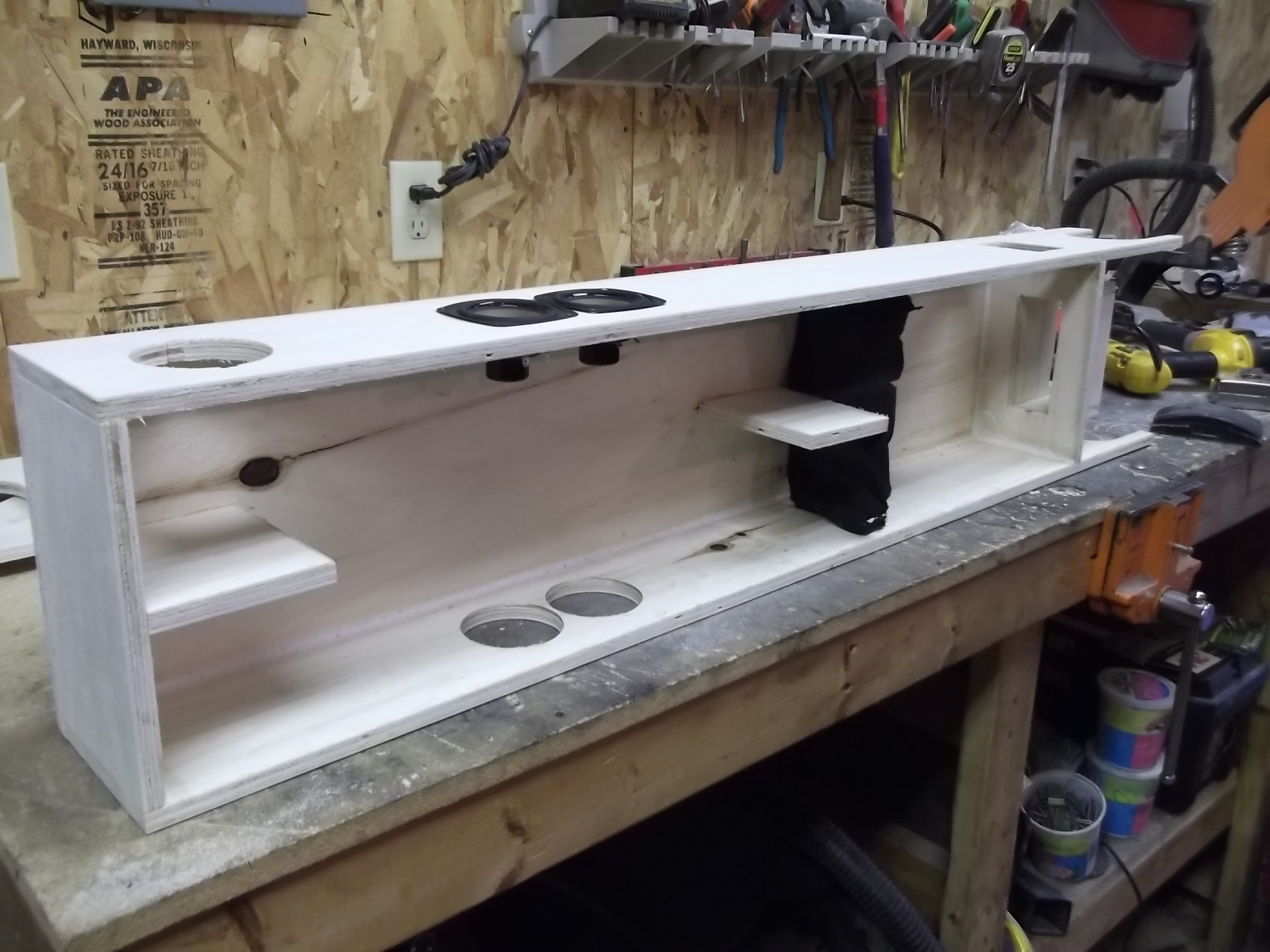

The inside dimensions are 8.5"d 5"w 40"t T had enough room underneath to make the port external of the box and it measures 2"x5"x3.7long.
Overall outside it is 9.5"d 6"w and 48"t
The drivers are placed 1/3 down the enclosure and it is stuffed 2/3 down with the bottom being left open over the port. I stapled an old scrap of speaker grill cloth at 26" to prevent all the stuffing from falling down.

This thing sounds so good and I haven't even monkeyed around with yet. 5 min of listening. After this write-up I will go enjoy it.
Bad thing is now I have to gut my other tower to build a matching enclosure. I can't wait to hear it then.
The old one just sounds dead compared to this one. Kudos to X! In this case the box does really makes all the difference in the world.
Thanks to all your guys write ups on the MLTL for the little tangband that could.

Well I got the other tower put together this afternoon. Stereo bipole front speakers is something I've never heard before. I like it! The sound just fills up the room but it still has left to right imaging. Really loving them so far.
Oh and X they must get down a bit because I had a friend stop over and thought I had a helper sub on. Said nope just 8 little 3"er's! He was blown away.

I'm staining them the same color as the old towers as per the Mrs. direct orders.
I was running them direct without bsc in their last setup so i'm sure they would have benefited with one, but the bipole must be doing its job. I did find distance from the wall did seem to affect them.
I messed with the helper tweeter. In phase out of phase and off. So far i've settled on out of phase. Although they do sound good without a tweeter, the little bump of the really high freq off the wall really does help to my ears.

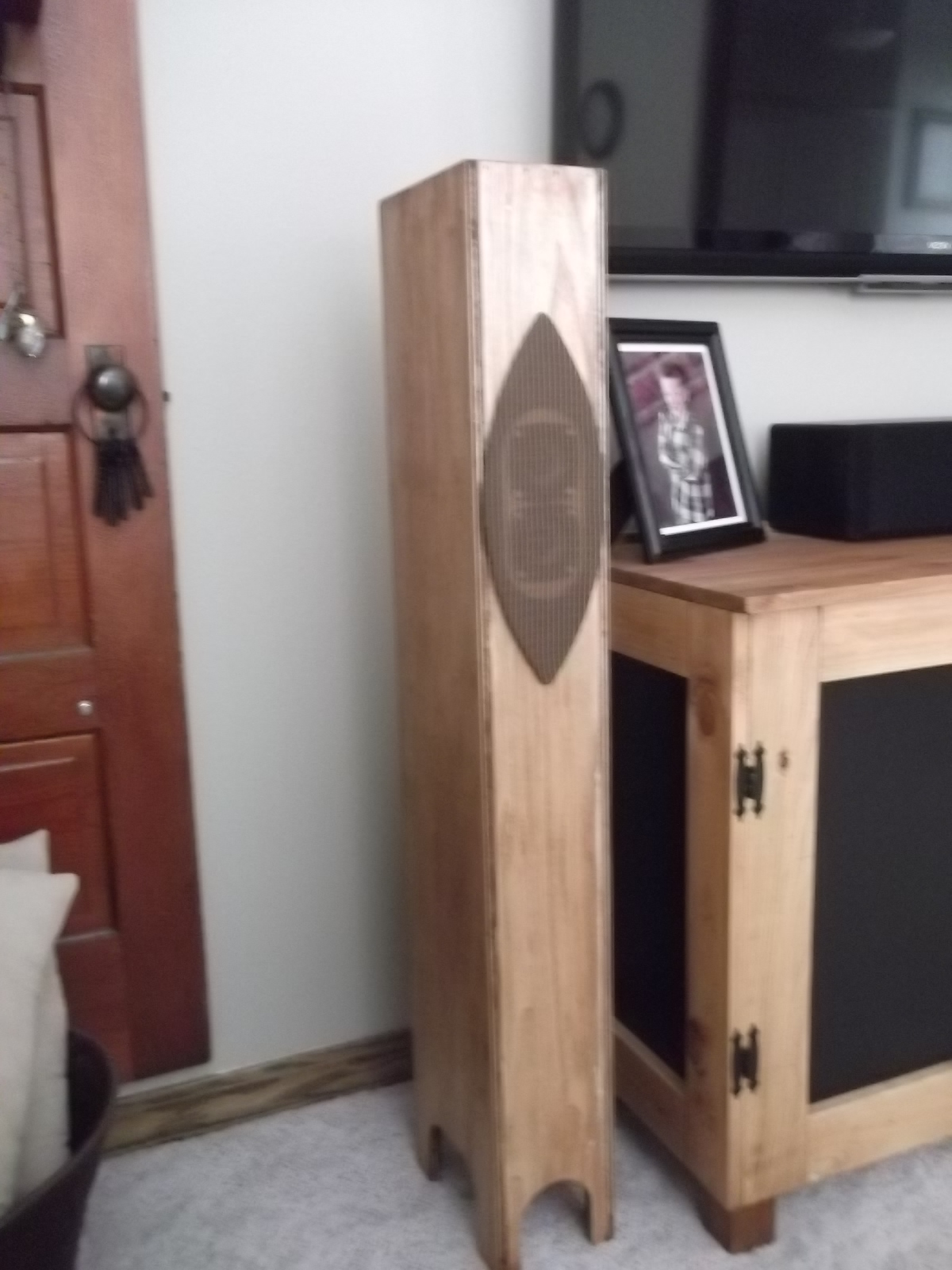

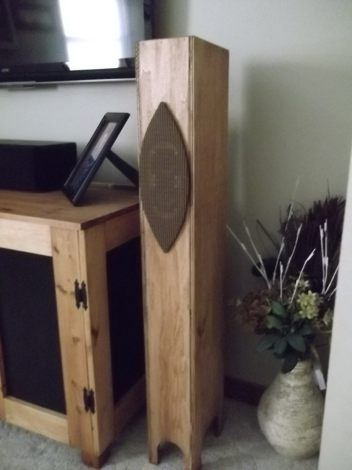

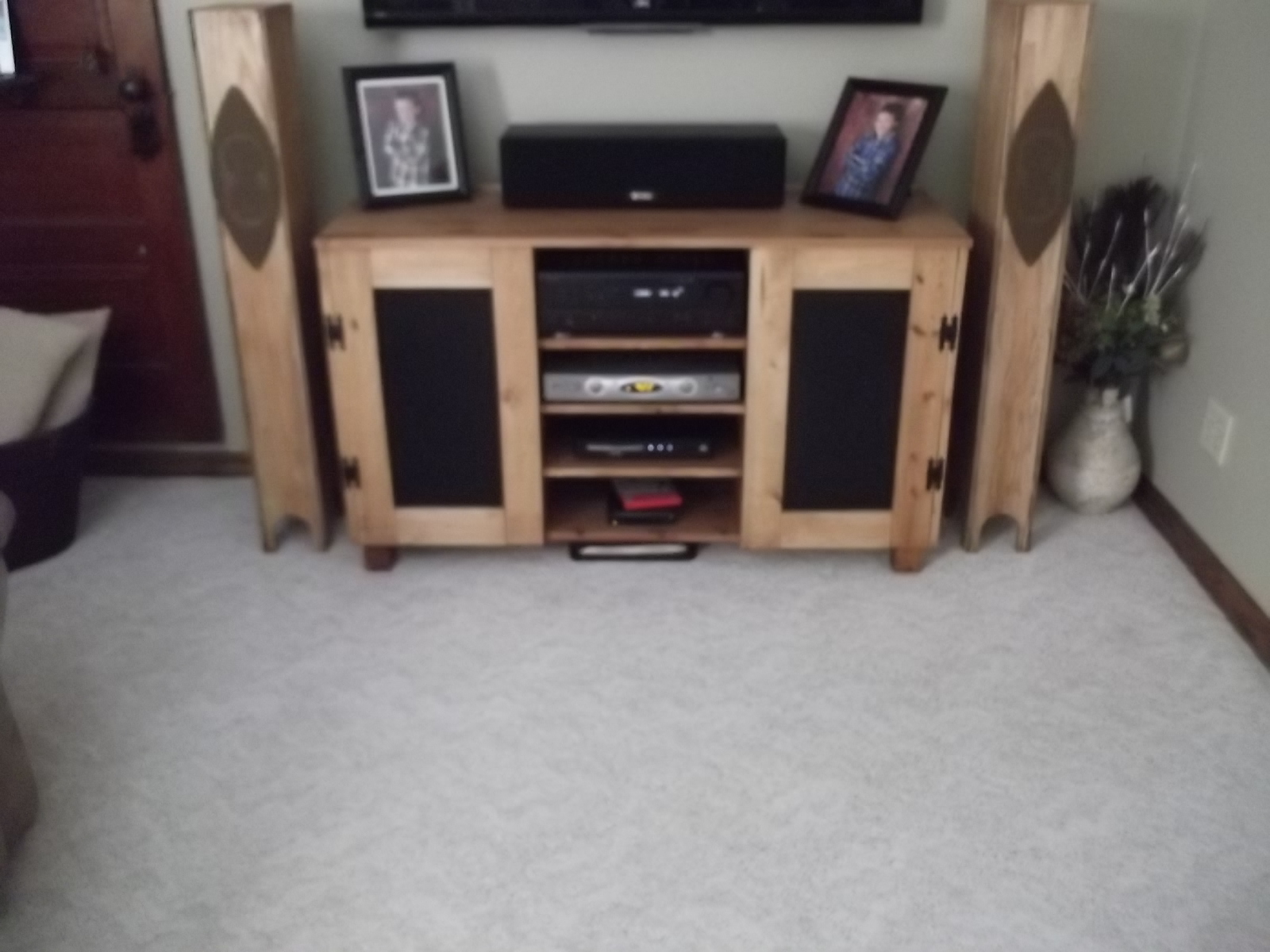

Well they're finished! Got the enclosures stained and the grills made. Still trying to like the red/brown grill cloth. Might just have to go back to good ol black. I will let it go for now.
I can't stop listening to these little guys.
X thanks again for all your help with the specs!
