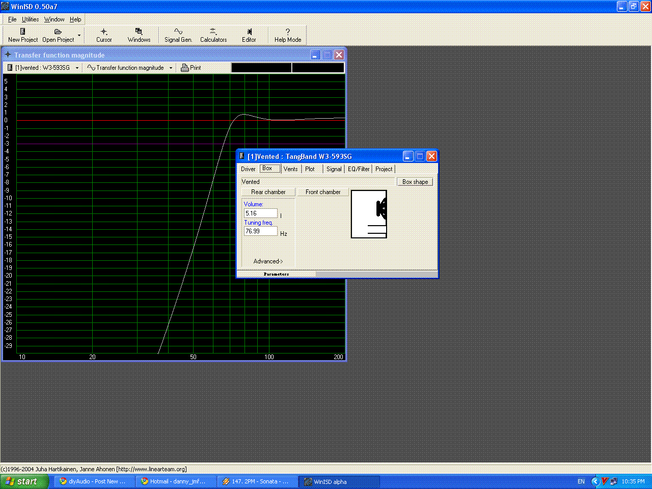

Hey guys, i got 1 pair of Tang Band W3-593SG planned to be used with an unknown brand tweeter.
Lately, after some listening test (audio track) shows some resonance problems at around 2Khz - 2.5Khz. I plan to use a 24 dB/Oct Linkwitz Riley Xover to crossover this midrange with the tweeter. Can u guys suggest any crossover frequency around 1.5Khz to 4Khz for me? thanks
Also predicted by WINISD the speaker is best in ported box. I don't think so due to the small diameter of the driver
There are some parameters for this driver:
Fs:110Hz
Vas:1.55L
Qts:0.57
Qms:5.06
Qes:0.64
Pe:30W
Znom:8ohms
Freq Range:110Hz to 20Khz
