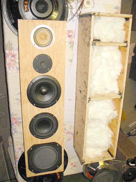

Ok, here's where we're at:
I have the TB along with a Pioneer drone in the lower cabinet (.8 cu ft), with the plate amp.
The MCM 7" and an unknown inverted soft dome in the next compartment (approx 500 cu inches), and the Coral mid in about a 300. The upper two compartments don't go all the way to the back so there's a little breathing room for the woof and drone up the back.
Crossovers are 100, 1000, 10000, all 6dB except the low pass on the plate amp, which I think is 12. No Zobel or notch, just air core and poly.
I am impressed. Not just a proud father kind of thing, this is for real. I am truly surprised at how this sounds. Takes a bit of juice to get 'er going but the overall effect I am really happy about.
When the real cabinets are made, I think I will add about 15 grams of weight to the drones and increase the cabinet to about a 1 cu ft, and fiddle a bit with the XO.
Not bad for a stupid 4 way that I never thought I would dream up let alone do a mock-up. Life is full of surprises.
The picture I took last night before it was wired up.
Cal

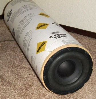

bwbass said:I just finished a "little" pc speaker sub with the adire Koda 8 driver, which has 12mm xmax and fits in a pretty small box. I wound up using an 8" sonotube about 27" long with a 17" x 3" diameter port mounted in the other end cap. I have it standing up in a corner as a HT sub right now and it's quite capable and has in-room extension to the mid 20's.
Adire shows a .7 qts sealed alignment for this driver as being .35 ft^3, which is pretty small, if you prefer.
