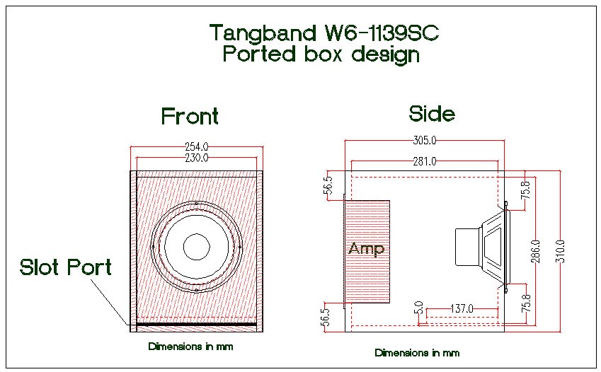

Here is my first try at a design
Well I was fooling around with WinISD and I came up with this.
Its a ported box tuned to 31Hz. According to WinISD, this should give a -3db somewhere around 28.5 Hz. The box dimensions were compensated for the extra port and amp volume and to a lesser extent, the speaker volume, and leaves an approx volume of 0.53 ft^3. It uses a slot port that is only 5mm high so I hope that this is not a problem.
I hope the attached image is self explanatory enough as to what I plan to do. Any suggestions, just let me know.

You might want to check the port velocity at your anticipated max power level in winISD... your port area equates to about a 1.5" diameter tube which seems kind of small for the tuning and excursions you're talking about.
Also, with your very "thin" slot design you'll have to be very precise with construction, since a .5mm error in the height, for example, will result in a 10% difference in your port area, messing with your tuning considerably.

Duane,
Firstly, I want to live where you do. Secondly, I am fooloing around with the same woofers. Currently, I have them in a sealed .5 cu ft. flat topped pyramid with a 70 watt plate amp. This is adequate but I know that more can come from the little beauties and am interested if anyone has good results from the PR route, as I have some of those on hand.

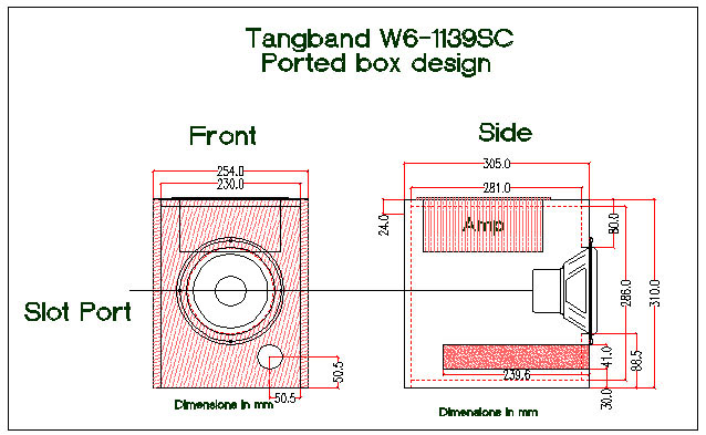

2nd iteration
OK,
After fooling around in WinISD (BETA) again I came up with this second design. The port diameter is what I have available here to me, and its internal.
Just one other question; if port noise will be an issue with that diameter, then would using plumbing fittings to get angles and beable to turn the port be sufficient? I ask this because this would mean that the port would not be smooth at the joints and Idont know if this is a big problem. If it is the case I may have to consider an exterior port maybe? But if it is not a problem, then how do you measure it? would it be down the middle or do you take the distance of one side, then the other and take the average?

I plan to make actual measurements of this unit in closed box (I have the box ready) and then using LspCad to design a compensation for rolloff and to cut the real low frequancies.... I hope I can get it done during the next week.
By then I should be receiveing my now souncard that will make it possible to simulate the crossover/eq scheme for the sub/sat combination.
I will let you know and post the results as soon as I have them.
