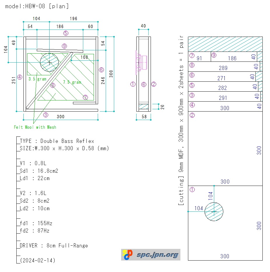

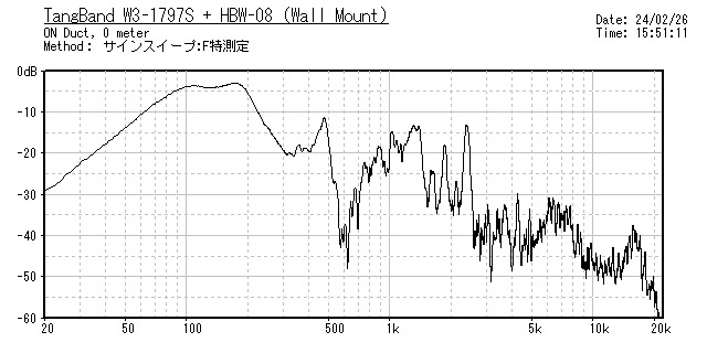

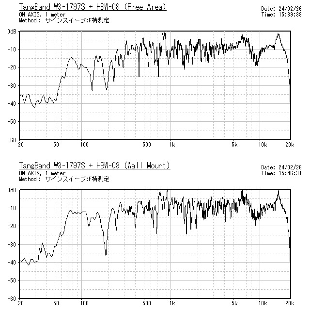

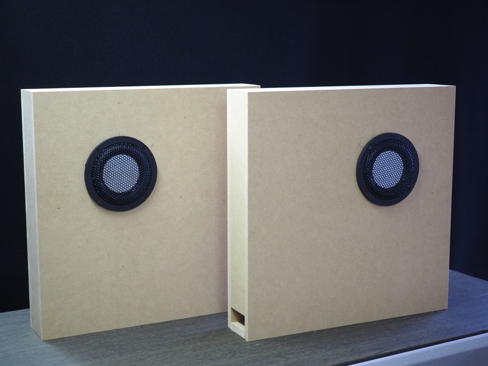

TangBand 3-inch honeycomb cone (W3-1797S) + HBW-08

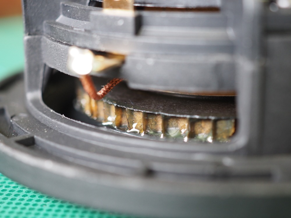

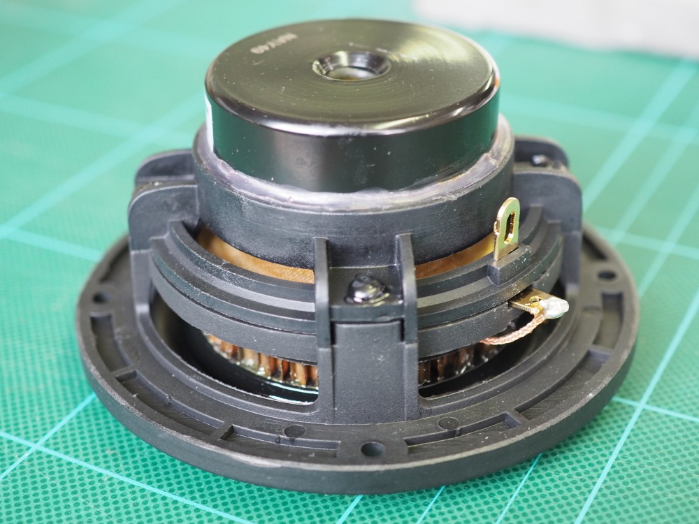

The voice coil has a large diameter and the damper area is small, so the bass is not so high.
The sound quality is refreshing with little distortion.
