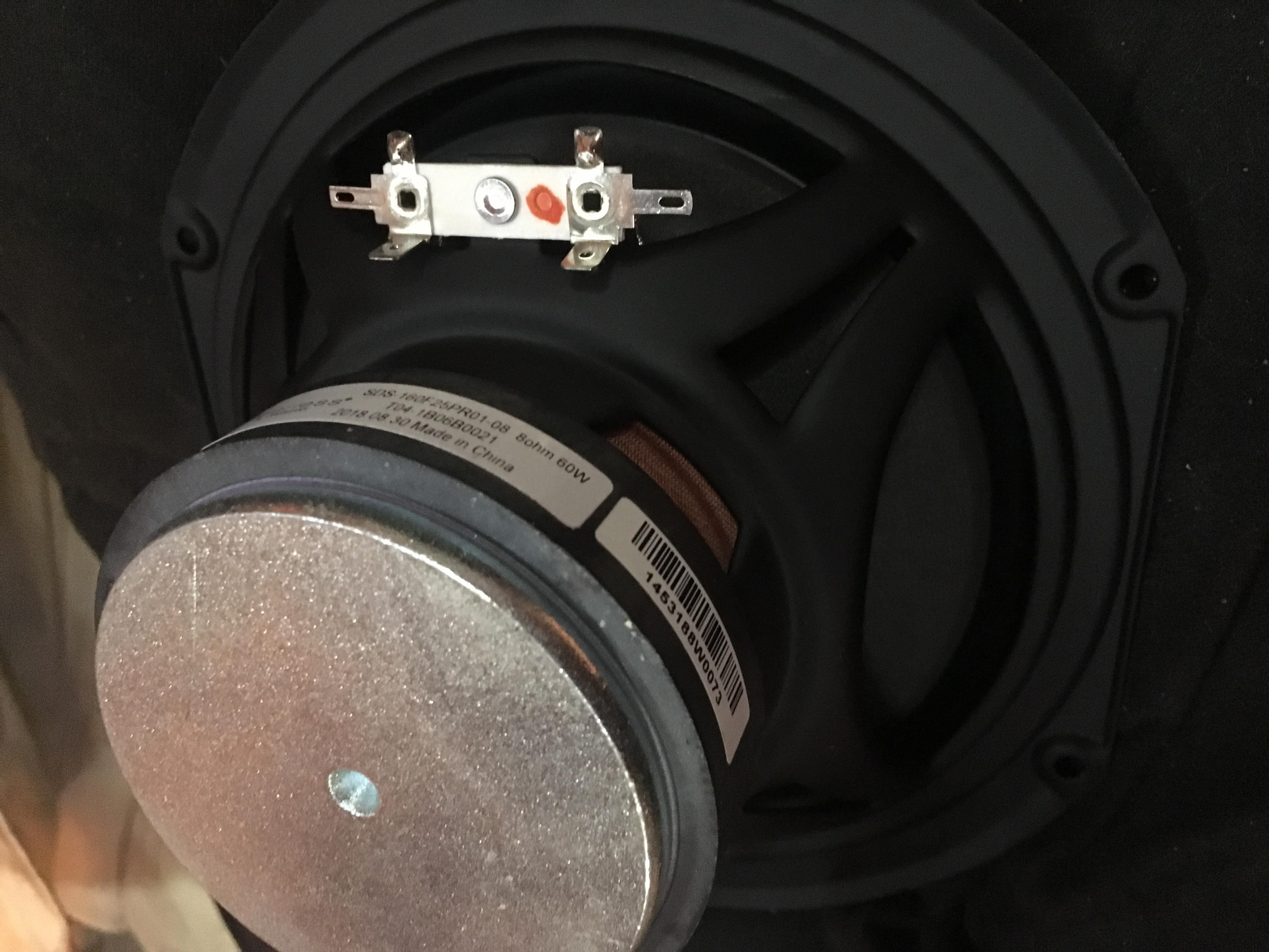

I think that McM one (two) justifies the use of ‘spending money’ for the month February? Last time it was a few of these for fun:
Peerless by Tymphany SDS-160F25PR01-08 6-1/2" Paper Cone Woofer Speaker
CBS240, only twice as much cost, so that helps. But good how the surrounds are rubber like the Ultimates were.

Youre a bad influence! 🙂 These magnet/motor parts and narrow open frame sneak into the gap on a retaining wall (raised garden area
Of concrete blocks in the back yard) just fine. It started pisssing rain or id have gotten the phone and a pic...

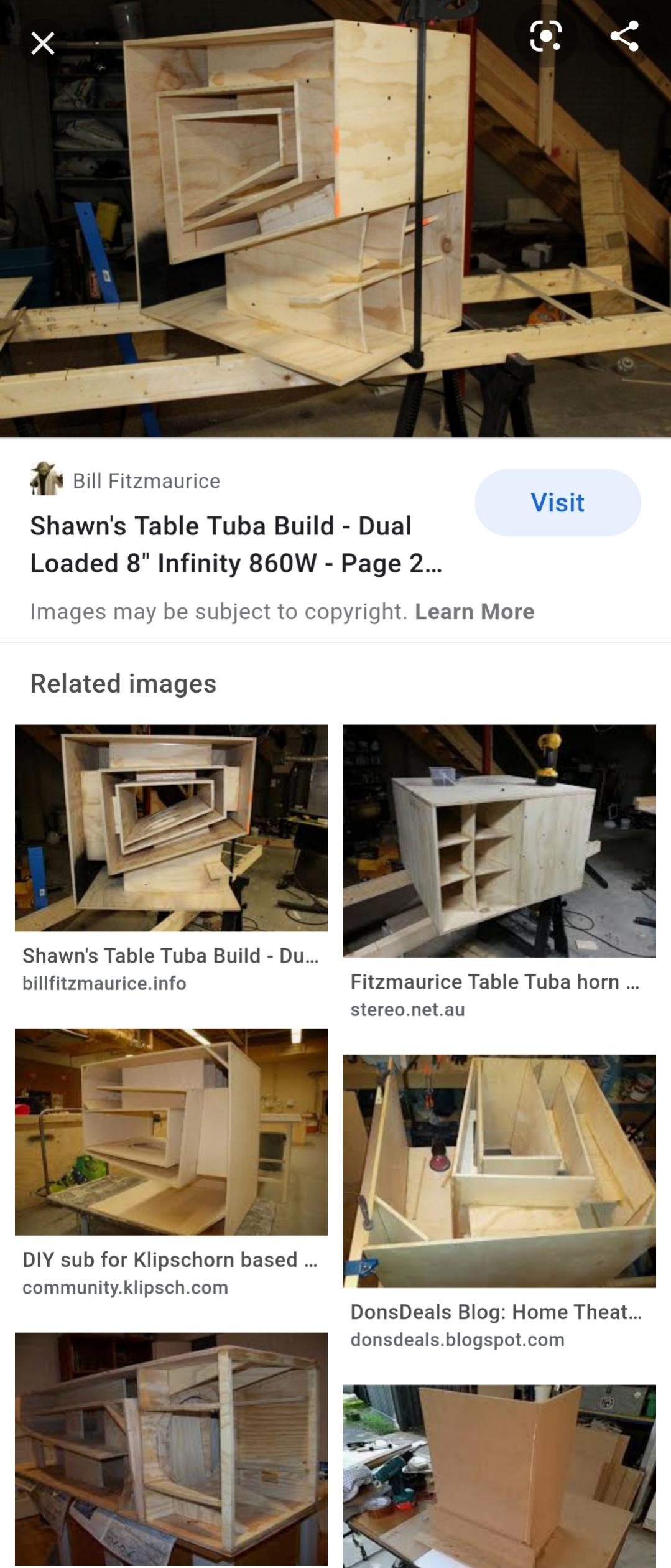

Cut it open, lets see the guts! 🙂
The 2nd link supposed take you to the guts.
But, here ya go!
Wow, that's a long, complicated path. I could probably BOXPLAN it if had some time on my hands, but I expect that there'd be no easy way to derive a corresponding Hornresp sim for it. Too many differently-expanding segments. I might be able to get close though, if given a measured impedance curve and frequency response graph to work with.
