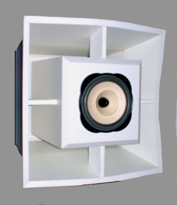

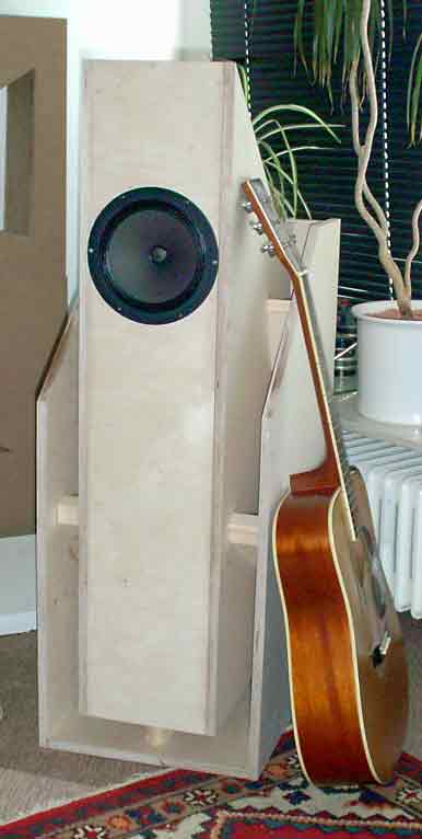

And thought Troels OB:s were big. OBL11

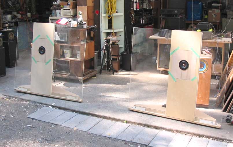

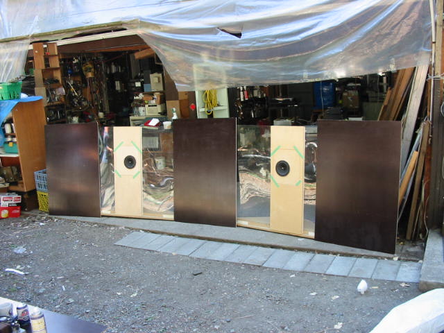

Those are about the same size asmy experimental baffles...
And here stretched out to 16 feet..
